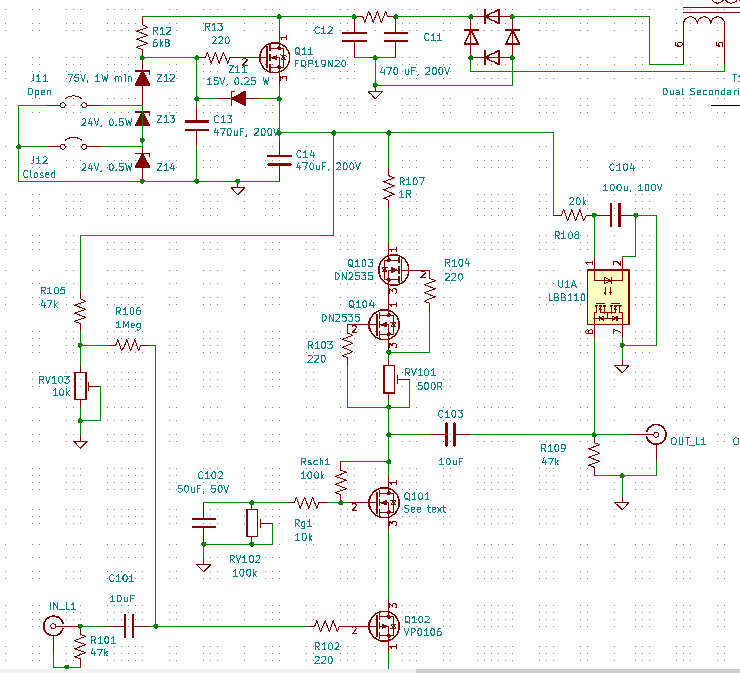

Here's a teaser. KiCAD schematic snippet. Starting from the top right side, coming off the transformer secondary, diodes and CRC filtering, followed by a simple zener reg, into the CCS, gain FET, and bottom FET. To the middle right is the LBB110 relay. Still to be tested and configured. Suggestions welcome.

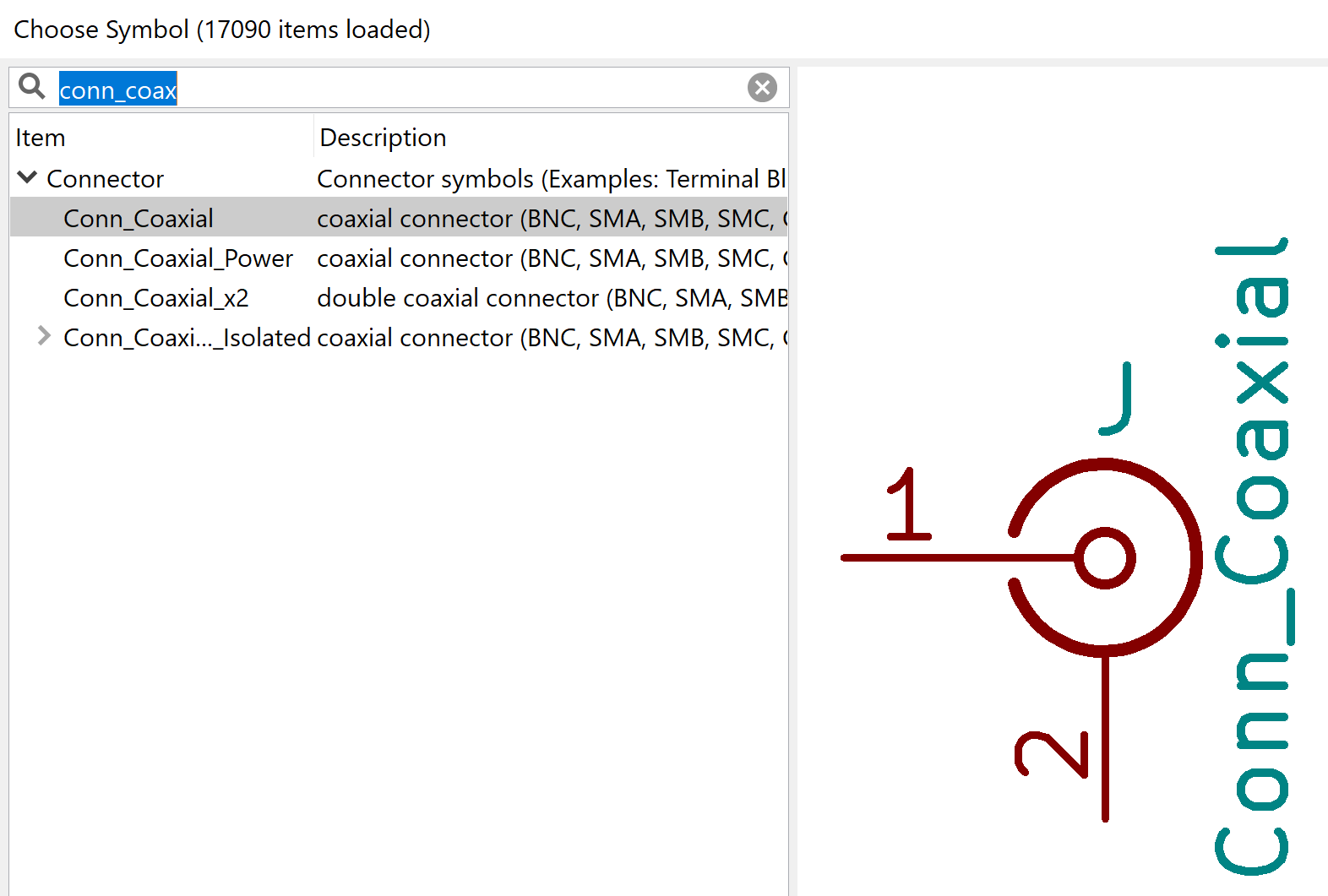

Your layout looks really nice. A naive question, but could you share the name of the symbol you’re using for ‘in’ and ‘out’? I’ve never found that one.Here's a teaser. KiCAD schematic snippet. Starting from the top right side, coming off the transformer secondary, diodes and CRC filtering, followed by a simple zener reg, into the CCS, gain FET, and bottom FET. To the middle right is the LBB110 relay. Still to be tested and configured. Suggestions welcome.

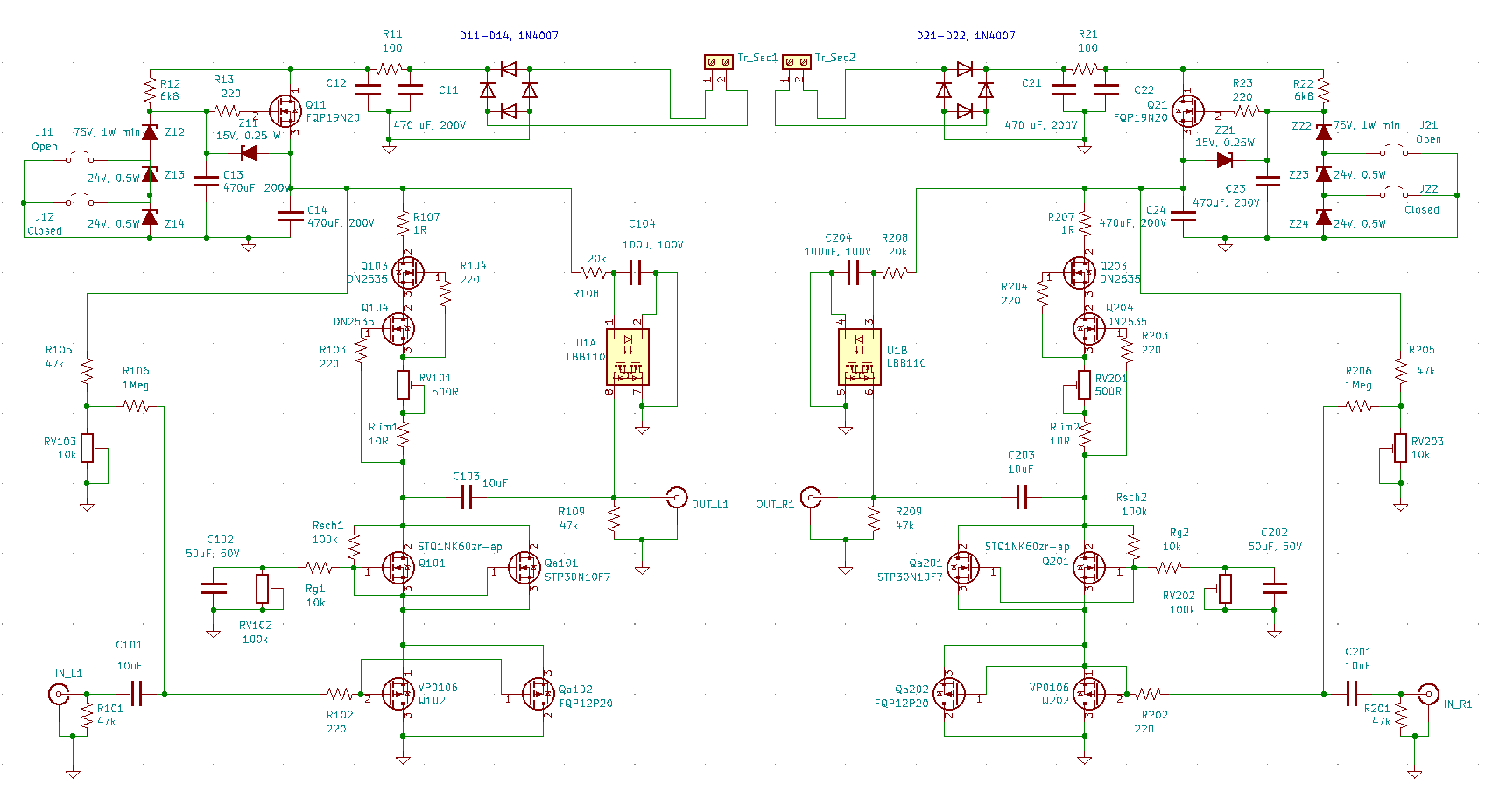

Here's the Full Monty. As I started laying this out, a few more changes:
1. Removed transformer and added a couple of holes/headers.
2. Added alternate parts for the main gain device and the P-channel follower. So, we can swap in high power and low power parts.
The relay portion has not been tested yet, so don't build that in case someone wants to jump the gun.
Disclaimer: schematic below is not for commercial use without my permission. Not that anyone would be interested 😊.
Question for interested parties: how big a cap do you envision for the input and output? It is the primary determinant of PCB size (and probably cost).
We have 1 MOhm after the input cap, so even 22n would give a -3dB point at 7.23 Hz and a -1dB point at 14.46 Hz.
100nF or even 1 uF can be ok.
As for the output cap, I'd consider another 50k as input impedance of the following stage, so around 20kOhm load.
1 uF would give a -3dB point at 8 Hz and a -1dB point at 16 Hz.
Looking good Ra7!
Definitely like the transformer header connection instead of an “onboard” trafo
Cap size….
I wouldn’t sacrifice capacitor real estate just to stay under the 100mm x 100mm pcb size, a batch of 10 boards might cost $13 instead of $5. But being able to properly fit PP film cap is priceless 😊. Also, I like to see the -3dB corner 2Hz or less. I’d like to see input/output capacitor location size to be in the neighborhood of 20mm wide x 30mm long with solder pads at 35mm, 27mm, 22mm and 15mm lead spacing to accommodate different types and capacitance.
Also, Test Points added at key measurement locations for easy probe connections would be a nice feature.
Cap size….
