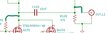

Looks like there are two errors with crossing wires connected

Thanks for catching! I had deleted that junction once already. Not sure why it appears again. KiCAD did crash once, so that might be it.

The horizontal wire crosses right at the point where the vertical wire meets the pin of the fet. The software thinks that you intended for all three wires to be connected to the pin. Move the horizontal wire further away from the fet and this won't happen. You should probably delete the horizontal wire and re draw it to break the connection that may be in the netlist.

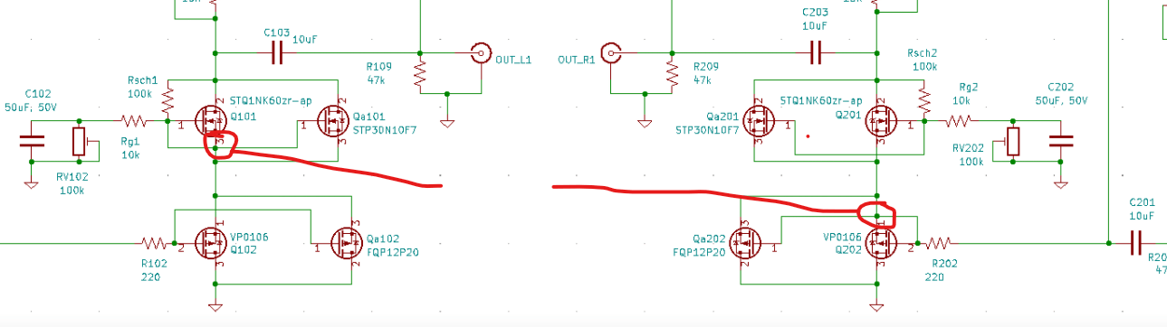

One rule I use to avoid confusion in wiring (either layout on pcb or point to point) is to not have any four way wire crosses connect. Many times you need allow non connecting wires to cross as that can still be necessary to keep the schematic organized. See the image for a couple of examples of changes I would make to keep the wiring clear.

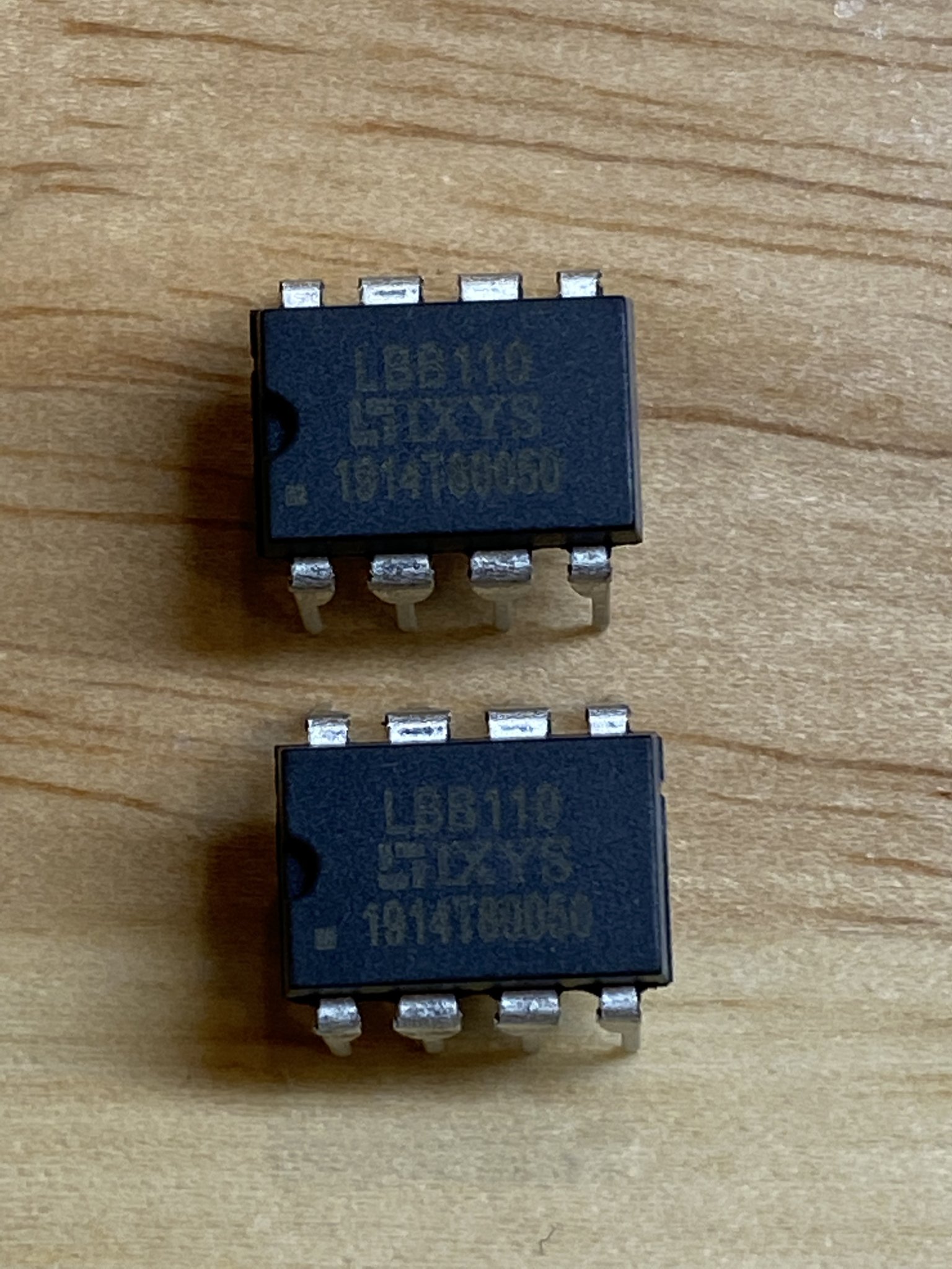

Tested the LBB110 bugger today. Works great! Tested with a meter and then with the amp. Upped the resistor feeding the input of the optocoupler to about 90k and the cap to 1000u, 16 V. Current feeding the LED is about 1 mA, and the 1000u cap charges slowly before the LED turns on and opens the switch (about 1 second I would hazard). Output doesn't go above a few mV. It doesn't work as well if you turn it off and then back on really quick, but I can live with that.
Neat little device this thing is.

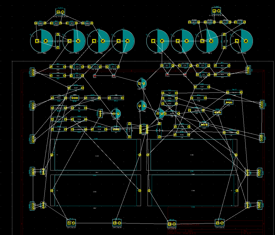

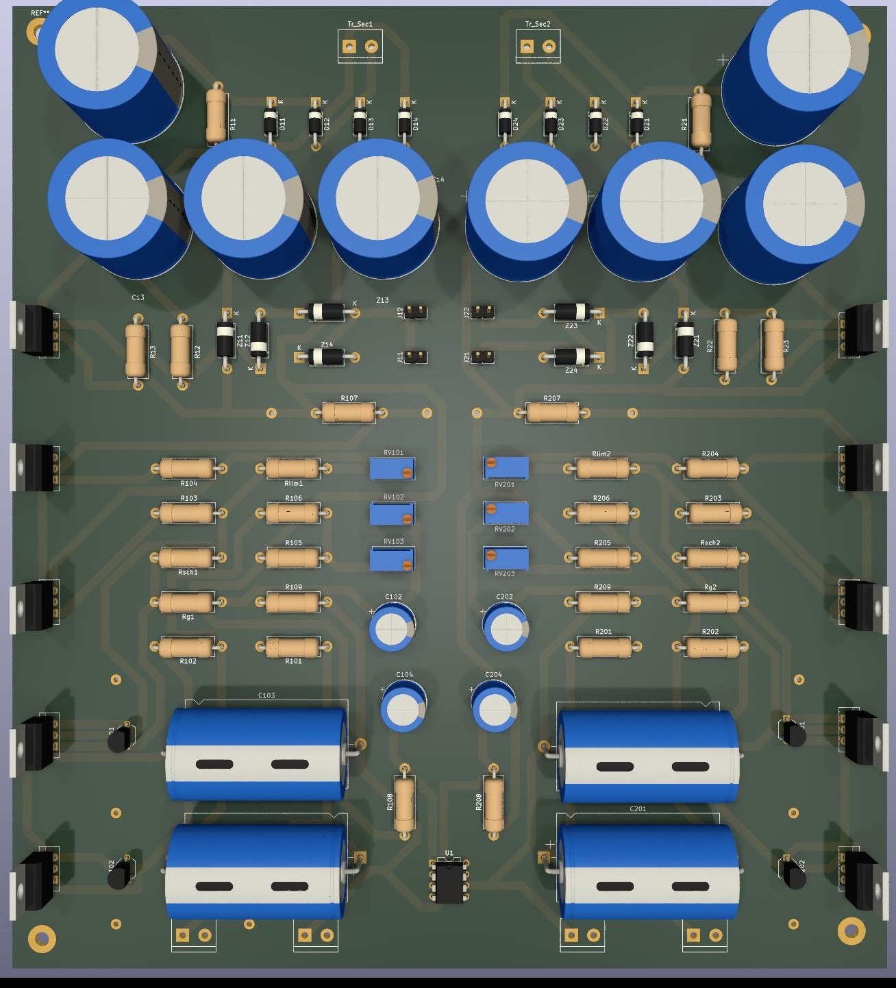

Layout is mostly done, part positions need to be finalized. But I am rethinking a few things based on feedback from all of you: cap sizes and test points. Also want to leave space for heat sinking and ease of use. On my test board right now, I am sticking different devices (TO-92 and TO-220) into a three-header screw terminal. I wonder if something like that would be convenient for everyone for popping different devices in... like tubes.
Here's the draft layout with the rats nest. Thoughts?
