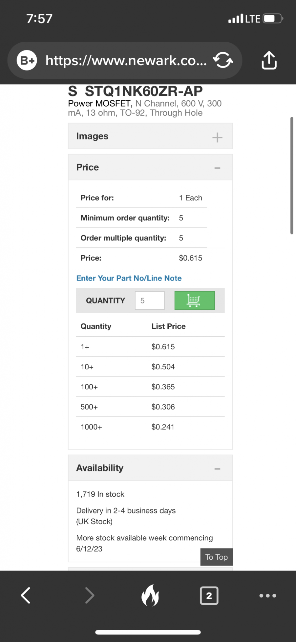

5 days later….. almost 4K sold out:confused:
They list 1,719 in stock ATM.
I’ll have at least 8 pairs extra. Similar to Raul’s offer, if anyone’s desperate for a pair of STQ1NK60ZR-AP to build his preamp, I can send a few out too.
