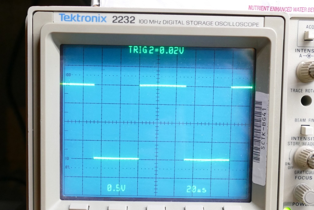

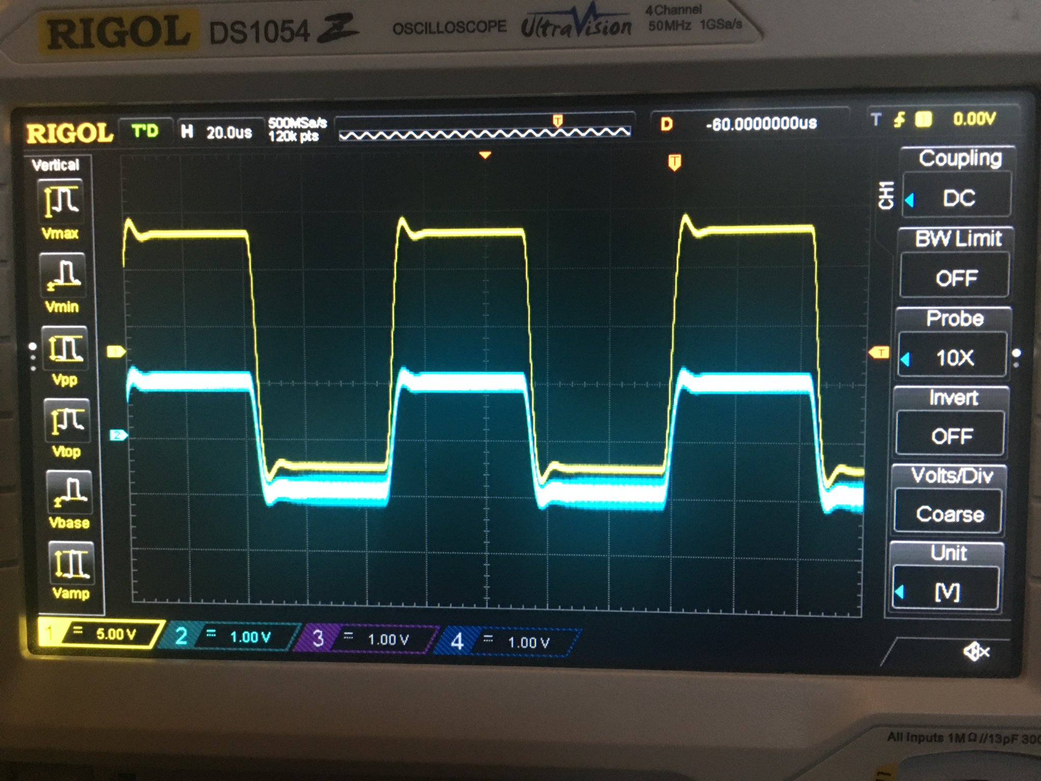

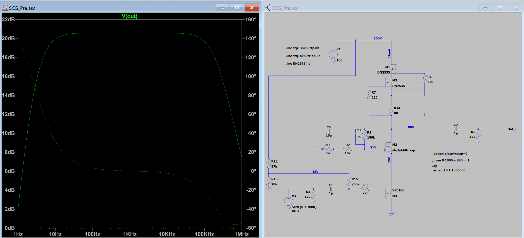

Measured today. 10 kHz square wave with STQ1NK60ZR-AP. (Why do they give them such awful names? That could be my password and meet all requirements)
Input (blue) is noisy and also has a bit of ringing that is faithfully reproduced by the preamp. Source is REW. For some reason, ARTA’s 5 kHz square wave was very poor. So much ringing that it is unusable. Still waiting on the cheapo function generator. But we can put to bed the thought of putting in a bypass cap on the PCB.

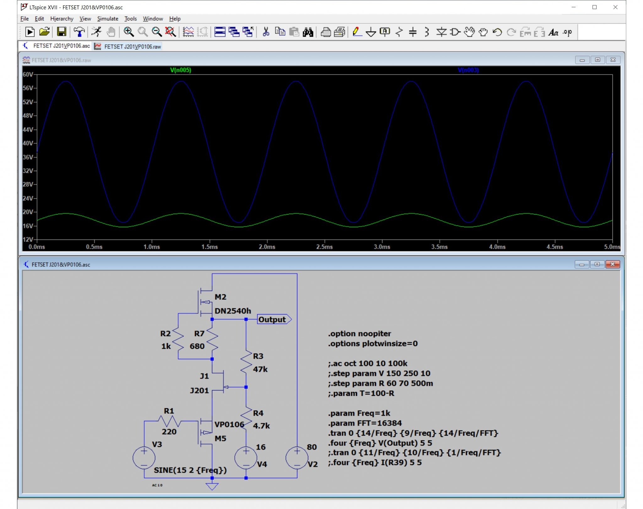

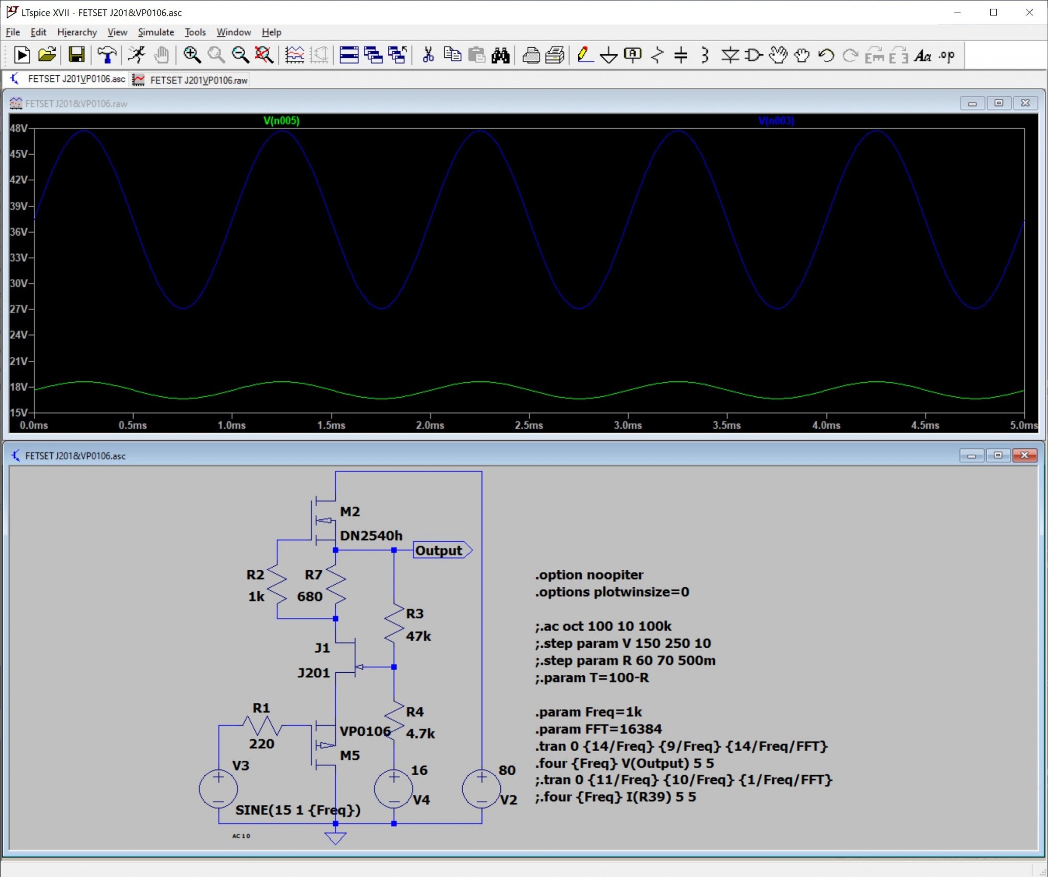

Enclosed are two LTspice simulations of a FetSet circuit. They are the same except for the input 1 KHz signal level. The green trace is the voltage on the gain fet and input fet's source. The blue trace is the gain fet's drain.
At 1 volt (peak) of input the input fet sees a two volt (peak to peak) variation in its source voltage (16.75 to 18.75 volts) This is about 10% of its available voltage. At two volts of input there is still plenty of headroom across the p-fet. The gain fet has 10.5 volts across it (27 - 16.5) ar the bottom of the sine wave. and 29.5 volts across it (48 - 18.5) at the peak of the sine wave.
Crank up the drive to 2 volts and we see that the gain fet starts to run out of voltage head room. This circuit has three active elements in series, so there is a balancing act to give each one its most possible headroom. LTspice simulations can get you in the ball park, but are only as good as the models used. Real parts often don't quite match the sim, so some resistor tweaking will be needed.

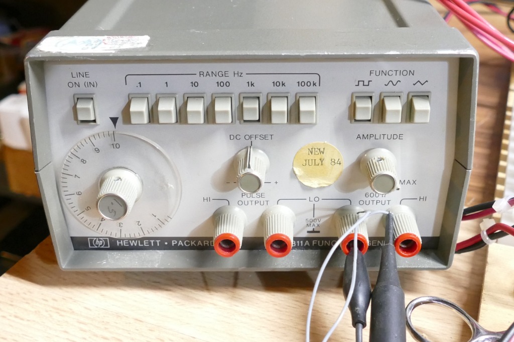

Back around 2000 Motorola used to sell surplus test equipment to employees. I picked up this HP3311A function generator for $20 and the Tek 2232 DSO for $100. The scope was on my desk at work for years but developed an intermittent condition thar required a good smack every day or two. It would occasionally do a spontaneous reboot whenever it was in the mood. During a random audit one day the inspector noticed that it and some of my other test equipment was say 5 to 10 years past its calibration due date. All the "non compliant" went to the cal lab where the scope was scrapped and replaced with a shiny new one since it was old, and the cal lab tech didn't know where to smack it. This model had known power supply issues. I bought the "dead" scope for $100, over 20 years ago and still smack it whenever it needs it, and it still reboots whenever it wants to. The scrap sale had a bunch of these function generators. I have no idea where in the plant they came from, but it works fine. I have never taken the covers off of either. Together they make pretty 10 KHz square waves.Without getting into controlled impedance interconnects and the like, that is about as good a square wave as you can expect to see from audio equipment.

Yeah, that makes sense (I think). The drain of the gain FET in my sim is at 65 V or so, and so there is plenty of headroom even at 2 V input. Node 005 is the drain of the gain FET.The FetSet curcuit here has some bias applied to the input fet to keep the voltage across it in a better place such that a two or more volt signal swing is not using up 100% of its range.

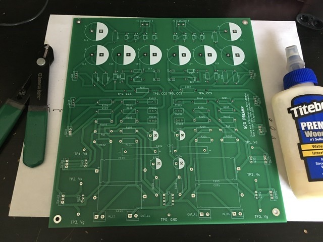

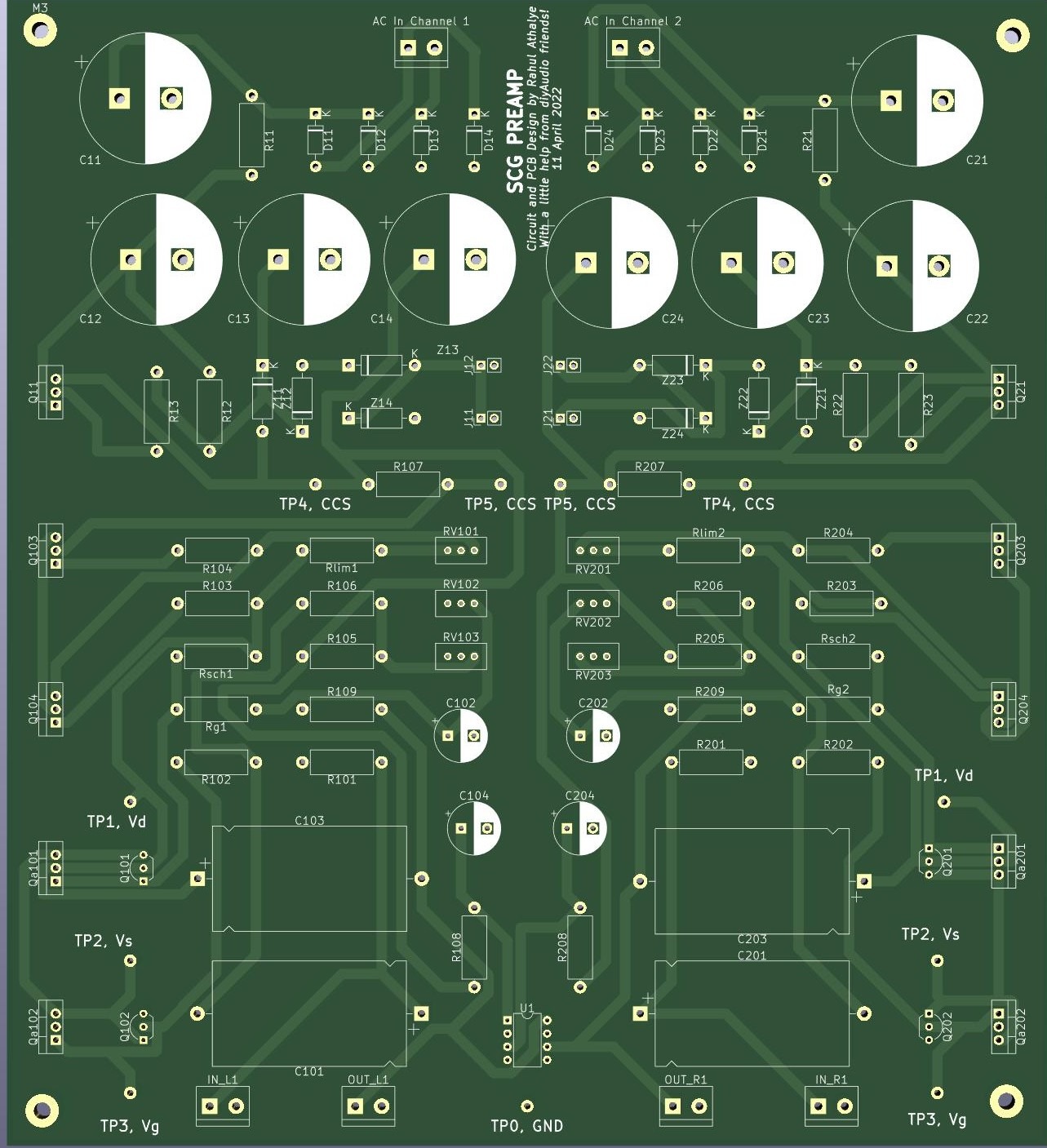

Here's the near final PCB, ready to go for a trial run. My plan is to get one or two made and iron out any mistakes or problems during mounting and operation. Honestly, I haven't done a PCB this complex before. Any help is appreciated. I'm not going to worry about the stoppers being a little further away just yet. Will test this PCB out and then see if we need to change anything.
I already noticed that the coupling caps need to have holes at different pitches. Will work on that. But please let me know anything you see. Thank you!

Yes, please allow for large size film coupling caps.
Thank you.

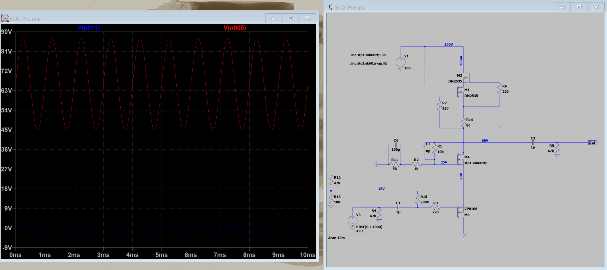

Quick update. Making one more change to the PCB: turns out the AC bypass, C4 in the Spice schematic below and C102 on the PCB, has a huge influence on the sound. I discovered this while playing around on a test board. It was sounding edgy and so I kept trying other devices, but nothing was changing. So, I started looking elsewhere. Tried paralleling the electrolytic in that position with a Wima DC Link MKP cap and the difference was night and day. I had said earlier that this position did not influence the sound much and this was based on the fact that the sound was nice and liquid with a Nichicon electrolytic there. But clearly, it makes a difference.
I am making room on the PCB for a Wima DC link style MKP cap there.
