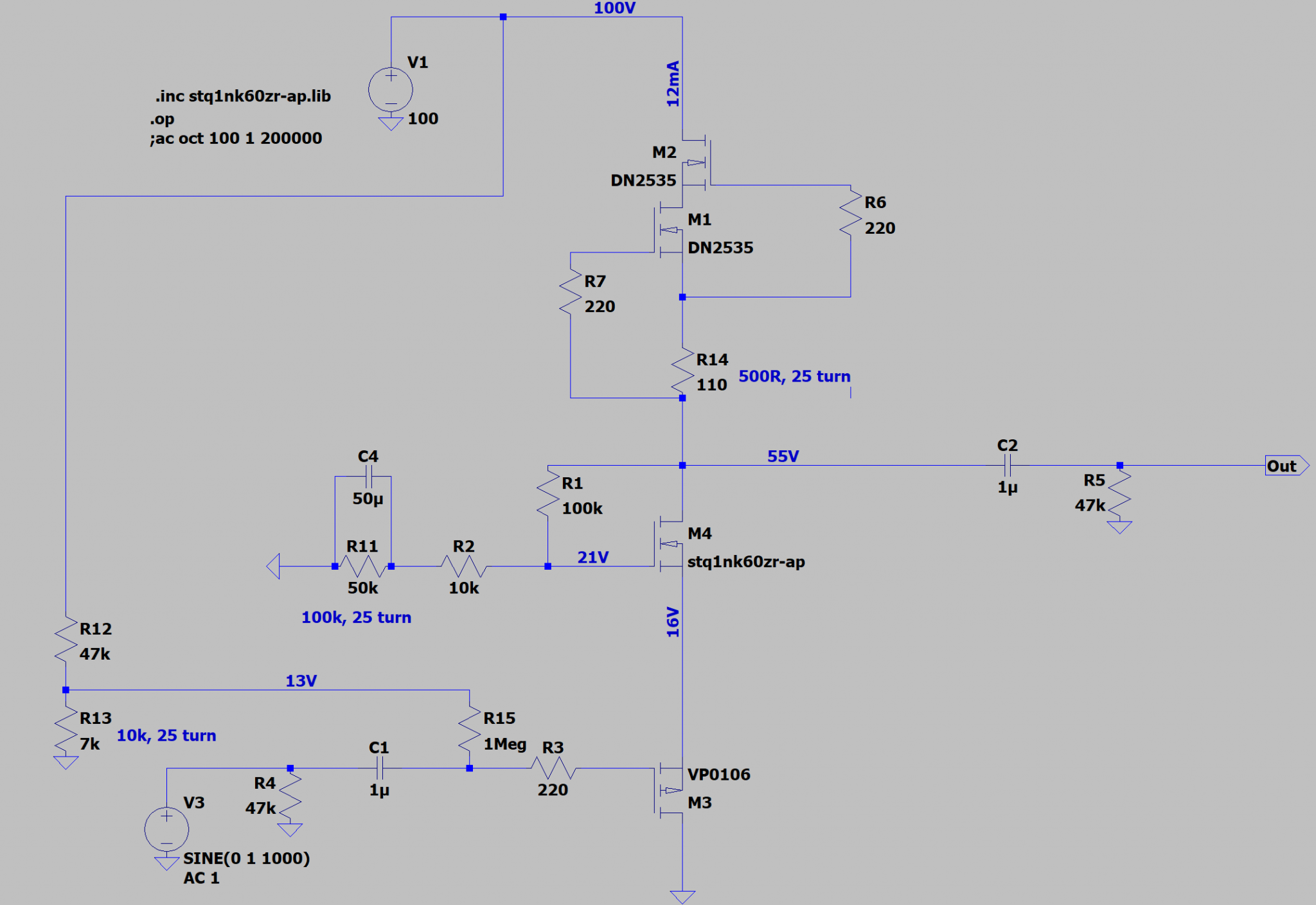

Updated schematic below using the STQ1NK60ZR-AP part. Tonight, I received the STQ1NK80ZR-AP part from Digikey. This 800V part is just as good as the 600 V part. You can literally turn it up until you cannot hear the person next to you and still not feel like it is loud. It is just so clean and sweet sounding. Sometimes, some parts, especially tubes, and to some extent, the VFETS, make things tolerable by sweetening it up and that's the key to their good sound. Not with these parts. They present the truth, no sweetening, but also preserve the excitement. The best DHTs do this. Really enjoying the sound.
Note the following changes:
1. Schade feedback resistors updated to higher values. Ratio is about the same, but you could also try an 18k instead of the 10k, raising the feedback closer to 20%.
2. Middle FET pot changed to 100k, 25 turn, instead of 10k. Provides much wider range to experiment with various devices.
Voltages and current readings on schematic are spot on compared to the real world measurements.

No, that is just the DC operating point. Sorry if that wasn’t clear. You would turn the 100k pot to get to that value. For 4-5V out, you would need less than 1V in, probably much less.
For the gain, there is quite a lot. I will measure and report back.
