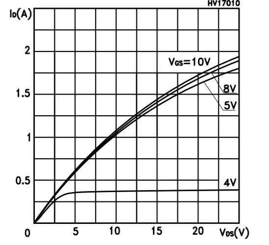

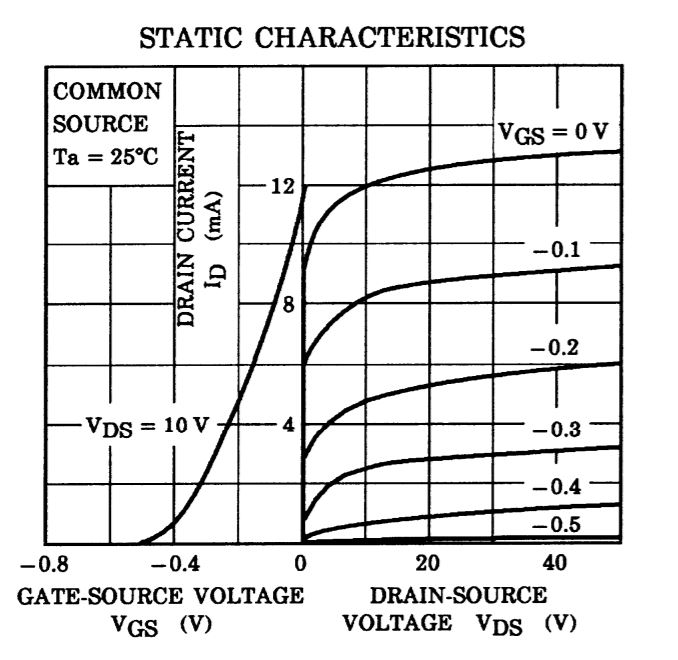

I have been looking at various datasheets of MOSFETs in the Mouser collection to look at their curves. Here’s a look at the STQ1N60 that I have been trying in the top position.
I have been looking for FETs with more true-pentode-like curves. The FQPs have decent curves. Then I got an idea. Is there a better, current production, solid state small signal pentode than the lsk170? Maybe, but I don’t know about it, and the lsk170, and the Toshiba original, the venerable 2sk170, have really nice curves to begin with. So why not pop it into the SCG configuration and see what we get? The part is not unobtanium, which is one condition for entry, and it is available from our very own diyaudiostore.

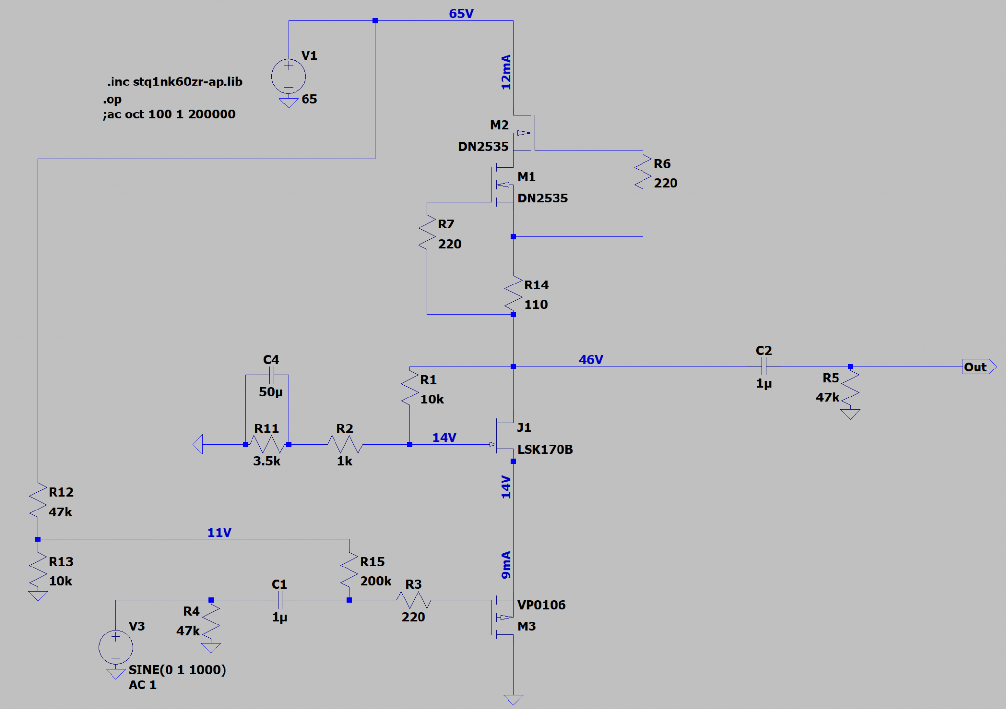

Well, it sounds really good. Currently paired with a VP0106, whose source is at about 15 V and the drain of the lsk170 at 45 V. CCS adjusted for 8-9 mA through the FETs. The feedback network draws an additional 3 mA. Here’s a quick spice DC operating point analysis, which is quite spot on. Compared to the others, the LSK Special sounds blisteringly direct. It reminded me of the B1 pre's sound.
I tried measuring it but it was moving all over the place. My layout is on a breadboard and these are fast parts. Wish I could post the full juicy update, but alas the measurements will have to wait. I’ll draw up a schematic and post here.

Will DN2535 in TO-92 package be adequate since the voltage and current has been reduced in this version?
Yes, in the low current version, TO-92 for the CCS FETs is fine. Mostly, the dissipation will be below 0.5 W. But note the lower supply voltage in the spice schematic above. If you used 100 V or more, then maybe you’ll be on the edge of TO-92.
Look at the LSK189. Digikey has them, but it is a 10 piece minimum order.
Thanks Geroge! That’s a good one! I also found some other JFETs on Mouser that look pretty good. Will grab that one and some others for testing.
Some of the biasing techniques you posted in the Spice schematics earlier are very interesting. I haven’t tried the depletion mode ones yet but that is another round of fun.

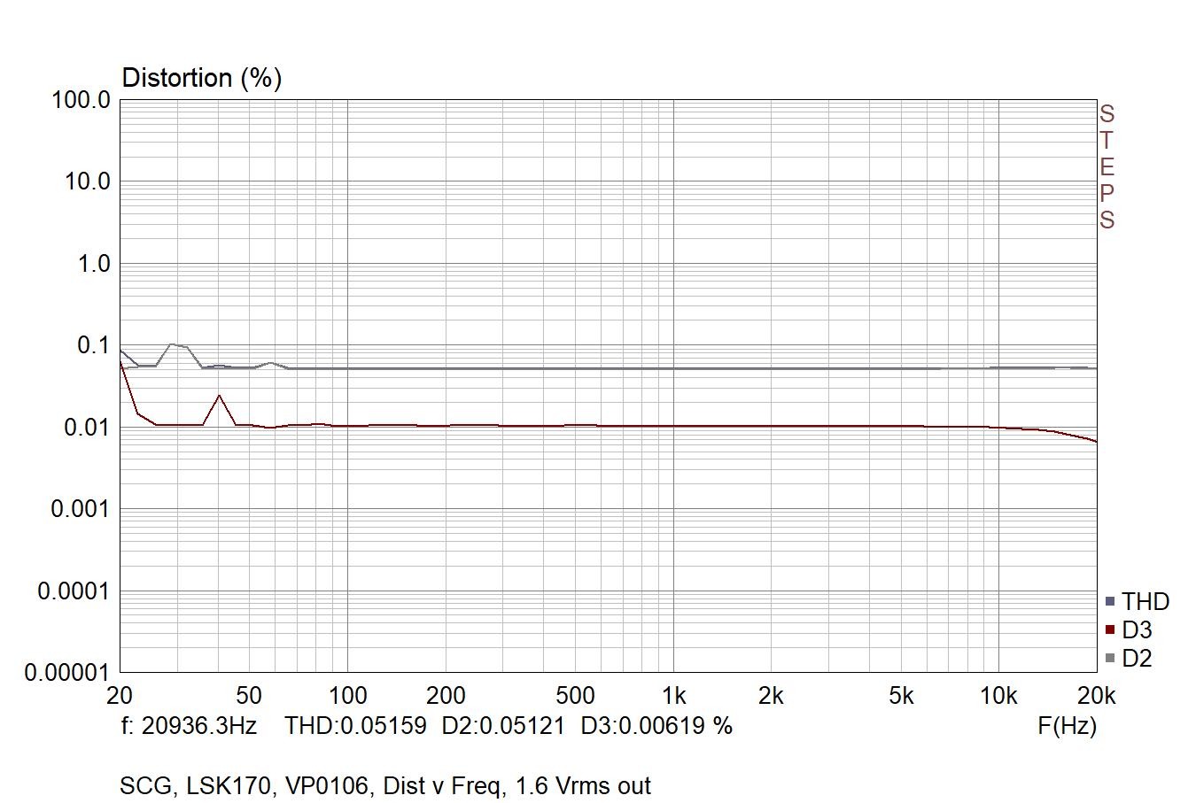

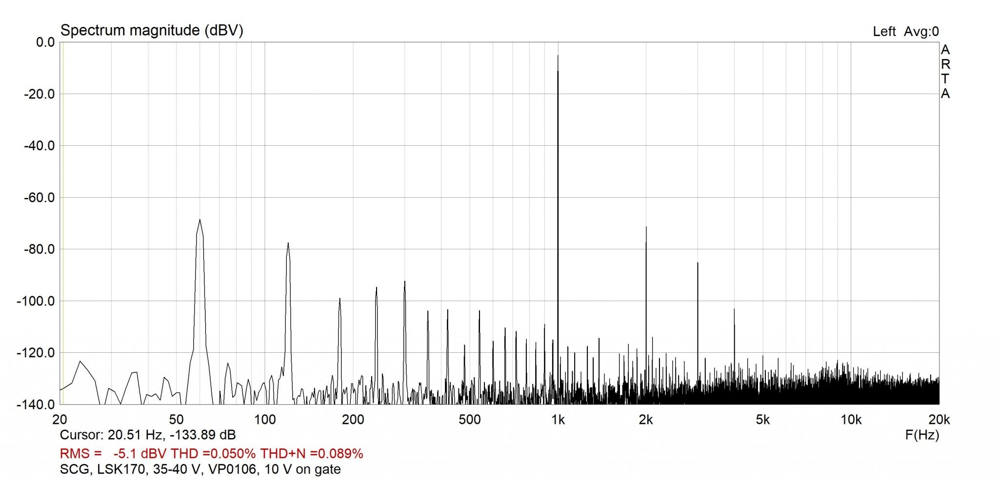

Here's a look at the LSK Special's measurements. All measurements were at 1.6 Vrms output.
1 kHz FFT. Nice spread of 2nd, 3rd, and 4th. Nothing above that. The other channel is a little worse at the same voltage on the drain of the JFET. If I adjust the drain voltage lower, I can get it to match up with this channel, but I wanted at least 25 volts between the drain and source of the JFET.

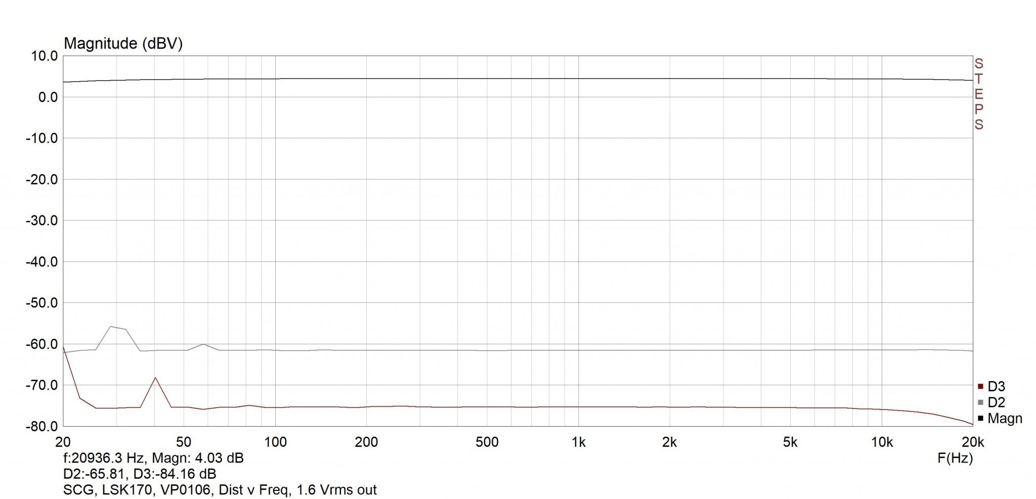

Distortion versus frequency. Nothing to be said here. Ruler flat.
Same graph but with percent distortion.

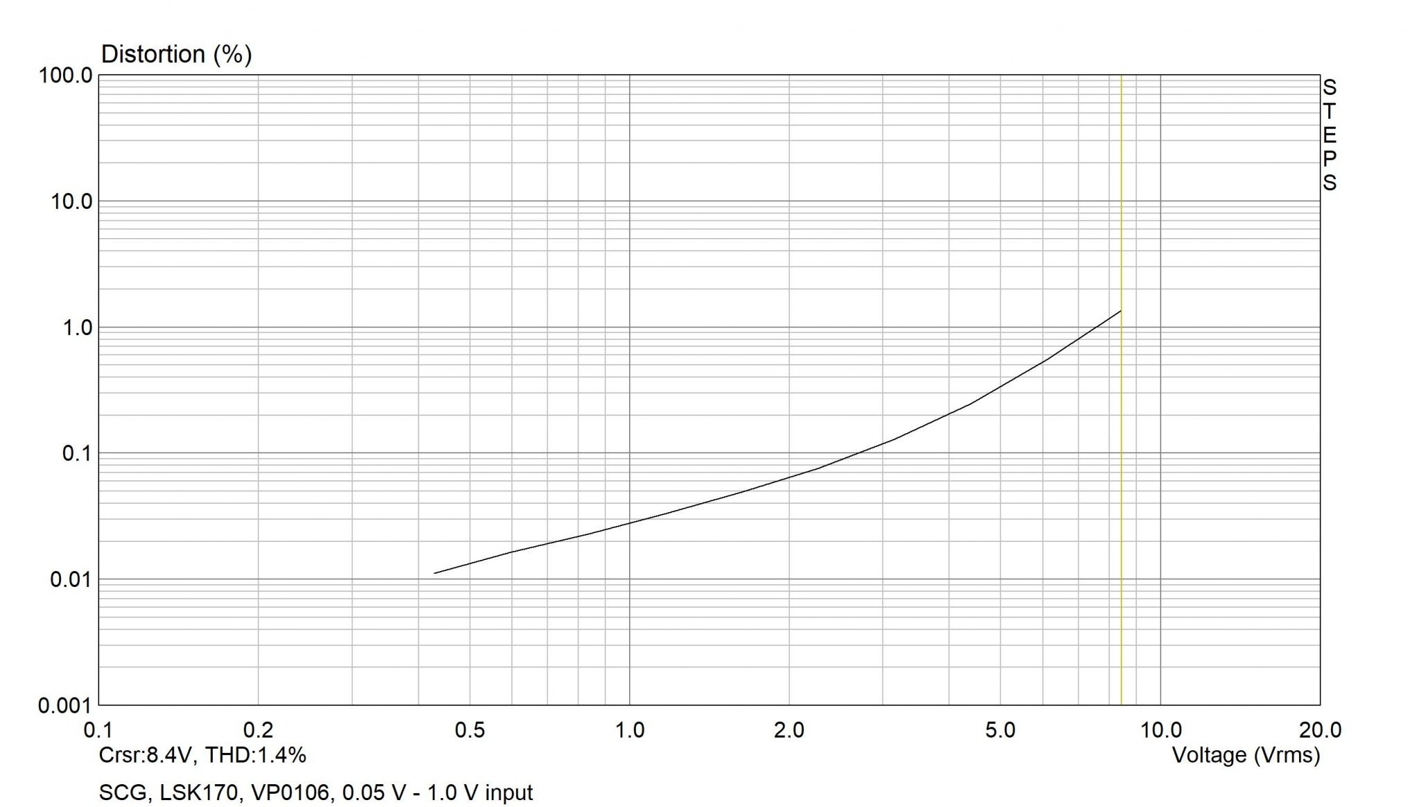

Lastly, distortion v amplitude. It is doing 5 Volts RMS at about 0.5% distortion. The ones with bigger FETs did better than this, but not by much. Though, we are limited by how much voltage we can swing by the device limits.

Oh, one more thing: the instability I encountered earlier was because the gate stopper resistor on the VP0106 was too small. I mistakenly picked up 32R4 instead of 332R. After putting in 332R, the instability was gone as well as the slight buzz that was coming through the speakers.
Note to potential builders: don't undersize the gate stopper.
