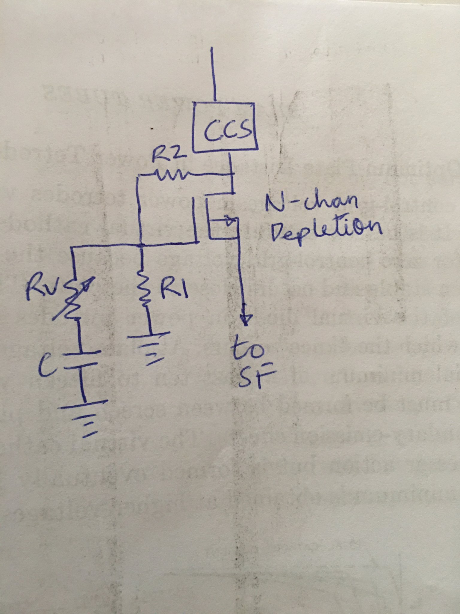

Regarding that last comment about the trimpot: are you proposing using a trimpot instead of the 1k feedback resistor? That would be neat. We could listen to different levels of feedback. Right now, it is at 10% (R2 = 10k, R1 = 1k). It results in pretty vertical, evenly spaced curves.
I did some horsing around with different levels of feedback, trying out 680 and 10k, and 680 and 20k, and still got pretty vertical and evenly spaced curves. But a pot would make this process easier.
In my experiments with a similar design having a vacuum tube pentode in the middle position I also found that 10 to 12% feedback seemed to work best.
The tube pentode functions much like a depletion mode mosfet with a pinchoff voltage in the 20 to 50 volt range. Here I did not need the 100K to B+, so my feedback divider is just two resistors. Changing the feedback ratio affects both AC feedback, and DC bias. In order to make testing a bit easier I set the resistor divider to get me somewhere over 15% feedback, then added a series pot and cap from grid to ground to shunt a variable amount of AC feedback to ground without affecting the DC of the chain.

So, like this:
Could use a depletion mode MOSFET like DN2535 or similar. Maybe save one from the CCS and use it here😉

I have also been experimenting with other FETs in both positions, especially ones with low gate capacitance, and have some promising results.
Yes, that is exactly what I built with a tube in the middle position. A small capacitor across R2 may be needed with a mosfet to compensate for gate capacitance.

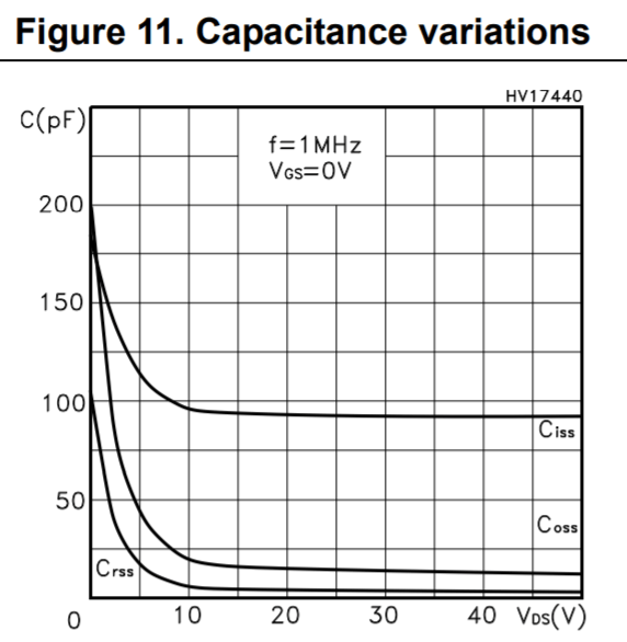

How do I calculate the value of that R2 bypass cap?

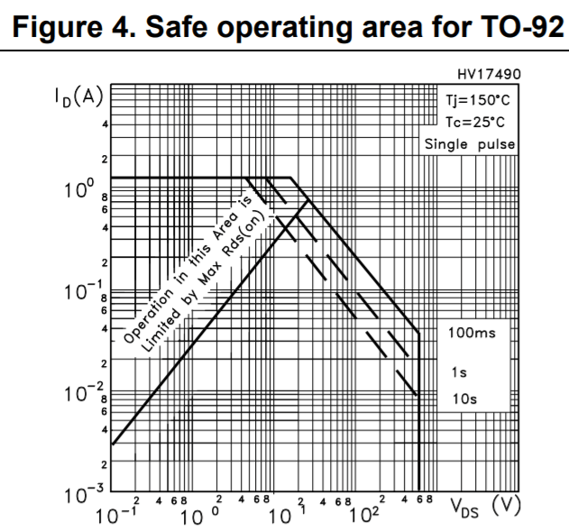

I'm currently trying out the STQ1N60 in the middle position.
https://www.mouser.com/ProductDetail/511-STQ1NK60ZR-AP
I bought it based on its low gate capacitance chart in the datasheet.
They are claiming quite a lot of power for the TO-92 package. Running it at 10 mA and 60 V, which is 0.6 W and even that may be pushing it but it hasn't blown-up yet. Also running a VP0106 in the P-channel position.

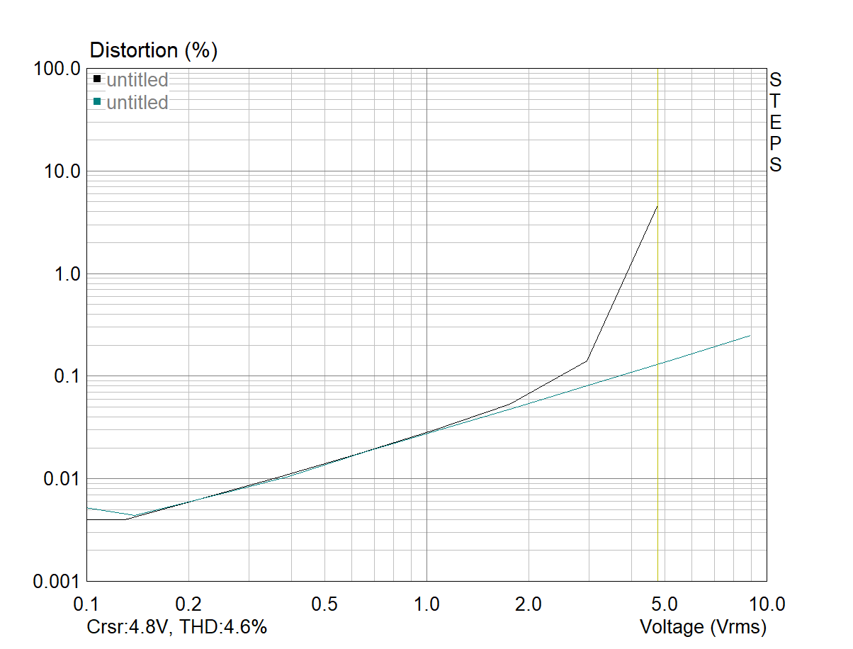

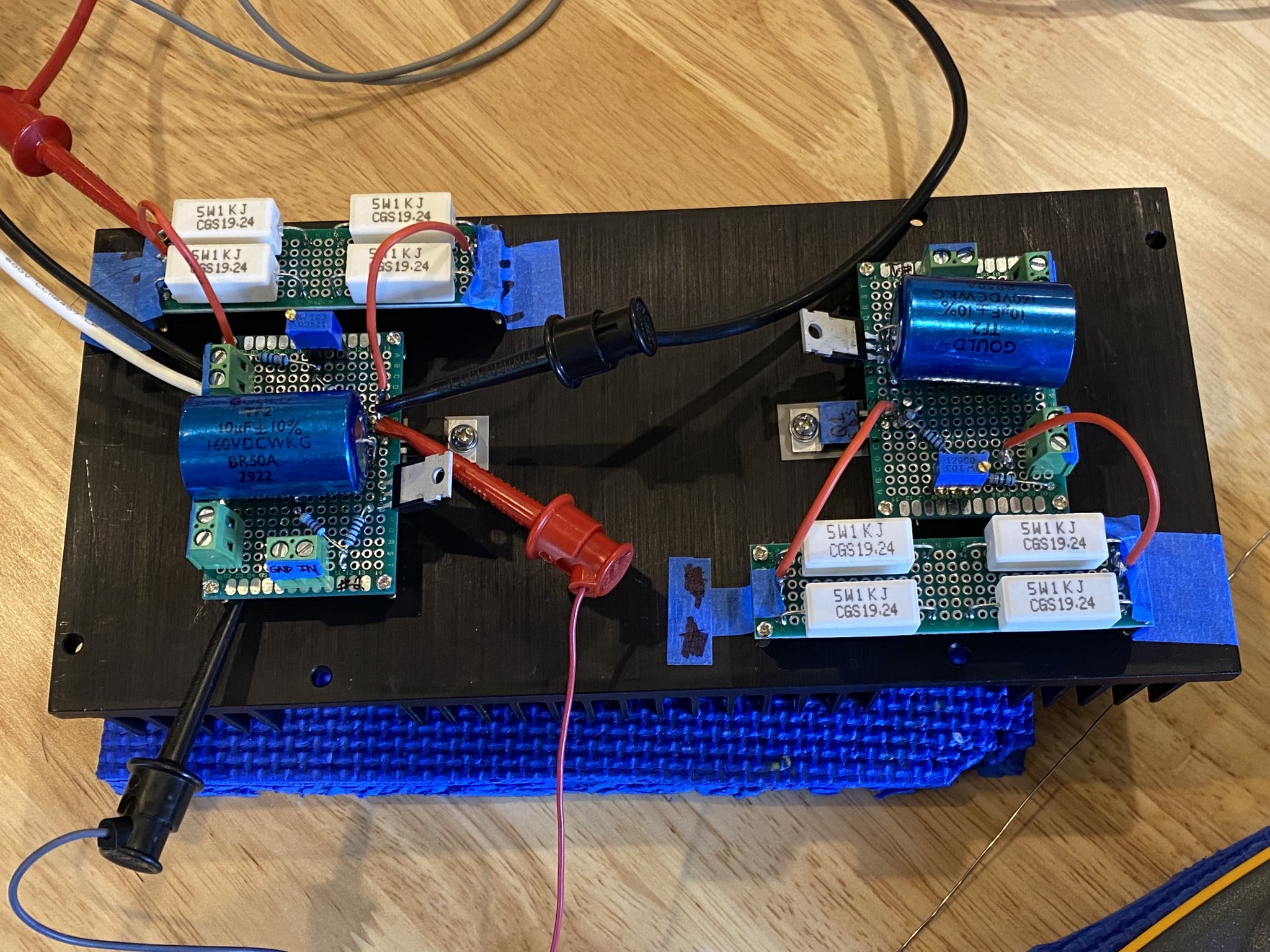

That makes sense. With the STF part above and the gate of the bottom part at 0 V, I am getting about 3V on the source pin of the bottom part. This remains fairly constant as I sweep the drain voltage on the middle part. Still learning how to bias up these different devices.
I am getting clean 25 V peak-to-peak swing in the above setup. That's as high as I can test right now. See chart below. The one that is clipping is a 10Y tube preamp and the reason for clipping is that the gyrator load doesn't have even voltage difference on it (it has about 20 V)--though I haven't tested that theory yet.

The cap value would depend on the gate capacitances of the mosfet which will vary with applied voltage. The reason for the cap across R2 is to compensate for the low pass filter created with R2 and the gate capacitance. I would tend to get the amp working and then look at the high frequency response, or just apply a 5 to 10 KHz square wave to the input and tweak for the best square wave at the output.
I'm currently trying out the STQ1N60 in the middle position. I bought it based on its low gate capacitance chart in the datasheet.

The data sheet isn't clear if 3 watts were on an infinite heat sink what, but with a Rthj-amb of 120 C/W one watt would put the die in the 150C range. The Rthj-lead of 40 C/W might allow two watts or so if the leads were short and went into some serious copper on a PC board. 0.6 W should be OK.

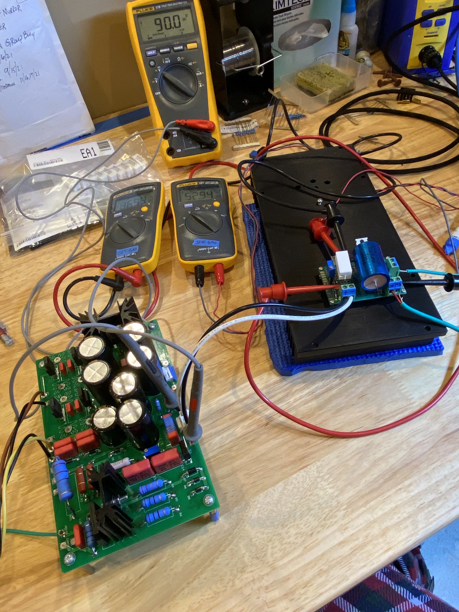

Okay, I will try that. Right now, the one with the STQ and VP0106 parts is sounding really good, matching the 10Y pre, which is no small feat. I really hope Vunce and others report on the sound, otherwise, it's just me tooting my own horn.
With the STQ part in the middle position and about 60 V on the drain and 10 mA, I am getting about 0.05% distortion at about 2 Vrms, which is just right for me. It is heavily 2nd harmonic, with just a teeny bit of 3rd.
Good to know. I am going to put this on a solder breadboard and may try to push more mA through it.

After I'm off this preamp kick, I am going to scale this up and build a power amp version of the preamp. No more unobtanium triodes. :headbash:
Yeah, my momentum stalled a bit while building a HV shunt psu. Had to order caps with correct voltage ratings, should be listening in stereo by the end of the week. In the meantime I'm enjoying your journey 🙂
