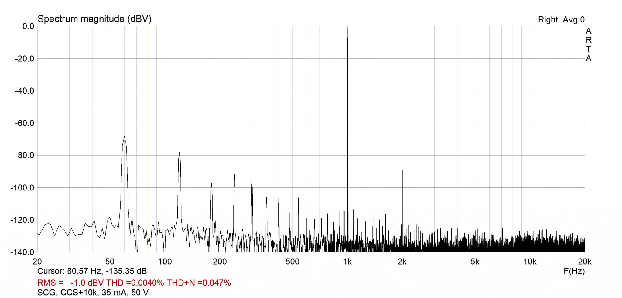

what is the gain of this preamp?
I suppose output impedance is quite high?
Gain is 9 or about 19 db. This is with a 1k load. Others were about the same.
I have not measured or calculated the output impedance yet, but working into a 10k load of the ADC, the output is down -3db at 50k+. So, no problem there.

Here is the CCS loaded version with 10k output resistor. This is great sound. Hmmmm... can I get H2 a little higher without introducing other harmonics?

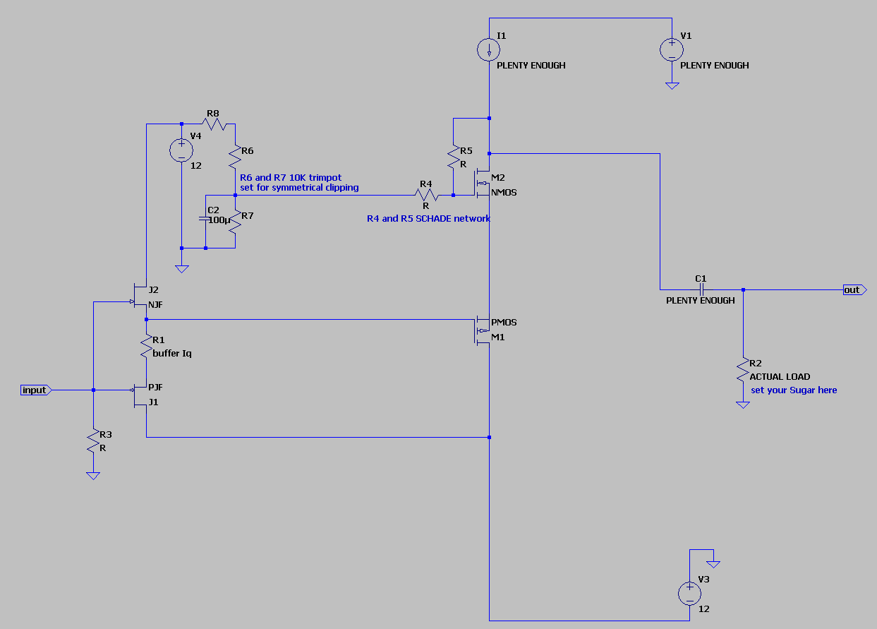

one more thing, interesting to try - you can include nice small JFet buffer in front of input MOS; quite possible that you'll get more resolution
price - you'll need additional neg rail, which can only improve things for input mos, and - with JFets in front, input capacitances should be even easier to deal with

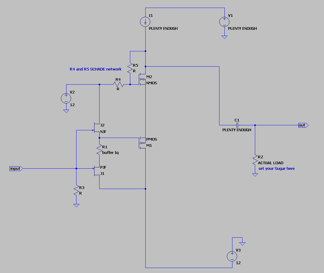

found some time, while finishing morning (noon afternoon) coffee, to make a sketch
edit : few tricks still in the bag, sugar and gain can be altered at least in few ways more, without sacrificing anything in form of dividers
of course, I forgot to draw that trimpot biasing thingie for Schade, was in hurry
will add edited sketch later
edit: added sketch
edit: added sketch
Thanks ZM! That’s a neat idea. I kind of like the simplicity of a single supply… makes me feel like it is analogous to the other great triodes and simple designs 😀
There might be some low input capacitance MOSFETS out there. That is one thing I want to try also. So many options…

now, you probably know that altering Schade resistor values would vary transfer characteristic and, in same time, both THD Spectra and gain
"real load resistor" should dominantly vary THD Spectra, while not so much gain of stage

Thanks Indra and ZM! We want to find an alternate only for the bottom source follower, right? Need a P-channel one there. I’ll check out the options listed here. You guys have given a lot of new ideas to explore! Thank you!
