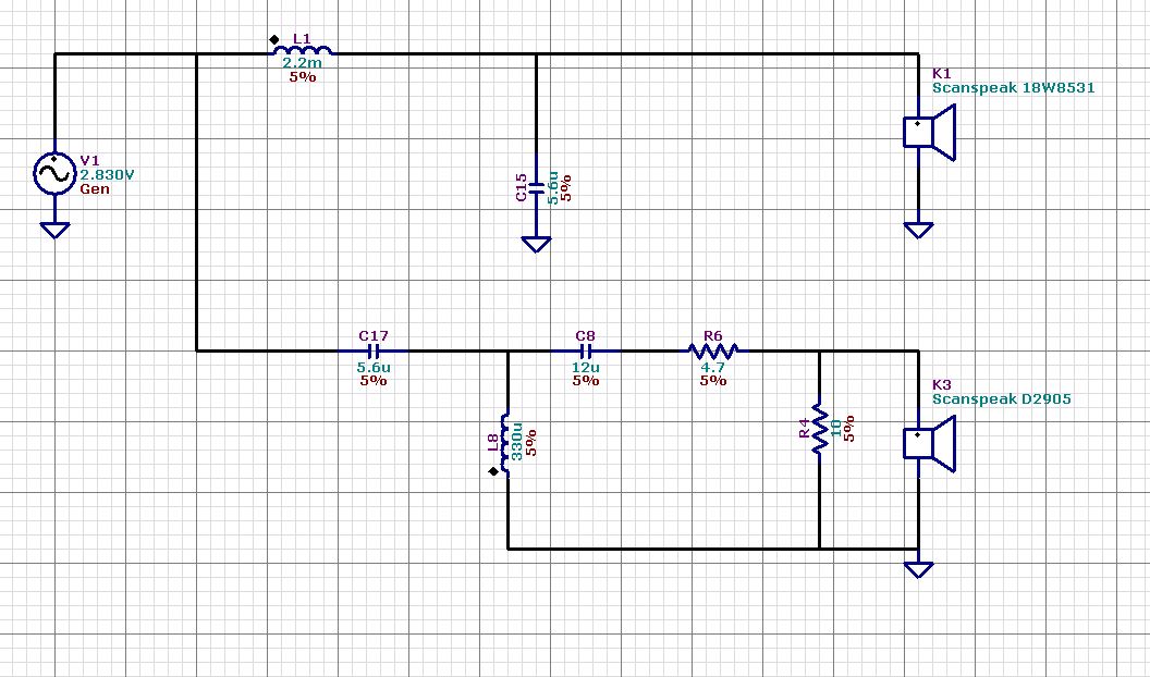

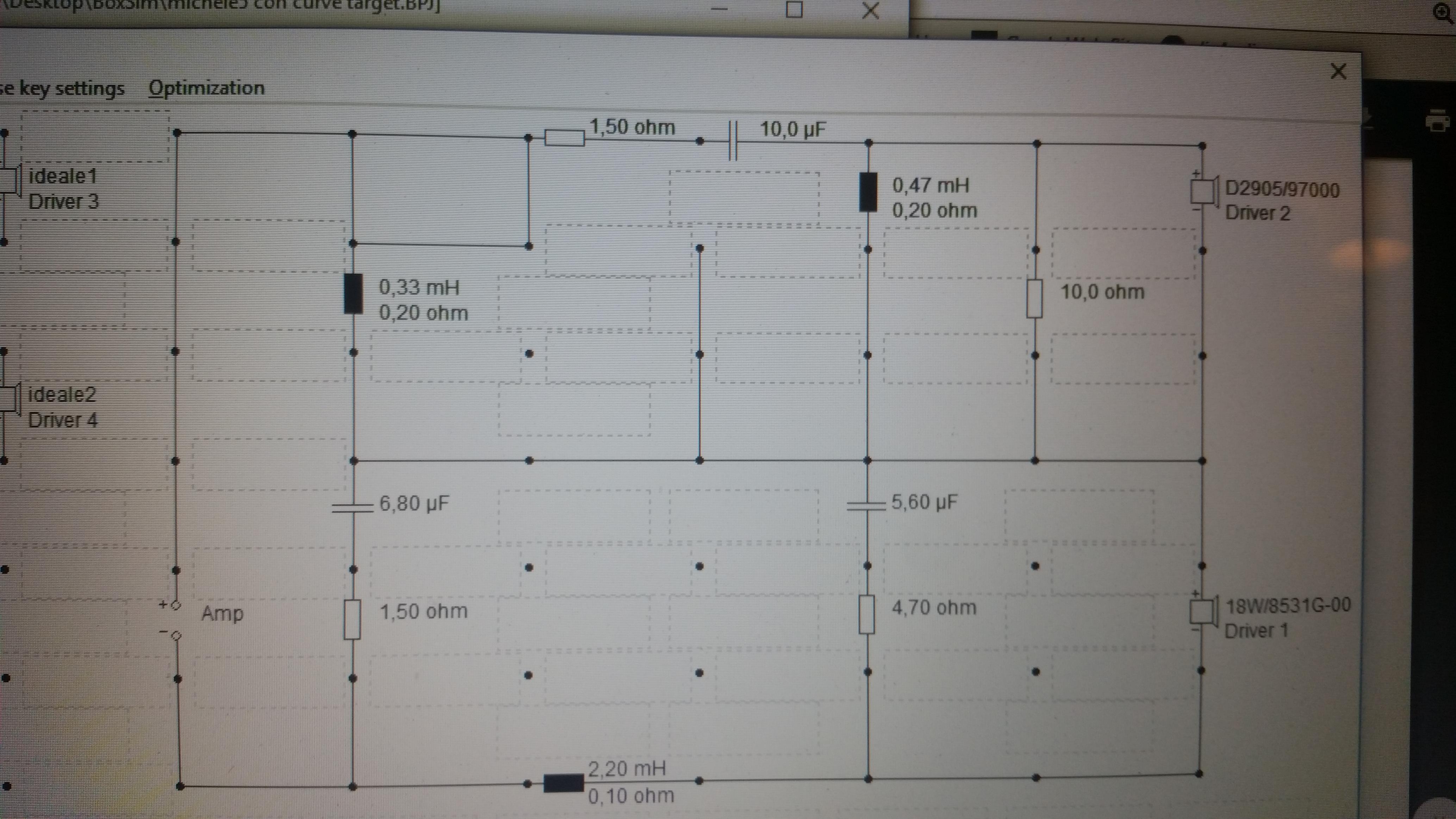

Can you similate the xover in the attachement?

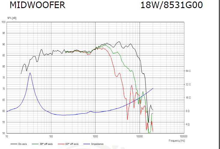

I'm understanding that may be there is an issue with woofer's data on .frd.
I tried to low the level of the tweeter on simulation of 1-2db's 'cause I was thinking about your +2db issue but the tweeter is ok: lowering its level on the simulation file causes the tweeter sounding too low. So I can say the tweeter sim is ok.
The issue may concern the woofer, 'cause in all simulation, using a target LR4 or B3 or anyelse on 85 db, the simulation requires a 1.8-2mH inductor to have a flat response on 85db.
But in reality, the 2.2mH inductor appears too low. So maybe the woofer is sounding louder than we see on the simulation, maybe for the baffle, maybe for the non-uniform and variable driver characteristics. It's well know that scanspeak produces variable parameters driver and whit different T/S from the datasheet. so maybe that the ones misurated by dibirama are quite different from mine.
At the end of the story, I think we should find a more reliable .frd file for 18w or trying to lower its level of about 1-2db in the simulation because after more than 20 xover tried, I'm understanding that the woofer plays too loud, the woofer is always over the the tweeter. with 2.7 inductor it goes on places but this need to perform a total re-adjustement of the entire crossover.
We finally get there 🙂 Ask Troels if he would be willing to share his .frd of the 18W on the SP95 baffle. I would completely understand him if he says no or doesn`t reply, but he is a nice chap so I think its worth a try. The other way around (the right one) would be you investing some extra cash into a measurement rig. Once done, you can sell it in the swap meet and reduce the money spent.

ANYWAY, I found these files for 18w8531 that are traced by the zaph page by someone.
I think they are very right because of the rising response from 400 to 1500hz not visible on the previous file.
so Paul, i invite you to simulate with this file, maybe we have found the issue!

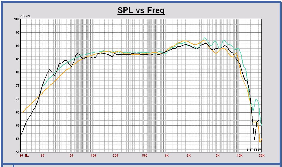

Look to the differences of the 18W8531 infinite responses of the Scanspeak specification , Zaph and Dibirama. They are not so much different. It has no sense to do simualtions again with the Zaph curves.
Maybe more differences can be expected with the tweeter.
You have to get your measurements Cucicu in some way. I think we have done our best to do without but it is mission impossible. I have done it against my preferred WOW.
Or maybe the midwoofer is not good enough for your level speaker. Troels' comments on its SP95 are also not so good.
black: Scanspeak specifcation
green: Dibirama
yellow: Zaph

The Zaph frd is an infinite baffle response, I am very sure of that. It maps perfect on Dibirama and specification, look to my last posted plot.

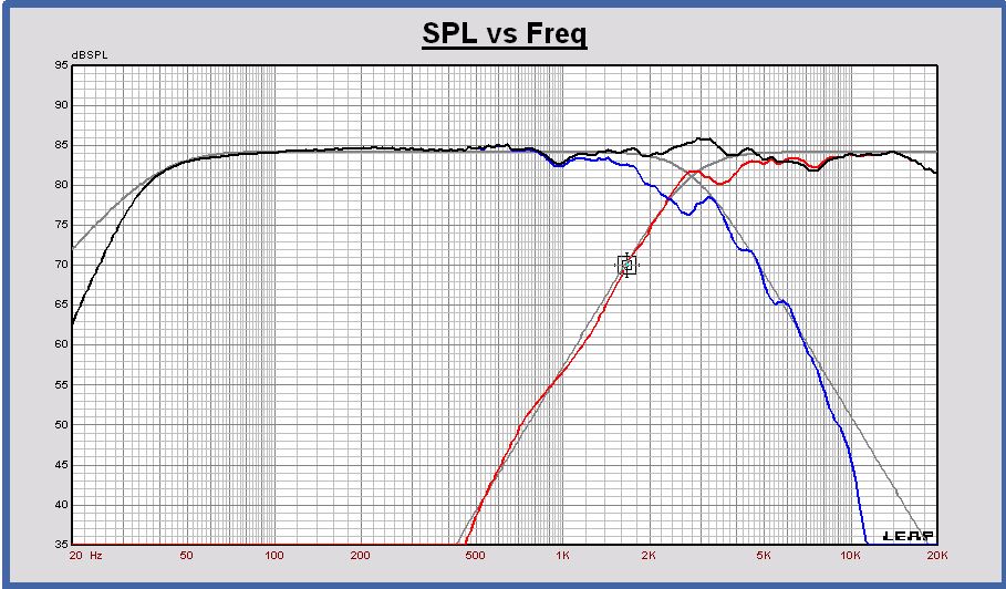

Hi Cucicu,

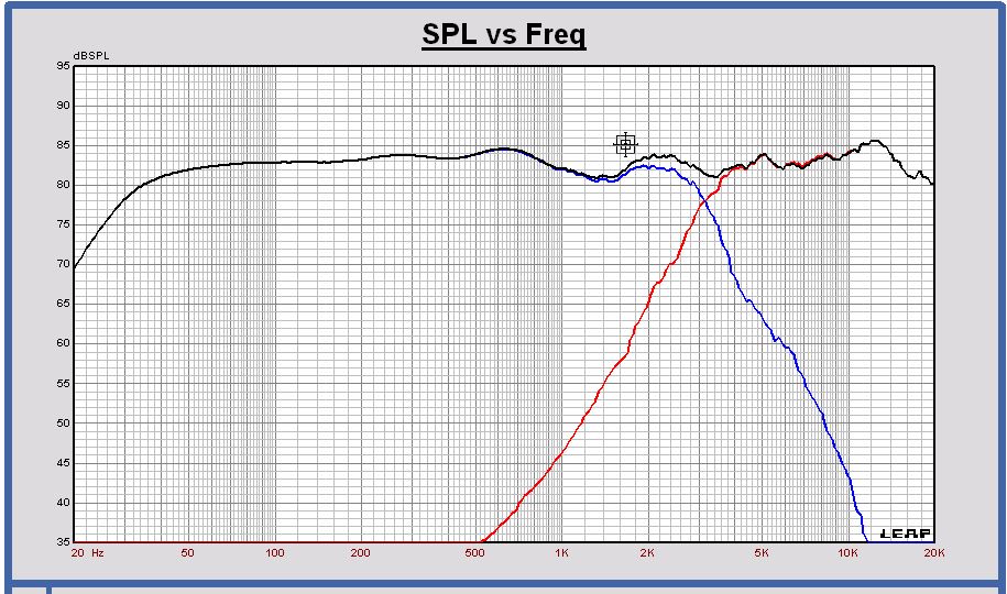

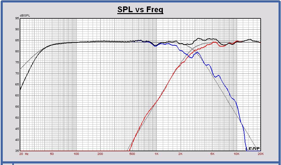

These are the results with the dibirama frd's
Schematic filter23 Proposal Cucicu

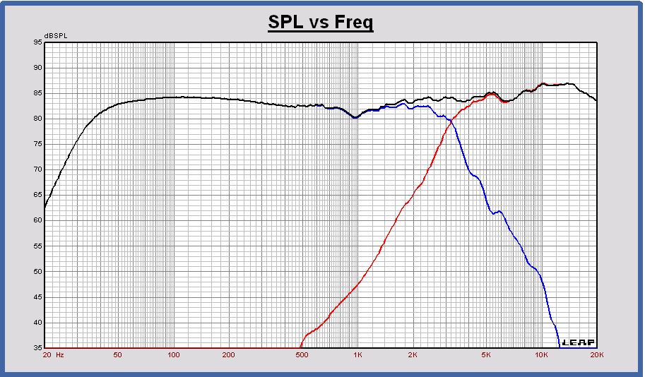

SPL filter23 Proposal Cucicu dibirama frd's

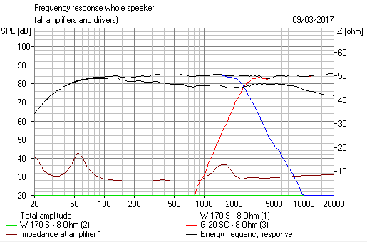

This is not really flat with the dibirama frd's but its sound is good you say.
So I think you have the non ferro fluid tweeter and secondly the baffle response has more boost.
Look to the simulation results of my own Leap frd's with non ferro fluid tweeter (specification Scanspeak) and using the Leap diffraction calculator. It is much more flat using these frd's now.
But for the same money I am completely wrong 🙂
SPL filter23 proposal Cucicu Leap frd's

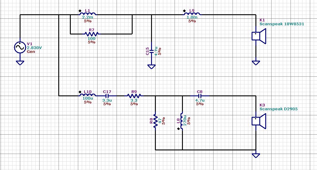

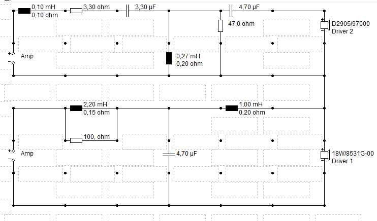

I ll post later but i can say that zaph frd and zma are the most correct. The filter i posted is made working on dibiramas files an it appeared good on sim. Also listening was very good and quiet, always better than the previous ones. But there was a lacking on the highs that I cannot explain by sim.
When i charged zaph files, same crossover, a 3db dip between 3khz and 4khz appeared. So now i am trying to adjust it but this is the way Paul. No overlapping, no paperish sound, very clean highs ( tweeter cut at 3200hz).
I lowered the 1 mh inductor drastically to 0.20mh and pumped the 4.7uf cap in woofer to 6.8uf. Now it is better, no dips at listening, no flat lines on the sim but is ok.
I think the last issue is to play with the 1mh inductor and the cap on the woofer that are very critical cause arr linked to a more/less presence of the mid range. Very critical and very audible. Now with 0.20mh and 6.8uf there is more cleareness on midrange but maybe it is too much. Make your proposal that we are on goal!!!!

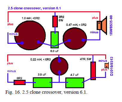

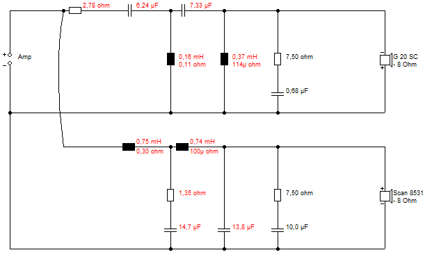

I don't think you are going to do this with low order filters. 😱
The rising response above 800Hz seems to dog all the Scanspeak 6" drivers.
What I did find is some impedance correction always helps. I used 7.5R and 10uF. That helped Troels' Proac 2.5 design a lot too.
But only a 4th order on both drivers could correct the response adequately. I actually used your ZMA and FRD files provided earlier.

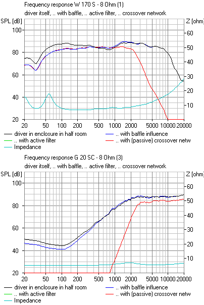

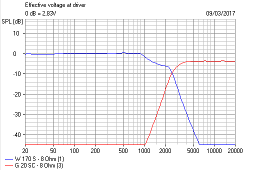

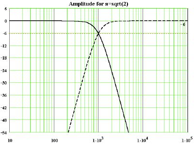

I'm actually not very bothered what the tweeter is, but used a 88dB G20SC to match yours. The woofer is a scanspeak 8531, because I used your ZMA and FRD files with a bit of fudging. The response seems to match the scanspeak data anyway. Time alignment was a bit guesstimate with your files. I could be wildly wrong on that. 😱
The theory says, once you get a LR4 curve on one driver, you just have to adjust the other driver filter for a matching LR4 result. And 4th order filters totally dominate individual tweeter response. The circuit is just what Boxsim optimiser came up with. It needs tidying up, but the 1.35R is a very critical component that works best when bigger IMO, because the impedance bump is ugly.
