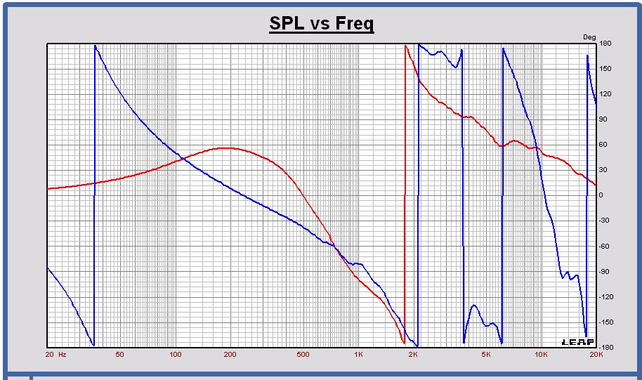

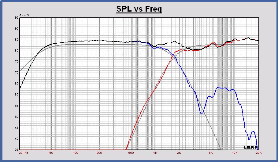

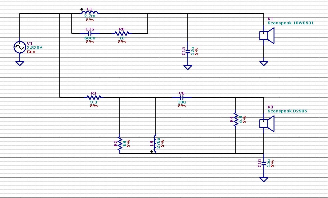

I have simulated again filter17 based now on dibirama infinite baffle responses.
I have created new Leap infinite baffle models based on dibirama.
To create the woofer in enclosure frd I have used Bagby diffraction calculator.
For the tweeter in enclosure frd I have used the Leap diffraction calculator. For the tweeter baffle response Leap and Bagby map perfectly on each other.

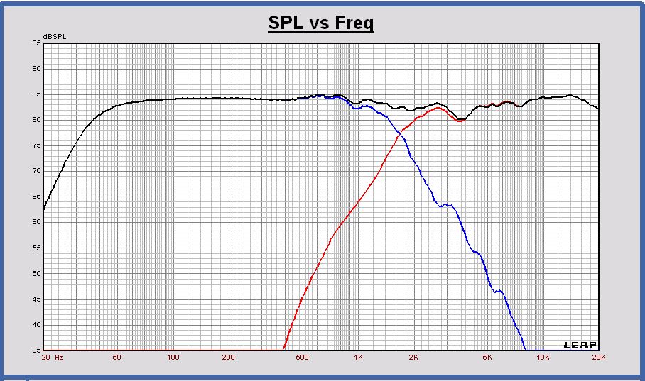

These are the results now for filter 17.
Schematic filter 17 with resistor R6 added
SPL filter 17 with resistor R6 added @ diBirama frd
Phase filter 17 with resistor R6 added @ diBirama frd
Woofer is 20 mm behind tweeter in this simulation.
Woofer response looks good. Technically the tweeter response can be better IMO. I will try to improve. If it will sound better then??

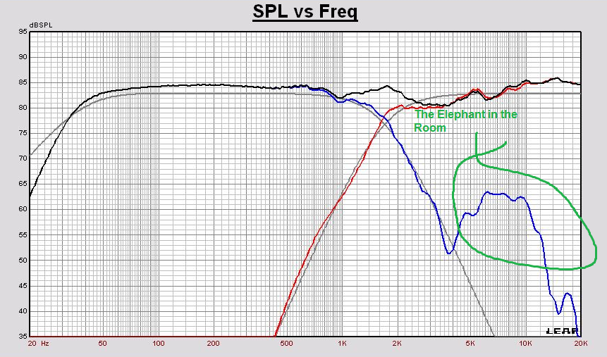

Paul, I don't deny you best intentions here. You try to help.
But how can you, along with your target curves of LR2, BW3 and LR4, ignore the elephant in the room? 😀
TBH, a 4th order crossover would make more sense. 😎

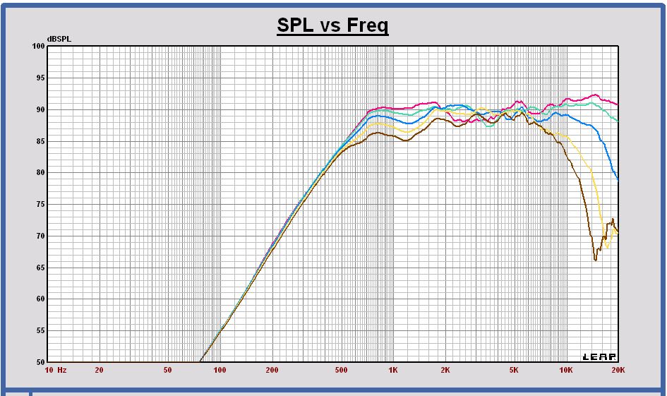

This is the tweeter off axis response to show that only optimizing tweeter response on axis is not good.
Cucicu, how is the set up of your stereo speaker set.
In the left speaker, is the tweeter at the left side of the front baffle?
In most cases I optimize the 15 degree response.
SPL tweeter in enclosure 0 15 30 45 60 degrees horizontal

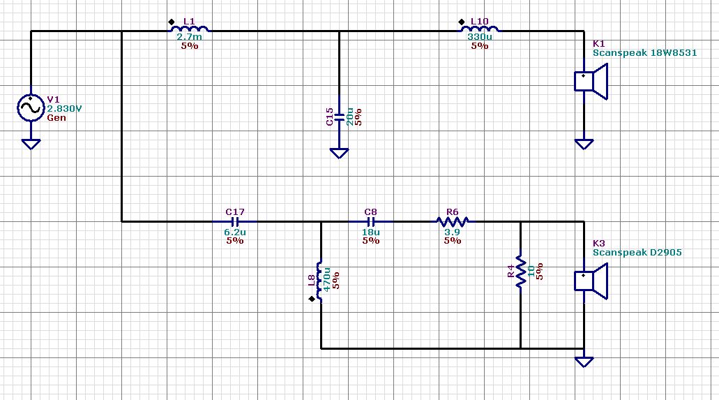

Regarding the woofer, I can say it sounds and looks better at sim with 3rd order filter 2.2mh/6.8ohm-1R/0.20mh.
Maybe we should go for a B3 arrangement trying to make the phase better. It s my opinion because this way we dont have any elephant in the room

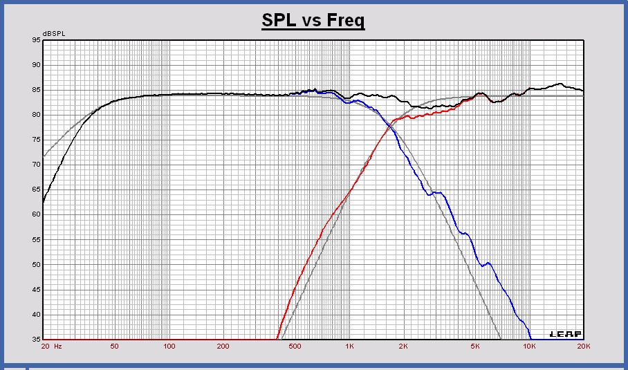

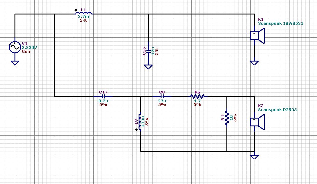

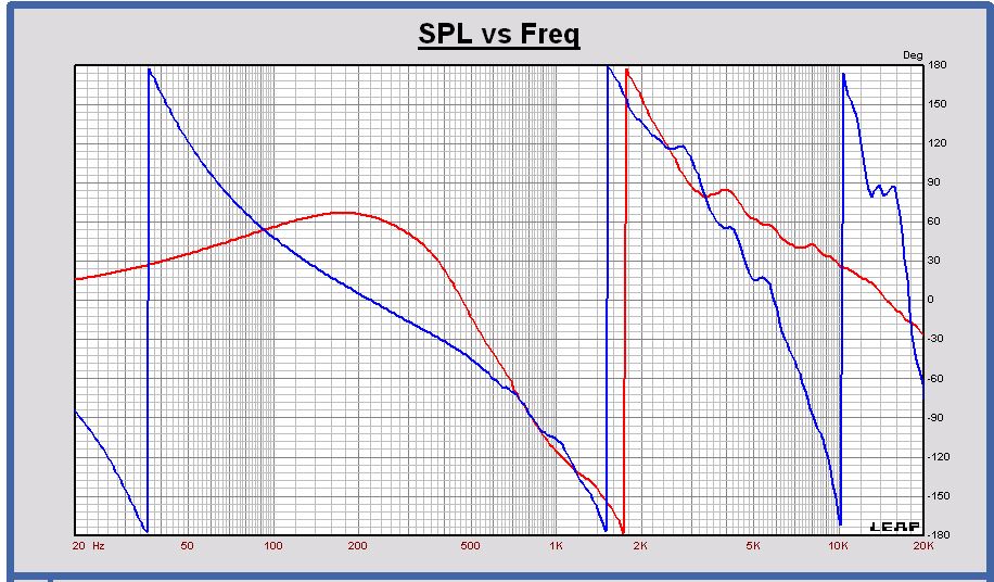

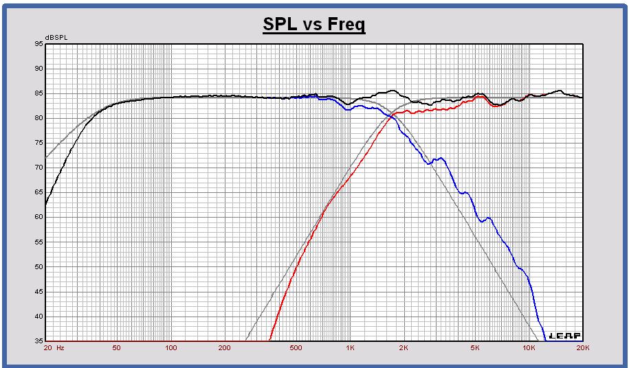

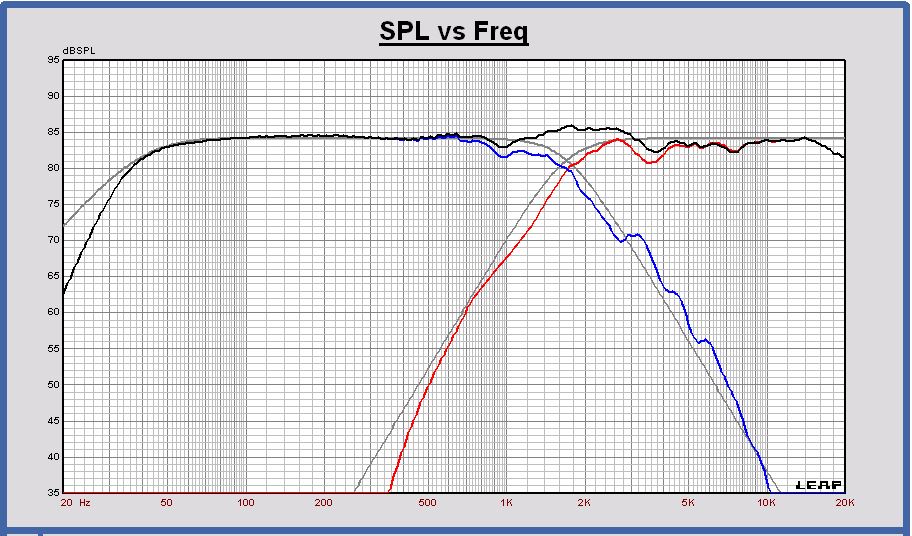

This is the best LR4 I can make at this moment.
Looking both to 0degree and 15 degree SPL responses and phase aligning. And making the schematic not too complex.
It is not the best enclosure to make a good on and off axis response.
Schematic filter19 LR4 1700
SPL 0 degree filter19 LR4 1700
SPL 15 degree H filter19 LR4 1700
Phase filter19 LR4 1700
Paul, I didn`t see the polarity was reversed at the speaker units, only looked at the source, sorry. The dbirama files do create a very flat response in my XSim.
Do a 2.8Khz and you`d get the Klingon Bird of Prey dispersion characteristic (sonogram). Very undesirable 🙂
Is there a 0.33uf in series with the woofer?
A coil of 0.33mH/0.3Ohm yes. The combination of that coil with the increase of capacitor C15 to 20uF realizes a better map on target for the woofer.
It can be critical, I know, but it better reduces the break up region of the woofer. Maybe try and listen.
No paul. It is not good.
