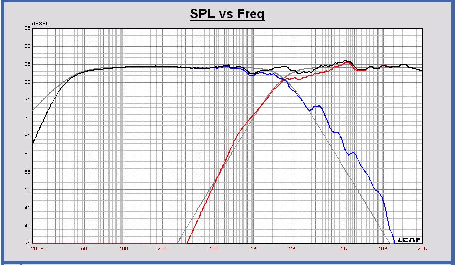

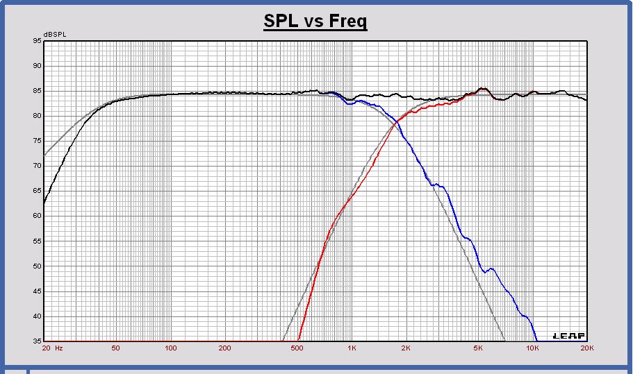

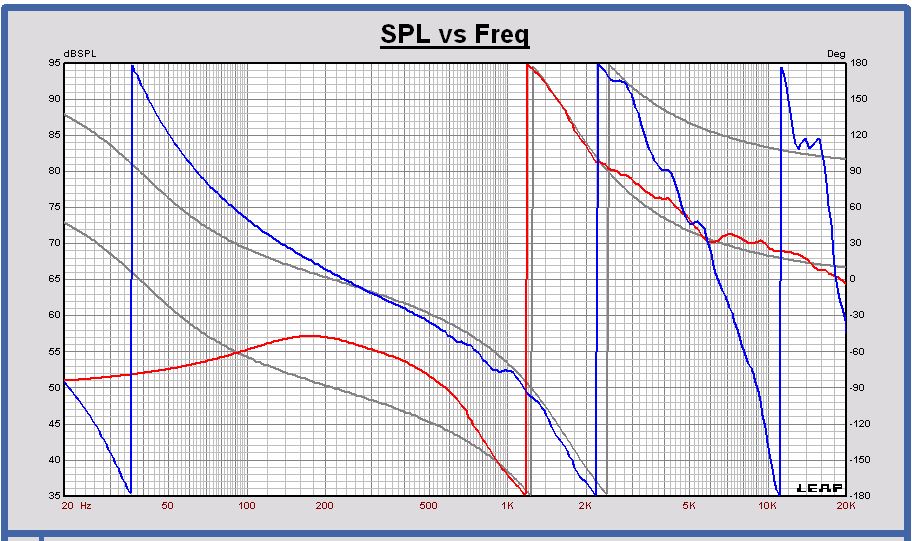

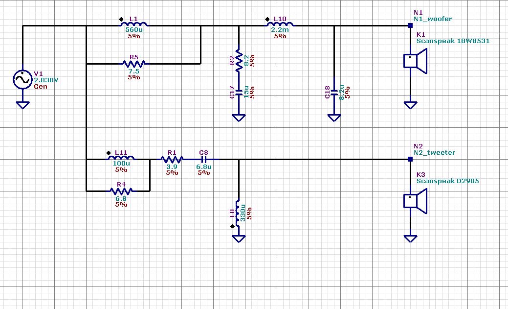

It will not make many sense if you choose now 1700Hz or 2000Hz at this moment. The point is you have to come to that reference filter based on your own exact measurements. But ok i have made a 1700Hz version, the power response is a little more flat, but this is my last one at this time 🙂.
Such kind of filter should sound ok. In case it is bad, i mean not balanced with too much high or low, then there is something wrong, that means still an acoustic problem or a big deviation of your drivers from specification.

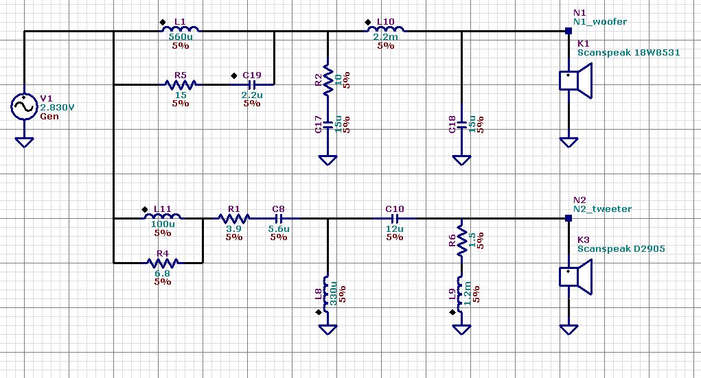

Did you try already filter37?
Schematic filter38
SPL filter38 LR4 1700Hz
Phase filter38 LR4 1700Hz

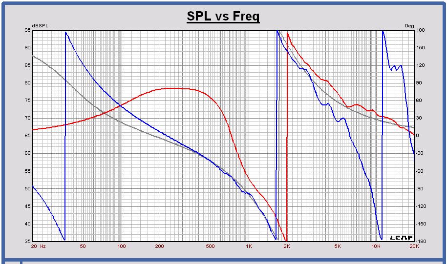

It can only be flat when the system is perfectly minimum phase, and that isn't the case. So you have to look to the phase also. The woofer is non-minimum phase outband, also due to the z-offset. The tweeter phase is leading to 90 degree at its resonance frequency of about 500Hz. You have to optimize for the best behaviour. I have done so for filter 39.
this is measurement of your filter39 B3 1700Hz
it matches perfectly with the sim. minor bump at 1800hz, minor dip between 2khz and 3khz.
this is more lively than previous. both are good. this 39 is more medious because of the bump on 1.8khz. if it is possible to lower it, I think this should be very fine.
You can decrease C8 in the tweeter filter with small steps ... 6.2u ... 5.6u
In case it is a woofer issue you can increase R2 in woofer filter to 9.1E ... 10E
Or do both. You have to listen. With these modifications you stay close to target.

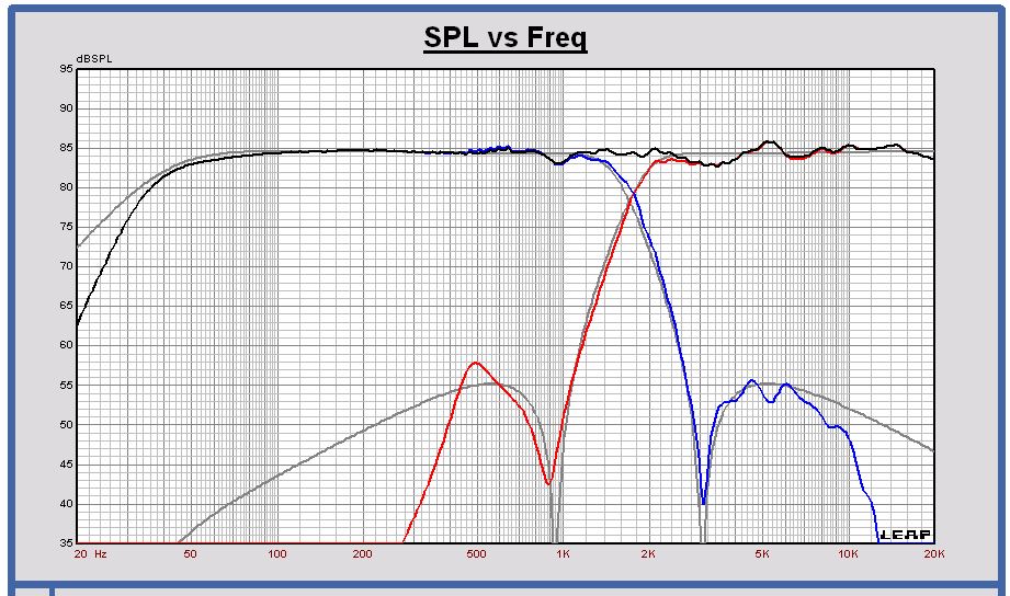

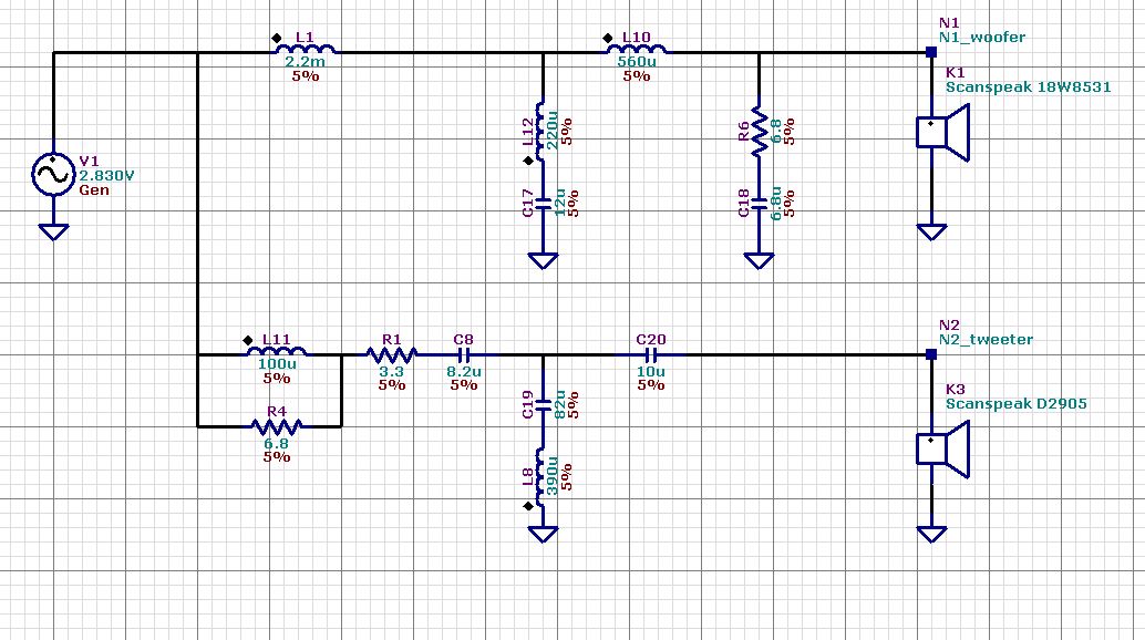

Ok Cucicu, here it is, elliptical 3rd order filter at 1700Hz. I am very curious for your findings 🙂.
IMO the sound has the qualities of both LR4 and B3, but it is playing even more fascinating, it's music. That is the experience of my realized elliptical systems up till now.
You can tune the high filter by changing R1 a little. 3.0E 3.6E 3.9E are also good values. Because we don't have your tweeter measurements
Schematic filter40 EL3 1700Hz
SPL filter40 EL3 1700Hz dibirama frd's

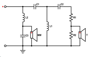

Hi.
I built these loudspeakers with this crossover. Maybe someone can find the scheme I used useful. 😉
(PDF) Cajas acusticas Scan-Speak Kilimanjaro | Jesus Losada - Academia.edu
T: Tweeter Scan-Speak D2905/970000, normal polarity.
MW: Midwoofer Scan-Speak 18W/8531G00, normal polarity.
C1: Capacitor SCR-Audio PB820, MKP, 8,2 µF, 400 V.
C2: Capacitor SCR-Audio PB2200, MKP, 22 µF, 400 V.
C3: Capacitor SCR-Audio PB2200, MKP, 22 µF, 400 V.
L1: Coil Mundorf Mcoil L140, 0,27 mH, 0,13 Ω, Ø 1,4 mm, air core.
L2: Coil Mundorf Mcoil L140, 1,50 mH, 0,38 Ω, Ø 1,4 mm, air core.
R1: Resistor Mundorf MR10, MOX, 2,2 Ω, 10 W.
R2: Resistor Mundorf MR10, MOX, 10 Ω, 10 W.
Internal wiring: Sommer Cable SC-Nyfaz, 2 x 4,0 mm2.
