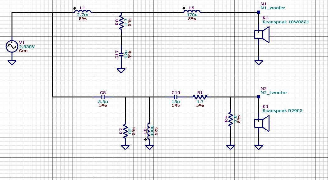

Curiosity, would you simulate 2.7mh/12uf-4.7ohm to ground/0.47mh? Dcr of inductor is very low
0.11ohm for 2.7mh and 0.19 ohm for 0.47mh

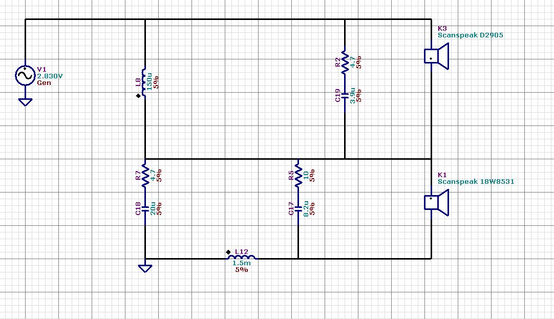

Paul, last thing I ask you, here rabbitz posted this series crossover. If you coul simulate, it will be great. He says it is a great speaker that way. Could you?

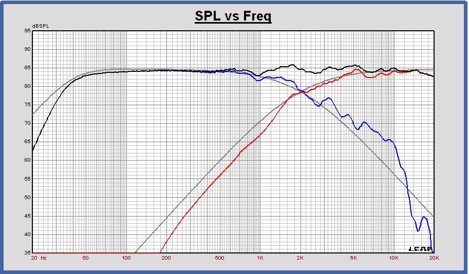

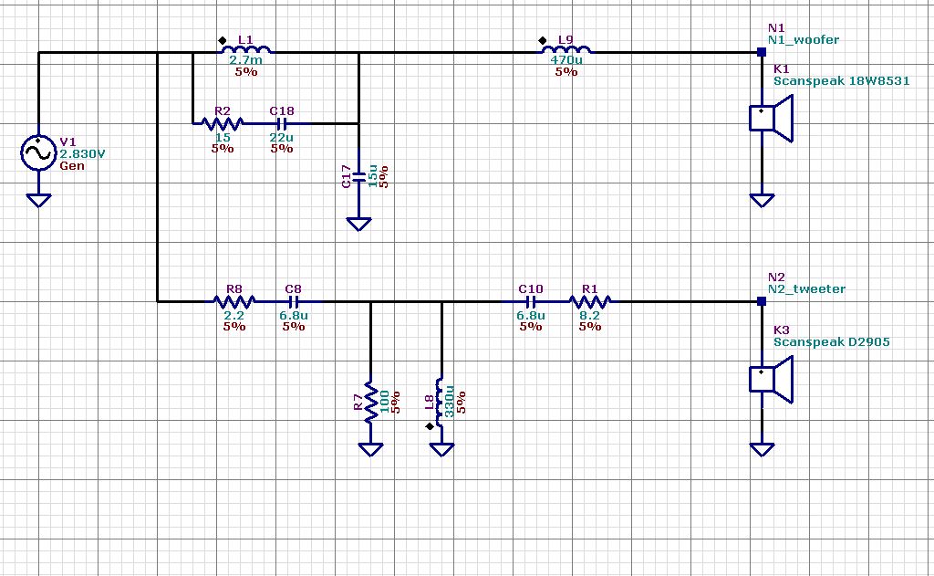

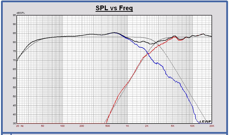

Cucicu,
It is a LR2 at 2000Hz, well behaving around the crossover point, good phase aligning too. But boost around 700-800Hz with both the dibirama as the Leap frd's. My first impression, it looks like that the baffle boost around 800Hz is not taken into account.
Schematic filter29 Rabbitz LR2 2000Hz
SPL filter29 Rabbitz LR2 2000Hz Leap woofer frd and dibirama tweeter frd
SPL filter29 Rabbitz LR2 2000Hz all dibirama frd
Do you think the baffle boost is adjustable?
Not so difficult and two components can be deleted.
Phase aligning is ok for woofer and tweeter aligned. With woofer 20mm behind, the SPL and phase aligning are a little worse, but ok.
Optimized with dibirama frd's.

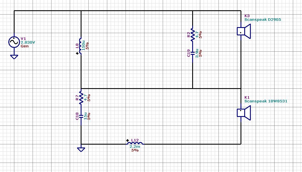

Schematic filter 30 serial LR2 2000
SPL filter 30 serial LR2 2000 all dibirama frd
For the best result with woofer Leap frd, L12 has to be increased to 3.3mH, but the response is not so good on target.
SPL filter 30 serial LR2 2000 Leap woofer frd and dibirama tweeter frd

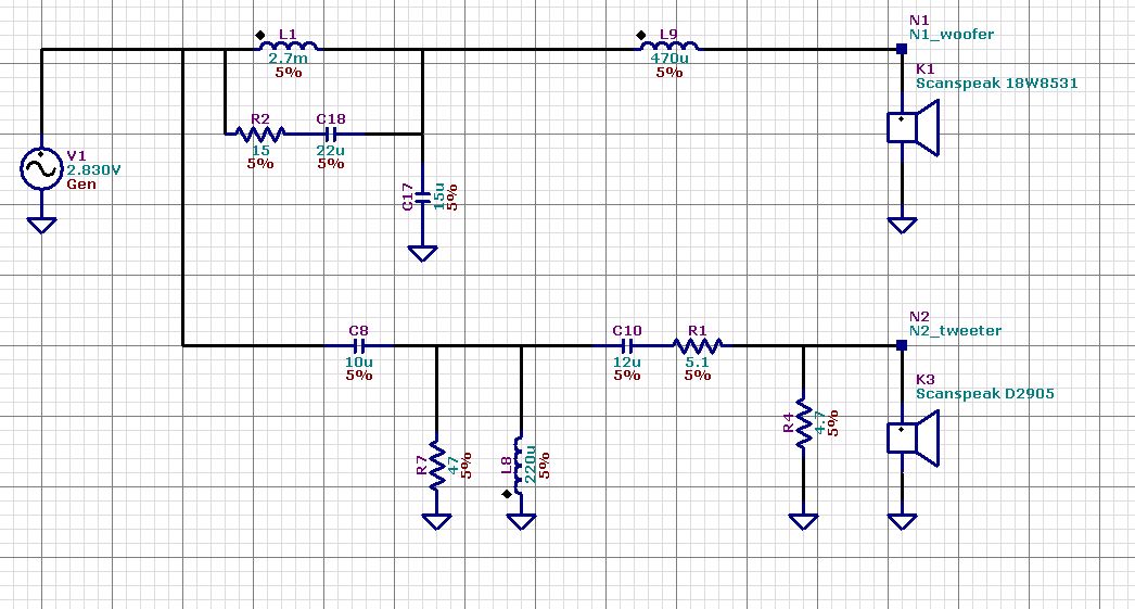

if you put a coil of ca. 0.10mh in series at tweeter, before the first resistence of 3.3ohm, frequencies from 4 to 8khz rise of 1-1.5db but the FR drops of 5-6db's after 10khz.

Without looking to the SPL try this filter. It is your last schematic but tweeter filter modified in a certain way. But first listen and tell me what the difference is, if it goes the good or bad way for that tweeter. After listening you can simulate the response of course. But listen first otherwise you are already brainwashed 🙂. It is a kind of blind test.

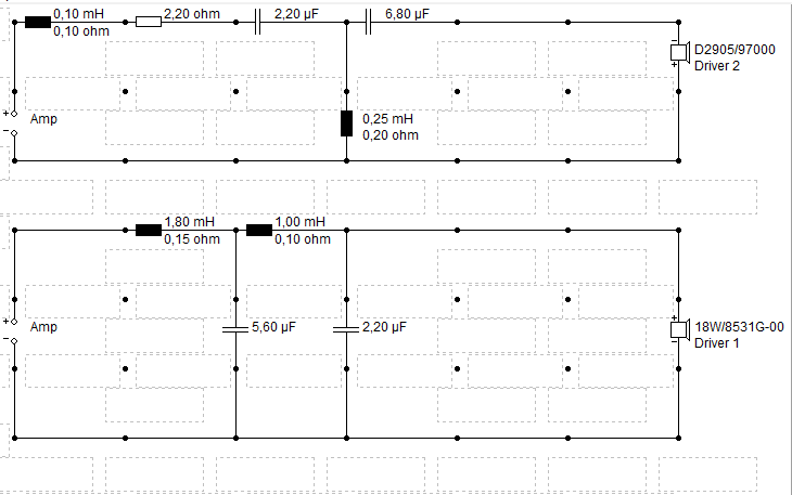

I had an issue with tweeter level. Finally I manged to allign woofer . Could you simulate this? Now it s good but at fft measurement I have a bump on 4khz-10khz and can t understand if it is a mic issue or the reality.
Xover is (sorry i cant attach images at the moment):
Woofer 4rth order: 2.7mh with 47ohm in parallel/4.7uf to gnd/ 2.2 mh/6.8uf to gnd
Tweeter: 0.10mh-5.1ohm-3.3uf/0.25mh to gnd-6.8uf.
This config is alligned and no more woofer issues but maybe there is a phase problem in the crossing point with tweeter. Thank you
