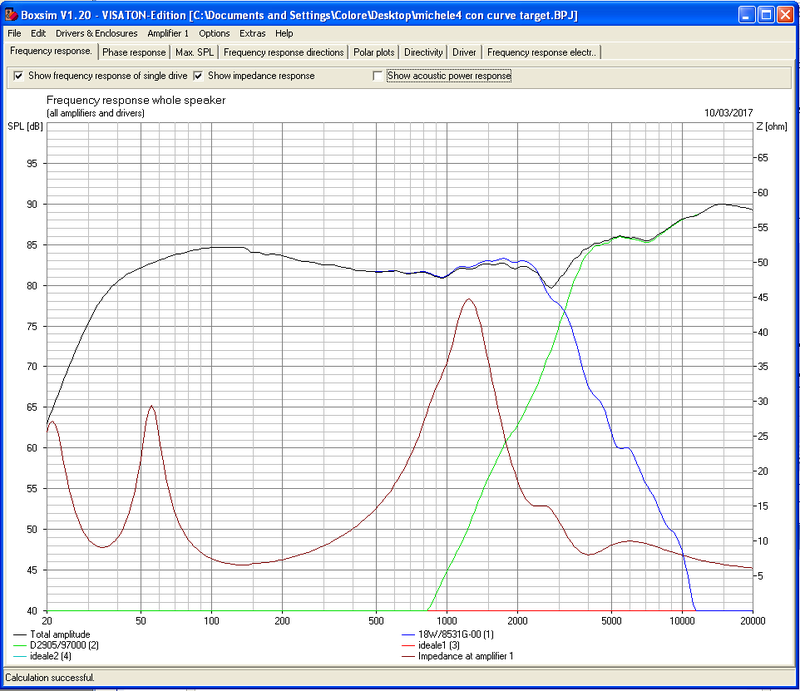

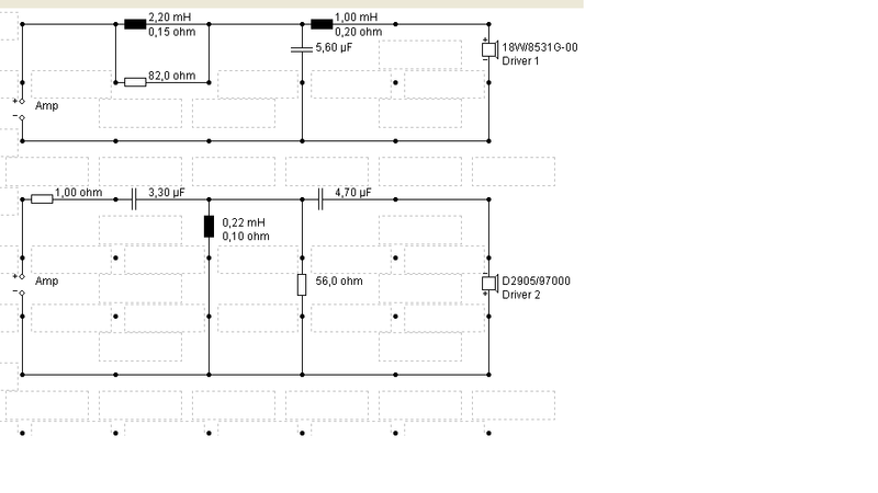

I have simulated your crossover and this is the result with dibirama's files:
here we are. No baffle step compensation. This is why I can't understand what you wanna say 🙂

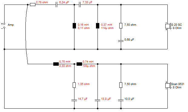

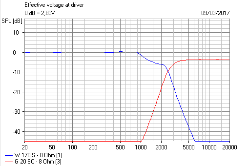

I'm actually not very bothered what the tweeter is, but used a 88dB G20SC to match yours. The woofer is a scanspeak 8531, because I used your ZMA and FRD files with a bit of fudging. The response seems to match the scanspeak data anyway. Time alignment was a bit guesstimate with your files. I could be wildly wrong on that. 😱
The theory says, once you get a LR4 curve on one driver, you just have to adjust the other driver filter for a matching LR4 result. And 4th order filters totally dominate individual tweeter response. The circuit is just what Boxsim optimiser came up with. It needs tidying up, but the 1.35R is a very critical component that works best when bigger IMO, because the impedance bump is ugly.

It wasn't my intention to suggest a filter. Just that 4th order seems to solve the problems here. I was scratching my head why there was no bafflestep:

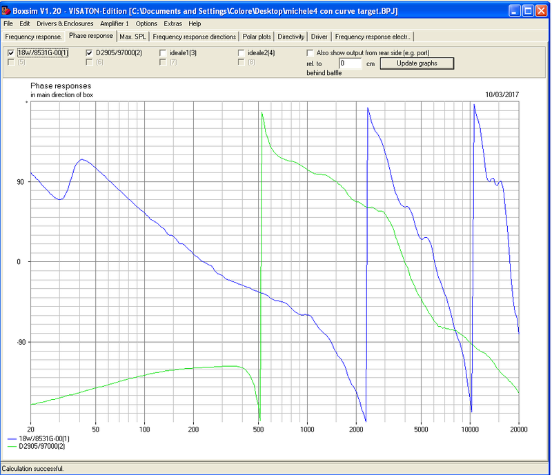

And the polarity is a bit weird. I fixed the polarity with a bit of slope adjustment. Because I think this one is not quite LR4. But I did mention the problems I had with guessing time alignment.
But it seems to me that second order, even with a 5kHz tank notch, is just not giving enough control of all the lumps and bumps in the 8531.

Mainly 4th order bass, you see. Some wriggle room with tweeter filter.

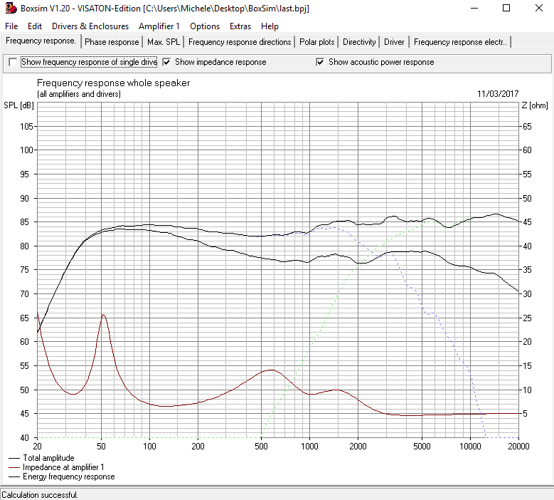

The bafflestep fiasco may be due to files I used being made on infinite baffle:
http://www.diyaudio.com/forums/multi-way/99926-scan-speak-crossover-help-23.html#post5013595
Adjusting for that gives cucicu's result, below. So far, so good, IMO. Something is working. 🙂

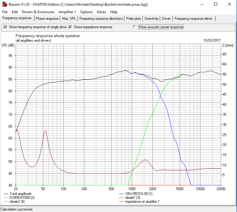

So said, I tried to "copy" the proac 2.5 FR on simulation, and trying to compare the sound of my actual with a couple of original proac of a friend of mine.
Well, I think I reached a perfect result with this crossover. Surely it will need some minor adjustements, but essentially i am very satisified. Let me share it with you. Could you simulate this, Paul and try to explain something about phase of this simulation? I can't understand how it is, if good or bad, but connecting the driver with the same phase, spl drops very very much.
NOTE THAT THE TWEETER IS REVERSE POLARITY.
and this is proac 2.5 FR:
and impedance (please compare the impedances of mine and of the original and see how much similar they are):

Very good to see your FFT, there is a reasonable good matching with the simulation. It gives more trust in this way. Do you apply "average on" in your FFT, you have to do.
I dont't believe so much in parallel resistors with coils, that they are needed. Indeed it lowers the Q, but more important is to realize the correct shape for the tweeter and when this will be done by the parallel resistor, no problem. But not a must to do IMO.
The peak at 300Hz can be a room resonance, but I am not sure. Now the SPL is also rising to low frequencies, maybe that is also an issue. I will simulate now and think about it further.
Yes i set average on. I can choose an average between 1 and 100 where 1 is "istantaneous" and 100 is slow in capturing.
I m changing way of working. I noticed , measuring only the woofer, that the pricky frequency is about 1.2khz and 1.6khz. I can hear it clearily also during the sweep. These are certainly the fastidious and too midy frequencies. So i suggest that notch at 800hz is not needed. It is better ( regarding the issue on 1.2khz and 1.6khz) at measurements and also to my ears a simple 2.7mh/12uf.
Better is 2.7mh/12uf-4.7ohm to ground/0.47mh.
In this way i measured and listened the the 1.2khz and 1.6khz become more attenuated and not pricky anymore.
So i will try with your help (please ) to sew a tweeter curve on this
I think, because the tweeter tends to sound forward, to make a ripid penndance, like b3 for the tweeter. The overlapping under the crossing point is terrible abd must be avoided. I say this after listening. This tweeter sounds bad when cut too low. Too energy in the 2khz region.
Cucicu, here the design with Leap woofer frd and dibirama tweeter frd.
I also need then 2.7mH to make it flat, your favourite coil at this moment 🙂.
There is more mid filtering for the woofer. Response is between B3 and LR4 on crossover point now.
Schematic filter27 B3 2750
SPL filter274 B3 2750 Leap woofer and dibirama tweeter
