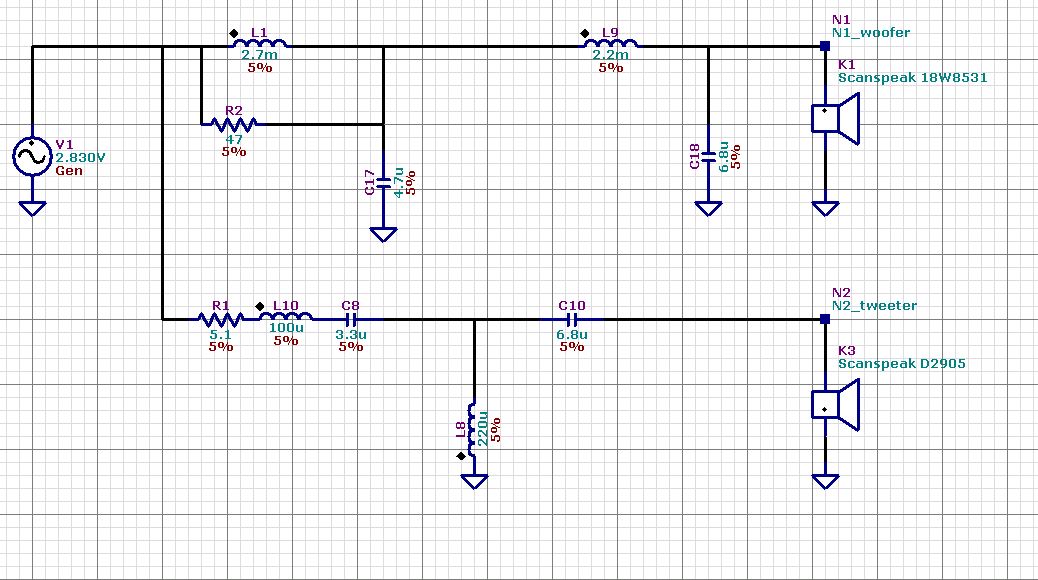

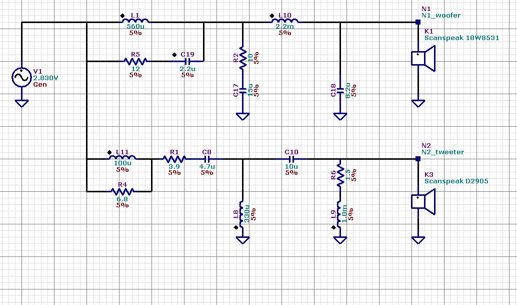

Xover is (sorry i cant attach images at the moment):
Woofer 4rth order: 2.7mh with 47ohm in parallel/4.7uf to gnd/ 2.2 mh/6.8uf to gnd
Tweeter: 0.10mh-5.1ohm-3.3uf/0.25mh to gnd-6.8uf.
This config is alligned and no more woofer issues but maybe there is a phase problem in the crossing point with tweeter. Thank you

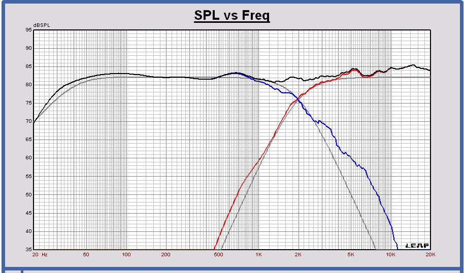

This is the simulation. I have used Leap frd for woofer and dibirama for tweeter frd. There is a power boost at 4-5kHz, just like you measure it.
There is some phase aligning above 3kHz. Below 3kHz the drivers become more and more in anti-phase.
For me it is difficult to give comments on this, because i don't hear the results. IMO you have to be closer to some standard designs. Do you have now a second speaker to compare with during your listening tests? During tweaking you should to go back sometimes to a reference design or speaker.
You did find filter 06 a "damn good" one. It is almost flat with the woofer Leap frd.

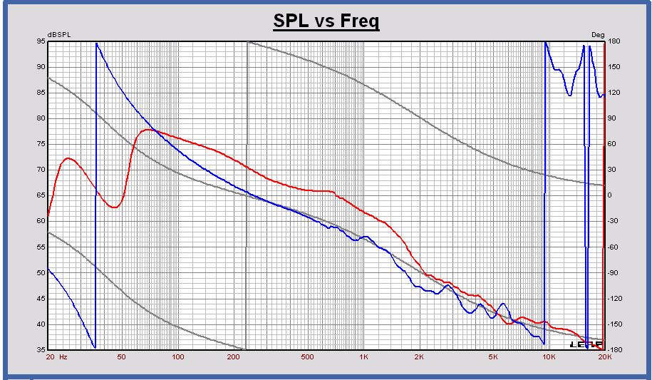

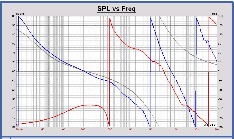

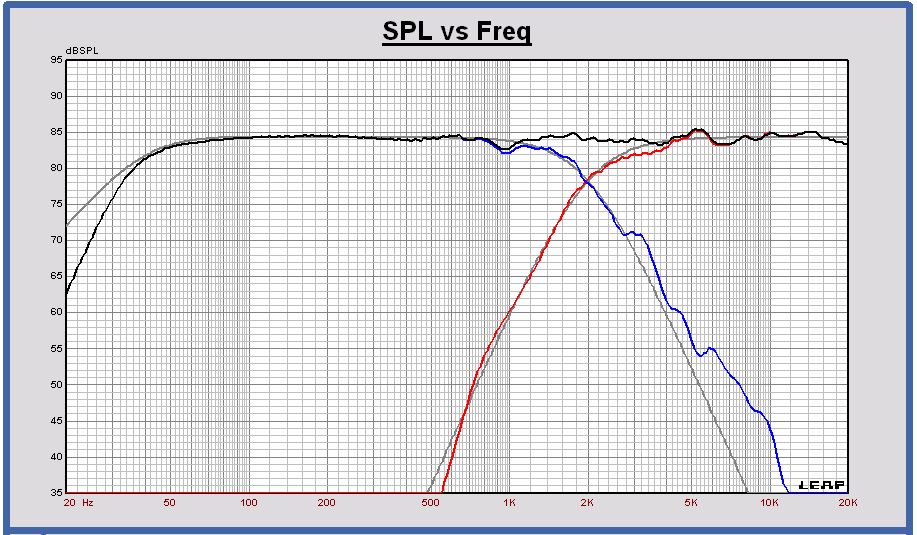

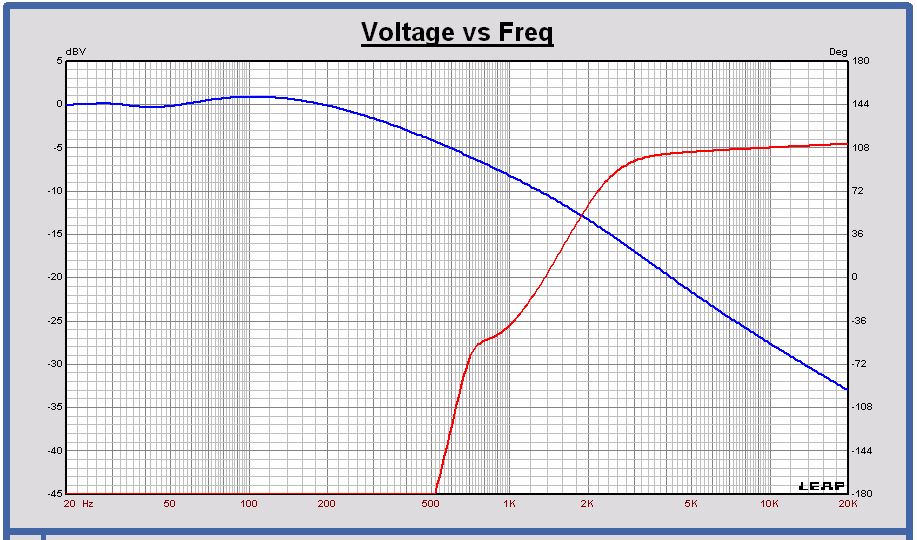

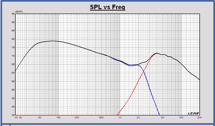

Schematic filter34

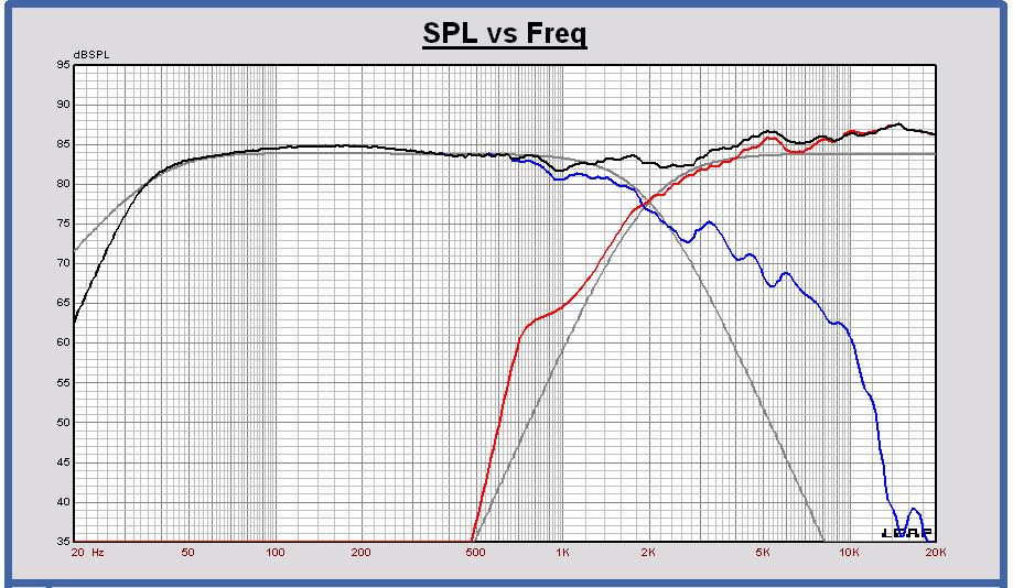

SPL filter34 and LR4 2800Hz targets

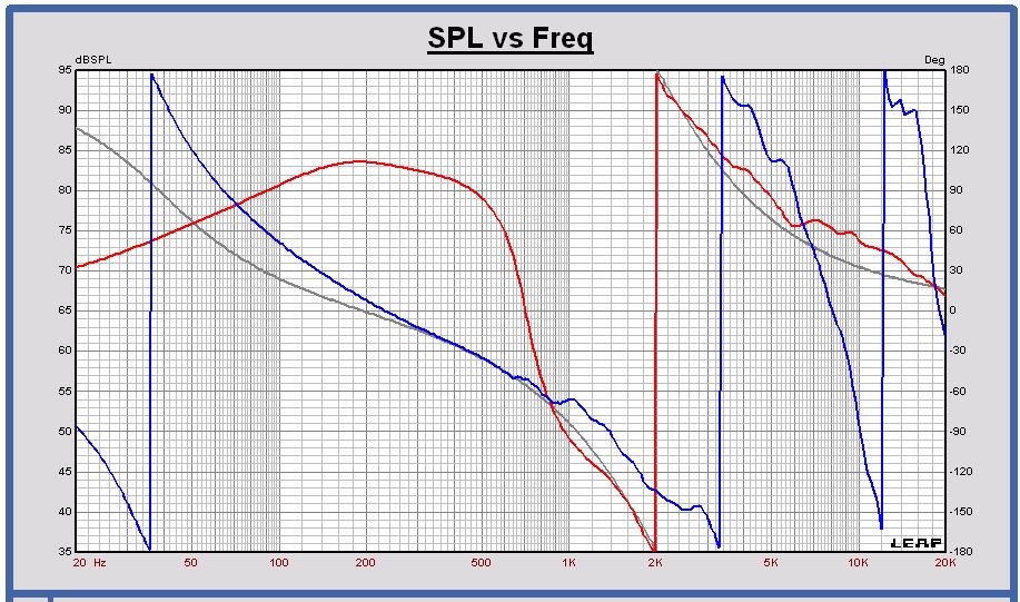

Phase filter34
Grey curve is LR4 2800Hz target phase
Electrical tranfers filter34
Power response filter34

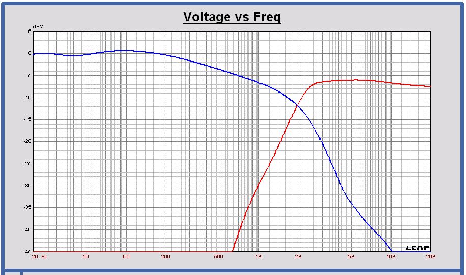

SPL filter06 and LR4 2000Hz targets

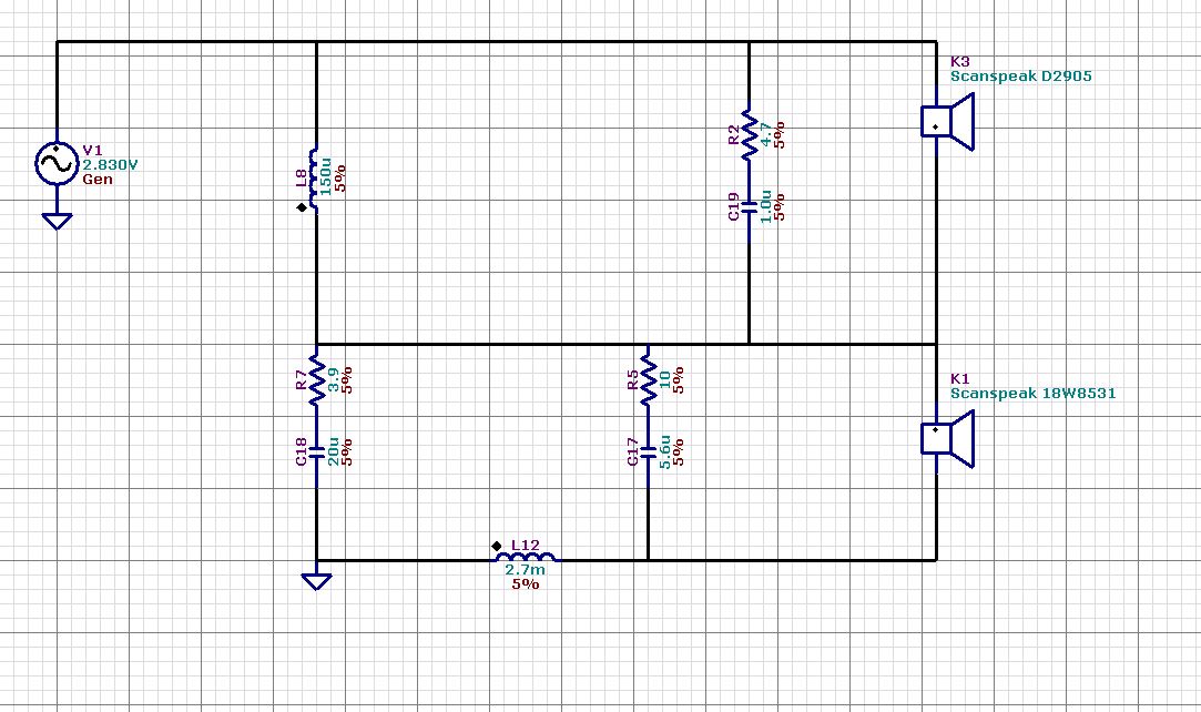

I have mounted the series xover here
http://www.diyaudio.com/forums/mult...8w8531-d2905-97000-crossover.html#post5015750
With minor mods. L2 is 2.7mh
Cz can be variable from 5.6 (more mids) to 12uf (less mids).
R1 is 3.9ohm
The cap on the tw zobel is 1uf.
Right now i am using it with cz=5.6uf, maybe mid are a little forward. If you try simulating i think we are on goal. Better of all the xover listened. The only issue can be cZ.

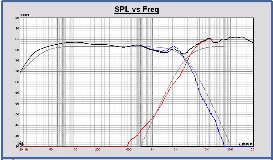

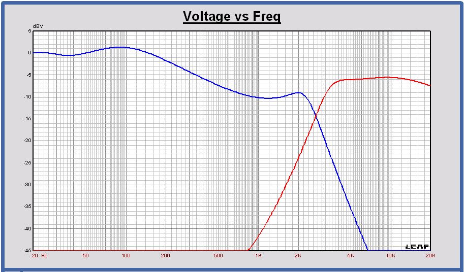

Cucicu, also filter 29 with some changes to the Rabbitz filter, was technically ok. It is a LR2 at 2000Hz. Phase aligning is good. I am not so surprised that it sounds good.
Simulated with dibirama frd's.

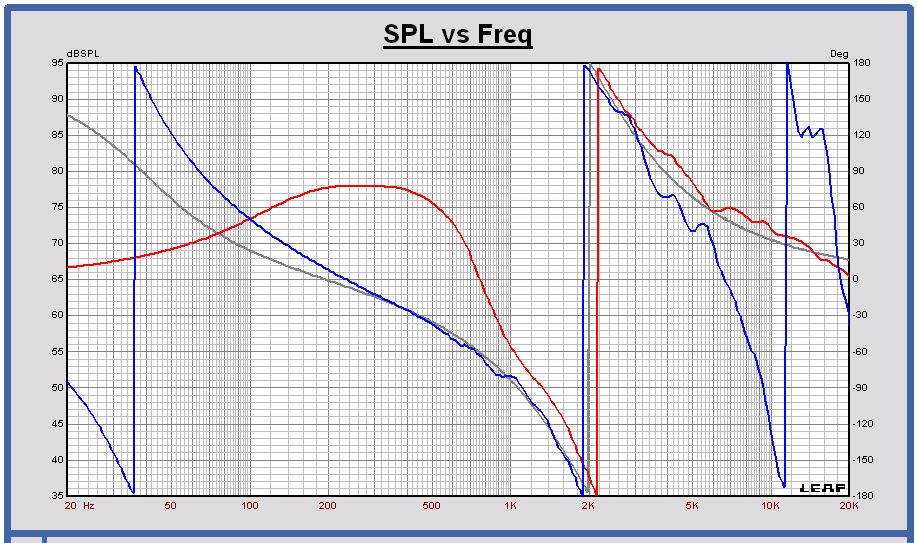

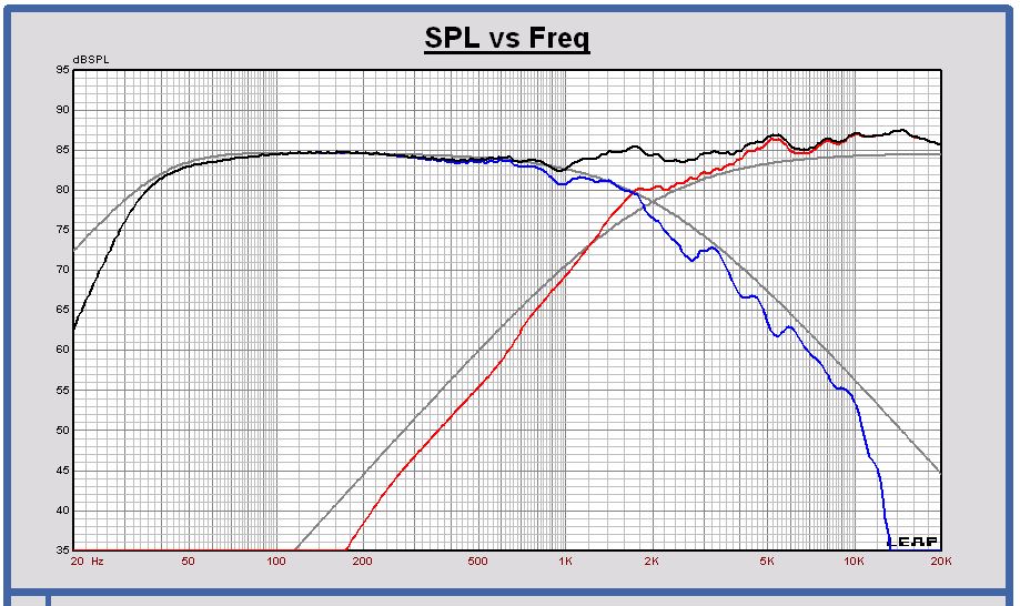

Schematic filter 35
SPL filter35 LR2 2000
Phase filter 35 LR2 2000

No ideas for modifications. Changing some components have impact on both driver SPL's for this type of filter.
Maybe your tweeter has a little lower level than the dibirama frd's.

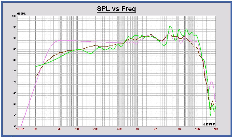

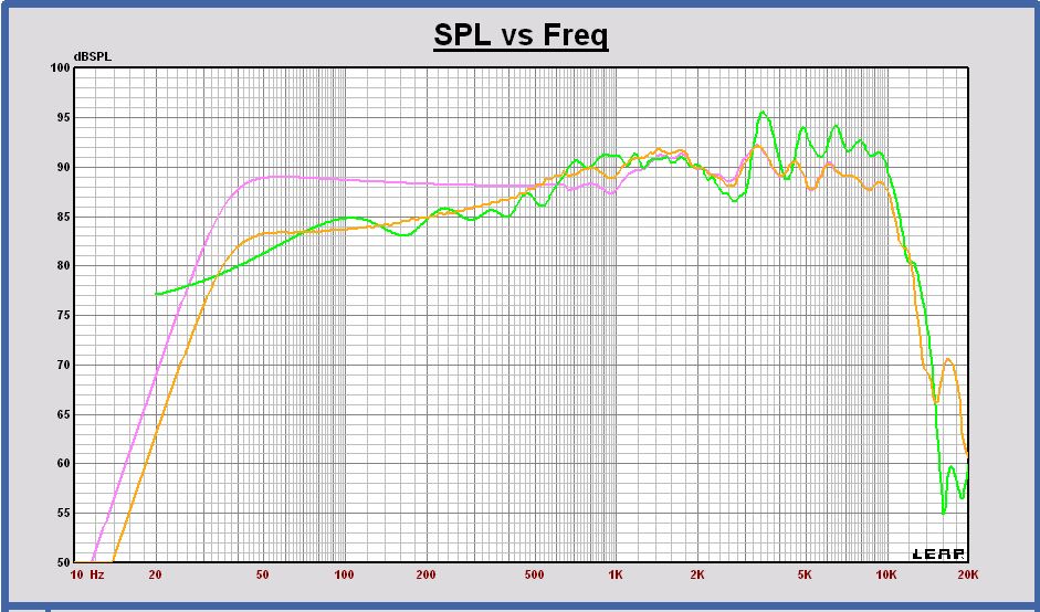

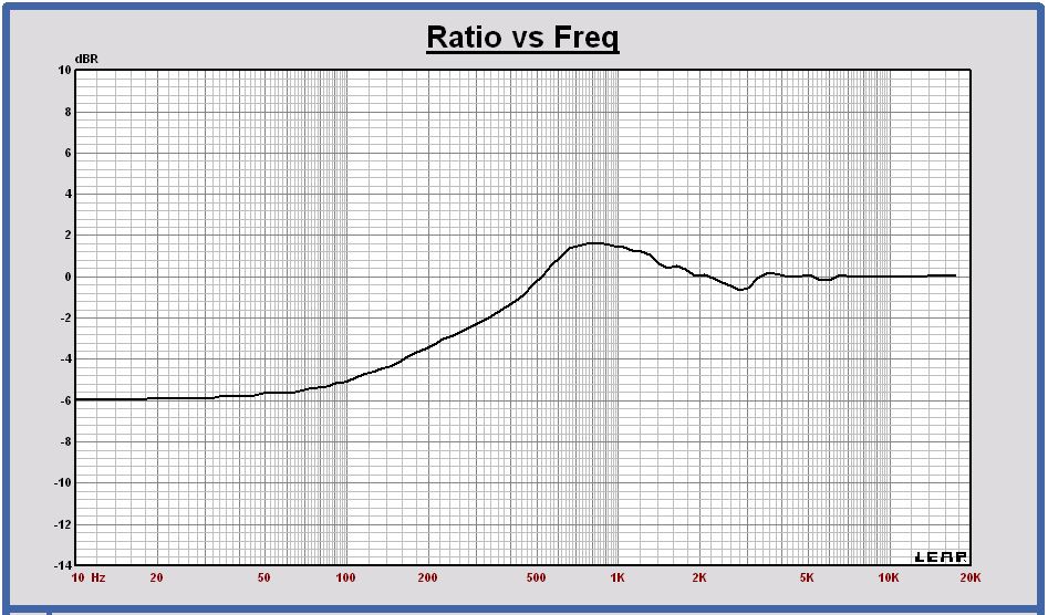

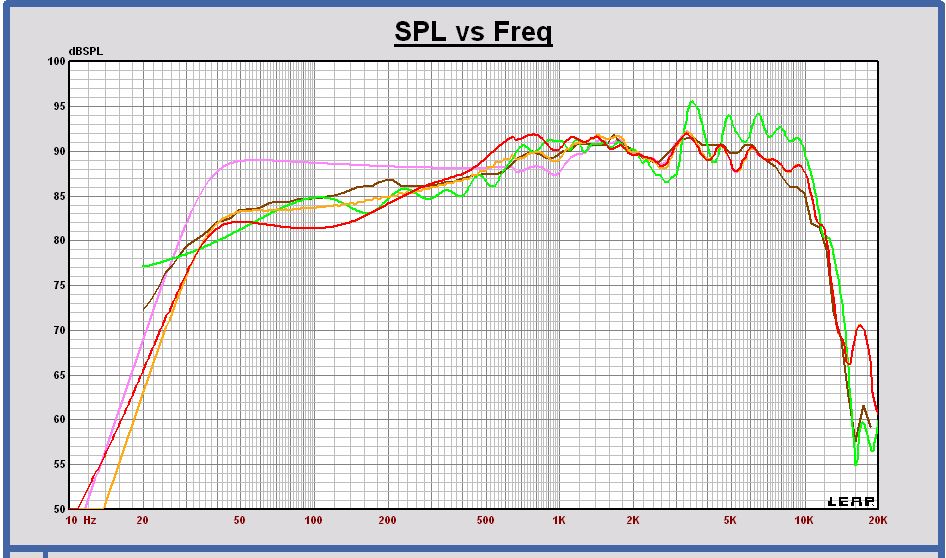

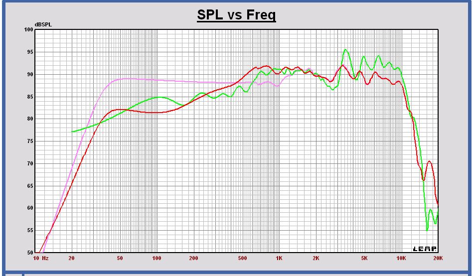

Hi Cucicu,

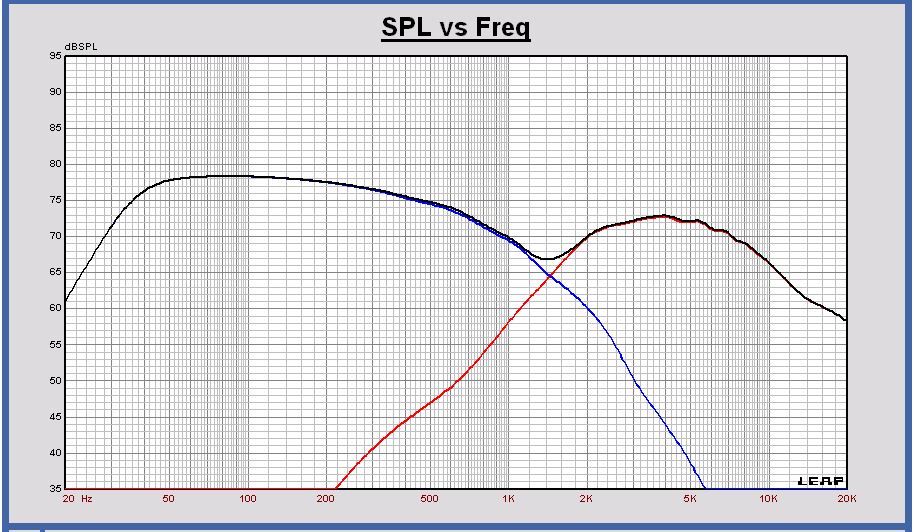

Here are some plots about this item. Some comparing measurements and simulations of the woofer in its cabinet in free field.
In 2007 I have done a Clio measurement outdoors of almost the same speaker as yours. With the bottom of the speaker at 150cm heigth. Probably an older version of the 18W8531 and the enclosure was a little smaller than yours, 21.5cm width.
Just to think about...
Bafflestep calculated with Babgy diffraction calculator
Response in enclosure on infinite baffle (pink), Leap simulation (red) and Clio measurement (green)
Response in enclosure on infinite baffle (pink), Zaph ZRT (brown) and Clio measurement (green)
Response in enclosure on infinite baffle (pink), Bagby calculated diffraction (yellow) and Clio measurement (green)
Response in enclosure all
IMO the Bagby diffraction simulator is not so bad, but you cannot calculate more complex enclosures.
With this enclosure Leap has some problems. It is the first time I see these differences with a Clio measurement. I will try to find what the reason is...
Paul

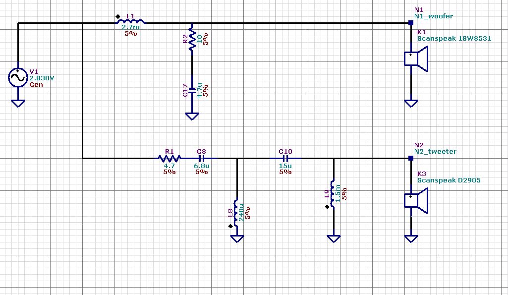

The actual xover is:
Woofer 2.7mh/10uf--4.7ohm to gnd
Tweeter is 4.7ohm--6.8uf/0.25mhto gnd--15uf/1.5mh to gnd.
Woofer z offset is 32mm as mario suggested.
Paul can you simulate and help me?
Without the 4.7ohm on the woofer, sound is mor midy in the 800-2000hz.

I have simulated your filter and compared with LR4 targets. It can be better. IMO, at first you should make a technical perfect filter as good as possible and after that do some tweaking with the help of simulation. You have to tune around a reference otherwise you will never realize the ultimate design. Designs that are almost correct, you can make hundreds of them, and they have all good points but also bad points. My experience is, when you make a very good design, that means based on measurements, on a target, you can reach a result that you can hear that everything becomes nicely in balance. And that is not possible by listening only...
I have also made a design, a LR4 at 2000Hz, but better on targets (in the assumption there is a good map of your drivers on the dibirama frd's).
Your actual filter
Schematic filter 36
SPL filter 36 LR4 2000 dibirama frd's
Phase filter 36 LR4 2000 dibirama frd's
target in grey
Electrical transfers filter 36 LR4 2000
New design
Schematic filter 37
SPL filter 37 LR4 2000 dibirama frd's
Phase filter 37 LR4 2000 dibirama frd's
target in grey
Electrical transfers filter 37 LR4 2000
