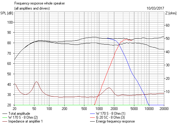

I have simulated your crossover and this is the result with dibirama's files:
here we are. No baffle step compensation. This is why I can't understand what you wanna say 🙂
I'm actually not very bothered what the tweeter is, but used a 88dB G20SC to match yours. The woofer is a scanspeak 8531, because I used your ZMA and FRD files with a bit of fudging. The response seems to match the scanspeak data anyway. Time alignment was a bit guesstimate with your files. I could be wildly wrong on that. 😱
The theory says, once you get a LR4 curve on one driver, you just have to adjust the other driver filter for a matching LR4 result. And 4th order filters totally dominate individual tweeter response. The circuit is just what Boxsim optimiser came up with. It needs tidying up, but the 1.35R is a very critical component that works best when bigger IMO, because the impedance bump is ugly.

It wasn't my intention to suggest a filter. Just that 4th order seems to solve the problems here. I was scratching my head why there was no bafflestep:
604337d1489081465-scan-speak-crossover-help-scanspeak-8531-electrical-response-4th-order.png
And the polarity is a bit weird. I fixed the polarity with a bit of slope adjustment. Because I think this one is not quite LR4. But I did mention the problems I had with guessing time alignment.
But it seems to me that second order, even with a 5kHz tank notch, is just not giving enough control of all the lumps and bumps in the 8531.
I've always thought a 6" is the speaker from hell. Worst time alignment and not enough natural rolloff.

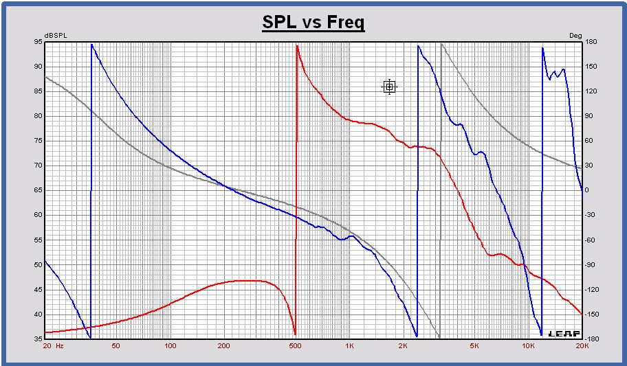

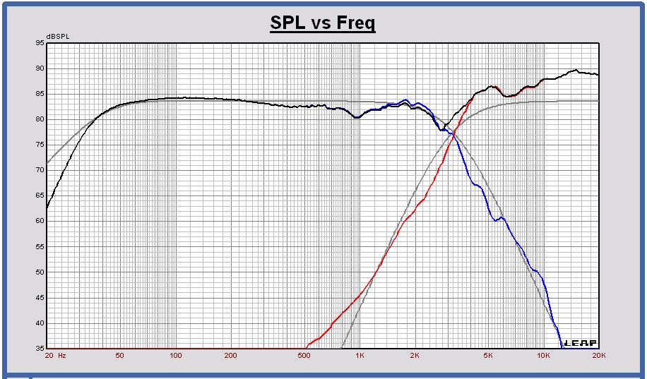

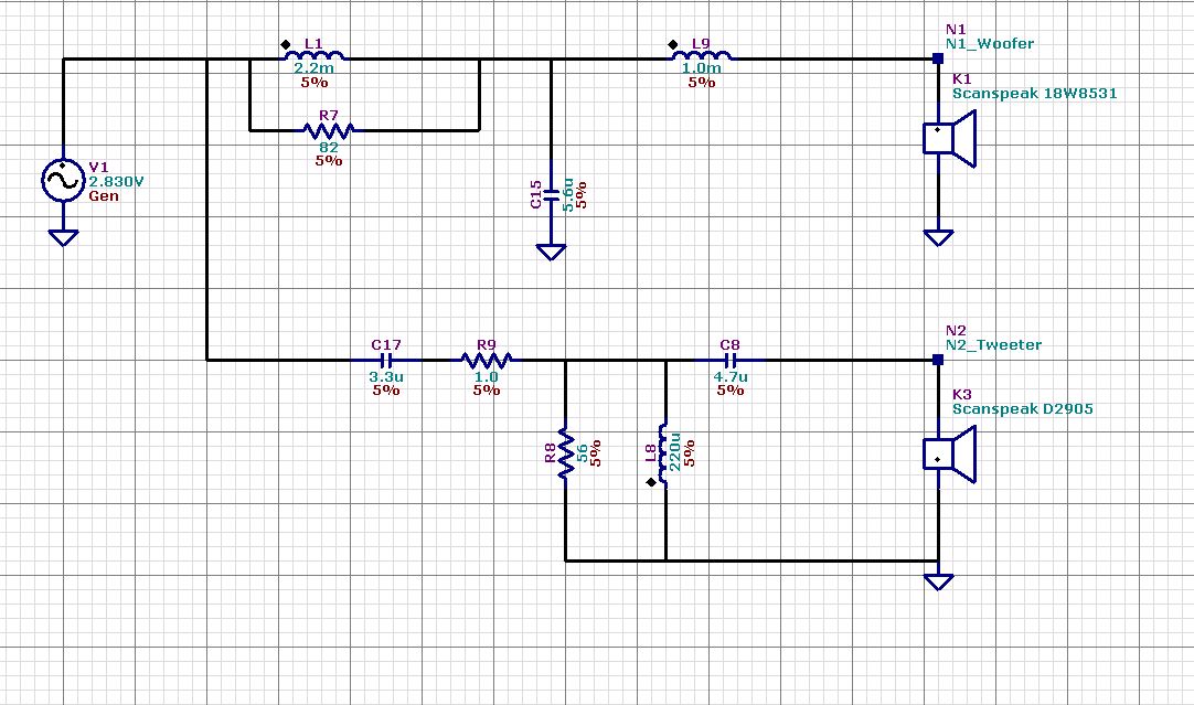

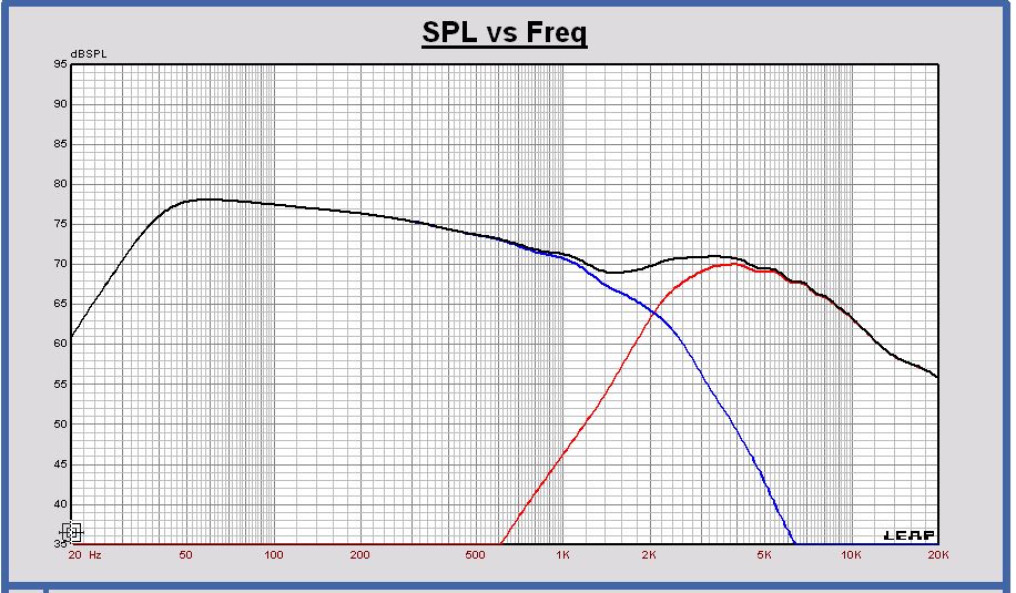

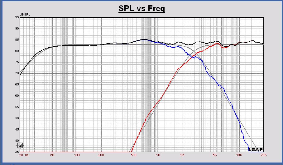

I have simulated your Procah design. My results are the same. Around 3200Hz it has a LR4 behaviour. But placing the woofer 20mm behind, the phase of the woofer is lagging more and an opposite phase for the tweeter gives a more flat SPL. I don't like the tweeter boost but when it sounds good, what can we say... Maybe your tweeter has a lower level, we don't know now.
Schematic filter 24 Procah
SPL filter 24 Procah and LR4 3200 targets
Phase filter 24 Procah @ woofer 20mm behind tweeter
LR4 target in grey

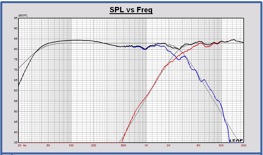

I will design a flat SPL filter with the Leap curves. Maybe crossover around 2800Hz? In that way you don't use the tweeter in the 1500-2000Hz region where the diffraction of the baffle is high, with a different SPL off axis as a consequence.

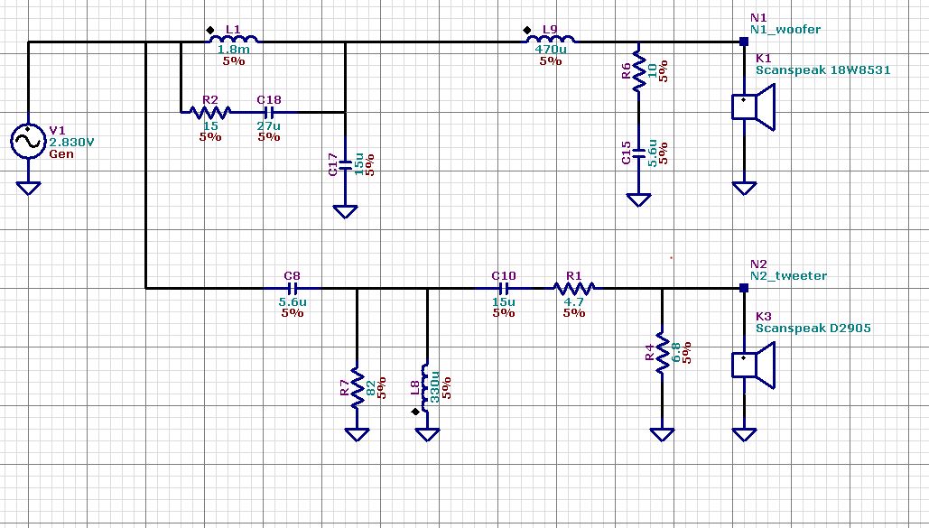

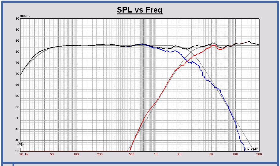

This is a B3 2750Hz. I have designed with the dibirama frd's and also with the Leap woofer frd to compare.
There is a serial notch on 800Hz. You can tune yourself by changing R of notch or increasing L and decreasing C to lower Q. You can do yourself in Boxsim.
SPL is optimal for woofer 10mm behind. For 20mm behind there is more boost on crossover point because drivers become more in phase.
I have looked for optimal power response and smooth electrical transfers.
When this is still bad I think you have to do a measurement. It still stays designing in the dark now, there is no reference.
Schematic filter25 B3 2750Hz
SPL filter25 B3 2750Hz dibirama fred's
SPL filter25 B3 2750Hz leap woofer frd and dibirama tweeter frd

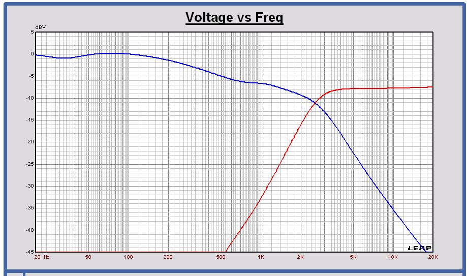

Electrical transfer filter25 B3 2750Hz
Power filter25 B3 2750Hz
To change the tweeter level change both R1 and R4 to keep the same load on the filter.
-2dB : R1 = 5.1E and R4 = 4.3E
+2dB: R1 = 3.9E and R4 = 12E

I just build your filter and it is very good. Notch filter is well spotted.
I made a FFT measurement (the best that I get) and Pink noise Third octave smoothed and I notice there is a bump on 300-400hz but also on the 1khz-2khz region.
I think that these can be the issues. Leaving out the 300Hz bump for the moment, I think definitively that the "midy" sound is given by the 1-2khz region. It is also evident from the simulation. Do you think that we can drop down that region of about 2db's?
here is your simulation, look at 1-2khz region
here is fft
I bring c15 of your schematics from 5.6 to 15uf and now the woofer is perfect. I will not touch it anyway.

The rising response is a consequence of the notch at 800Hz, you see on the electrical response of the woofer. I try another way, maybe more flat below 1000Hz.
Very good to see your FFT, there is a reasonable good matching with the simulation. It gives more trust in this way. Do you apply "average on" in your FFT, you have to do.
I dont't believe so much in parallel resistors with coils, that they are needed. Indeed it lowers the Q, but more important is to realize the correct shape for the tweeter and when this will be done by the parallel resistor, no problem. But not a must to do IMO.
The peak at 300Hz can be a room resonance, but I am not sure. Now the SPL is also rising to low frequencies, maybe that is also an issue. I will simulate now and think about it further.

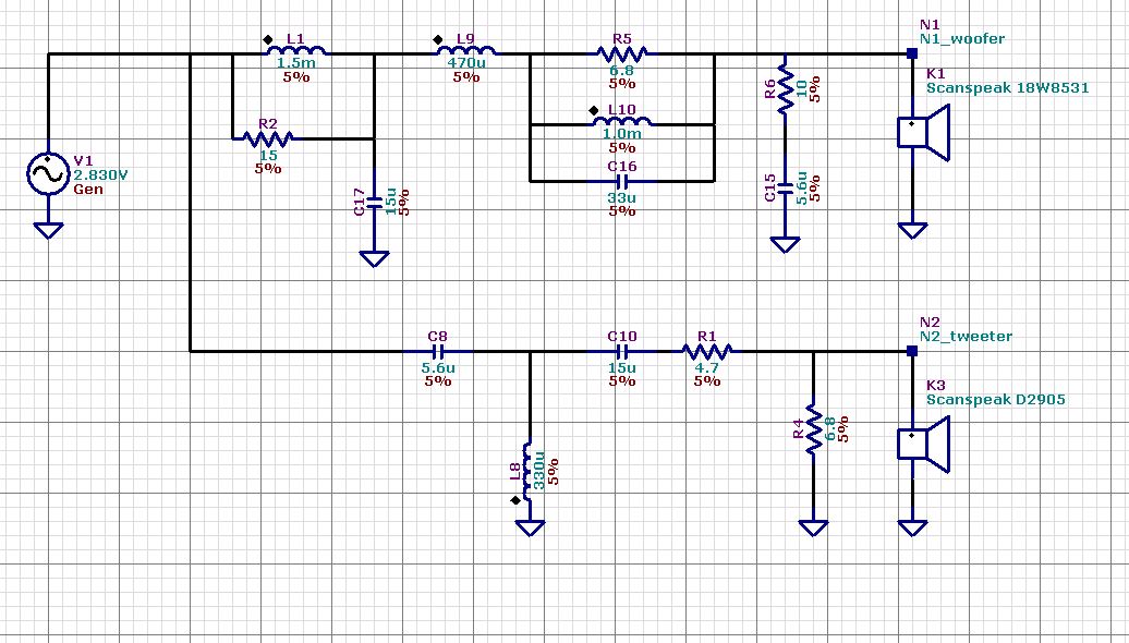

I m changing way of working. I noticed , measuring only the woofer, that the pricky frequency is about 1.2khz and 1.6khz. I can hear it clearily also during the sweep. These are certainly the fastidious and too midy frequencies. So i suggest that notch at 800hz is not needed. It is better ( regarding the issue on 1.2khz and 1.6khz) at measurements and also to my ears a simple 2.7mh/12uf.
Better is 2.7mh/12uf-4.7ohm to ground/0.47mh.
In this way i measured and listened the the 1.2khz and 1.6khz become more attenuated and not pricky anymore.

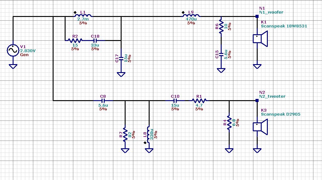

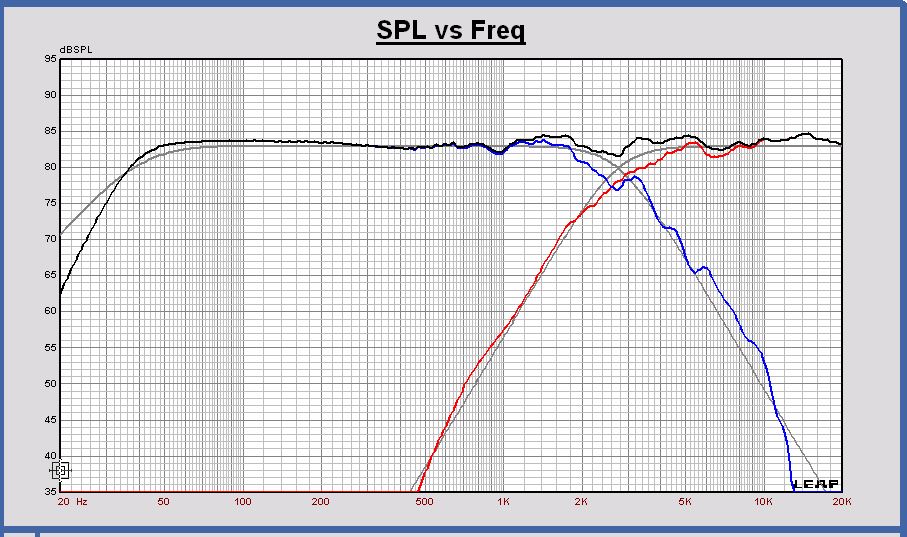

Cucicu, here the design with Leap woofer frd and dibirama tweeter frd.
I also need then 2.7mH to make it flat, your favourite coil at this moment 🙂.
There is more mid filtering for the woofer. Response is between B3 and LR4 on crossover point now.
Schematic filter27 B3 2750
SPL filter274 B3 2750 Leap woofer and dibirama tweeter
