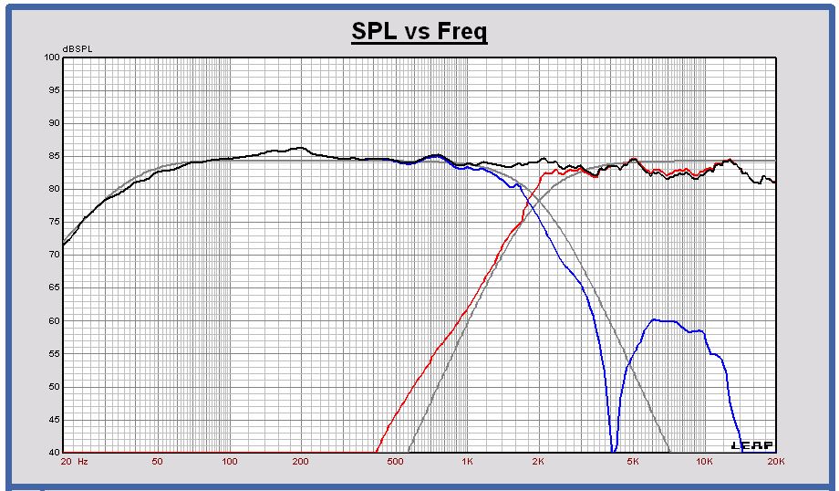

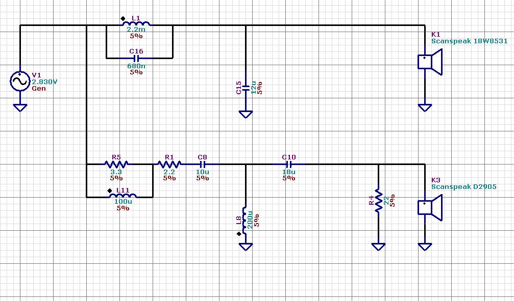

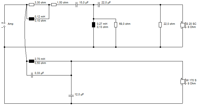

A technical better LR4 design. Two exta coils needed.
The responses are better on target in the outband. Better phase aligning also.
In some designs I had a much better tweeter performance with the 4th order electrical filter.
If it was my speaker I should start with this filter and tweak it 🙂
Schematic filter13 LR4 2000

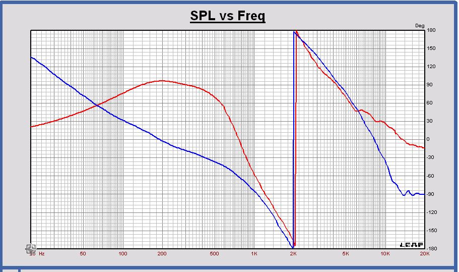

SPL filter13 LR4 2000
Phase filter13 LR4 2000

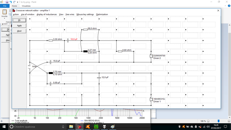

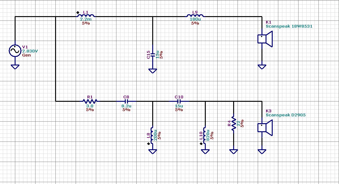

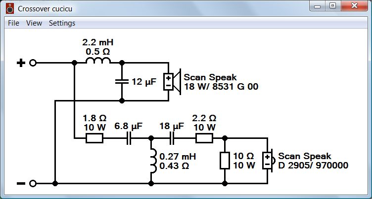

Paul, we can make the last attempt trying a crossing freq fo 2500-2800hz.
Here i found the xover of the SF guarnieri evo which uses the d2905 9700 tweeter and it shouldn't be a custom unit.
I tried to simulate and it is very good but i need you to perform a new woofer arm...will you help me?
The up resistor in parallel to the 6.8ohms should be 22ohm; the inductor in paralle with 10+5.6 ohms is important for the slope and should be 0.27mh.
Many thanks....

Cucicu,
No sorry, this costs me again a lot of time and it is not the good WOW to realize a good sounding speaker. When you are not able to do some measurements of the drivers you have in home it will not work.
You want to make a top speaker, sorry that is not possible in this way.
Think about it.
Crossing at 2.5-2.8Khz is not adequate. I had to use 2.5Khz in my home setup due to tweeter constraints with the 4531 version and I do not like it. It beams a lot.

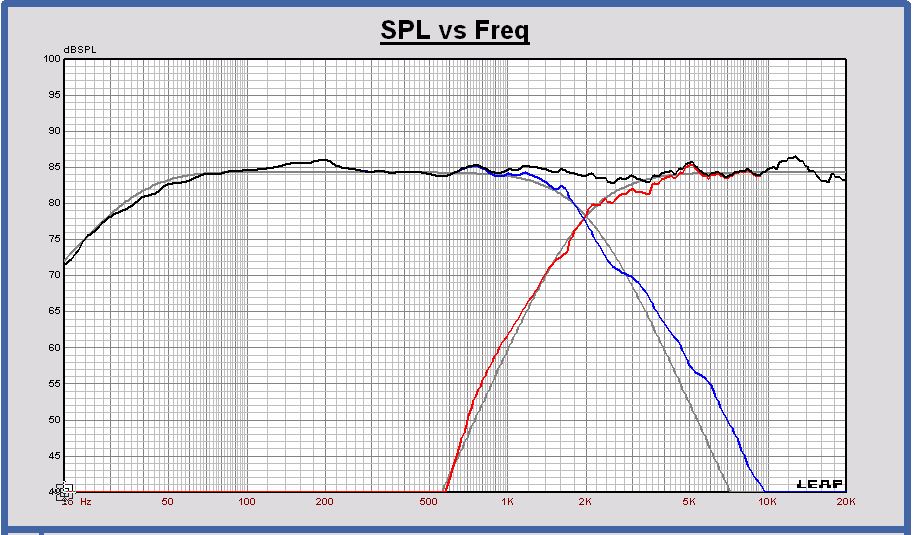

Ok Cucicu, let's give it a try, for one time 🙂. There will be a serious power dip between 1 and 3kHz, but there are a lot of commercial designs on the market like this, for instance this Sonus Faber Guarnieri Evo 🙂.

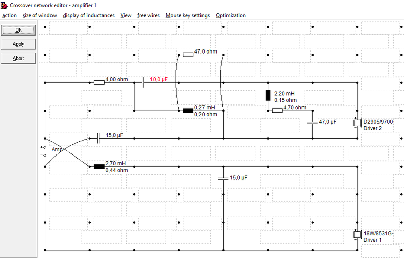

I have made an exact one tot one copy of the Guarnieri tweeter filter. It seems to be a B3 filter at 3kHz. So I have made targets B3 at 3000Hz for woofer and midrange.
The woofer filter is redesigned. I have used 2.7mH/0.44E and 2.2mH/0.15E, because you have them at home.
The results.
Schematic filter15 Guarnieri B3 3000

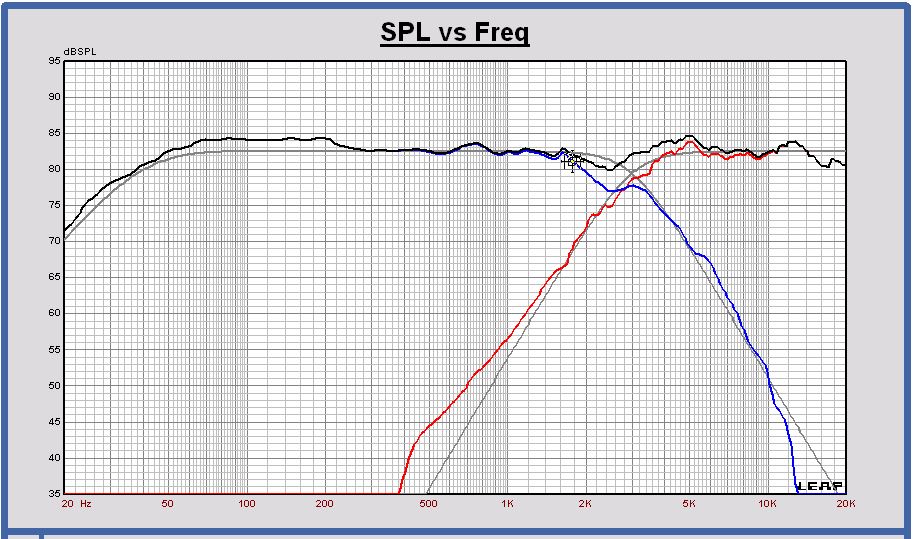

SPL filter15 Guarnieri B3 3000
The tweeter response maybe can be better but we use original Guarnieri !!
In the woofer response there is a dip at 2500Hz. Probably this can be better with a more complex filter with new values.

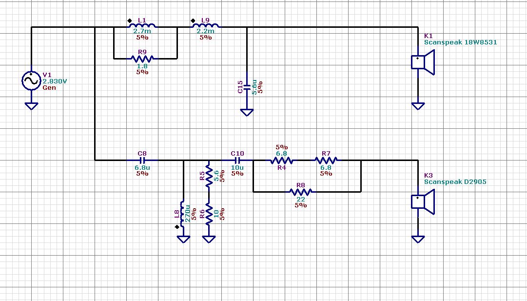

I have worked out a proposal now with your coil values.
It's a try with many riscs to go wrong, but you asked for it.

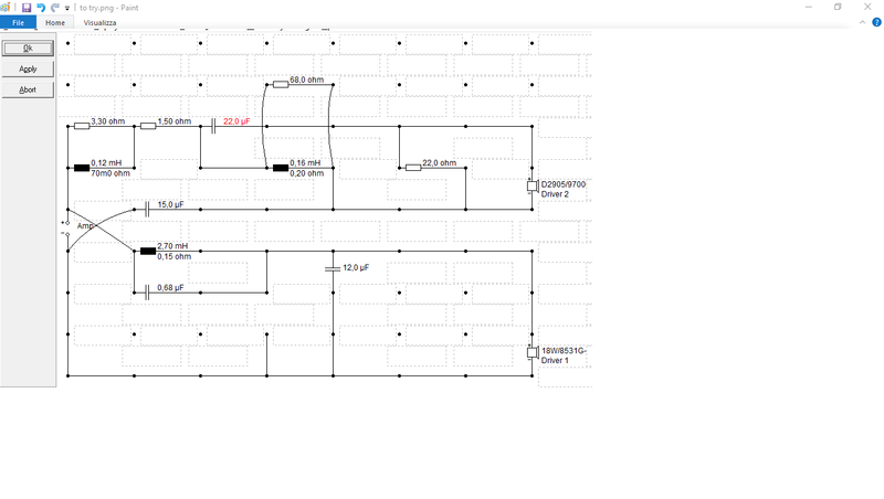

I don't wanna to give up 🙂 But there is something wrong here, I tryed more than 20 different crossover and no one was really satisfying to me; now I made this simulation, I put one cap of the tw on negative arm (similar to SF design) and phase is very good.
If you have time and wanna simulatem you're the welcome... thank you. I'm also damning myself to find out a proved design with this drivers but I found only SF guarnieri and Opera Callas Divina which uses the tweeter SURELY NOT CUSTOMIZED (standart part) in a 2 way towe system but uses 4 woofers (combined in series and paralell ) for a 2 way system and a rear super tweeter.
I'm gonna post my last simulation and also the xover of Opera Callas Divina

Thank dissi. Your proposal sounds very "dark".
Im ny simulation of your xover, highs are ver low, thank you anyway.

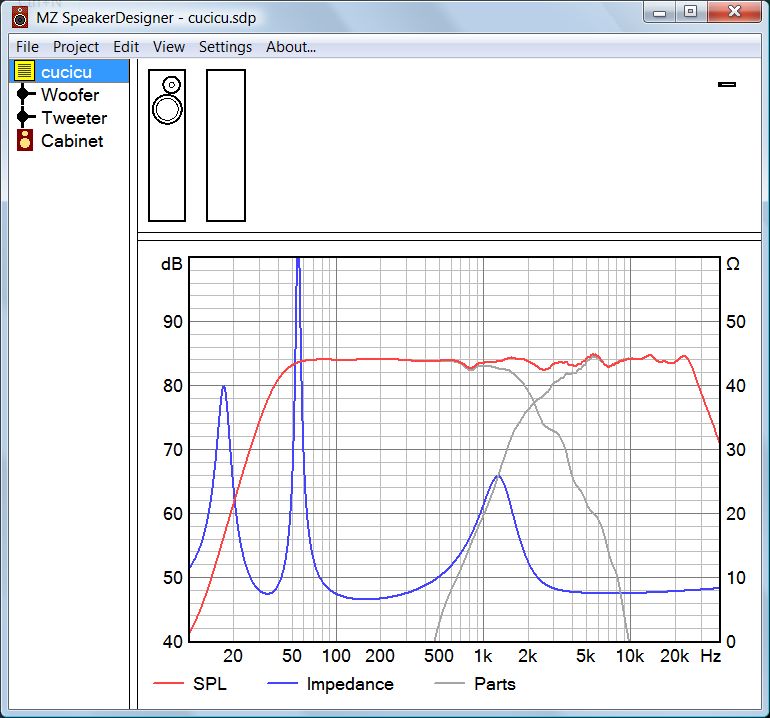

Paul, it seems that i ve found the issue on this speaker.
I m using a filter for tweeter called para-cross, a topology used in SF guarneri evo for this tweeter and it works very good . Tweeter is clear with a smoothing beetween 2 and 5khz. Now the speaker is not midy anyway but mid highs are very relaxed and not pricky. A solution which I could live with but im gonna try minor mods to rise that zone and make the tweeter absolutely flat.

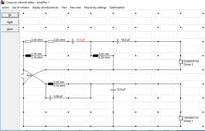

What do I think?

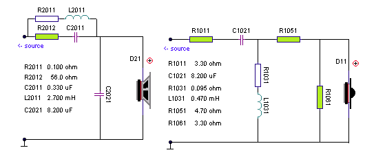

Dreadful. Inept. And audio-hoey with "para-cross" as well.
Your 3.8kHz deep bass notch is a horror. The 1.5kHz crossover is too low. You are still stuck with the 2.7mH/8-12uF idea that has sunk so many designs.
It is a well known theorem in electrics that the order of series components doesn't essentially matter.
Below is your para-cross redrawn. And to be compared to one of Troels' "not to be tried" circuits. 😀
I think you are just fiddling about here. I think that Micheal Chua Starling idea was better as a start.
