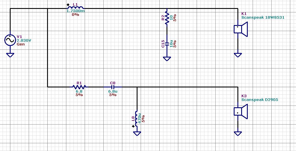

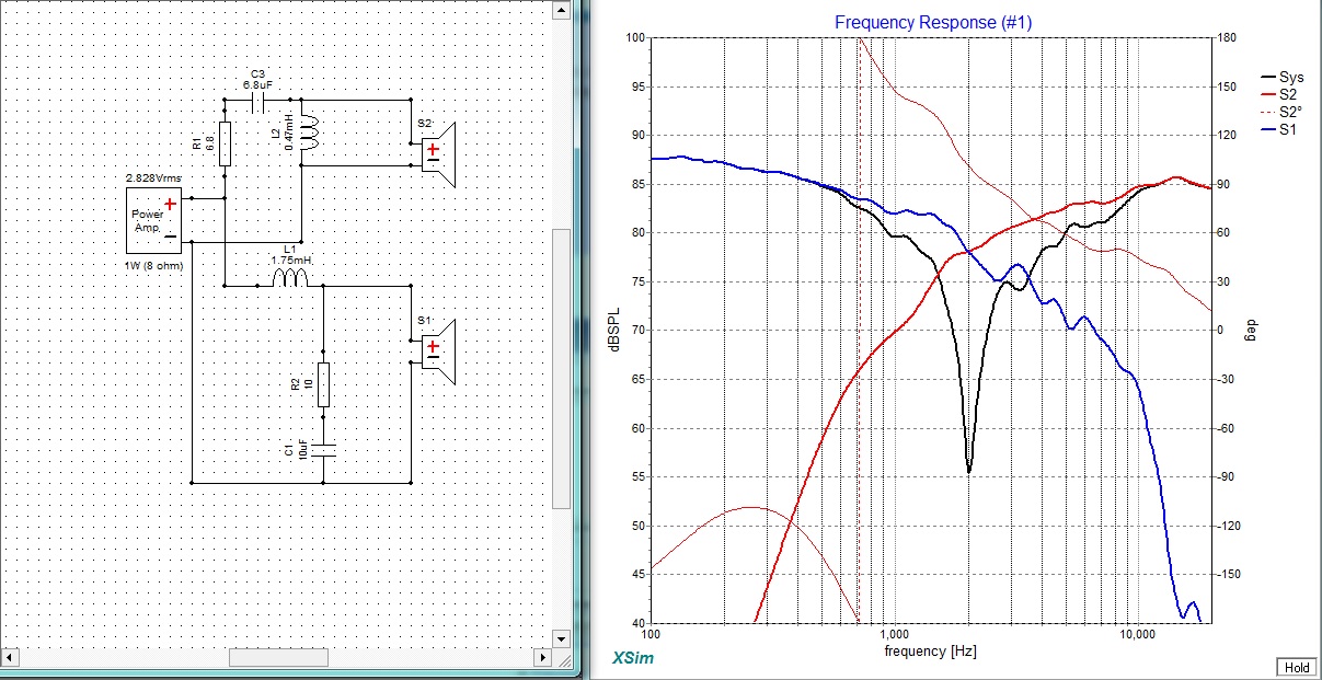

Have a look at the attached simulation. This is a simplistic crossover at 2Khz based on the .frd files you have uploaded. Tweeter should be connected with reverse polarity, otherwise you`d get the dip in black seen on the graph. If you want more baffle step compensation, increase L1 and R1 accordingly.

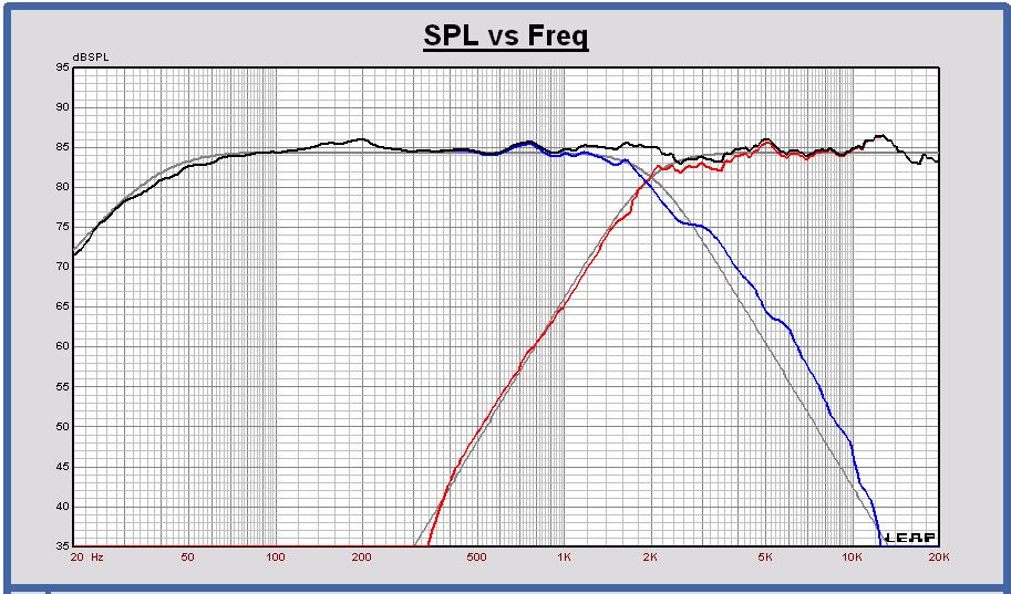

To start with, LR4 2000Hz

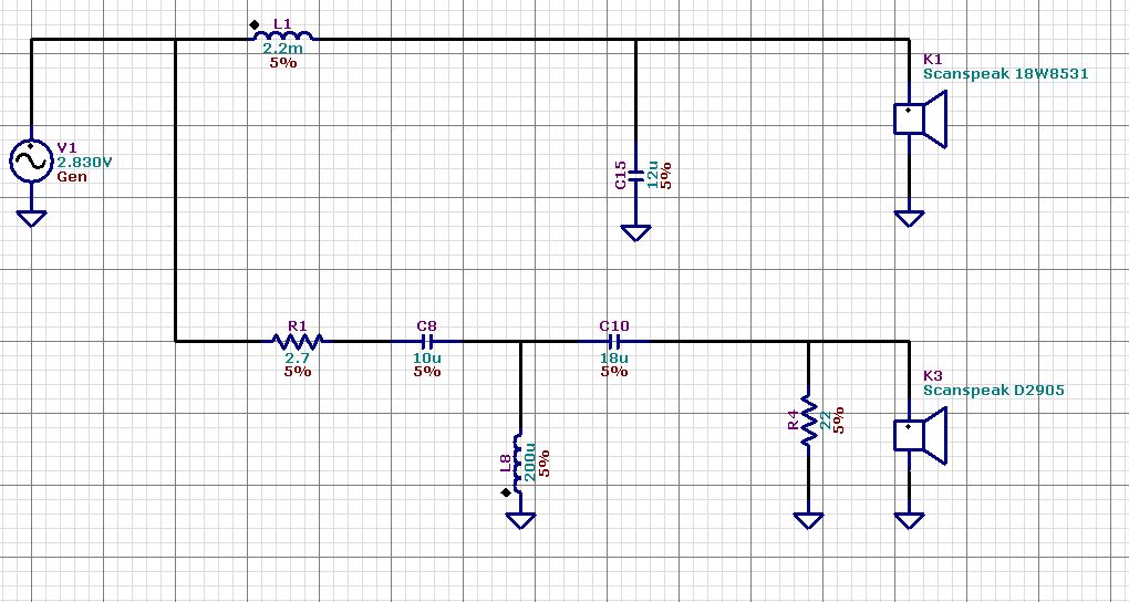

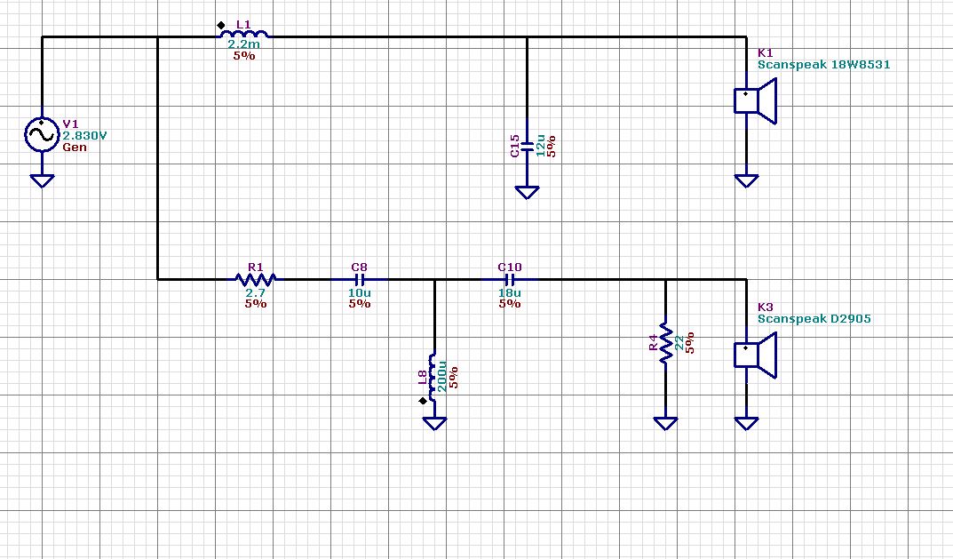

Schematic filter 09
2.7mH is too large to realize a flat SPL.
2.2mH / 0.30E chosen

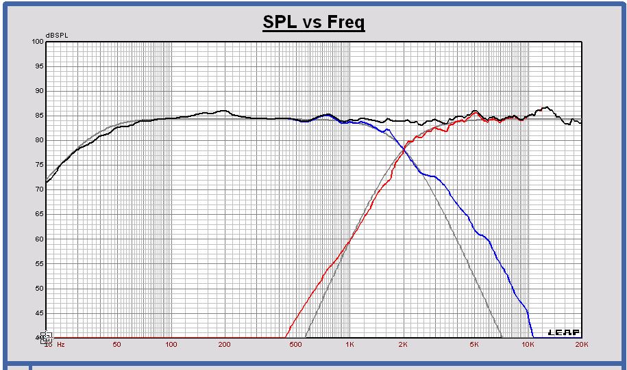

SPL and LR4 targets filter 09

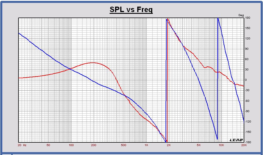

Phase filter 09
blue is woofer; red is tweeter
In the drivers outband it can be designed better on target with even better phase aligning, but the schematic has to become more complicated then.
I have chosen now an offset of 20mm between the acoustic centers of woofer and midrange (woofer 20mm behind).
Forgot something important - DCR of the parallel coil in the tweeter (L2) should be 1-1R4. 1R4 works best, coil will also be cheap as wire would be thin. If you don`t have such coil, add a resistor in series with it to achieve 1R4. DCR of L1 is 0.6 ohms, standard 1.2mm coil would be around this figure.

Yes and no. Increasing L1 means you get more baffle step compensation but this has a limit. Increasing R1 is to compensate the woofer baffle step loss incorporated in the inductor + higher voltage sensitivity of the tweeter. So, if you apply more baffle step, you`d need to pad the tweeter more. I hope that explains it.

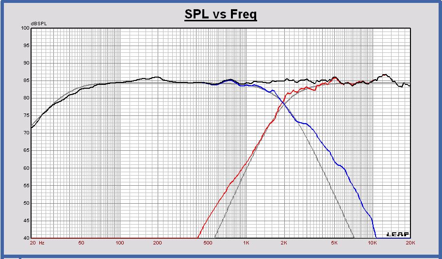

Cucicu,
Here are three designs for your project.
The LR2 2000Hz proposal Mario Pankov, a LR4 2000Hz and a B3 2000Hz.

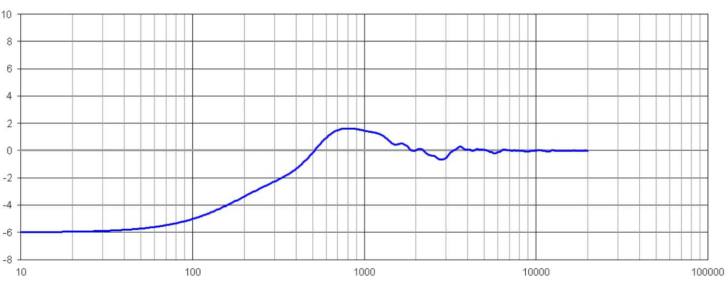

I have used the Leap infinite baffle response for the woofer and applied a baffle response transform on it with the Jeff Bagby diffraction calculator.
In this way the woofer SPL is almost conform the Zaph measured curve.
For the tweeter I still use the Leap simulation.
All my SPL's and impedance values are based on the specification values of the drivers. So yours can be different.

Baffle response at 3m according to Jeff Bagby

All the SPL's are simulated with no offset between the acoustic centers of woofer and tweeter.
With the woofer 24mm behind, there will appear some SPL dip around 8kHz, but acceptable and only at 0 degree on axis.

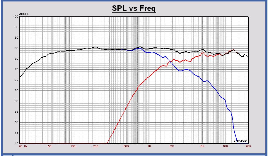

WOW PAul, great job, thank you!

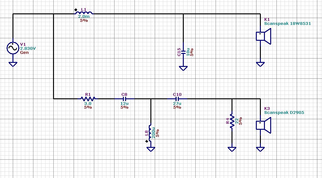

I'm listening right now to filter 11 LR4, I think we are on goal but there is an excess of mids from the tweeter...
18W sounds sweet, I think Baffle step is right with 2.2mH.
The tweeter is very "present" and lively in the 1-3khz zone, i think it could depend on the bump on 2khz. have a look:
I know it seems a little thing, but in reality this issue makes the tweeter sounding too midy and make mids forward.
Here troels says d2905 has a bump on 2khz and a dip on 3.5khz and thus need some equalizing, but I think we can work adding a resistor to the inductor of the tweeter or reducing 10uf cap to 8.2uf...what do you propose?
I think it is better also to increase C10 to 22uF.
C10 = 18uF causes some resonant boost in the electrical response at 3kHz.
You can see that in the impedance curve.
Try out some combinations based on listening.
Technical C8 = 8.2uF R1 = 3Ohm and C10 = 22uF seems to be the best.
