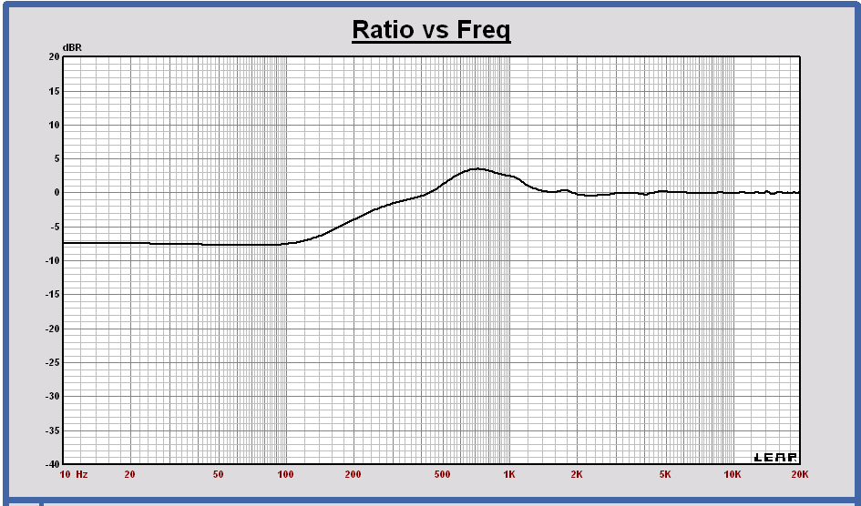

Let's do a proper calculation for the ZRT at 100 Hz. Driver SPL is 87 dB. The port contributes 0.6 dB and the filter transfer function another 0.9 dB. Hence we are at 88.5 dB. The baffle step at 100 Hz in 1 meter distance is -4 dB. So the result is 84.5 dB, and that's exactly what Zaph measures.
According to your chart LEAP predicts a baffle step loss of 7.5 dB at 100 Hz. That's very unlikely to be true. More than 6 dB simply is not possible IMO, and at 100 Hz and 1 meter it is less for sure.

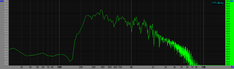

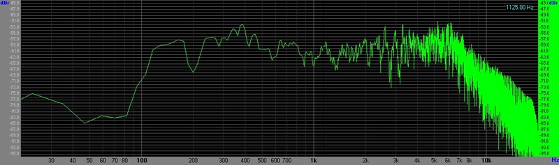

this is a measurement I have made, no calibrated mic, 1mt , center position between woofer and tweeter.

it seems the woofer has two peaks at ca. 1175hz and 1600hz. may be that is the issue, because also with notch filter, or with the xover 05 suggested by Paul, listening is always too midy. what do you think ?

The problem with Leap is that it simulates different low frequency SPL values dependent on the complexity and shape of the cabinet, I did know that. Also for closed box systems it is the case. I am surprised about the -7.5dB Leap value at 100Hz for this rather simple cabinet shape now . I didn't have an exact view on that value now, that is the mistake I made.
To conclude, the error in the design with filter at 100Hz, should be 3.5dB with your statement of only -4dB loss due to the baffle. I will have a closer look of the influence of the path length diiference of the port and the driver. I think the loss is a little more than -4dB.
Cucicu,
Is this is an averaged FFT measurement with noise in your room?
Cucicu,
yes it is

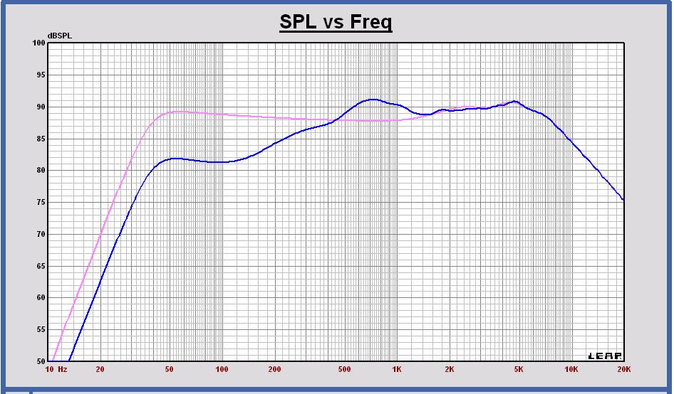

This is the baffle response of the system without port, so it is closed box; to avoid the discussion of the port position and impact on SPL.
Leap still simulates a roll off to -7.5dB, which is not correct indeed. IMO it has to be -6dB. I will do a correction on this.

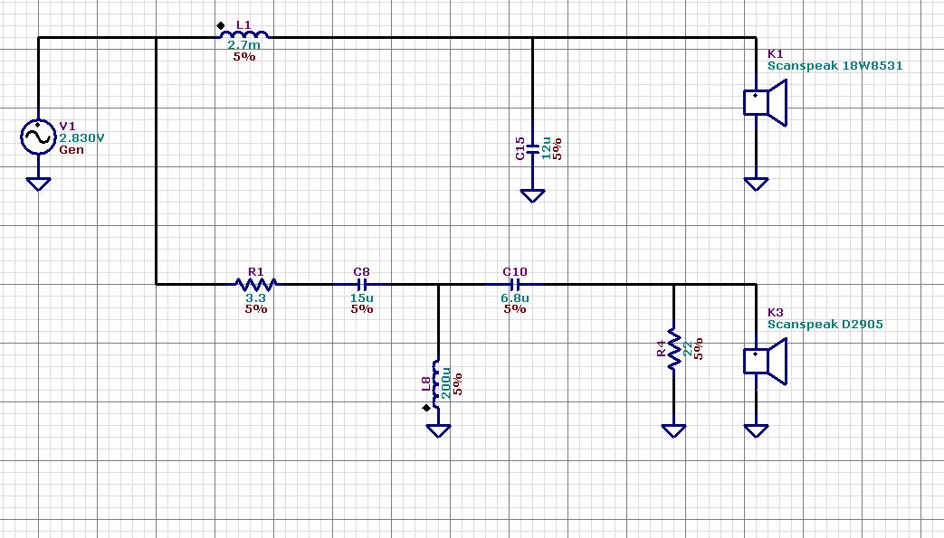

I ask you to reset everything and just consider this filter I'm trying right now, it's very equilibrated in the "boost" region (I think it's good baffle-step compensated) but mid-highs are a little backwards; I think this may depends on tweeter itself and on its placing on baffle. I think we should work only on tweeter to make sound it clearer, trying some equalization and playing with resistors values.
Referring to my listening experience, to my personal tastes and to the actual equipment/listening room, the actual filter is something like "flat", it has no any boost at a particular frequency, bass, mid and highs are equilibrated. So I think we have a "flat" target on which work on. But..... I'm listening to a "boring" sound, it has no character and lacks the "sparkle" of the best performer.
I feel it lacks something on the 2Khz-10khz range, something like "clarity", and "breath".
I tried many configs leaving the woofer out of games (2,7mH/12uF is almost perfect) and the actual situation is the one with the best equilibrium between the drivers. Modifying a cap or a resistor I have noticeable boosts/dips and mismatching with the woofer. So this is flat for me.
I'm sorry for all this, but I hope you would continue to help me.
regards

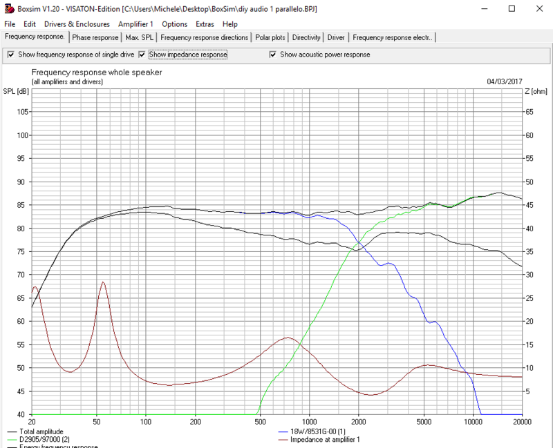

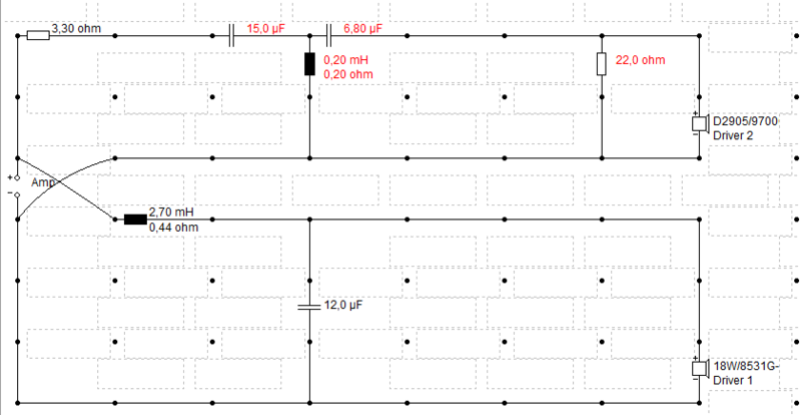

here's actual xover attachment and simulator response:

Cucicu,
No problem at all, I only would say how my favourite WOW is 🙂.
I think the goal of this forum has to be, to give the best support to each other.
I will simulate your last status and do some analysis of your measurements.
First I will do the low frequency SPL correction.
In your simulation I see that the impedance peak is 27 Ohm at 55Hz. I have 55 Ohm in my simulation. Have you also measured the impedance of the woofer in the cabinet without filter? If it is 27Ohm I have to make that correction also.

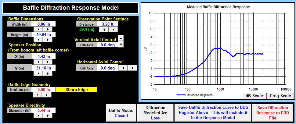

Why do you think the loss is only -4dB? For this small enclosure the baffle reponse is completely worked out at 100Hz.
My simulation says -4 dB at 1 m and -5 dB at 10 m. Baffle step diminishes in the near field. Lojzek's simulation apparently says -5 dB at 1 m:
The baffle of a floorstander isn't exactly small. At least the height is close to 30% of the wavelength at 100 Hz, probably enough to have some impact.
Edge diffraction is very complicated and the different models used in simulation programs actually just are approximations. I was very curious to see what LEAP does. Thanks for sharing that. LEAP shows a somewhat steeper slope and a higher positive peak. Based on my experience that's fundamentally right. However it seems to exaggerate a little bit.

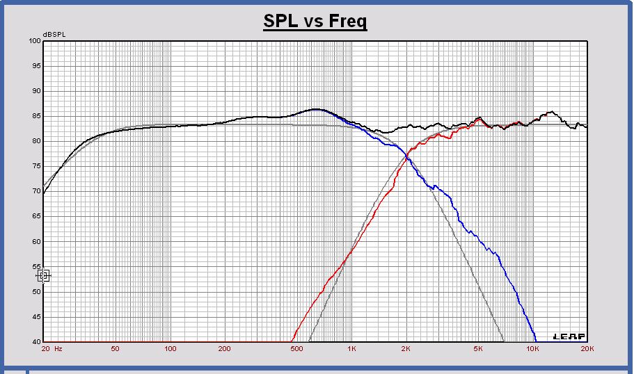

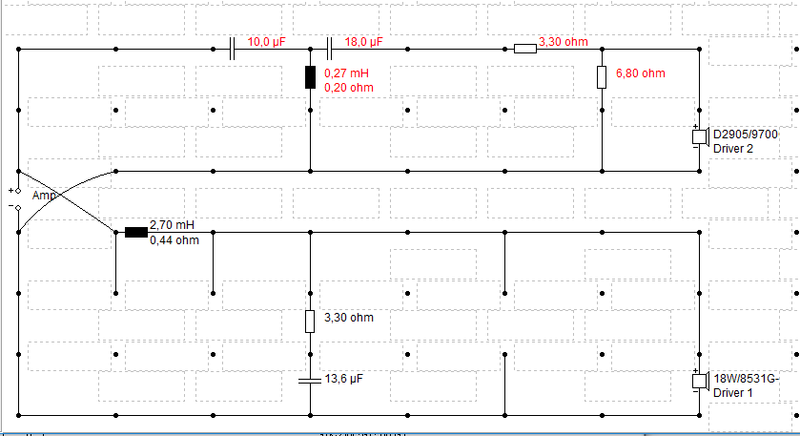

Cucicu
A new simulation with your actuel status.
I made a correction on the tweeter position, the impedance peak at 55Hz to 35Ohm and a low frequent SPL correction of +1.5dB.
Schematic filter 08
SPL filter 08
Remark the better tweeter response due to the correction on the tweeter position.
When I compare now with the actual room FFT measurements, my first impression is that the Leap simulation has more boost at 800Hz.
All my simulations are done at 3m distance on axis and I calculate to a 1m SPL level by adding 9.5dB. There is some deviation between the 3m and 1m response, especially for deep and wide enclosures.
I will look further if something can be improved.
Thanks Dissi.
In the past I have compared bafflestep responses of Leap with anechoic room measurements and the map was very good in the frequency range 200-2000Hz.
In Leap I simulate at 3m distance. At 1m distance the SPL is already slightly different. To compare with measurements at 3m, these are difficult to do without an anechoic room.
I will do a correction of 1.5dB now for low frequencies with a fade out at 200Hz. It will be more correct in that way.
