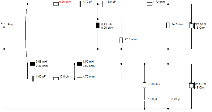

ok Paul, at this point I will try xover 03, indeed the two inductors 2,7 and 2.2mh in series are not a typical design.
I hope you can look also at off axis response and try to realize a mor conventional xover for this baffle (I'm worried about the resistance of the two coils on the woofer making deep basses a little lacking).
Maybe you could try to mantain tweeter xover of the xover04 and readjust just bass part, the tweeter in 04 config sounds quite good. don't know.

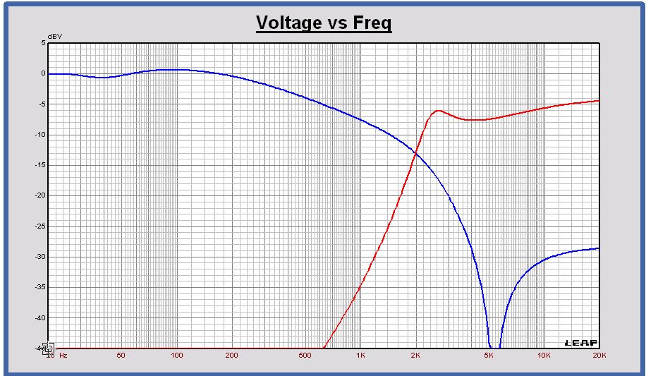

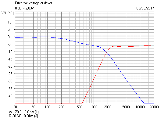

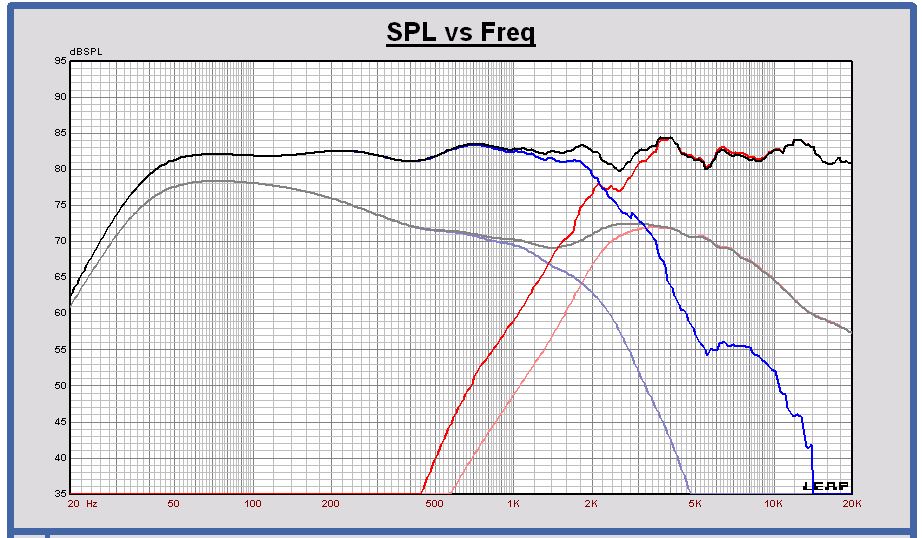

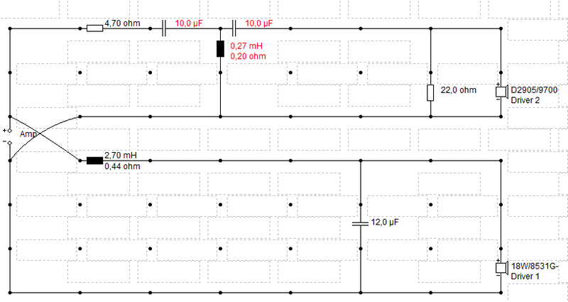

I think I understand why you find your filter 04 better playing. Look to the voltage response of the tweeter with this filter. Compared with the previous filters, it has a boost at 2500Hz and it creates more total power at that frequency in that way. It is too much to post now , but I see that the total power response with filter 04 becomes more flat in that way. The off axis responses are not so nice to see with this filter, they show a boost at 2500Hz. I will post all later.
I will look further to the design. I will try to make the power response more flat. Now there still is a serious power dip between 1 and 2kHz. The reason is the 7.5 inch (Sd=150cm2) on this baffle and the electrical filtering we have to apply to cancel the boost. Maybe choosing the X-over frequency at 1500Hz (if the tweeter can live with it).
Voltages filter 04

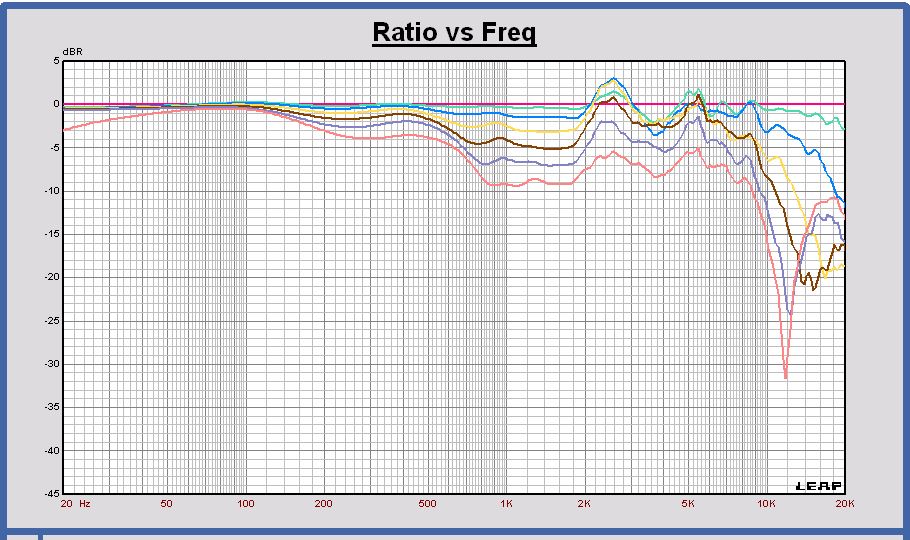

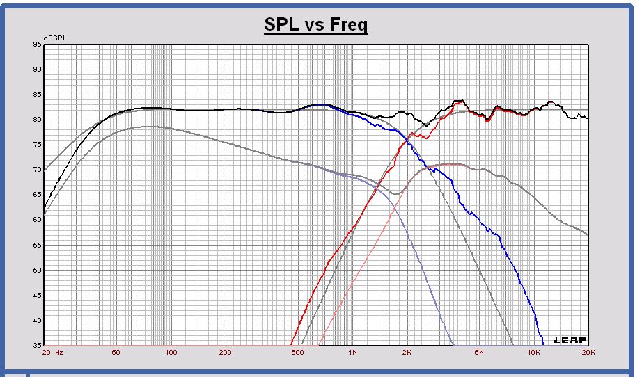

These are the horizontal off axis responses and power response with filter 04.
SPL horizontal 0 15 30 45 60 75 90 degrees
The off axis SPL is normalized to the 0 degree response.
You can see the impact of the boost at 2500Hz of the tweeter filter 04.
That is not so good.

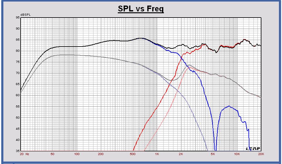

SPL and Power response with filter 04
Power responses are the lower curves in the plot.
You can see the power dip between 1 and 2 kHz. Also observe the power peak at 2500Hz due to tweeter filter 04.
The overall power response has to become more flat. We will try to improve this if possible...

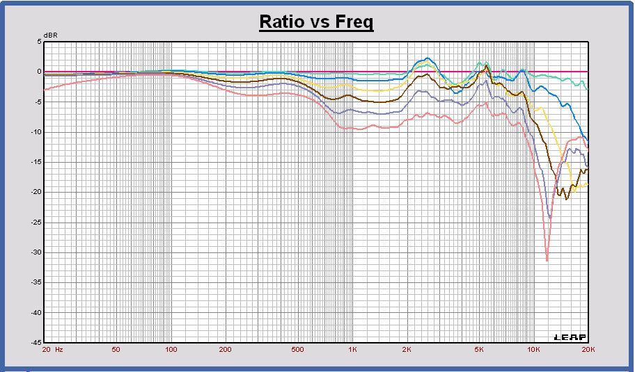

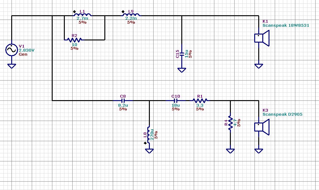

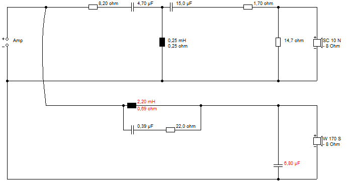

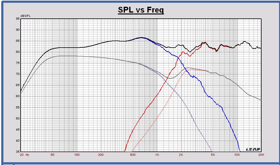

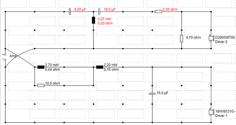

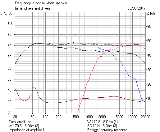

Filter 05, a design also focussed on the power response to be as flat as possible. I have made the best I can at this moment.
There are some problems with this speaker setup. Especially the tweeter is positioned to close to the top, with a serious impact on the horizontal off axis response, that could be better.
These are the responses.
schematic filter 05
serial resistance coil 0.82m/0.30E
SPL and power response filter 05
The power responses are the lower curves.
The power response is a lot more flat with this filter compared to filter 04.
Horizontal 15 30 45 60 75 90 deg response normalized to 0 deg response
The horizontal off axis boost at 2500Hz is caused by the tweeter position too close to the top of the cabinet.
Later on we can try to attenuate the SPL at 2500Hz on axis.
Better to listen first to this filter.

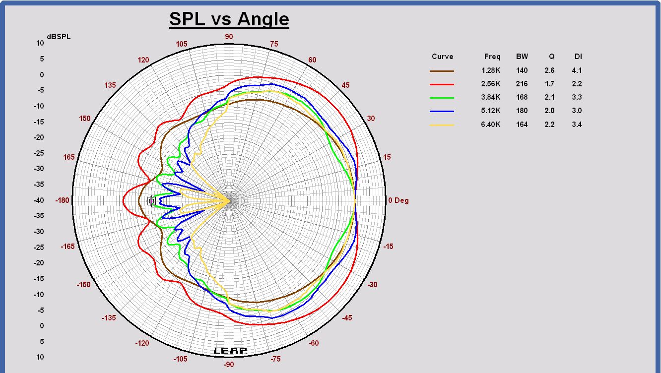

As an information, the polar response of the tweeter in the cabinet. Responses are normalized to the on axis response.
Polar response tweeter in enclosure
1.28 - 2.56 - 3.84 - 6.4 - 12 kHz
This is not so good and completely caused by the tweeter position on the front baffle. And of course this cannot be solved by the X-over filter.
schematic filter 05

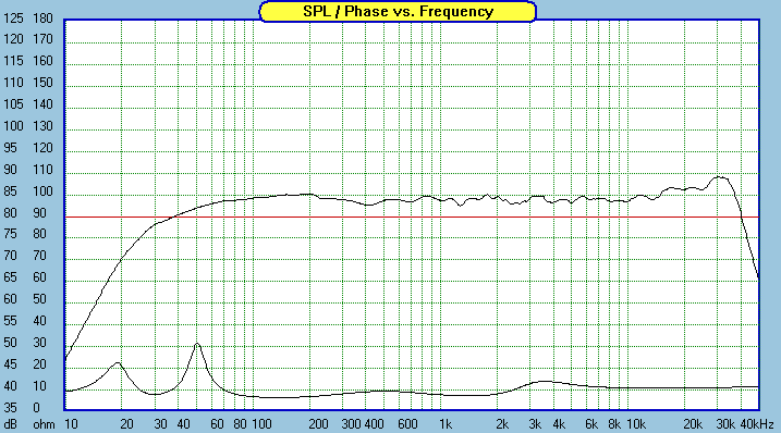

from zaph site:
Actual measured response is very close to the modeled with the biggest difference being in the 400-500 Hz range. Seeing as the impedance curve with the crossover in place is exactly the same as the modeled curve, this is likely due to a mild difference between the individual driver measurements used in the model, and the system response curve. The model uses on-axis data with piston based off-axis simulation for a given mic location, while the actual measured system response is real. The mic location for the woofer response used in the model is 6" lower that the mic location used in the measured system response. Some floor bounce still comes through a bit in the nearfield woofer plots with diffraction added. This floor bounce is at a mildly different frequency and level for the measured system response compared to the driver curves taken for modeling, and the difference presents itself in the 400-500 Hz range. This is more than anyone wants to know, but I like to have a perfect grasp on differences between modeled and measured - even if it's only 1dB.
Measured frequency response on-axis, 10ms window
where is the 500-1000hz bump??

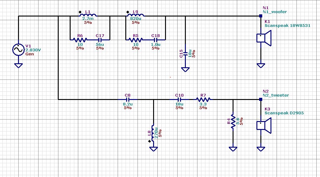

Paul, could you simulate this?
I'm listening to it now and it's very neutral an natural, non audible bump on 500-1000hz. don't ask me why 🙂 but I'm very happy for this.
I only would need an help on the tweeter section, as the mid-high frequencies are little back, I think starting from 3khz....voices are backward. it needs some brilliance more.
thanks

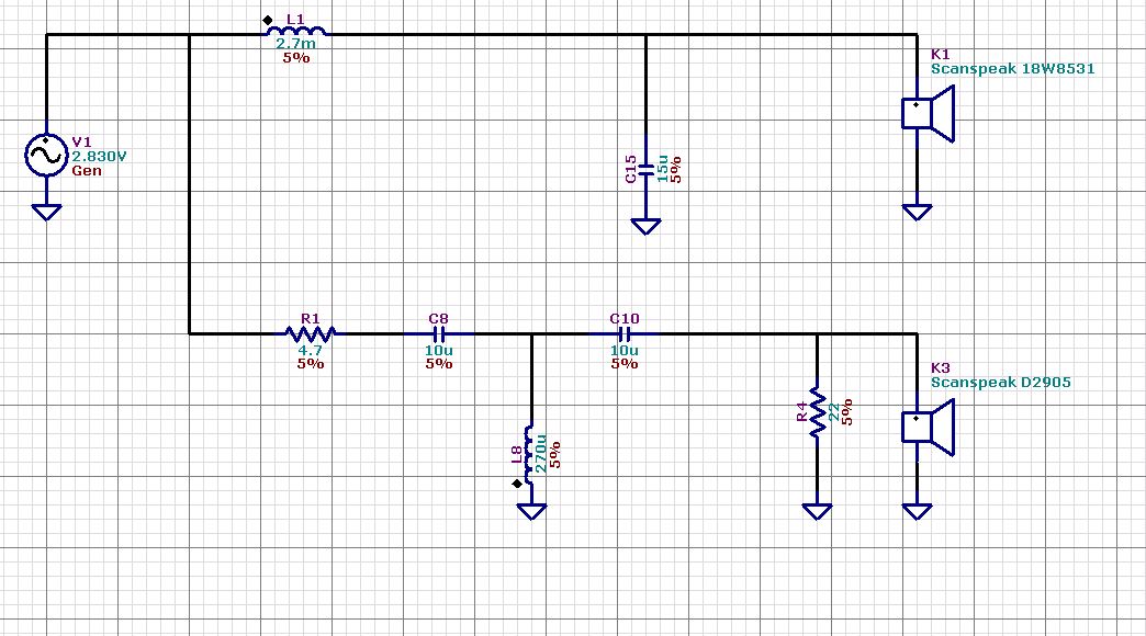

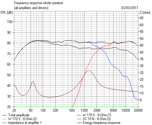

Here are the results of filter 07 🙂
schematic filter 07
C15 changed to 12uF
SPL and power filter 07
C15=12uF
Cucicu, maybe listen also to filter 06, which is more flat for low frequencies. In the case your drivers are conform the specification.
