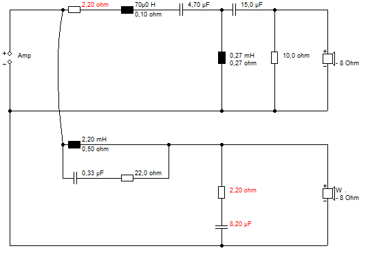

The 0.07mH coil is just putting back the tweeter voicecoil inductance which tames the rising top. The drop from 5.6R to 2.2R gives you the +3dB you want. Impedance doesn't change significantly, though it's actually a bit low in the SP95 at about 2.5kHz. About 3 ohms.
These ideas apply to any filter really. It would work with a parallel filter too. But I would want to sim any chosen design to be most exact on a modification.

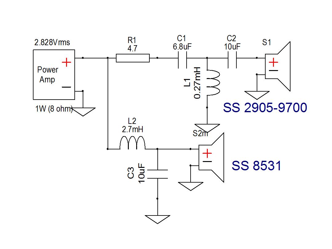

I have just tried the filter of sp95 with your modifications and it sounds good but i don't like the paper sound of the 18w. Too much mids frequencies....sound is too lushy, too fat in other words...i also tried to bump the damping inside the cabinet on the rear of the woofer but it doesn t have effect.
I would prefer a parallel filter to try to eliminate that excess of 500 -1500 hz...i tried also 2.7mh-10uf-0.47mh 3rd order: it looses basses but mids are always there...can you suggest anything?

You have paperish sound most likely due to a present cone resonanse or low tweeter level compared to the midwoofer. Troels prefers to tune his speakers with 1.5-2db recessed tweeter level, it makes sense due to the way our perception of sound works. He likes it this way, I don`t because to me some instruments sound unprecise this way - one very good example is the accordeon. It will sound unnatural no matter what you do until you equalize tweeter and midwoofer level. BBC did introduce a dip in the freq. response to reduce the lushness of mezzo-soprano vocals and push them a bit backwards but retain higher tweeter level in the upper octaves and many commercial (successful) designs using this approach are being liked by the public.
That all being said, I`d suggest if you now use the SP95 crossover, reduce the 5R6 resistor and increase the 6.8uF cap to 8.2uF and see if it clears up. The efficiency of the 9700 is lower (up to 3.5Khz) compared to the 9500 and it does not exhibit the broad peak at 1.6Khz, I am sure this peak has been addressed in the SP95 crossover and this leads to an even bigger difference in levels between the two tweeters. The 9700 has a stronger peak at Fs due to the (possible) lack of ferrofluid in the gap, this will need its own RLC circuit or at least a parallel resistor ir it will ring at the right frequency. The two tweeters are not interchangeable, each requires its dedicated crossover.
I would tweak the midwoofer crossover too. Increase the 2.2mH coil to 2.7mH and reduce the 6.8uF cap to 5.6uF or even better - to 4.7uF. You can ommit 3R3, it is there to shape the knee and allow better phase tracking but in your case will complicate things a you lack measurement equipment. The RLC network introduced on the midwoofer is not necessary for good sound, the larger coil would do the job. Instead of buying a new coil, drop a nut or bolt in the coil gap and test this way, you can vary the level by introucing larger/smaller ferrous pieces.

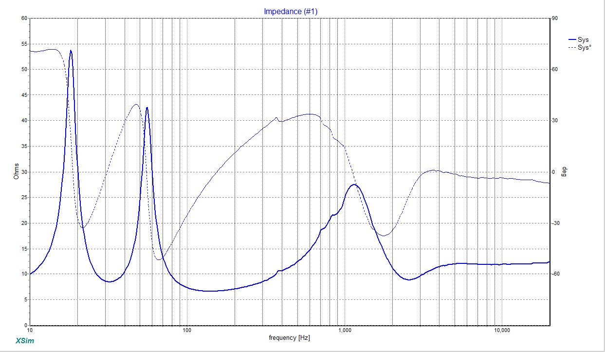

Hi everbody and thanks for all the replies!
sure I can give any detail about my building: the box is the same of Troel's SP95. My idea was to build the SP95 but the seller sent me the D2905/9700 instead of the D2905/9500 that I've ordered, and he told me not to care about his mistake 'cause both tweeters are the same 🙁
@ Lojzek the quotes of the baffle are the same of the picture, so also the position of the drivers on it. Internal netto volume is about 32 Liters, bass reflex is in the bottom of the speaker (like ProAc d28) . Port tuning is 34 Hz (ID 66x170).
Internal Damping is :
-2mm bitumen pads + 10mm felt
-30mm smooth foam.
Ask me for any other detail, I hope all these can be enough for you to help me.

I made an impedance measurement and i have not any issue...
