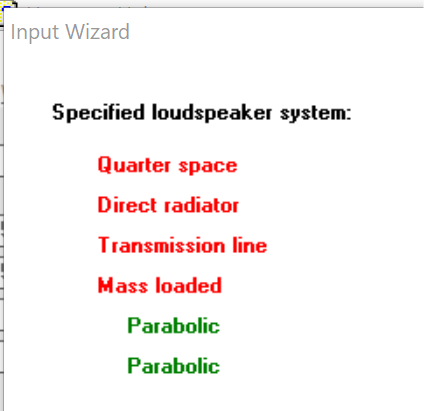

Hello @nandappe .
Thank you for sharing your learnings and knowledge. You have inspired me to purchase a pair of SB20FRPC630-8s and build a Voigt pipe for them.
I am open to changing the cabinet dimensions to tailor them for the drivers and hence I'm trying to model them in hornresp to find the optimal dimensions.
Given that I intend to place the pipes close to the front wall, are the below selections I've made for the input wizard correct? Thank you in advance for any guidance you can provide me.
  • Thank You
