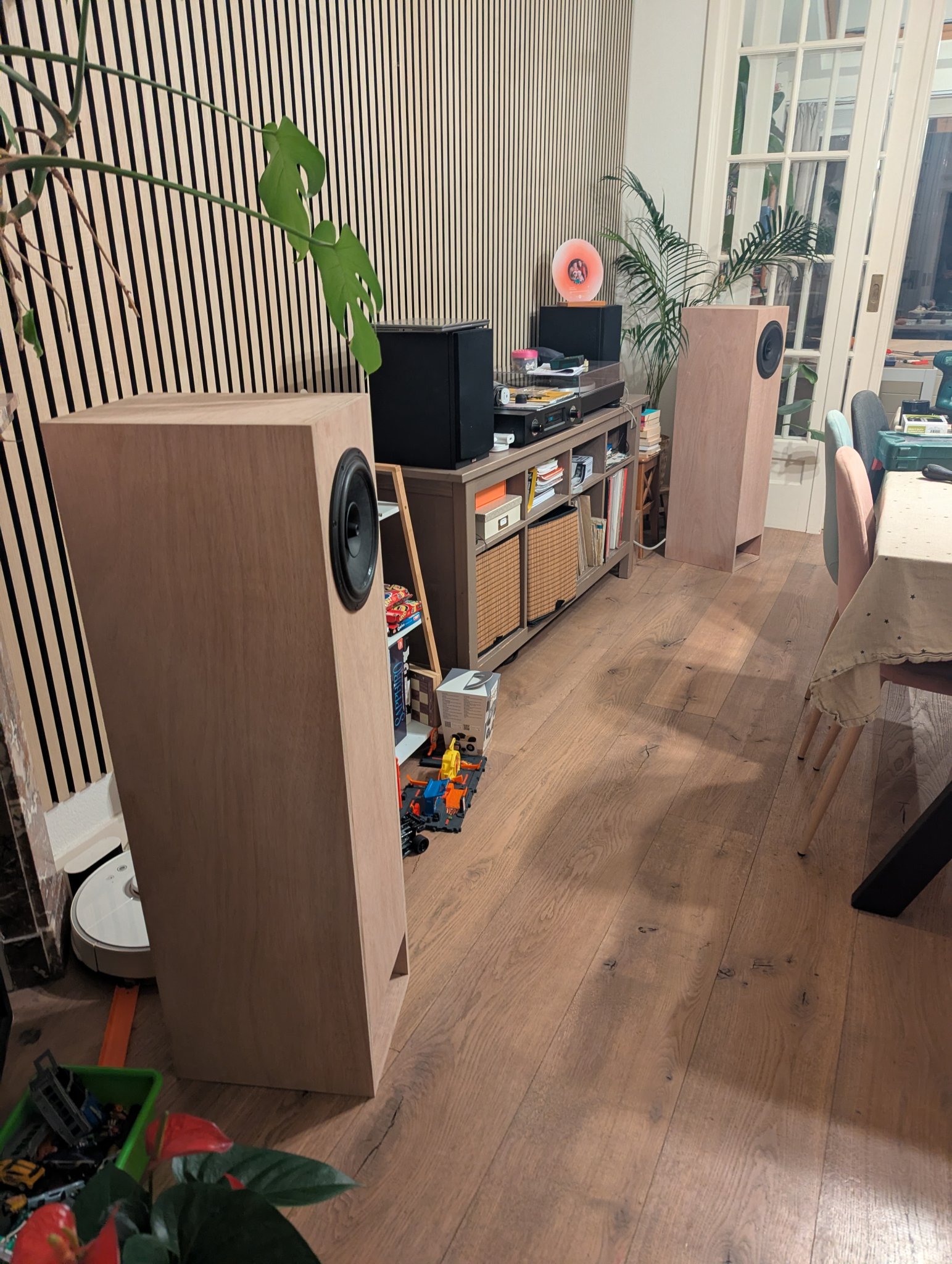

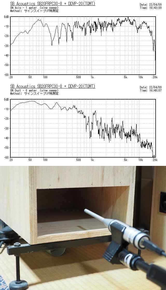

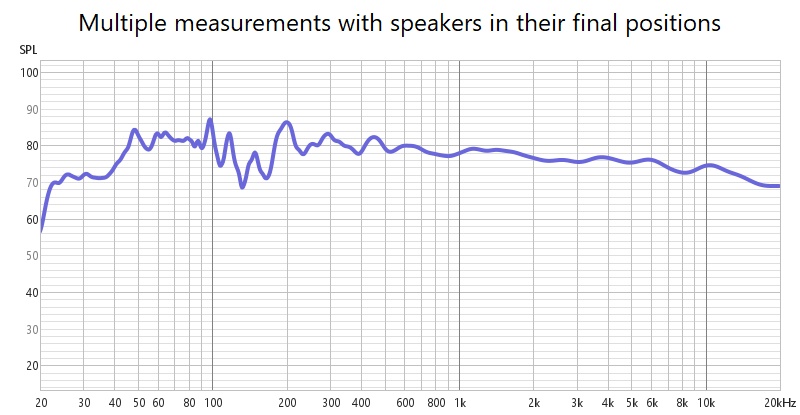

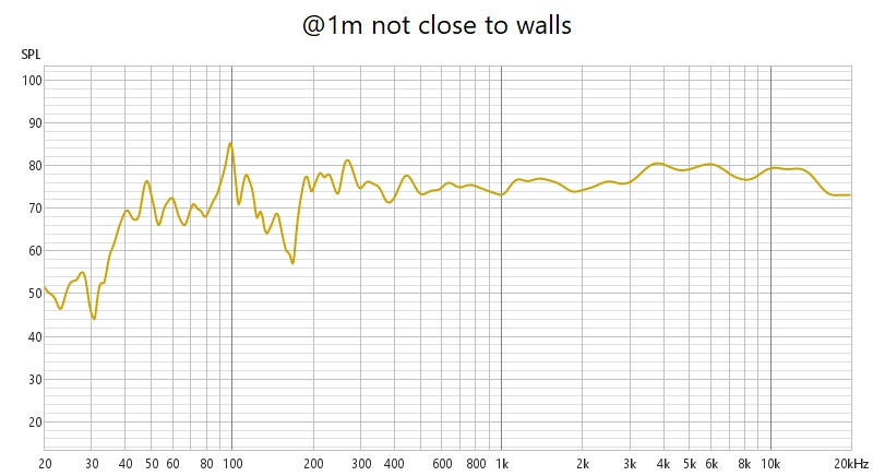

I just finished my build of ddvp-20 with sb20frpc30-8; lovely project to keep me busy.

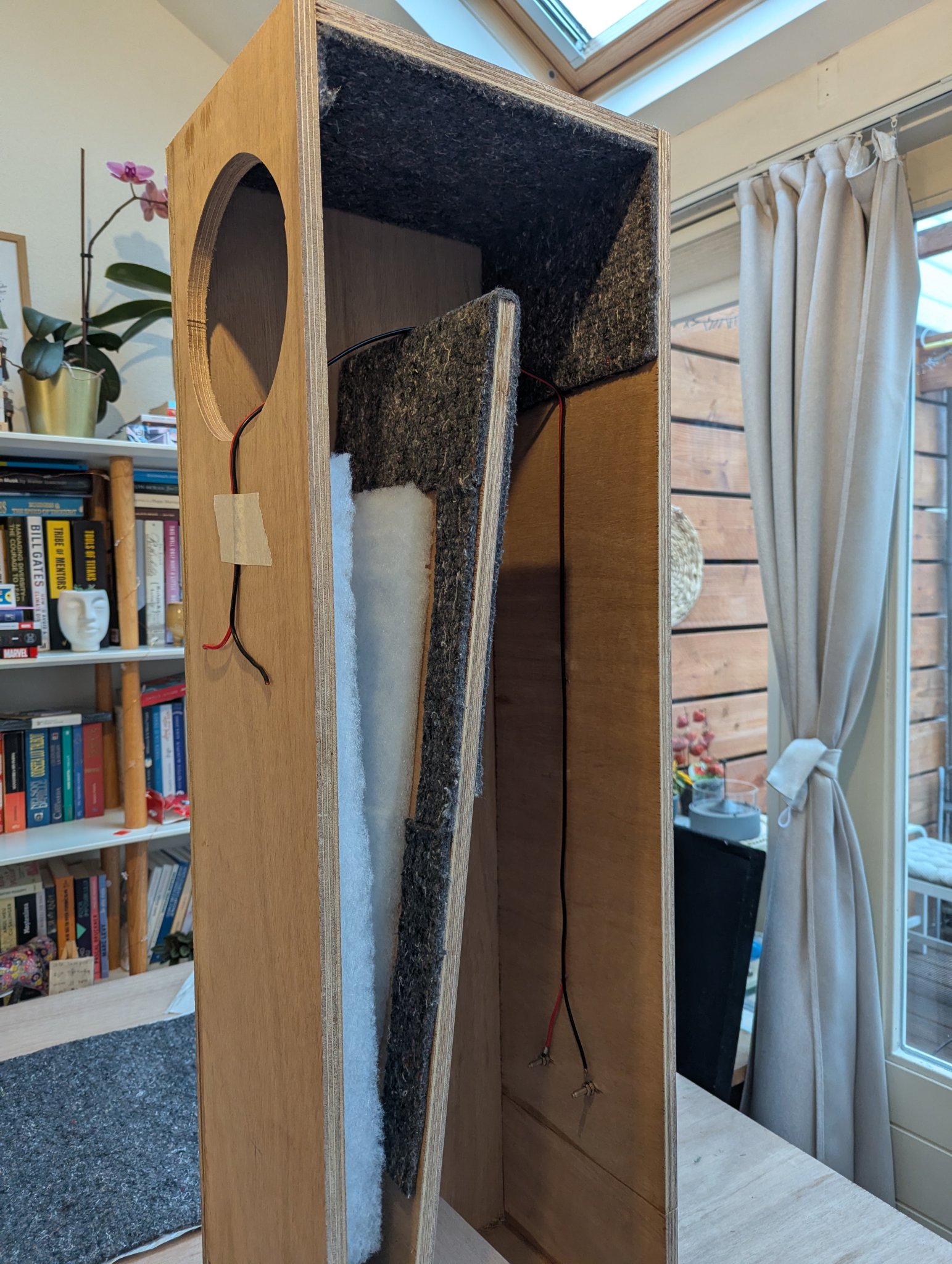

I got a dip between 120-180hz and then a huge drop under 50hz. room placement creates some manouvering space to correct it, but that dip is weird.
Could it be due to the damping i used?
I's polyester wool and cotton felt 6mm thick.
Thanks!
It could be the design, but I think that’s probably floor bounce cancelation. It’s normal and the only way to do much about it is to mount your driver near the floor, which will actually just move the frequency higher. If you can live with the aesthetics, you could put a thick rug on the floor in front of the speakers which should help all around.
Depending on the microphone distance, it’ll usually occur around 150Hz for a driver mounted around 3’ above the floor.
Lovely speakers btw! How do they sound?
Hi cata02, thanks for the follow-up.
I use lightweight sound absorbing materials that contain a lot of air.
The picture looks like it is 4-5 times heavier than mine, but you can adjust the sound absorbing material to your preference.
Also, the box is raised 10 cm from the floor.
Resonant boxes always produce peaks and dips.
The frequency and sound pressure of the peaks and dips vary with the size, shape, and installation position of the room.
It is noticeable when playing a sweep signal, but it is often not noticeable in music playback.
I hope you can try different things and improve.

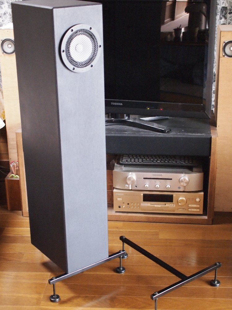

I like the sound of the whole box ringing, so I use hollow pipes to float without blocking the bottom.
Reactions: LeifB60
If you measure at the opening of the pipe you should get good output at the fundmentl resonce say 50 Hz and hopefully not so much of the third fifth and seventh harmonic at 150, 250 and 350Hz
Mesure the driver at 1-2 cm distance and you should get a sharp dip in output at 50 Hz (maximum radiation resistance)
If you get output from the harmonics try more stuffing between the driver and the closed end.

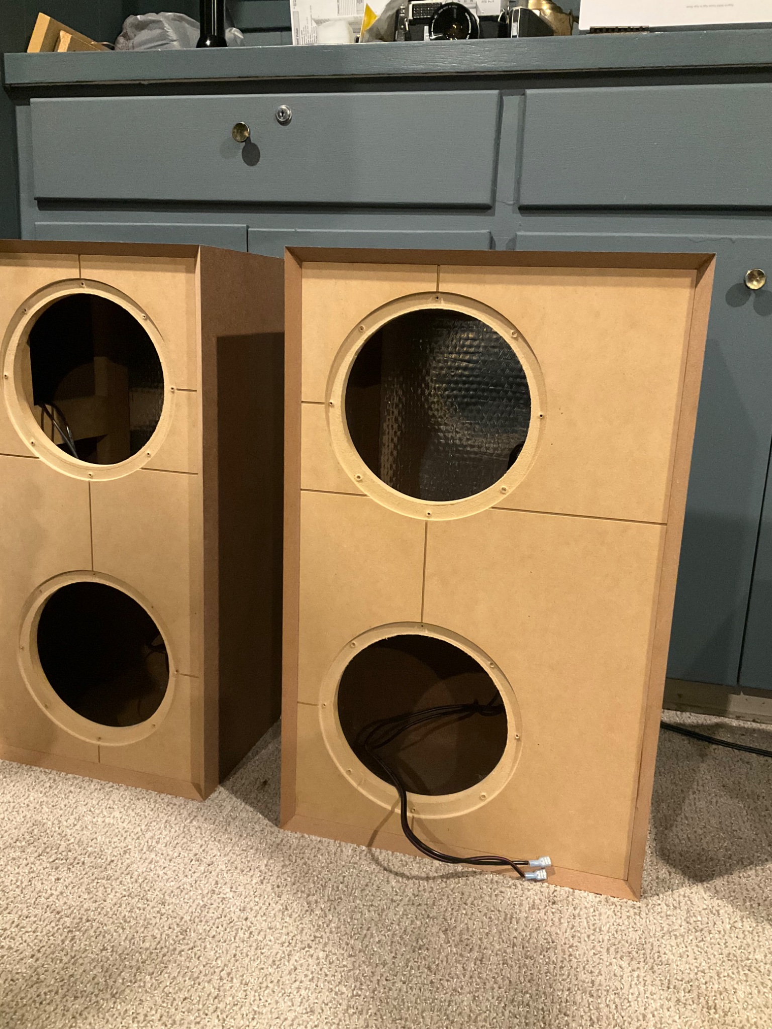

I built sealed 1.5 ways in 40L total giving 25L to the SB20FRPC30 and around 15L to the SB20PFCR30-8. This gives both of them nearly identical roll offs and a Q of just under 1 if I remember correctly. F3 is only around 70Hz, but with the combined SD and mid bass bump they sound pretty impactful and like they play lower than that (and in room, they do). The upside is that I get almost 94db in a reasonable box.
Here’s what they look like disassembled and waiting for me to get around to veneering them. Not stand mounts, but reasonably small imo.

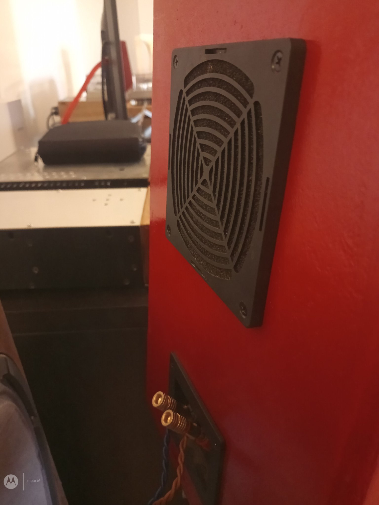

Stanislav Hi Can you share the build details of aperiodic box very keen to try it out
Hello Tiger,

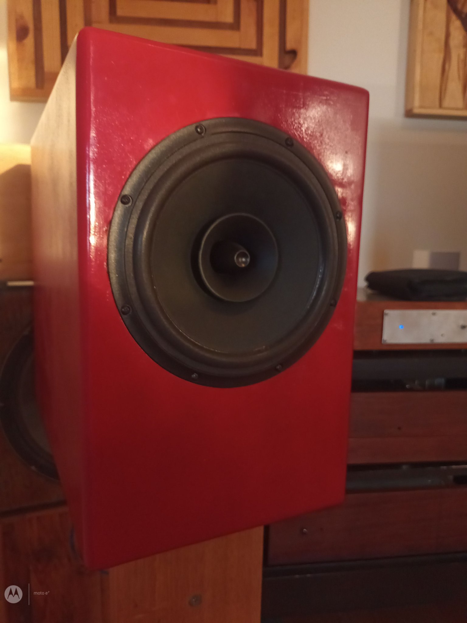

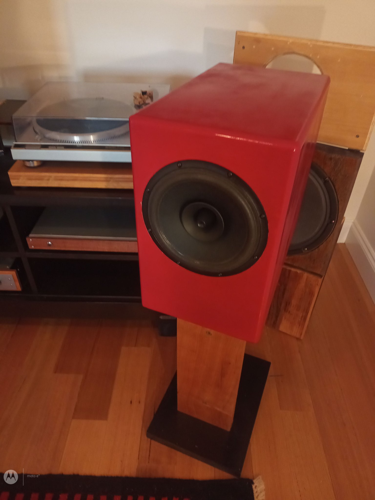

The aperiodic box is just an extension of the closed box, you introduce a resistive vent, a hole usually at the back which is stuffed with sound absorptive material, foam, felt, etc. Nothing fancy. This greatly reduces the peak of the impedance at resonance.
I used Basta to model the enclosures with QL = 3, with 30L volume that bought Qt to 0.707.
You see the aperiodic vent in the middle photo, there's some felt behind that fan guard.

I think I was considering those same fan guards when I was planning to go aperiodic, they’re the cleanest looking ones I found and come in a lot of sizes. How much felt did you need to bring the peak down? And did you try it sealed with the higher Q to compare?
@satx: I started with 2 layers of felt, the type that removalists use, but any felt will work.
Then testing with LIMP and checking the impedance peak and also listening to selected material that I know well. Preferred the single layer. The double layer took too much of the life of the sound IMHO.
No, I did not try sealed, always been a fan of the aperiodic boxes which sound open, non-resonant, similar to open baffles.
Re. the fan guards, I also have a pair of the old Variovents, but am keeping them for another project with a much bigger double aperiodic box. Something like some of the old Dynaudio speakers.
