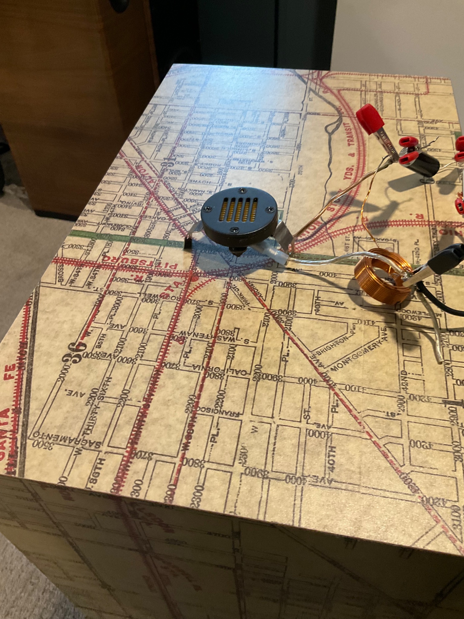

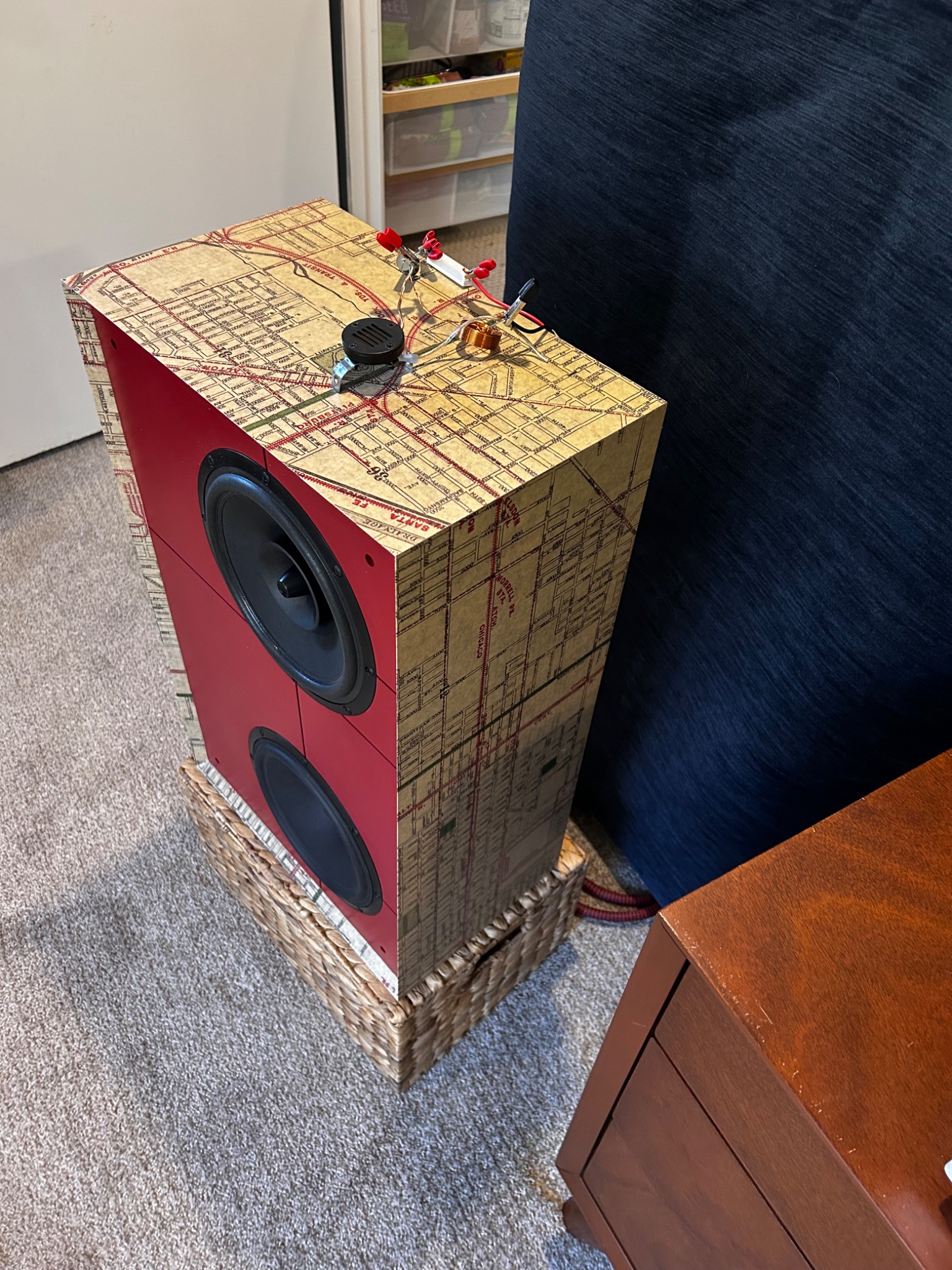

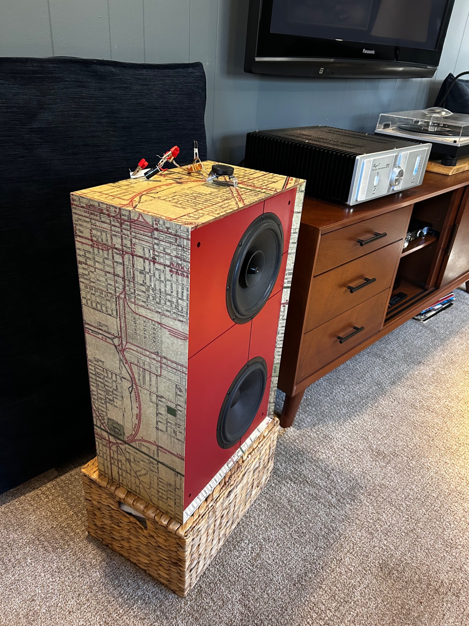

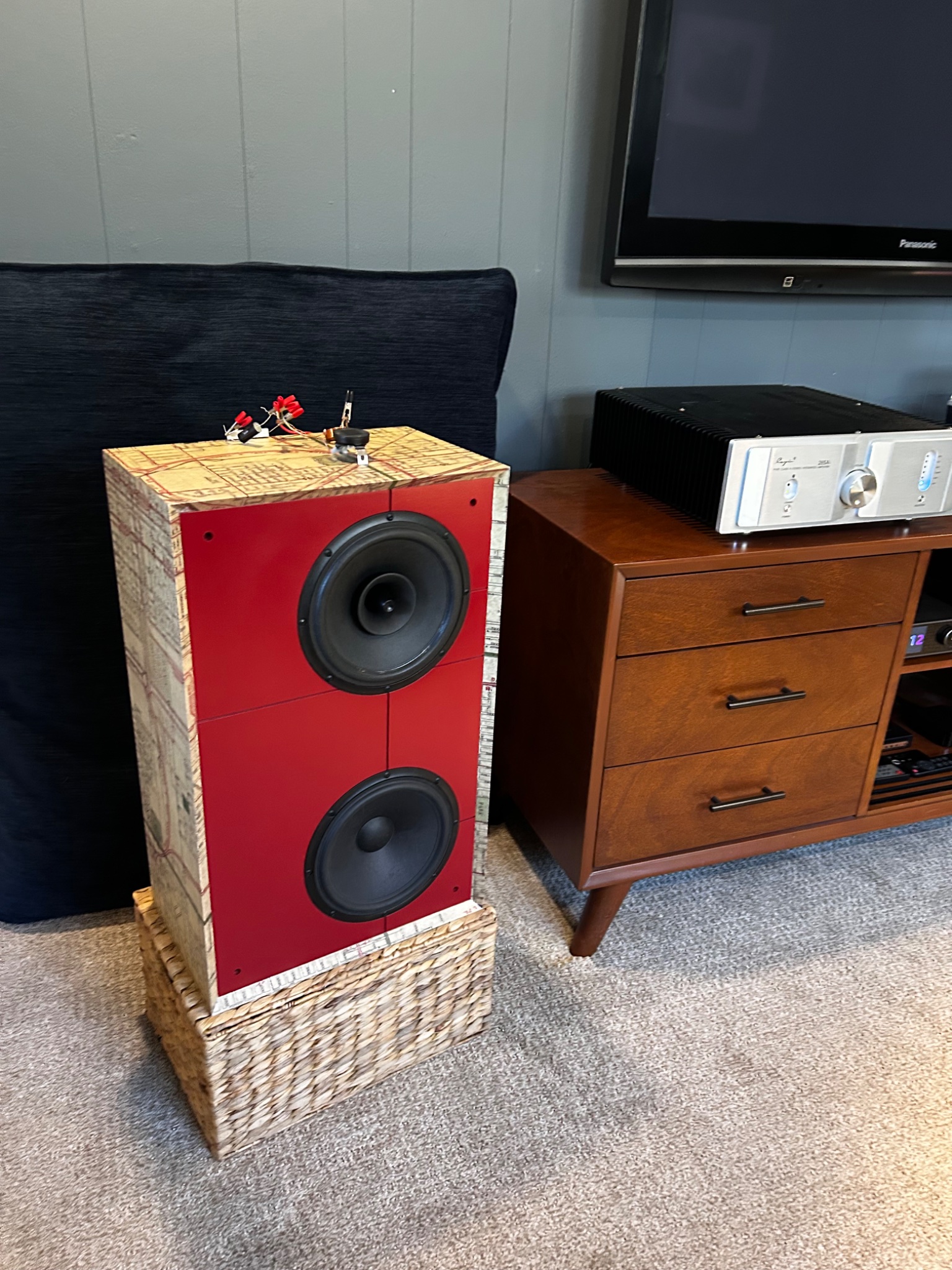

I finally got around to finishing my 1.5 way. After waffling on what veneer to use, I went with tissue paper, smh! It’s called decoupage and I’ve never done it before, but it was pretty easy, fast and inexpensive… It turned out pretty cool too if I do say so😎. It’s finished with a simi-gloss water based poly, but it’s hard to photograph. There’ll be an inset grill with green cloth and a short green stand eventually too.
They’re a touch brighter than I remembered though. I voiced them in a different space with a different amp and now I think it needs a bit more baffle step, ie bringing the FR down to match the sensitivity of the woofer. Right now it has a coil with a built in notch on the woofer and a parallel notch (in series) on the FR and that’s it. So no crossover per se and I’m wondering if I can just put a resister in series with the full range to pad it a bit? Maybe doubled up? I just need 1 ohm or less. Can I do that even though it’s run full range?
FYI, the tweeter on top is just a super tweeter that I was playing with when I designed it. I’ll use it, but for some reason I didn’t build it in.

Ah, simplicity… if only I was that smart! I already adjusted the filter though. No series resistor, but the breakup needs some good correction for everything to sound natural and I added a zobel to the woofer to hit a true 1st order slope which controls its breakup region better too.

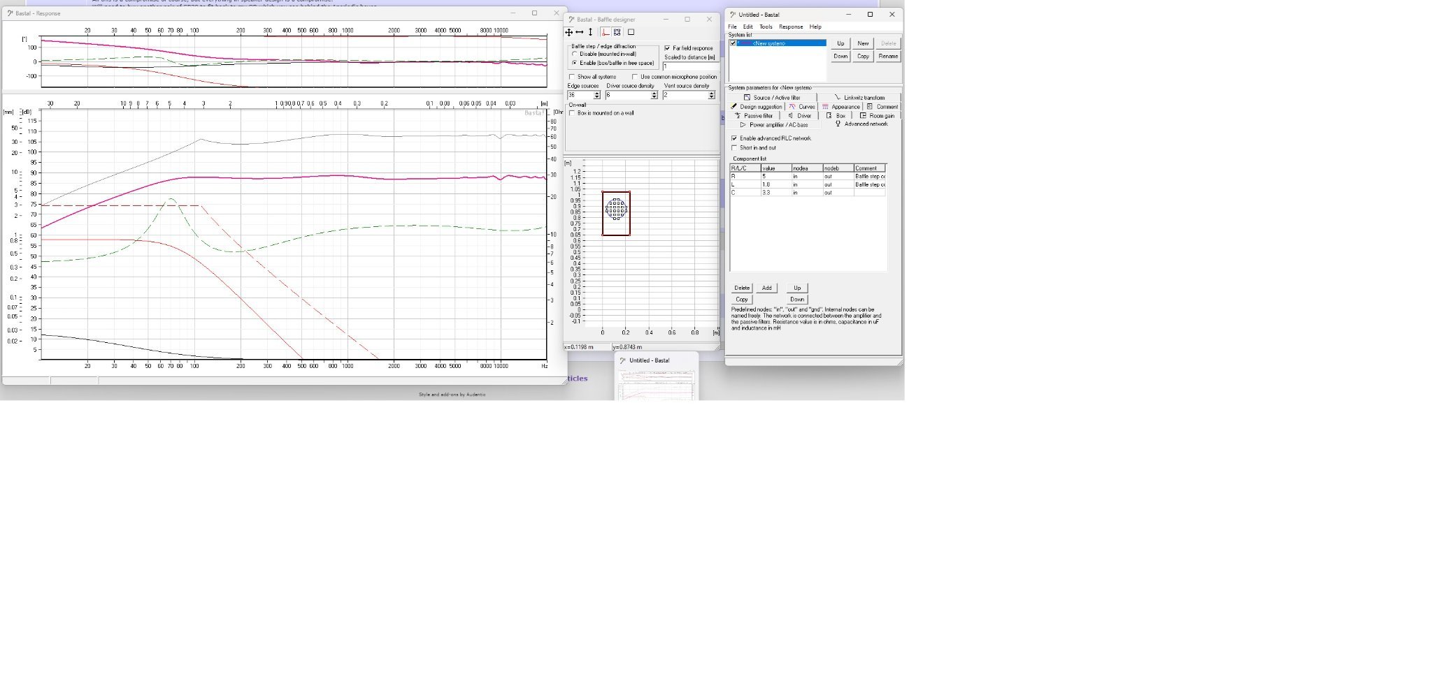

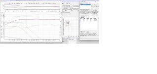

Have a look at the attached file which shows the simulation of the speaker in its box, QL = 3, with the parallel circuit in place. The simulation is done in Basta!
What you see is the L and R take care of the baffle step, and consequently lower the SPL, and the C raises the upper part of the freq. response to make it more or less flat.
I think you can simulate that in VituixCAD too.
Play with different values and observe the response. My values are not set in stone and slight variation may satisfy other tastes. I am currently using R = 3.9 ohm as that is what I had at the time, but listening tests told me that R should be higher, 4.7 - 5 ohm preferably.
