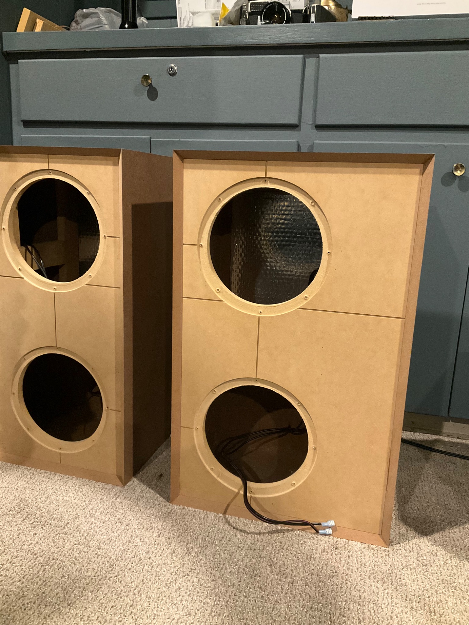

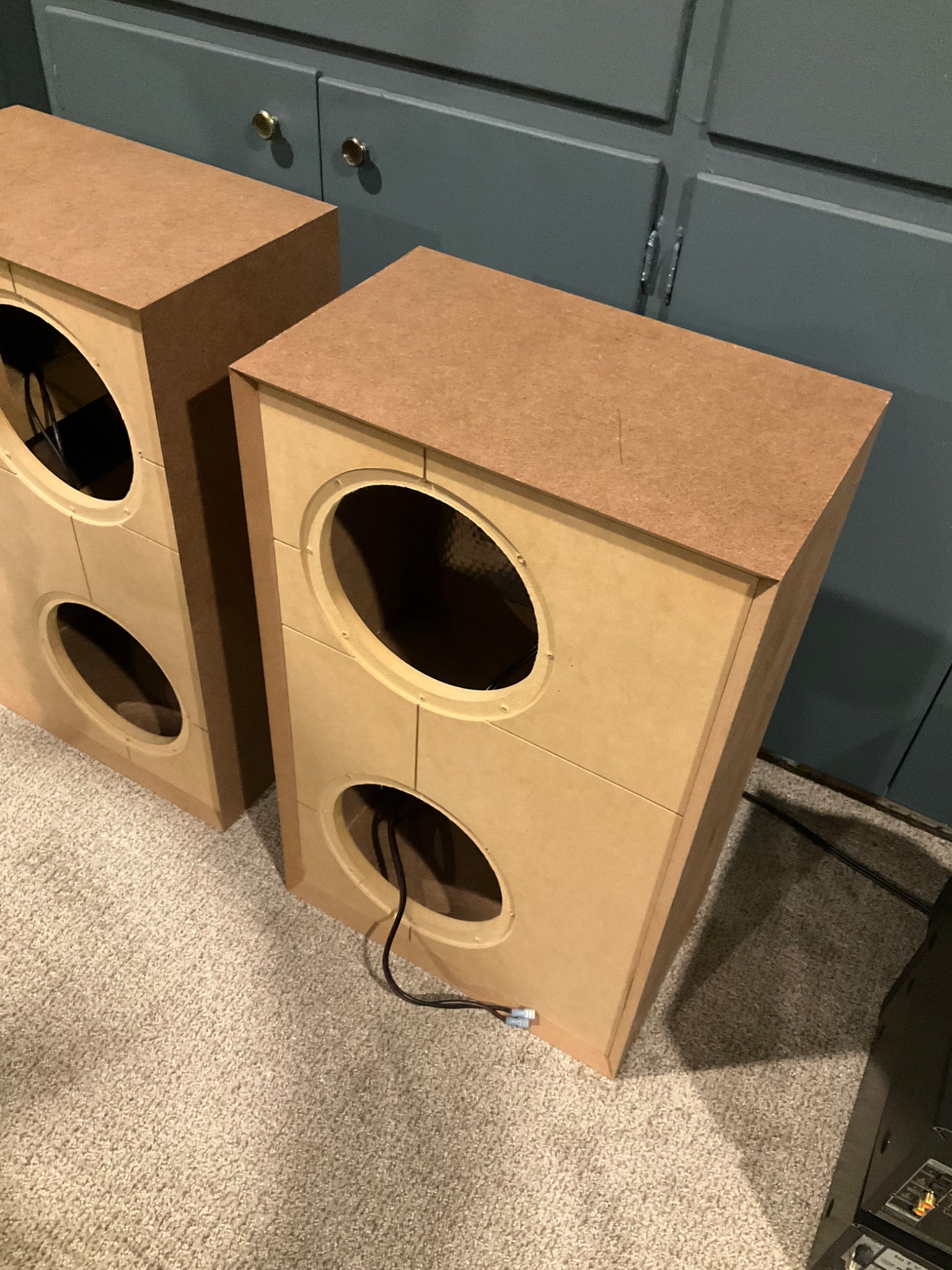

Wery nice.How small is small? You might be able to get down to 50-60L with a PR, but that’s just a guess. I found them really good sealed though in as small as 25L. It all depends on how low you want them to go.
I built sealed 1.5 ways in 40L total giving 25L to the SB20FRPC30 and around 15L to the SB20PFCR30-8. This gives both of them nearly identical roll offs and a Q of just under 1 if I remember correctly. F3 is only around 70Hz, but with the combined SD and mid bass bump they sound pretty impactful and like they play lower than that (and in room, they do). The upside is that I get almost 94db in a reasonable box.
Here’s what they look like disassembled and waiting for me to get around to veneering them. Not stand mounts, but reasonably small imo.
View attachment 1414151View attachment 1414152

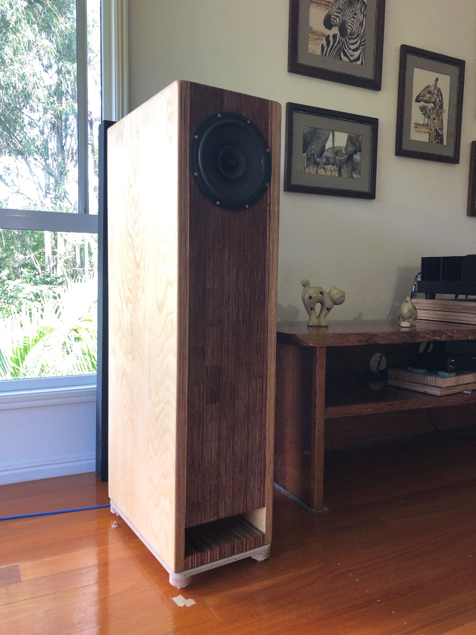

A photo of number 11. 24mm Birch 🌳 ply sides and cut LVL front, top and back.

Very nice Johnny! I love the contrast between the front and sides. The LVL is a nice touch as well. Can you share internal and external details/dimensions? Single fold/baffle inside? Is it a DDVP-20?

So, it’s a single fold… but the narrow part is at the back of the cabinet ( following suggestions by Janos on Real World Audio YouTube.
The mouth/port is 70mm high and 70mm deep from memory (sorry I’m on holiday so I can’t measure it or find a pen 🖊️ to draw you a diagram..)
Internal width is 225mm.
Outside, 1100 high, 480mm deep.
The sloping Center piece is 2 pieces of 25mm hard eucalyptus plywood with mass loaded vinyl in between. ( I’d like to try green glue).
I have access to 40mm x90mm LVL structural beams. So I cut them to 30mm and re glue them back together to form a 30mm thick panel, with the pieces in a brickwork pattern.
These panels become the front, top and back of the speaker.
The idea is that it behaves like an acoustic guitar 🎸 top plate( the bit with the hole in it).. All the timber grains are in the same direction.. ( Janos says build your Voigt pipe like a musical instrument… Mostly I believe what he says!!!
the solid timber boards required to achieve the same goal are going to be Very Expensive in today’s world, so this is My way around that..

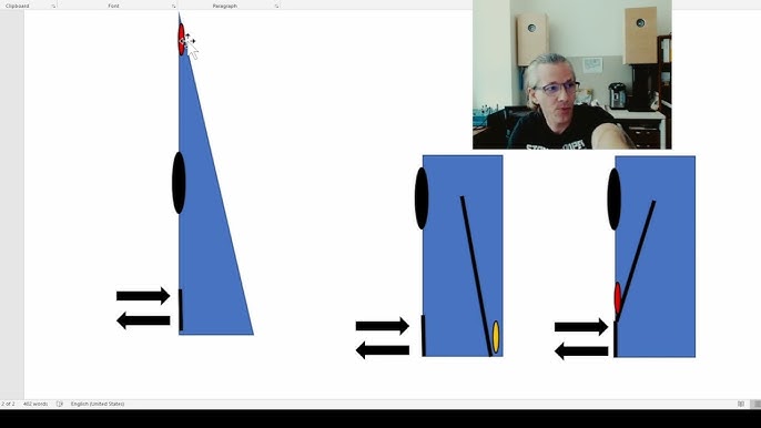

Very cool! I’m going to have to check out this Janos guy…
I’d love to see a plan, even a simple sketch of the design you’ve developed. I’d ask more questions but a basic drawing would probably answer them all. I’m heading away for a holiday as well so no rush. Again, very nice result!
Edit: Oh, like the middle design shown here? I was trying to picture what you meant by “narrow part at the back”. Very interesting!
Ah, it looks like you found Janos!!
I have also learned a bit from Harley Lovegrove ( YouTube) about developing his Sibelius speaker. Also folded voigt pipes.

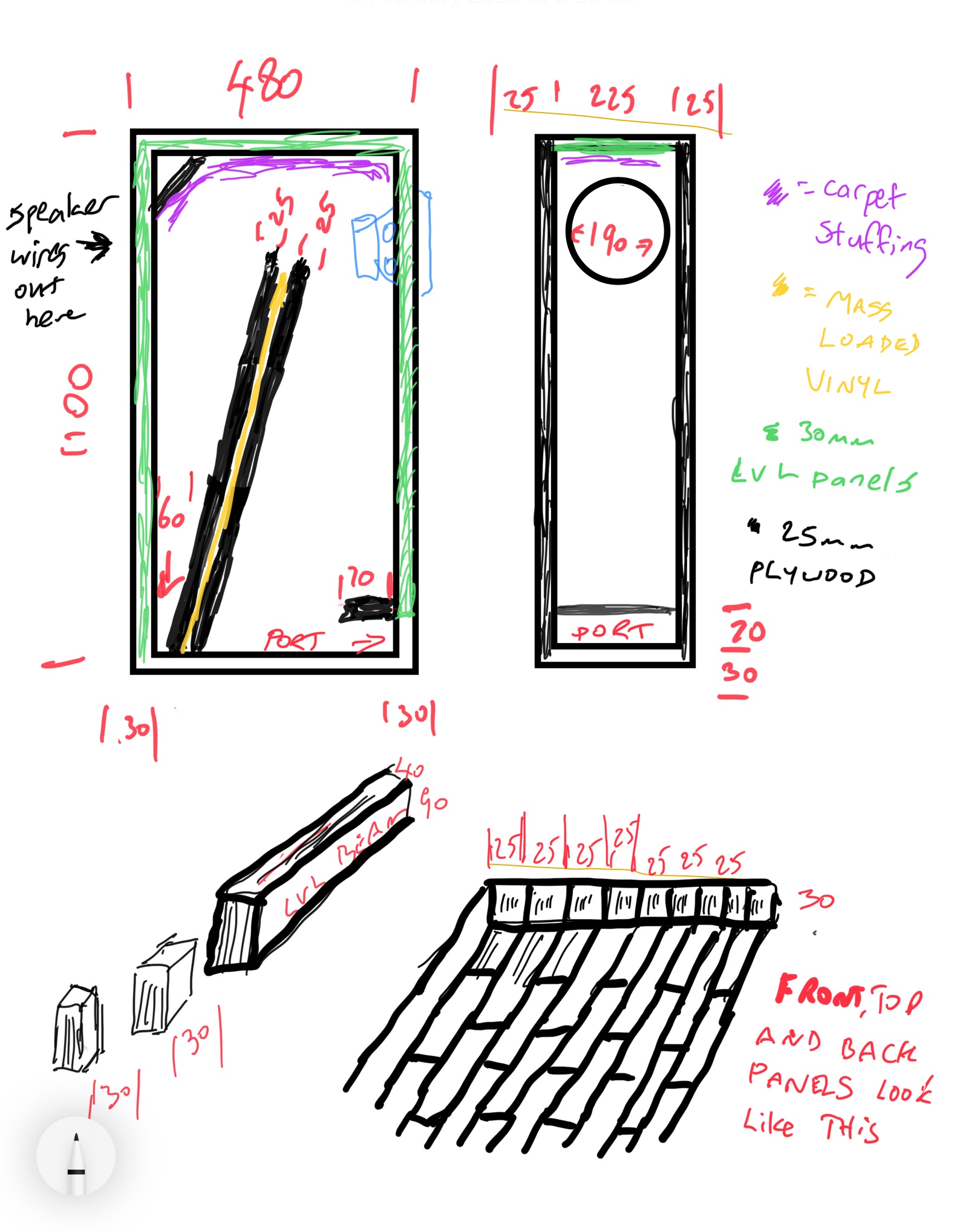

So I managed to draw up my design on the iPad!! I have tried nearly every depth from 370mm to 480mm. My room is large, so 480mm provides more bass, not necessarily lower htz.
Instead of LVL beams, on older speaker boxes I’ve cut 25mm plywood Into 30mm Strips rolled them 90 degrees and glued them into panels.
This will give you 1/2 of grain running front to back, but the LVL has better dynamics and detail.
I hope the drawing helps a bit.

Nice job on the drawing! The color coding makes it very simple to interpret.

The good part about this type of design is that it’s all rectangular/ square so the wood work is pretty simple..
The original design from Nandappe uses 15mm plywood… personally I can’t recommend thin plywood as I like a fair bit of volume to my music and even my first 18mm Malaysian hardwood plywood box resonated pretty badly!!
It loved Michael Buble though!!! 🤣😂😆.
I found that to my ears, if the box is too stiff, it reduces the detail..
Janos recommends Strong sides and softer front, top and back, and probably that’s true.
On a straight Voigt pipe ( I’d love ❤️ to build one, but the Lady Wife will send me to the Doghouse as they are a bit ugly… so, it isn’t worth it!! 🤣) , the back panel resonates into the room.
With a folded pipe, I believe that the “ middle sloping panel, corresponds to the back panel, so you don’t want the sound vibrating from the front to the back of the pipe, as I suspect it muddies things, hence the 2 x 25mm panels and MLV or green glue in between..
With the port tuning, I used to have 100mm high port and 100 deep in the past, but I added a 30mm piece of wood in the slot and the bass went noticeably lower in htz, and felt happier with the balance of sound, so now I stick to 70mm high.
Probably I should do more tuning..
As Janos suggests your room might prefer different tuning… or it might suit your musical choice better, so maybe you can plan something you can adjust, but these are some starting numbers!
If your listening room is “ normal sized”, like 4=5 metre x 4-5 metre you may be happy with just 370mm deep boxes.. especially if the boxes are close to the corners..
Speaker stands, as simple as blocks of wood 30=40mm high will tighten your bass response.
Plan to remove the drivers to adjust the “stuffing”… I made a box with a removable lid, but my gut feeling is that the removable lid messes with box rigidity…
Enjoy 😊 the journey! With SB Acoustic 8 inch drivers, it’s cheap fun 🤩!
I believe you will know when you want to spend more on drivers!
Always happy to help! 😀
I love your enthusiasm!
Try not to make 11 boxes as I did! Hopefully you will get Amazing results

I'm building a new surround set up and am currently really liking the sound of full ranges, I'm currently using a 11ms 2 way set up but the spl requirements of a cinema are pushing me towards the 20fr.
I have a large ~140m3 room with some room treatment at 1st reflection point to etc.
Anyway I'm wanting to build both a sealed box and maybe a karlson to compare as I am a bit concerned about the of axis response.
Any recommendations for a karlson plan if the one linked #752 isn't recommended?
Cheers in advance

for a movie setup, I think going simple is the key here.Anyway I'm wanting to build both a sealed box and maybe a karlson to compare as I am a bit concerned about the of axis response.
Three SB20FR L/C/R in sealed boxes and the same for surrounds, then channel anything below 80Hz to the LFE using multiple subs to deal with nodes should be a fun setup. There's nothing to gain by going Karlson in this case.
This is what I was thinking as well. I have a good bass set up currently with 4 corner loaded tpam htl subs (modified tham 10s).
I guess iv been looking at karlson for a while and almost want an excuse to try haha.
Iv ordered them now and thinking the benefits of sealed are winners so it will be a 7.4 set up.
The price is good enough that I may even look into doing atmos with the sb20fr as well, time will tell
