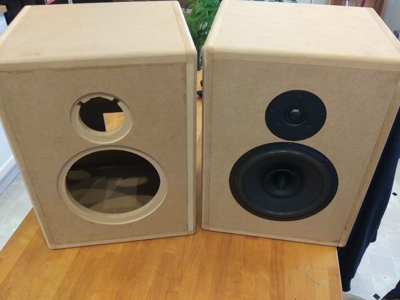

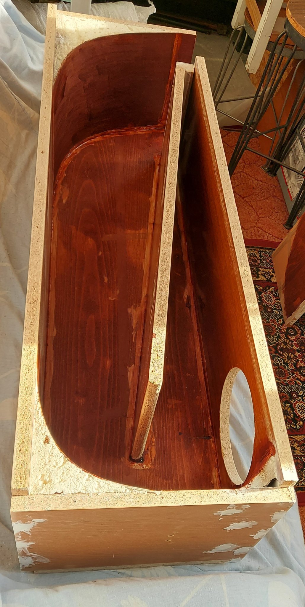

That enclosure looks to be pretty right .I ordered SB20FRPC30-8 after reading this topic.
Now I have to decide between the DDVP-20 and this version of the Voigt Tapered Pipe enclosure.
Your experience would be helpful.
That size will sound gorgeous .You will be able to follow the bass right down to where it concludes.Hi All,

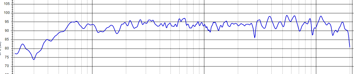

In-room response of the 8" by itself with the BSC and notch (~3k-6k). The notch only drops a few DB to leave enough on the table off-axis to play with toe-in. Easy enough to alter anyway by swapping out a resistor on the notch.
Enclosure is ~32liter. A design I came up with to use a single 2ftx4ft sheet per enclosure. Rear ported with a set of 2" precision port flares butted up to make about 4" estimated length. Nothing special about the bass, not amazing, but not bad. I find it adequate to provide an anchor to the music for the midrange to shine.

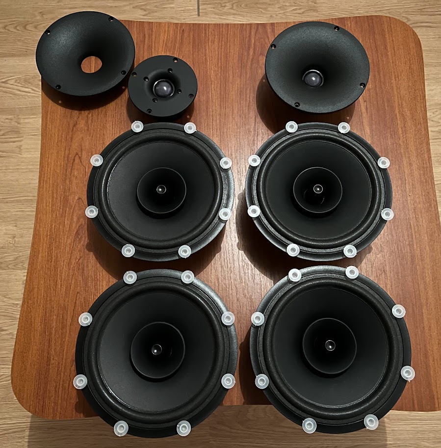

My plan is to make 2.5 way BR tower of approx 80 liters with two of SB20FRPCs and maybe Monacor DT300 in waveguide for real 94dBWm 4 ohm speaker...
It can't cope with the very best tweeters but it has really nice and extended sound, Maybe the best fullranger which I heard and I'm not really fan of most of fullrangers, especially not of those too small...
Absolutely nothing comes close for price of 50 euros/bucks...
