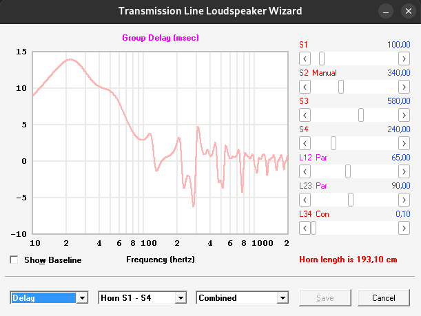

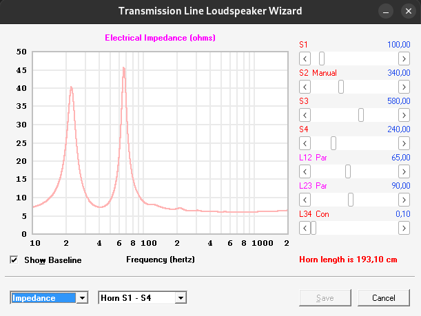

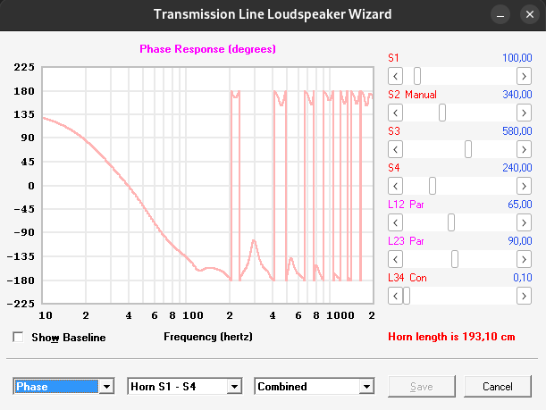

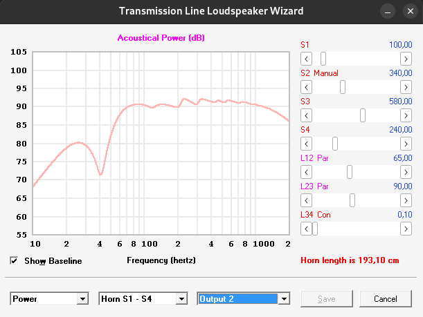

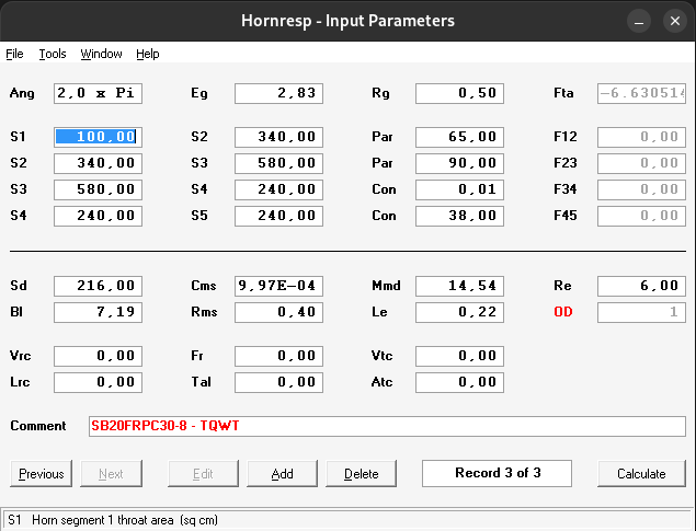

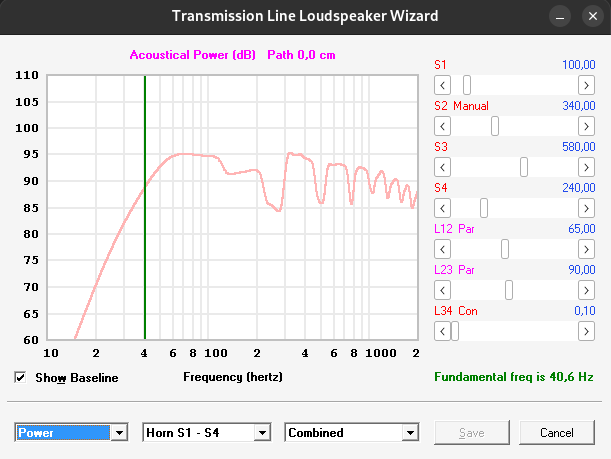

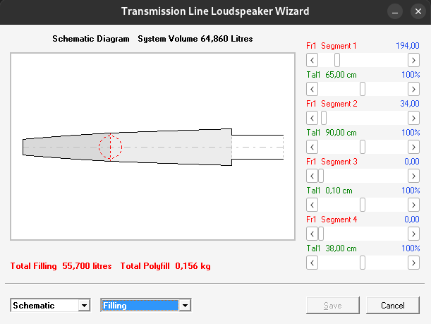

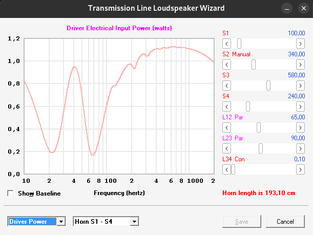

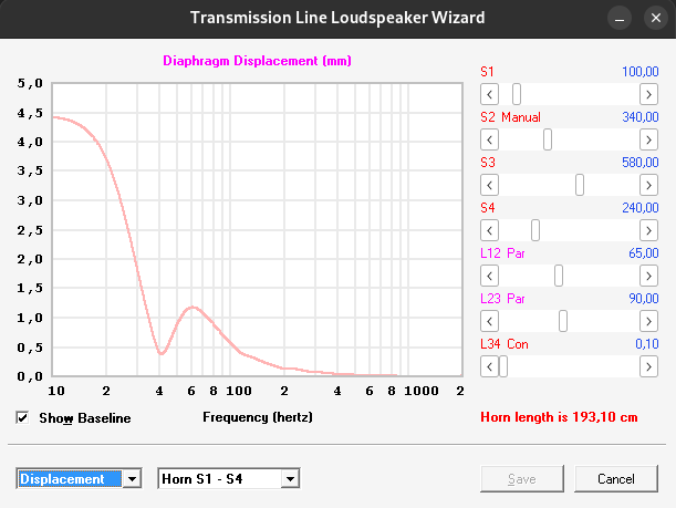

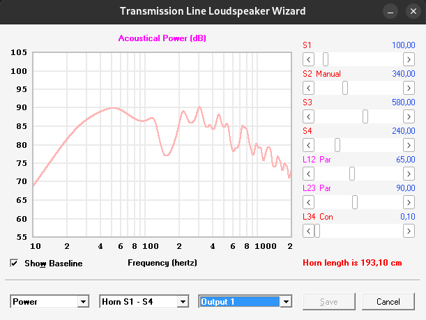

Hi there!
I am planning to design and build my first pair of speakers, and I would like to use the SB20FRPC30-8.
I could make DDVP-20 cabinets, but I like to experiment with new things, and I'm trying to learn how to use Hornresp.
I did a simulation for a cabinet design quite similar to the DDVP-20, a little narrower (20cm internal) and deeper (36cm internal), with SB20FRPC30-8's parameters.
Not being familiar with Hornresp and TQWT, I don't know how to interpret some results, and some graphs look quite chaotic, I don't know if this is normal or not.
Concerning the filling, I put a fairly large quantity but perhaps in practice it would be necessary to have less...
Could you please tell me if this looks like correct results or not?
delay.pngdisplacement.pngdriver-power.pngimpedance.pnginput-parameters.pngphase.pngpower-combined.pngpower-output-1.pngpower-output-2.pngschematic.png

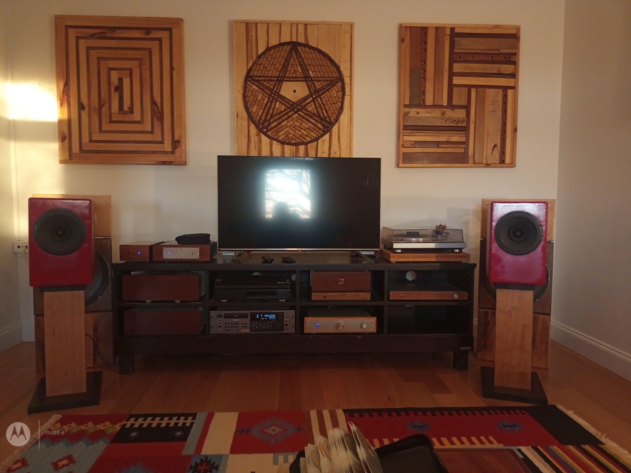

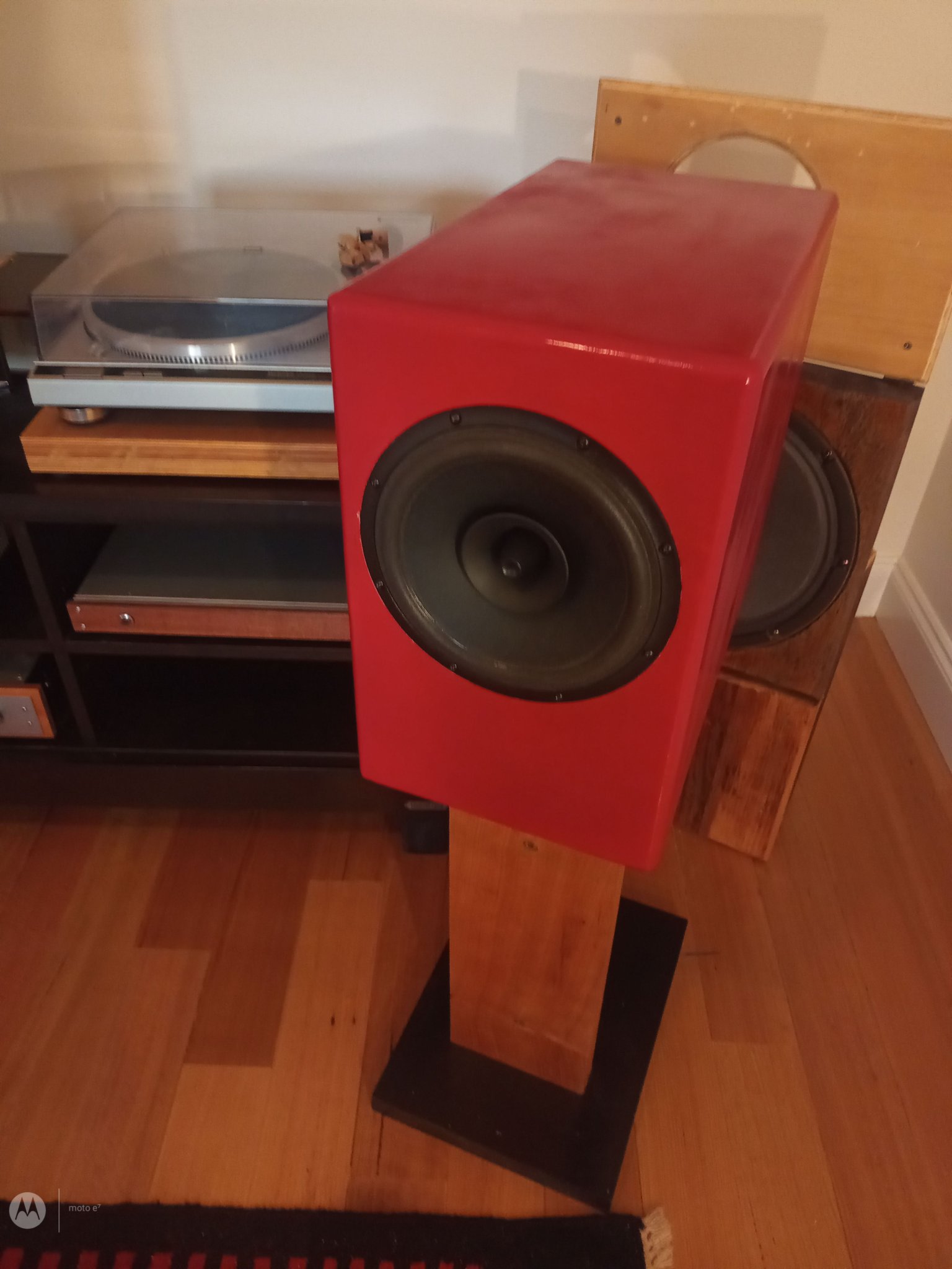

I finally built my monster.
SB20 in a 30L aperiodic box with a LCR correction network in series with the driver.
What can I say, the transparency, timing, ambience is amazing.
Before that I had this driver in an OB with a 15" woofer, and it is great, but this, with all its shortcomings is just unreal.
Porcupine Tree, In Absentia, is a great test CD.

I used Basta, the good old Basta, for all the simulation.
Thank you Svante!
The LCR network is:
C 4.7uF
L 1.8mH
R 4.7R / 5W
All components in parallel and then this whole lot in series with the positive.
As I had no 4.7R I used 3.9R and the range around 800Hz - 1kHz is a bit hotter than I want it to be. Verified with a small Android app called Spectroid.
The bass is great. Not as deep as from the 15" woofers, but deep enough, tight, very satisfying. And very much in synergy with the rest.
Porcupine Tree, In Absentia, track 8 & 11 are perfect for such evaluation.
All this is a compromise of course, but everything in speaker design is a compromise.
Will need to buy another pair of SB20 to fit back to my OB which you see behind the Aperiodic boxes.

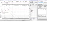

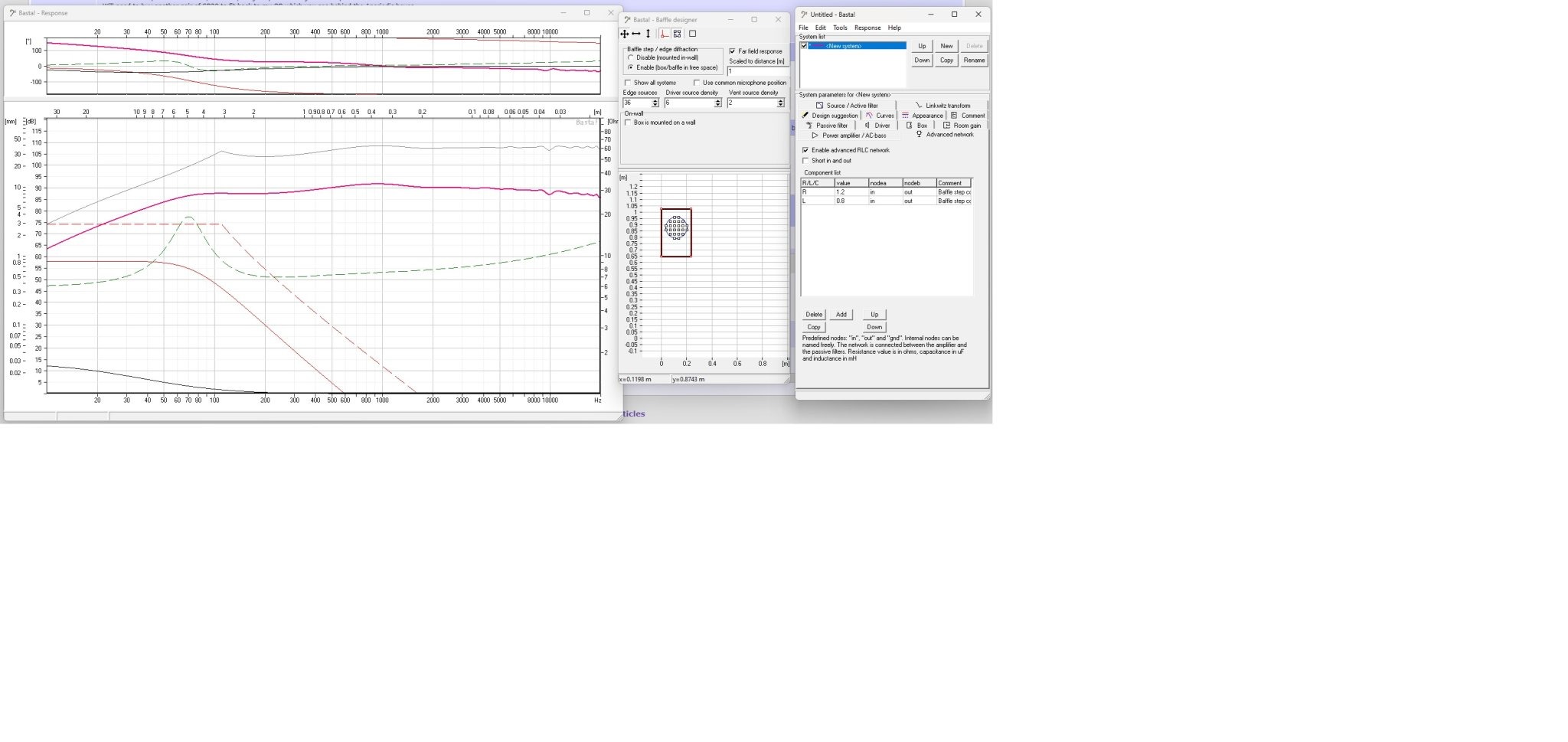

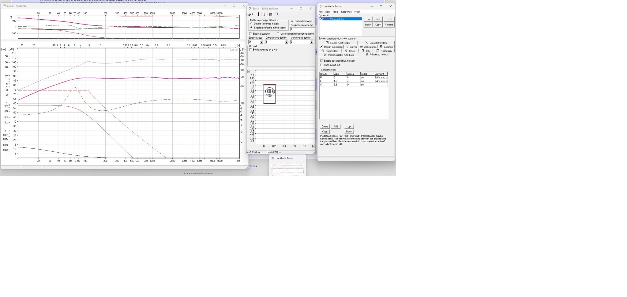

Yes Leonardo, I'm quite happy with the result. Maybe will need to increase the value of the resistor a bit.
The idea of the correction network was not only to cater for the baffle step but also to lift the highs back to "normal".
Here's what it looks like in Basta with my circuit:
And here's with your values:
I only measure freq. response with a little app, Spectroid, and the result was very close to the predicted one.
