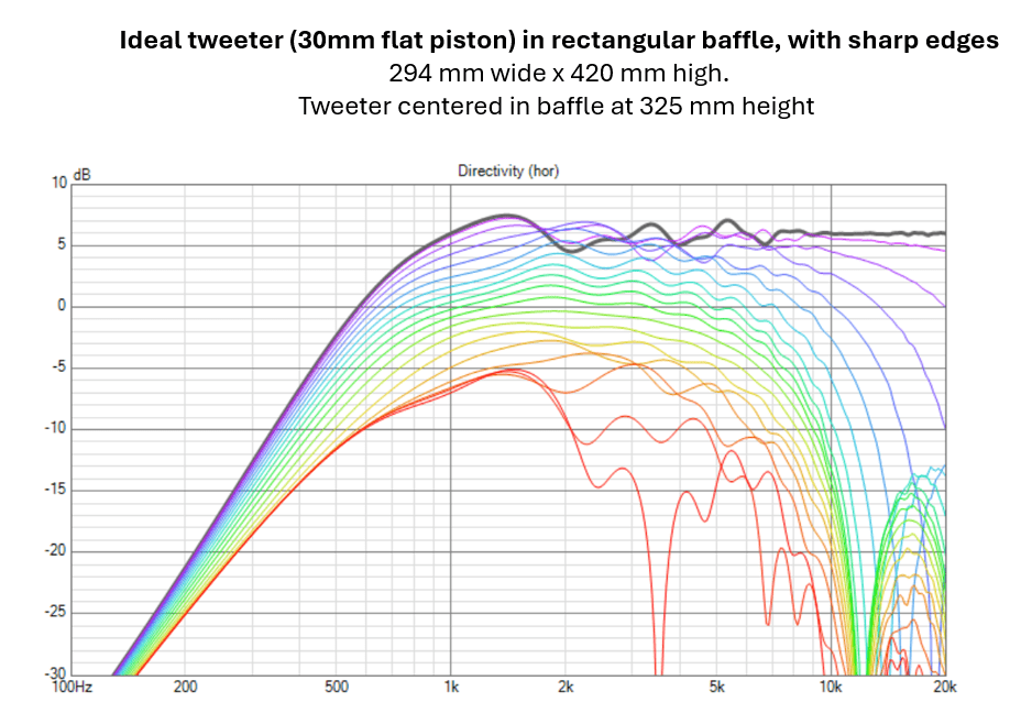

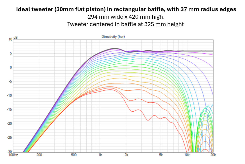

In my opinion, cabinet edge diffraction can have a detrimental effect on speaker performance.

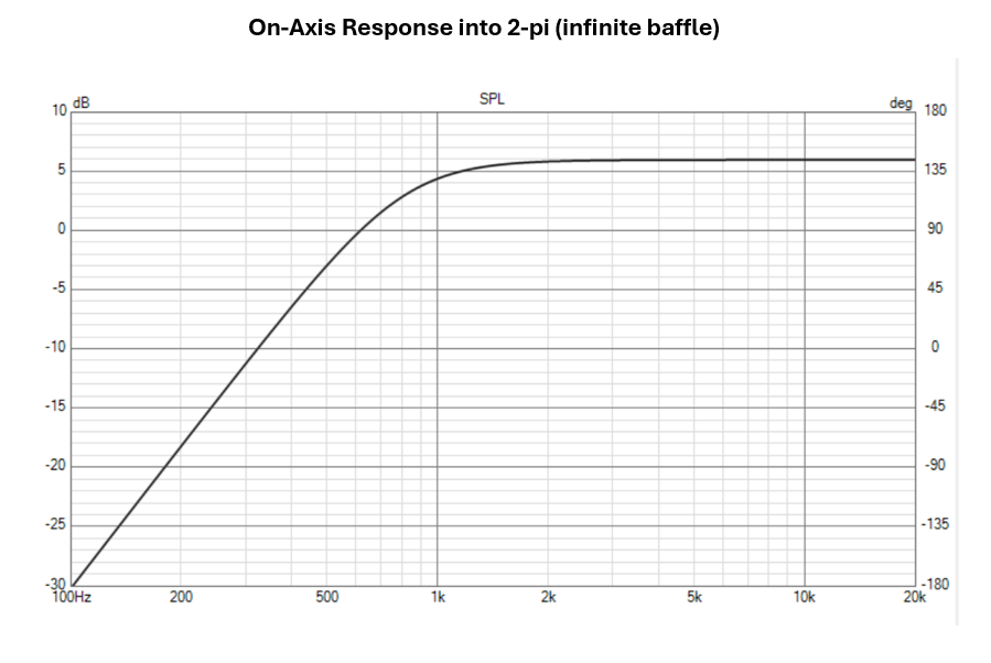

Here are some simulations. I simulated an ideal tweeter as a 30 mm diameter flat piston. First I show the response in an infinite baffle
Now I put that ideal tweeter in a rectangular baffle with 37mm radius edges. Here I show the horizontal polar responses in 10 degree increments.
Now here is the same rectangular baffle, but now the edges have a 1 mm radius, which is a sharp edge.
There is a measurable effect on the polar responses from 0 to ~70 degrees.
High frequency diffraction has an effect which goes beyond the frequency response impact. I believe it diminishes the 3-D presentation, and reduces the listener's ability to perceive a sense of spaciousness and localization. If the listening position is far from the speakers, and the sound field is mostly the reverberant / reflected sound, this impact may be negligible. But if the majority of the sound is direct sound (close listening distance), the impact of diffraction sources on the speaker baffle can be detected.

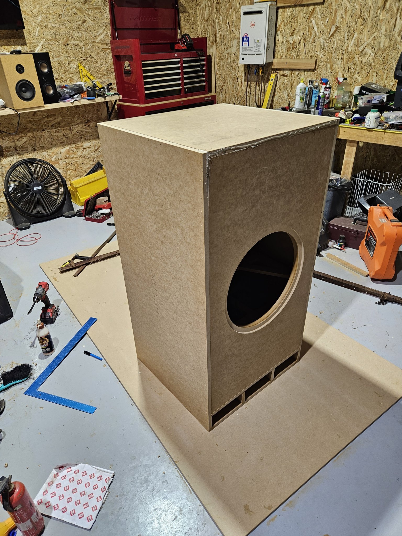

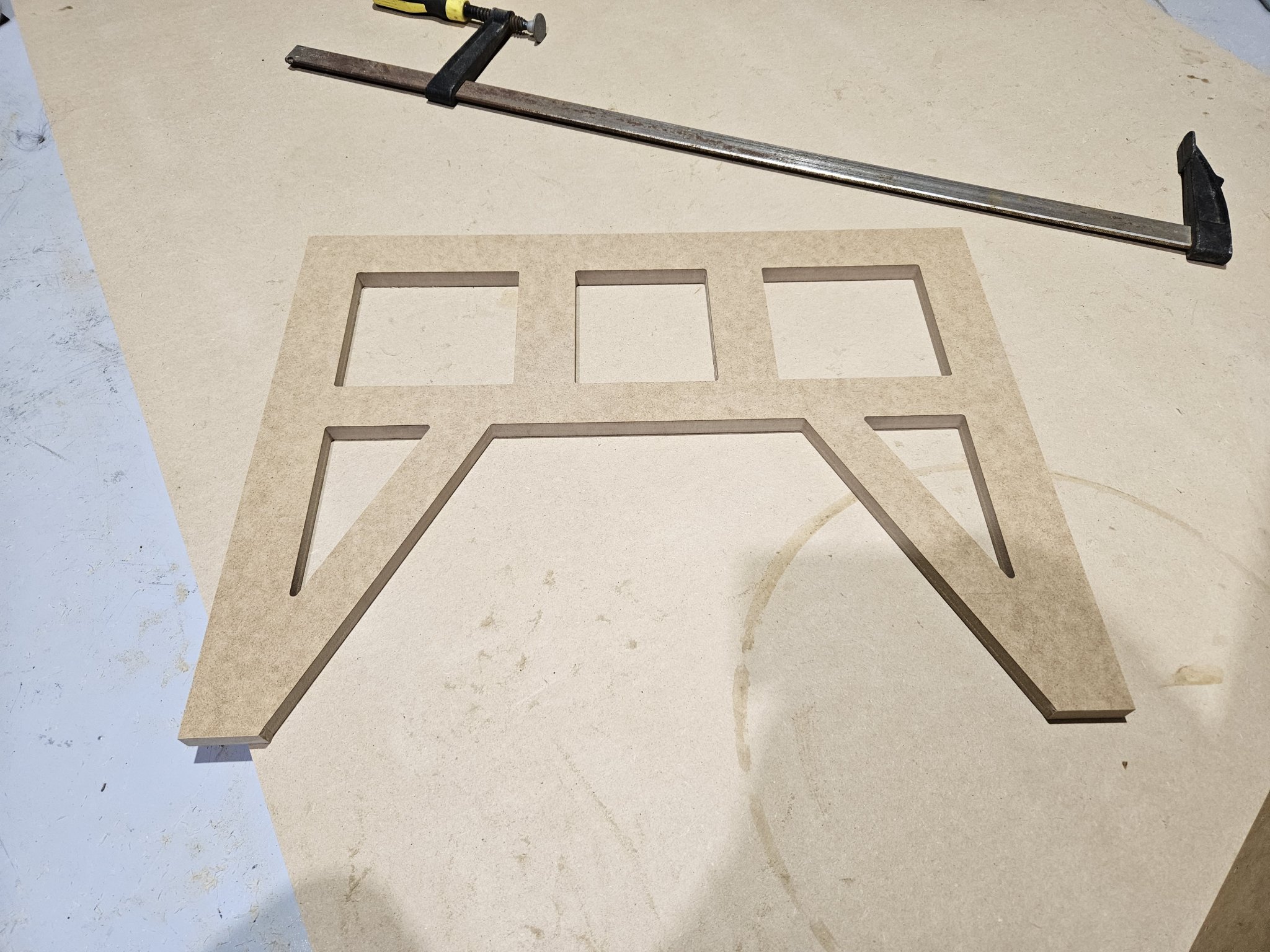

Slightly off topic, but i finally got the change to do some proper testing on the CNC after setting it back up.
I ended up making a Full marty 18" sub. Done all the internal braces and the baffle on the CNC, makes light work of it 🙂

Nice, if you have access to material being able to knock up test boxes quickly is so nice. If you add some rebates to the sides and countersunk drill holes so you can screw cabinets together you can go from sheet to testing within the hour.
