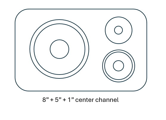

I have contemplated making a center channel, something with this kind of configuration:
Again, I have no experience with center channels, and no experience with multi-channel systems such as 5.1, 7.1, atmos, etc... I enjoy movies just fine with a standard 2-channel stereo system.

For best results speakers should always be in-line(more or less) and vertical.
Otherwise dispersion off-axis left/right will have unnatural and not pleasant to listen response.
I suggest you take a program to simulate that.
There is one BoxSim made by Visaton, it also takes into account driver placement and listening angles.

With a crossover from woofer to mid of 400 Hz or less, the two drivers will be within 1/3 wavelength of each other. Horizontal dispersion will be affected only to a minor degree.
This sort of configuration is common to center channels in HT applications... especially because it tends to fit under or above a screen.

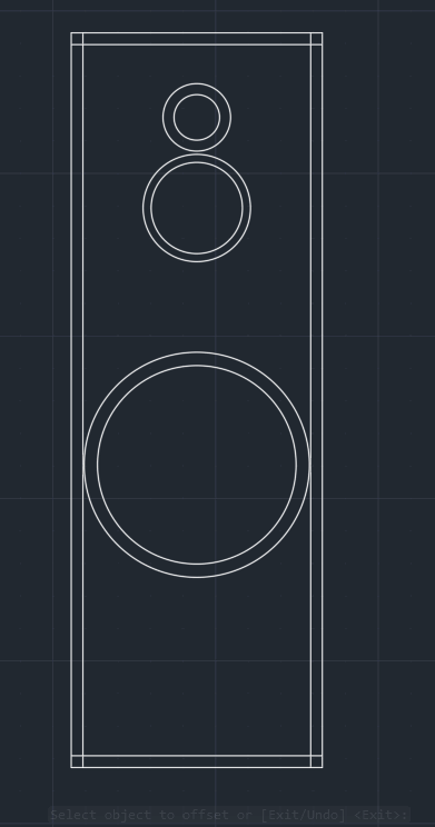

I have another question before i order drivers.
I'm tossing up between the waveguide/non waveguide tweeter.
I realise this decision will affect the whole design of my speaker and the front baffle setup.
In regards to this then, if i use a non waveguide tweeter, would i be best to put the 12" driver in the side of the cabinet
and have a skinnier and deeper speaker?
If i use a waveguide tweeter, i could possibly look at a wider shallower cabinet, more like Zaphs Sb12.3.
If there a general best practice in this regard?

1) I tested side placement of a woofer long time ago. IMO unless cross over point is low(e.g 100 Hz or so) it's not a good idea because of different directions. Also keep in mind that drivers must behave in a consistent manner to each other not only at crossing point but maybe +/- one octave from it.
2) I think if you plan to use cross over at 2k or so wave guide is important mainly for attempting to reduce distortion from tweeter.

It is not easy to come up with a design that incorporates a 12" woofer on the baffle, and also incorporates a minimum sized baffle around the tweeter. A tall trapezoid, perhaps. Or a two-box design. It is also possible to make the baffle very wide so that both the mid and the tweeter are presented with an infinite baffle. in other words, the transition from 2pi to 4pi happens well below the mid-tweeter crossover. Something on the order of 50+ cm wide.

The wave guide acts like partially a horn, boosting efficiency at some frequency spectrum.
I recall testing one aluminium tweeter without and with wave guide attached. The wave guide was made by manufacturer and matched to it.
IMO wave guide made it blend better with the woofer, so I would consider a wave guide version, perhaps.
Of course not every wave guide is made the same so if you can find measurement data and compare it's the best.

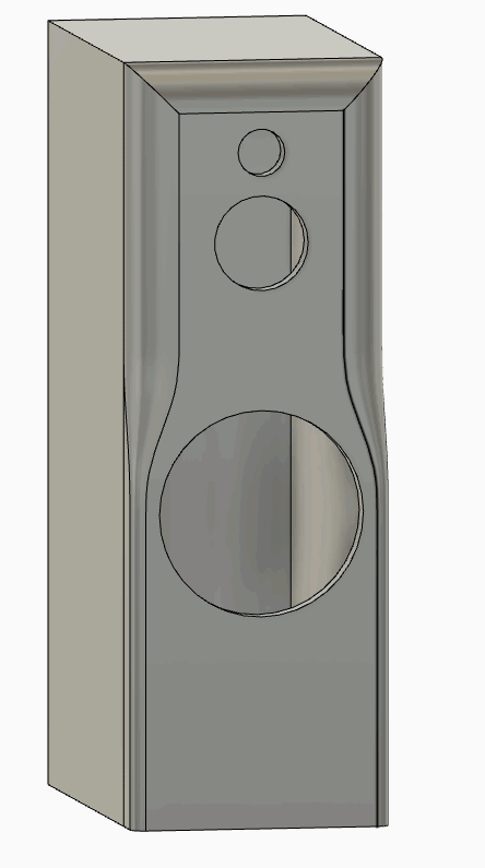

With a CNC router, you could probably profile a 15" wide cabinet such that the baffle around the tweeter was pretty minimal. With that equipment, you have a lot of options.

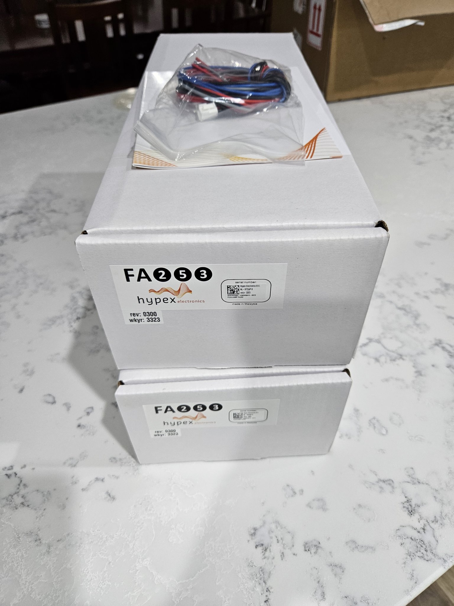

Got a nice surprise in the post today. See attached pic.
Drivers are all ordered and coming mid next week. I'll start a build thread once i get started. Still working on cabinet design at the moment.

Yes I always thought it looked great, probably the best way to make a very low diffraction cabinet that is wide enough for a large woofer. This challenge is one of the reasons we see so many speakers that use a stack of 7" or 8" woofers rather than a single 10" or 12"... Managing the tweeter is much less complicated when the baffle is only 8" wide.
In your situation, with your superman router, you could vary the radius of the baffle edge from ~20 mm around the woofer to gradually increase to ~120 mm radius near the tweeter, and the result is that the tweeter will have a very minimal flat baffle area. This is a key component of good directivity performance through the crossover region.

Be careful when handling the Hypex amp boards. It is very easy to ESD them and damage the components. In fact I would handle them as little as possible until you are ready to install them.

I've done my preliminary baffle design, same principal as @PKAudio design as i really like the look.
Preliminary pic attached.
In general it seems to get the tweeter and mid as close together as possible, so i've worked on that.
I did some reading on the mid to bass spacing and it was to be max 1/4 wavelength, so i've worked on that too.
(hope my terminology is correct here, correct me if i'm wrong)

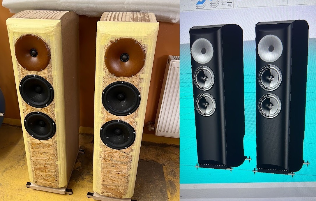

Well, to produce large roundovers you will need very thick baffle, 60 - 80 mm, which is also good support for drivers. Or to construct it in some other way. Thiel was doing that for years and they did it well. For the first test you can construct similar baffle from some residuals and make roundovers from XPS, everybody is doing that to confirm that imagined shape has expected properties. It's a pity if you loose hours and hours of CNC work and some nice woods or plywood and then you need to change roundovers or something because measurements didn't go as expected....
But generally, you will not miss with shape you sketched...
On picture is my test front baffle, 60 mm thick, made from residual OSB and MDF. If measurements and sound will be OK I will do final baffle from 3 layer real maple wood...tear drop shape which will continue to the side walls to have nicely rounded speaker without to big disturbances...
For Ellips I did not use roundovers with large Radius. I use elliptical "roundovers", it works well, looks good, and it does not require too thick baffle. For Ellips the baffle was 50mm thick.
