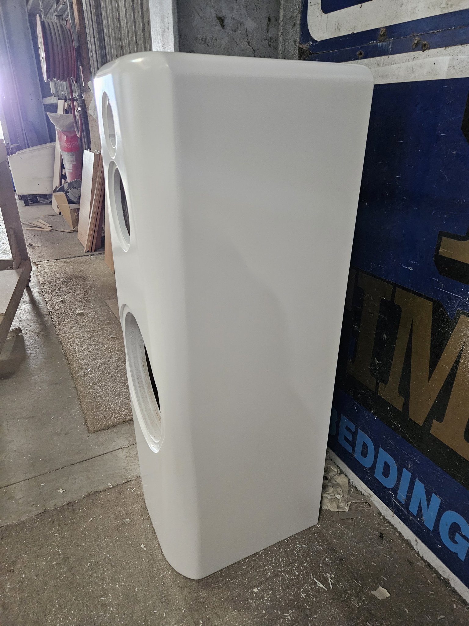

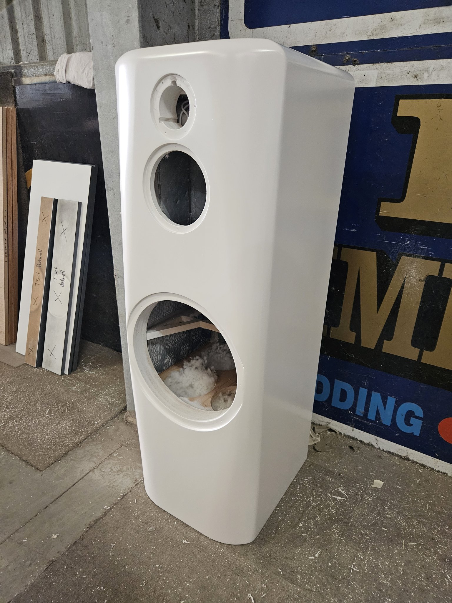

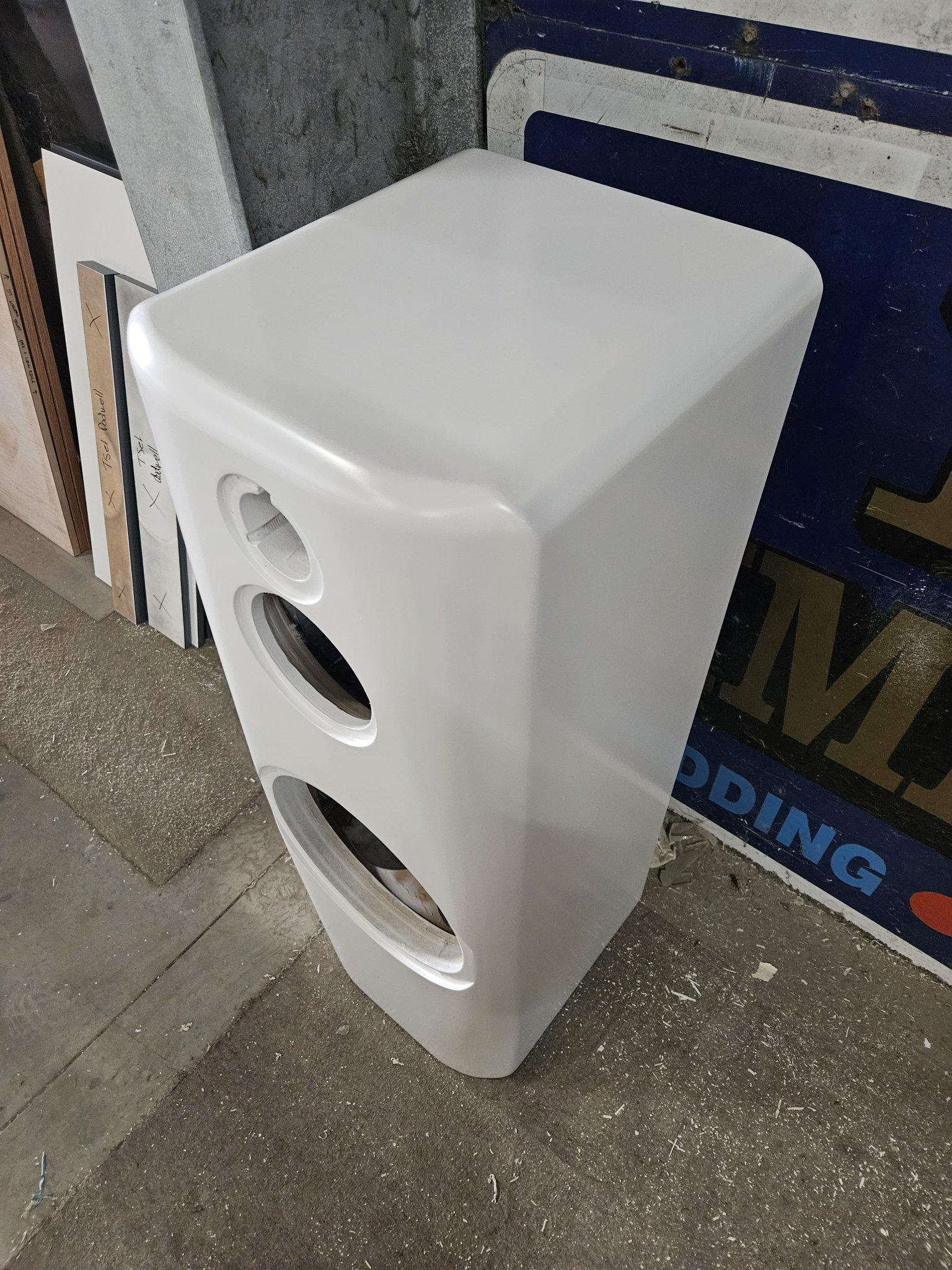

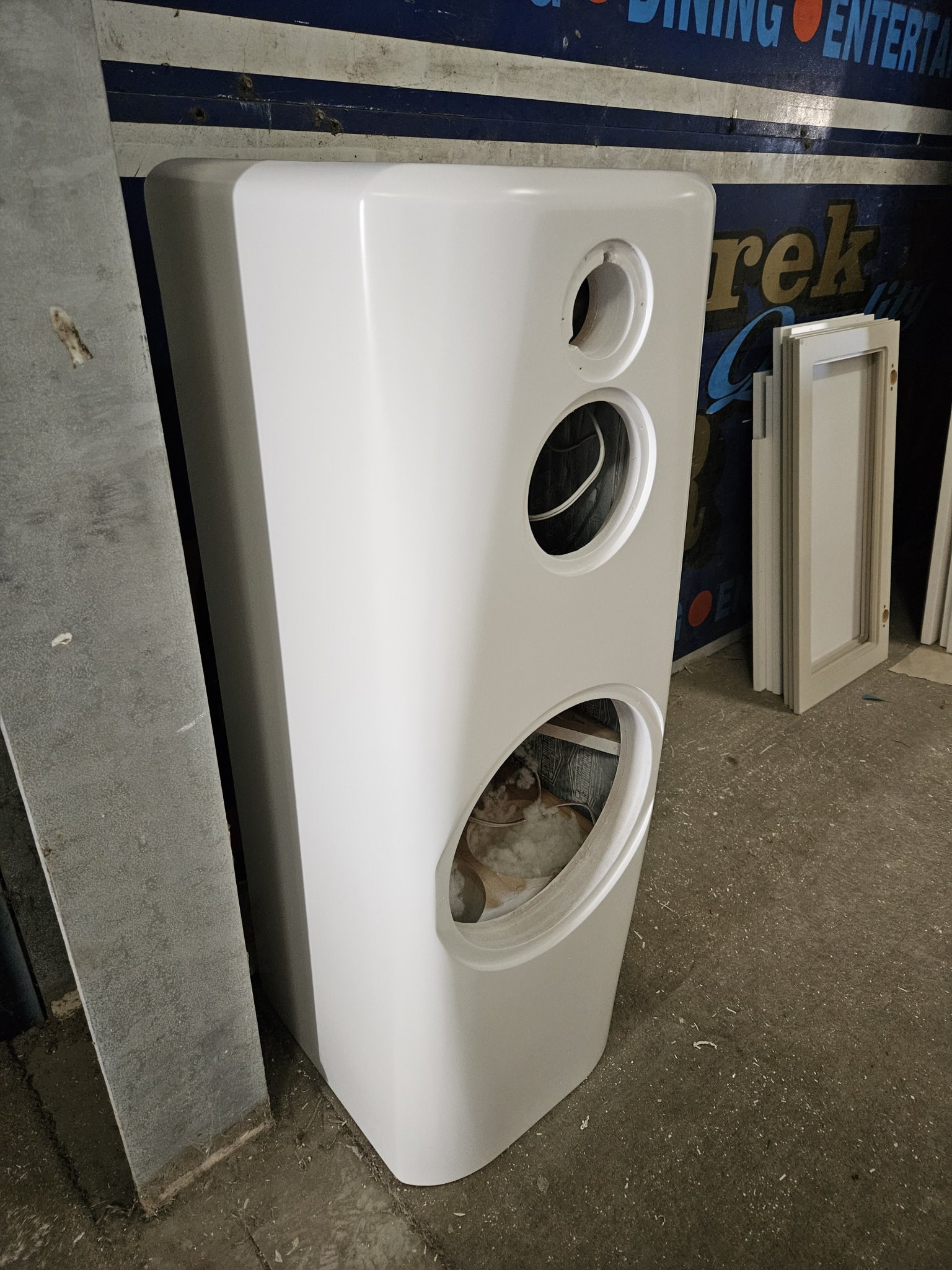

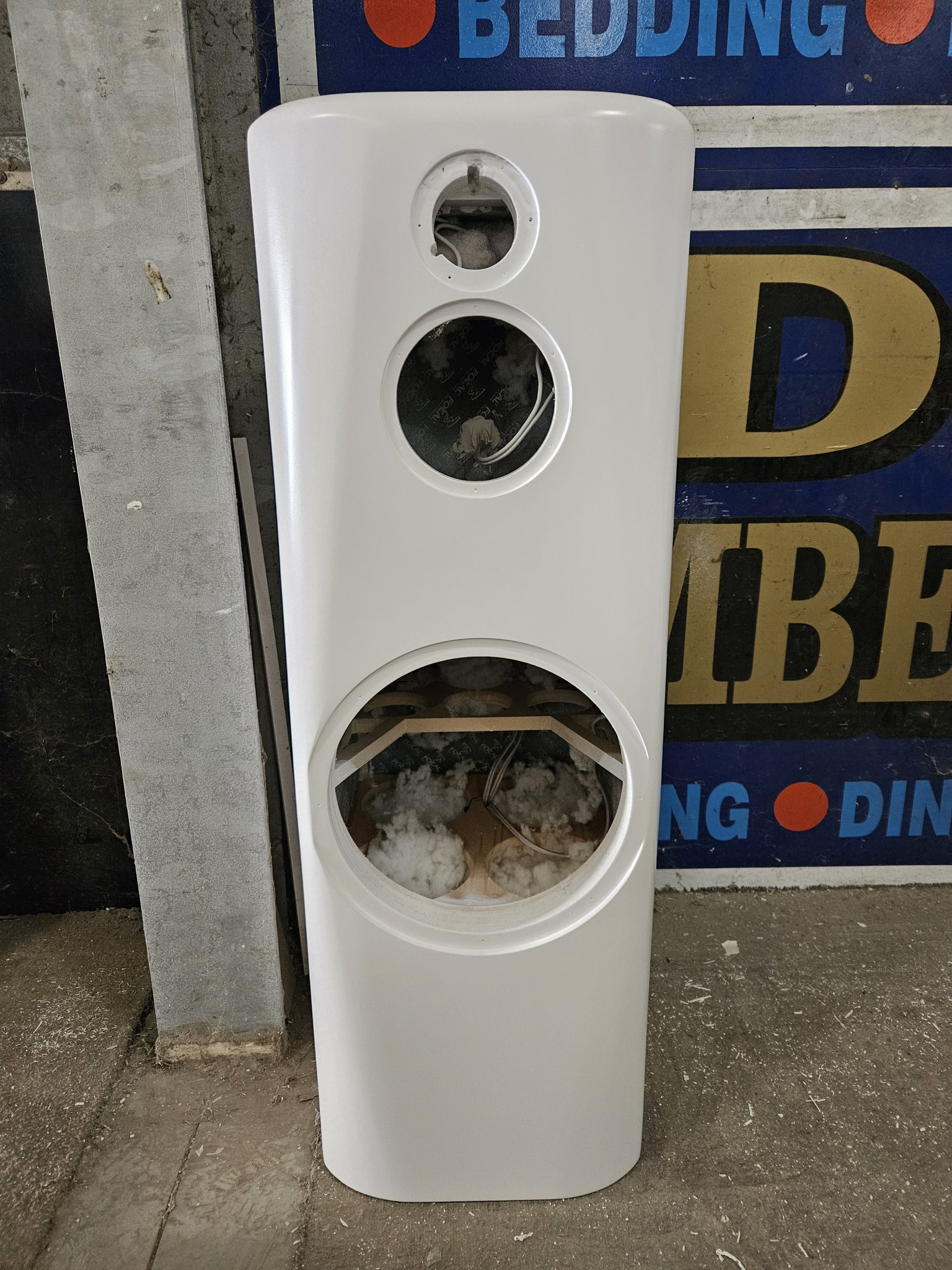

Painter rang me this morning to say he's got one finished so i popped in to take some photos.
Inside a dark gloomy shed, so photos wont do them justice at this stage but you get the idea.
The other one will be dry early next week so i'll pick them up then and begin the testing.

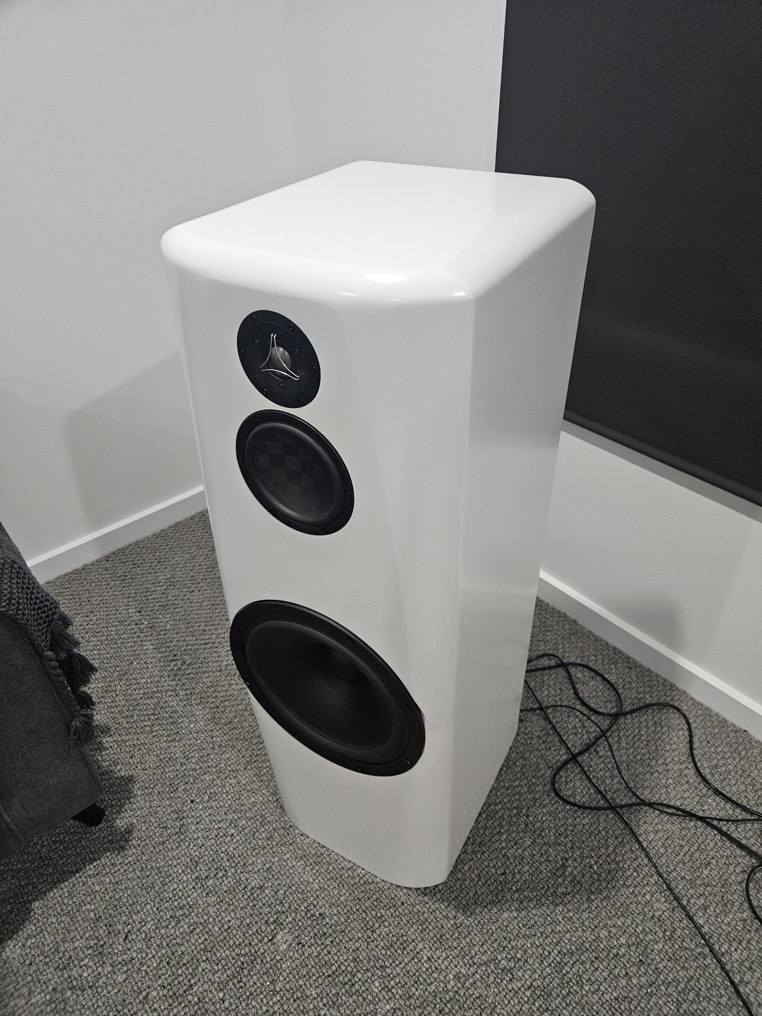

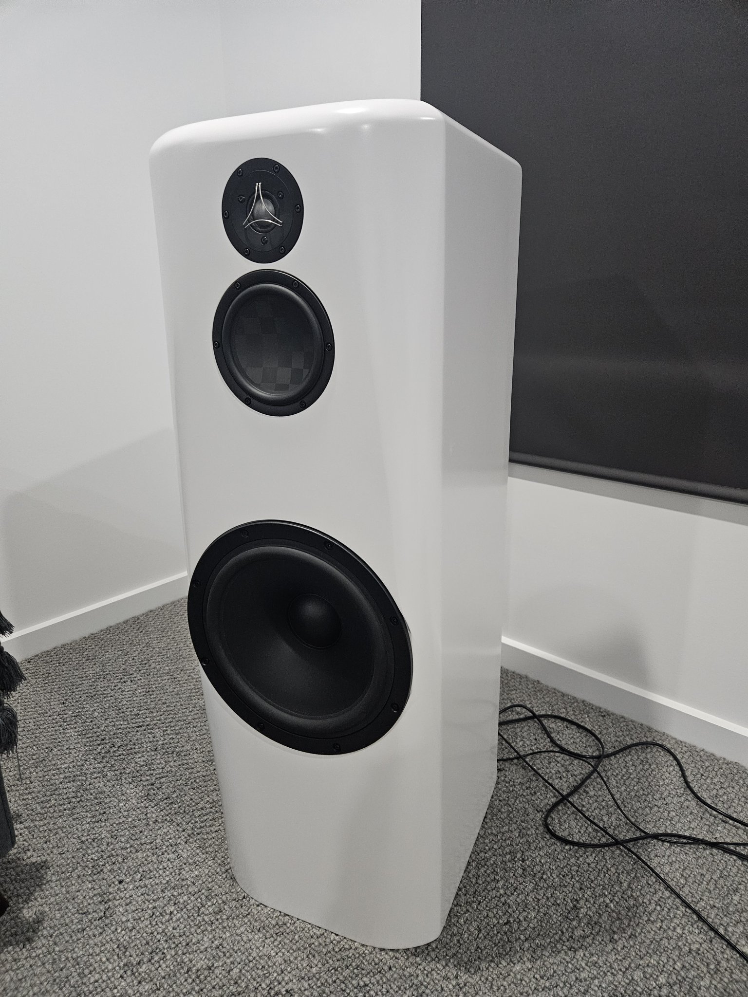

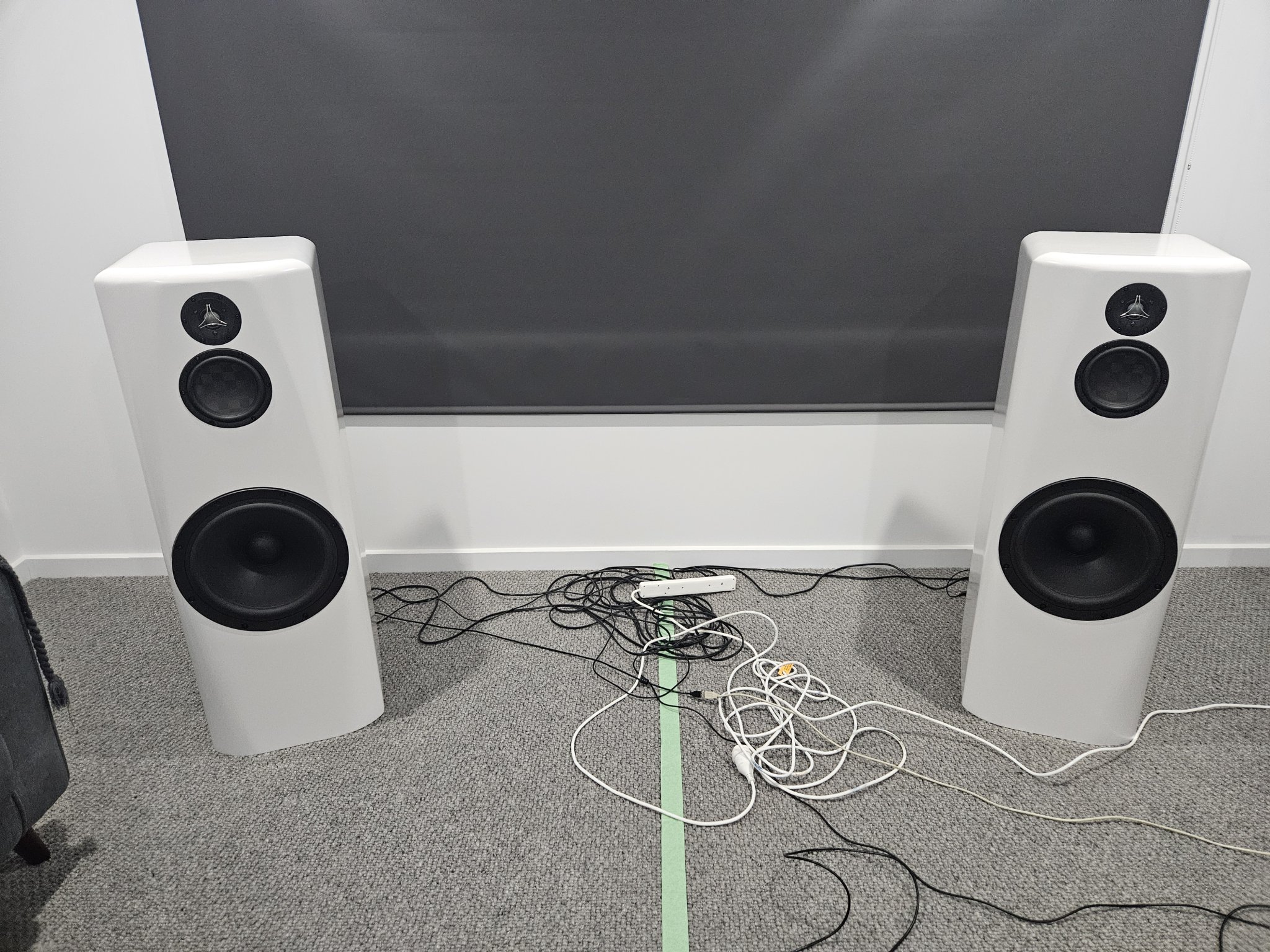

Got them both home earlier than expected. Assembled and couldn't be happier with how they came up.
Spend a bit of time getting the drivers time aligned before i done any listening.
They sound amazing. I still have lots of tuning/testing to do but very happy.
Thankyou to all those who offered guidance and advice.
