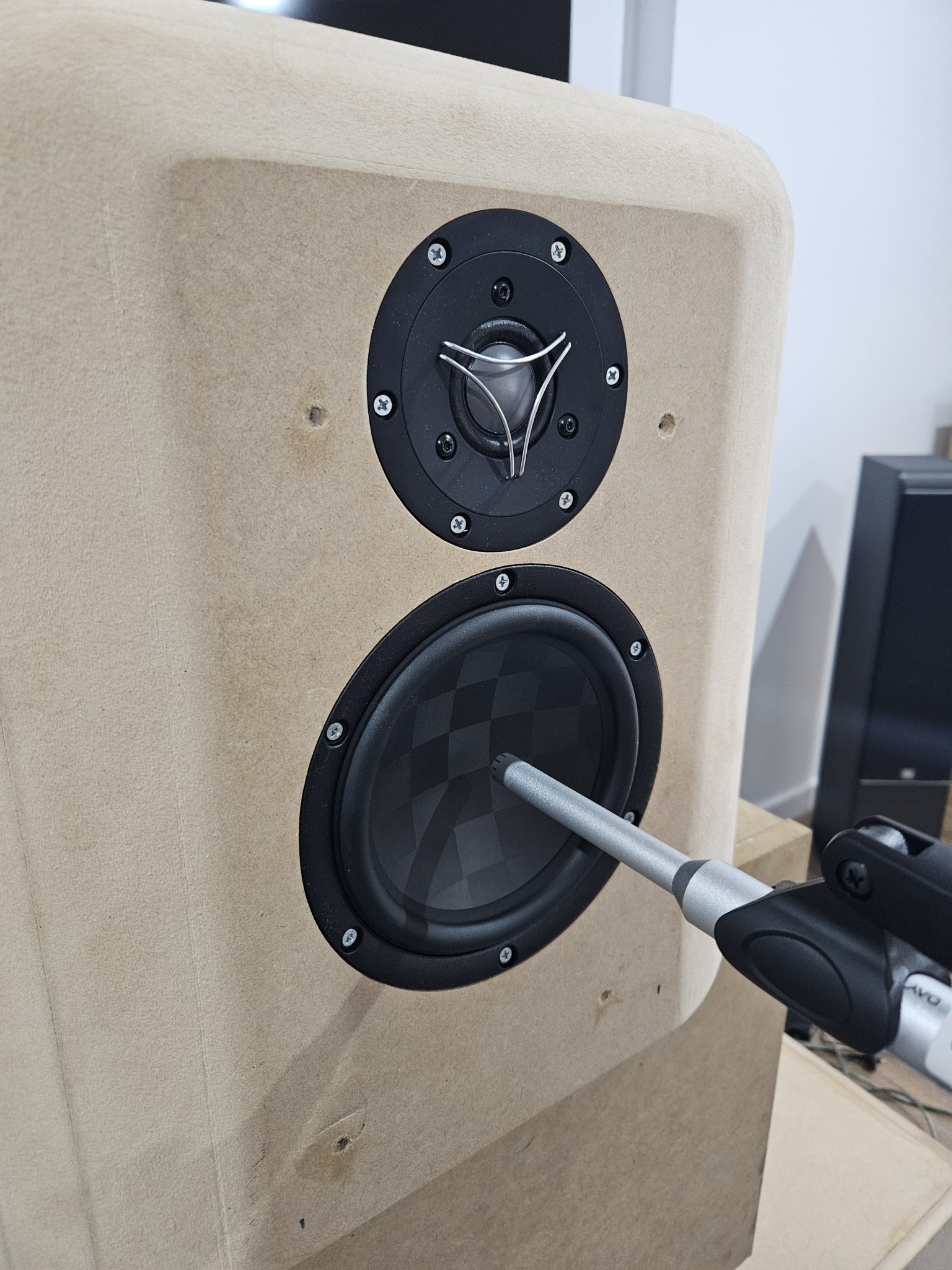

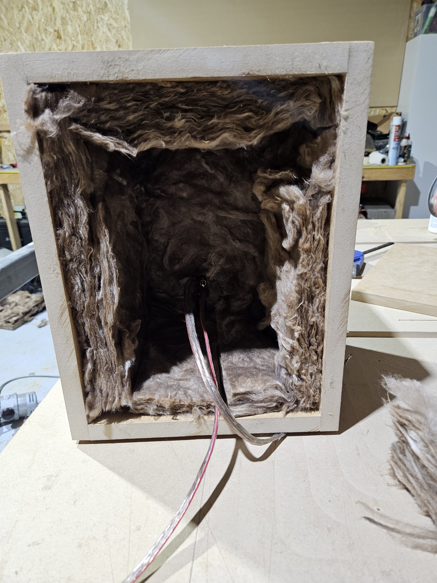

Well I've been very busy. Got my test baffle made, built a box and lined it with some wall insulation i had lying around, glued that to the back of the baffle and thats my test setup.

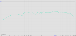

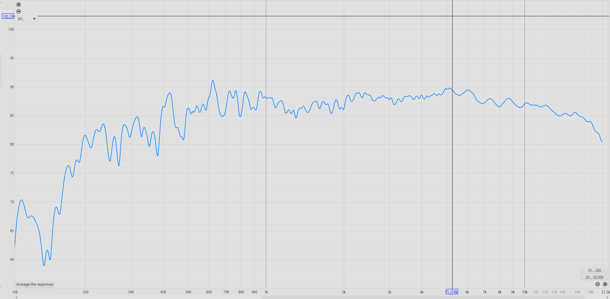

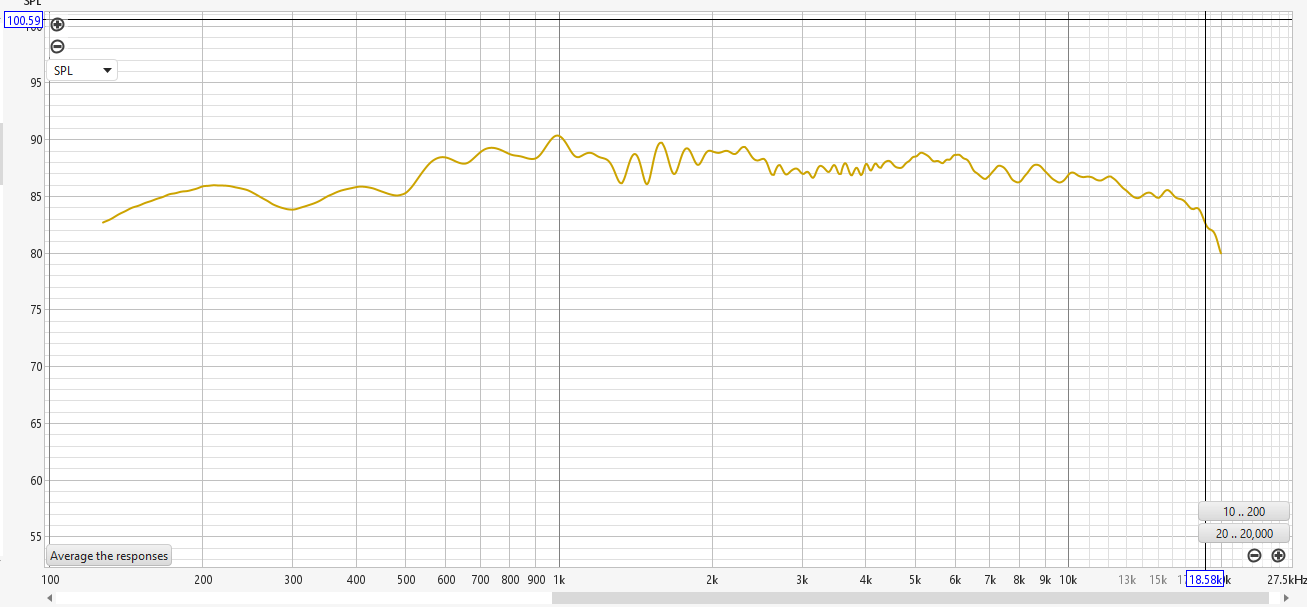

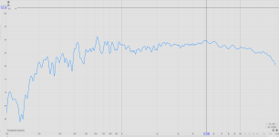

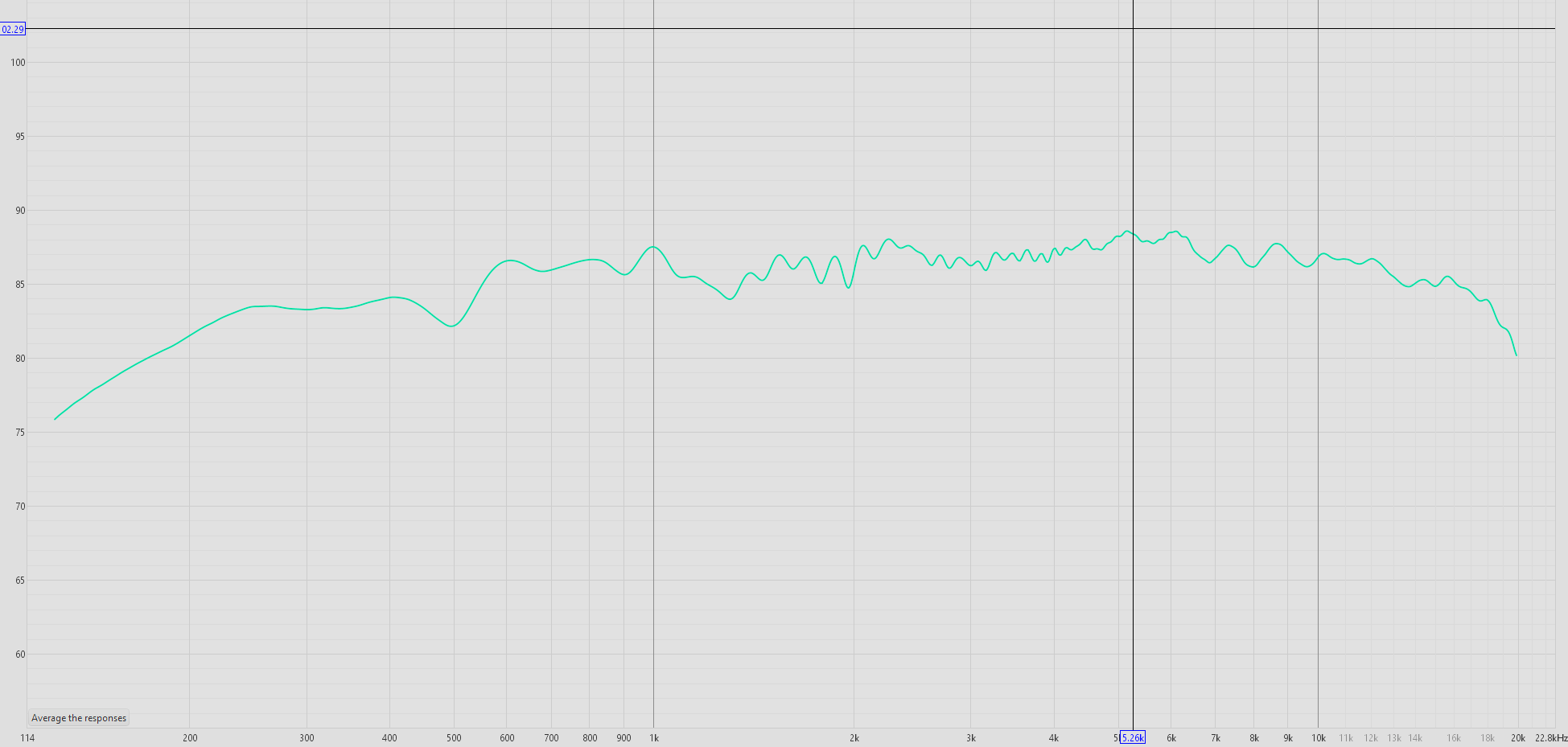

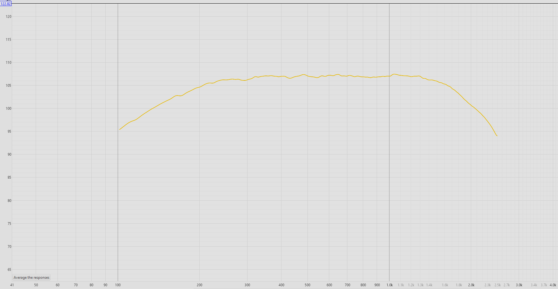

I took the following measurements.
1 - Tweeter, no crossover, 1/24 smoothing (1m on axis)
2 - Mid, no crossover, 1/24 smoothing (1m on axis)
3 - Mid, nearfield, no crossover, no smoothing (Nearfield)
4 - Tweeter and mid, crossovers in place, 4th order 200hz, 4th order 1.6khz, 1/24 smoothing (1m on axis)
5 - Same as above, but gated to avoid first major reflections, 1/24 smoothing

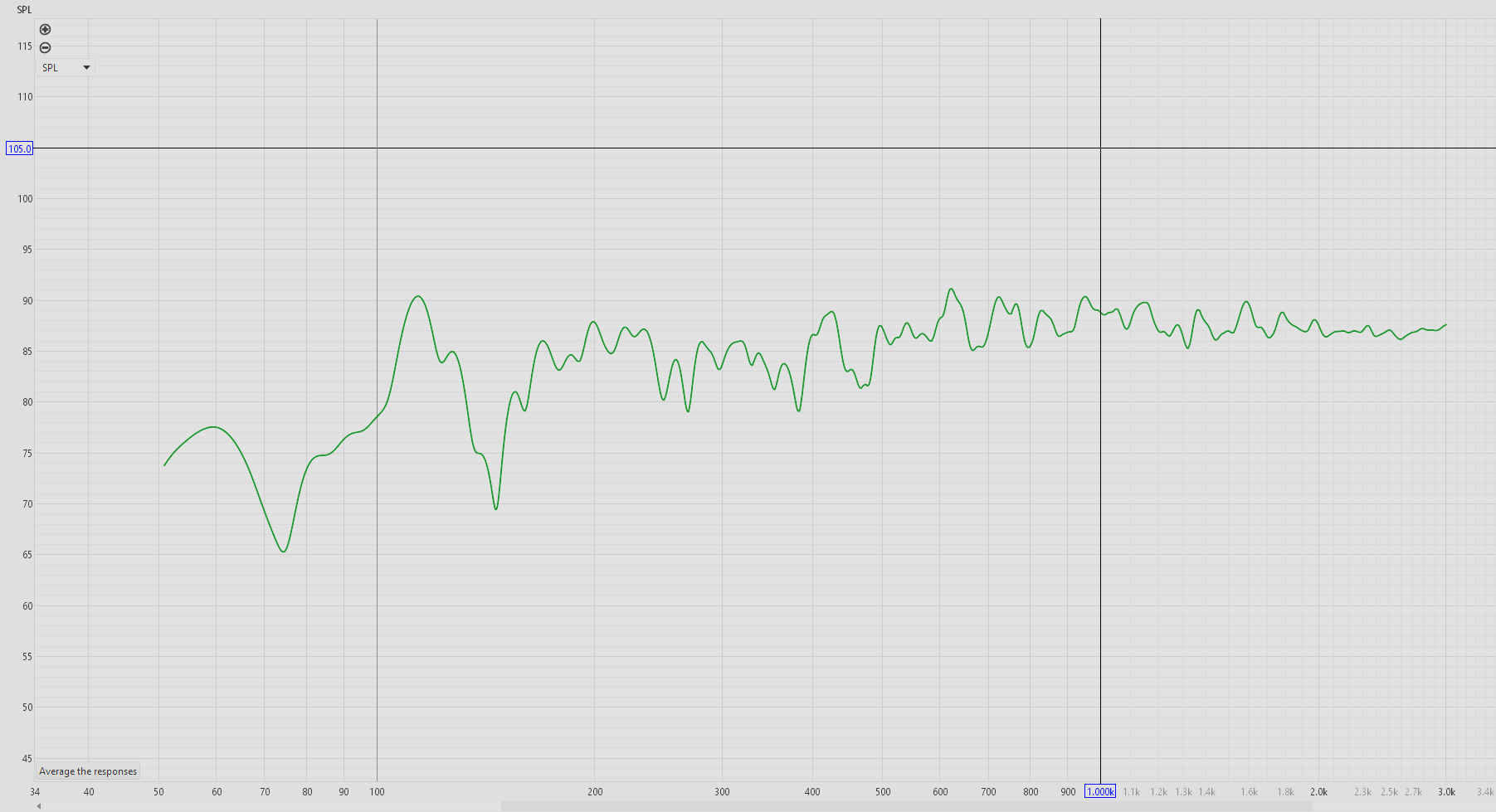

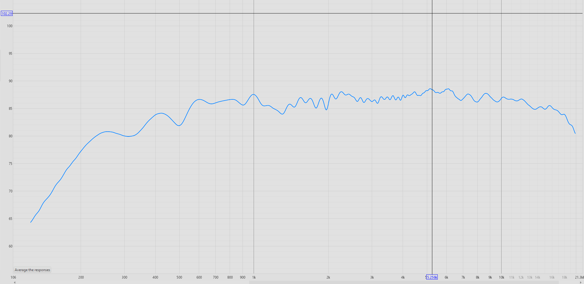

6 - Midfield Measurement and full spectrum measurement merged in rew (Trace Arithmetic B to A at 400hz) (Just following the guide from the website,
this measurement may or may not be correct or relevant)
All measurements were taken in REW, using the UMC202HD, Dayton EMM-6 XLR Mic. At the level of the tweeter, @1m for most measurement, or approx 10mm from mid for nearfield measurement.
So where to from here?

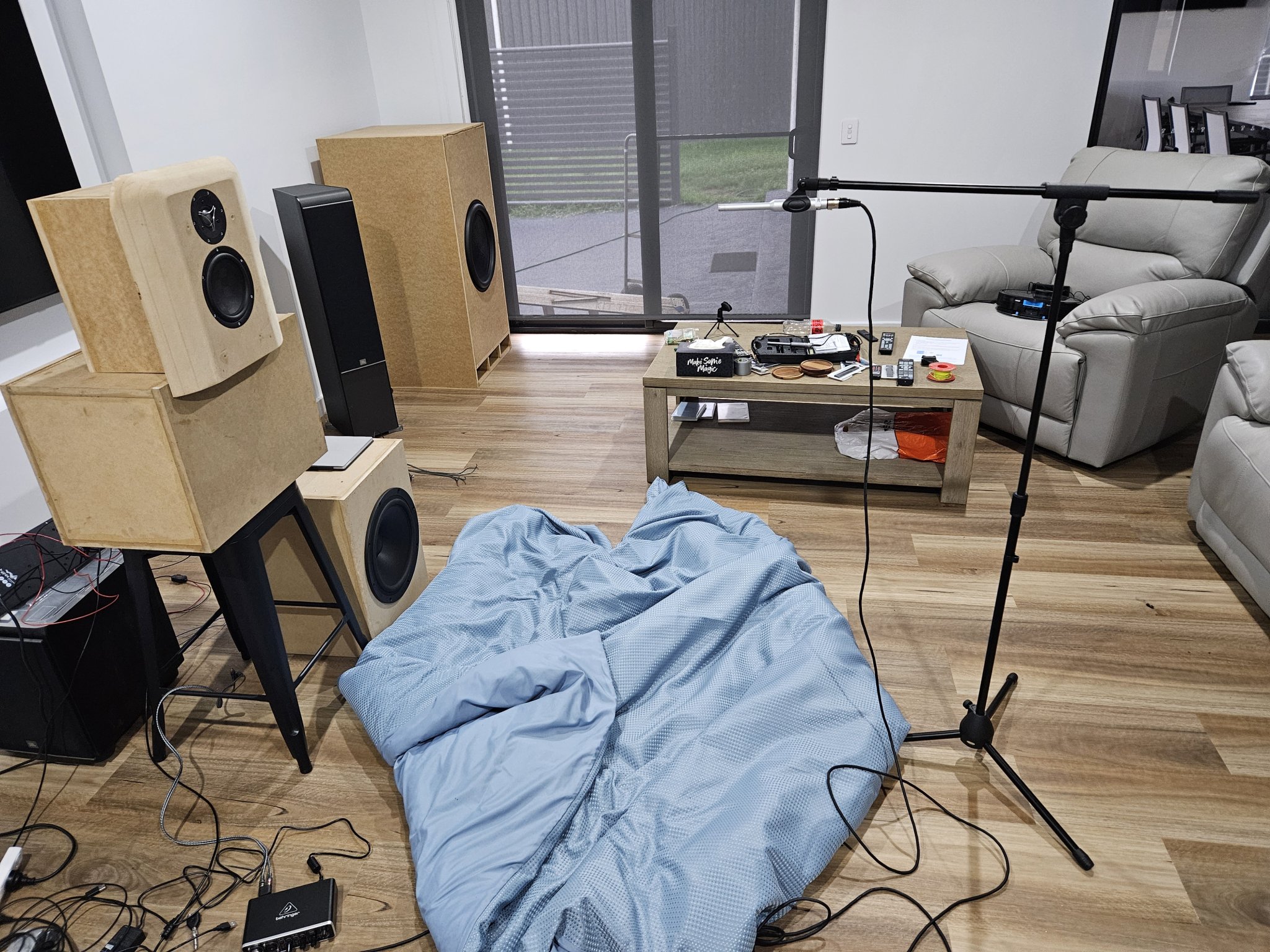

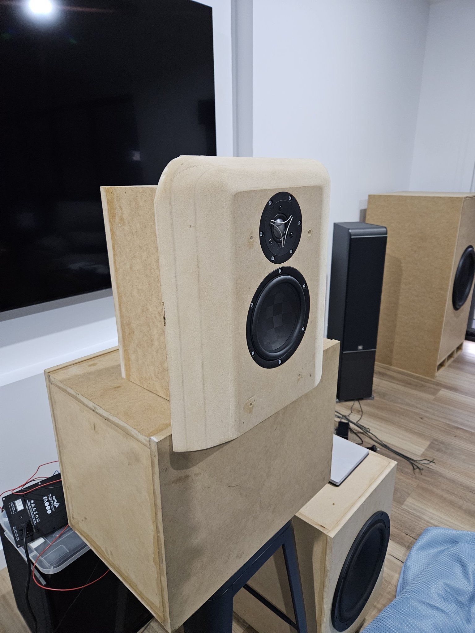

Thanks again, some pics attached.
The frequency reponse irregularities that you are seeeing are typical for measurements in the room. Not so much can be done about that.
I have found out that measuring at about 50 cm from the speaker is sort of good compromise, so room influence is a bit less than at 1 m and also distance is large enough to see how drivers interact over cross over frequencies.
I see you are using celullose-filled fiberglass(perhaps knauf) ? If so, it's a light filling and it's safe to fill the box completely. Lining the walls is less effective, because it tends to absorb only freuquencies where lining thickness is perhaps 1/2 of wavelenght or so.
I think that crossing the tweeter you are using at 1.6 kHz is too low. Suggestion to also try other frequencies, perhaps 2 & 2.5 kHz and test how it measures and sounds. Maybe in theory off axis response is better when crossed lower, but also tweeter is loaded much more and can start to distort at higher volumes.
Normally, fine-tuning of the cross over can always be done(and IMO is the best to) do in final phase, when box is in final shape.
When testing off-axis, look if there are no peaks at X-O points, as it is something to be avoided.

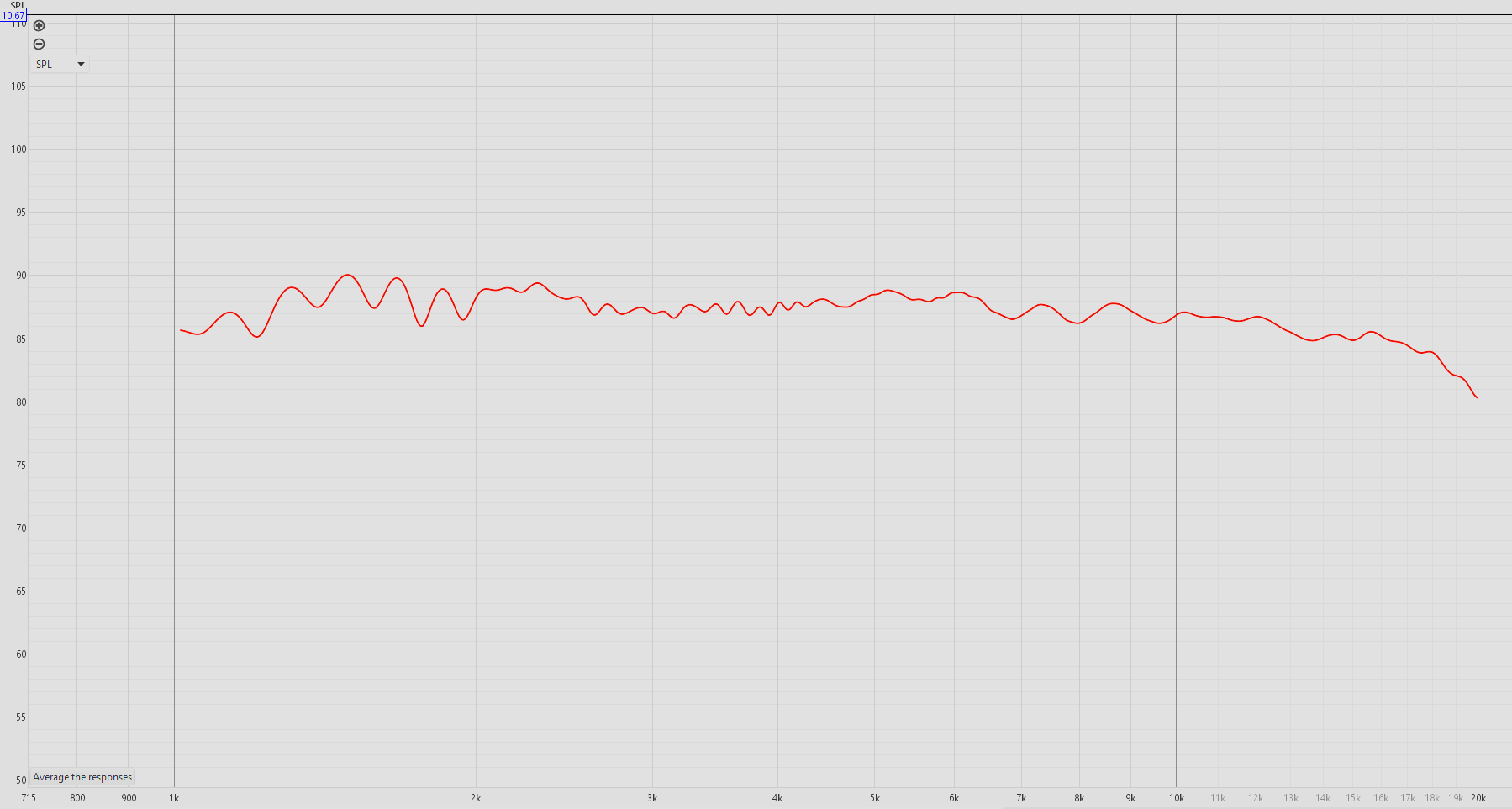

The near field mid measurement looks good. The next step forward would be to apply gating to the far field mid measurement, and then merge it with the near field.
To start with, you can apply gating (time window) to the mid driver and tweeter driver far field measurements. If you saved the impulse response as a *.pir file, there is no need to re-measure. Just load the *.pir file into REW or VituixCad.
The ASR post from napilopez is an exceptionally good guide.
Your test baffles look excellent. Nice job on that.

Yes. At this point, there is really no way to know or guess what the final crossover filter shape will be.Normally, fine-tuning of the cross over can always be done(and IMO is the best to) do in final phase, when box is in final shape.

Read the rockwool MSDS.
The stuff is manmade asbestos.

Just to clarify. The purpose of me building the test baffles was to see how the roundover radius effects the tweeter, that is something I will only know once i do off axis measurements?
I attempted to combine the far field tweeter & mid. Pic attached.
What product do you recommend lining the walls/stuffing with for the final enclosure, i'll get some of that ordered so i have it ready.

It can be experimented with, but in general filling density between 10 to 15 Kg/m3 is desirable for a closed box. That means rock wools are typically near the high side of filling density, and maybe often too dense. Fiberglass being on low sidde and a safe bet. No need to buy some special pofill or something like that, likely it's going to perform worse(near useless) compared to fiberglass.

I have had very good results with natural wool stuffing. As Bazukaz mentions, both fiberglass and rock wool are well regarded. Polyester fiber stuffing can be good if it is the right grade/type. Often the type of polyester stuffing sold at fabric/craft stores is not the right type, and it is inferior. "acoustistuff" is a polyester stuffing which is a good safe choice. Shredded denim/cotton insulation performs well. Melamine foam is very good, the sort that is branded as "basotect" is a good choice.

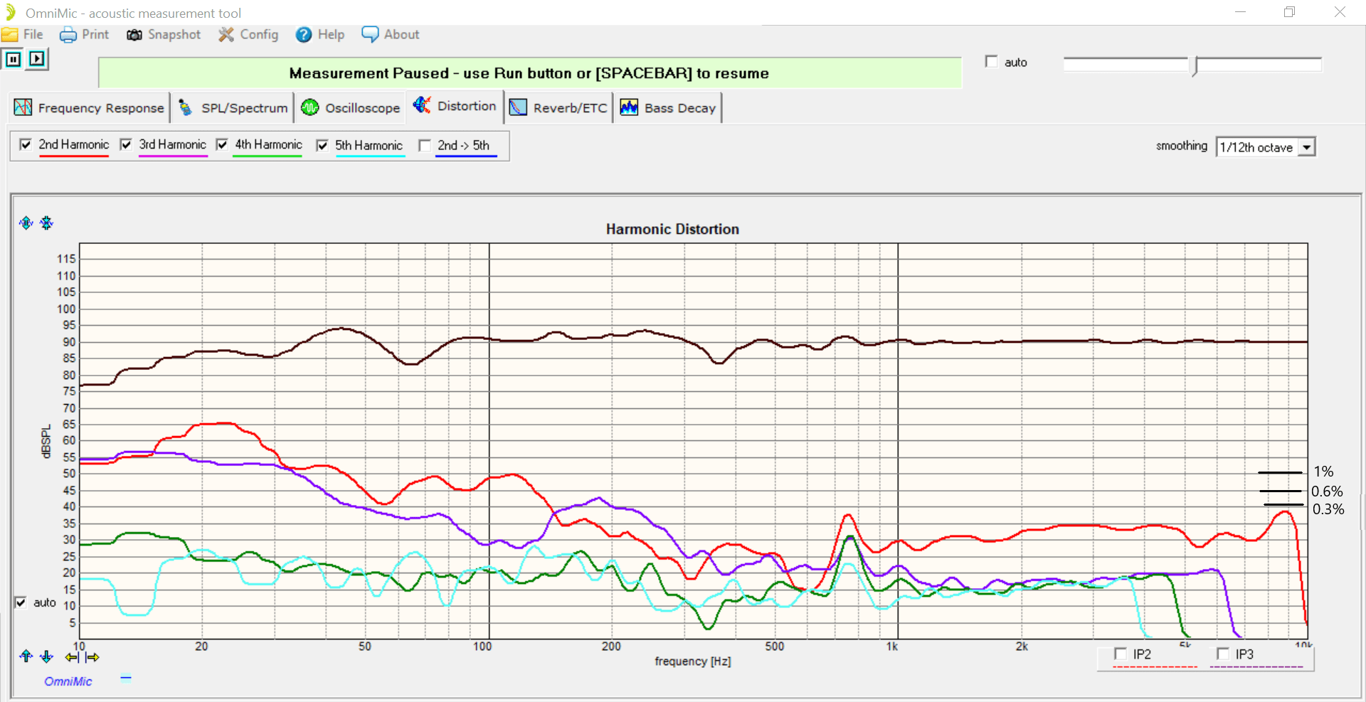

In my textreme system, I crossed a MW16TX to a TW29TX at 1.6k LR4. This is the measured harmonic distortion
odd order harmonic distortion is below 0.3% from 150 Hz up. The 1.6k 4th order crossover is adequate to protect the tweeter and keep its low frequency distortion suppressed. In truth, my noise floor is masking the true distortion, so it could be lower. But it is at least as low as this plot shows.

It's a nice figure, and I think it's really quite good considering especially low XO point. From your data and tests by hi fi compass it looks that indeed the tweeter can handle XO @1.6kHz/90dB/1.4V without a problem of running into high levels of distortion.
However in case of higher drive voltage distortion would raise sharply. That's by about 10 dB for 2.83V/96 dB and IMO is typical of peaks in music while listening on average level. This can be already audible, depending on type of programme material.
The voice coil of a tweeter is tiny. Maybe it can handle a watt, two or so of continuous power unless ferrofluid cooled. Crossing lower means more energy is being fed to this tiny coil, so power compression can definitely become an issue while listening loud. Also power handling is significantly reduced with increased risk of thermal damage.
So what is the big advantage of crossing the tweeter so low ?
Attached link to tests :
https://hificompass.com/en/speakers/measurements/satori/satori-tw29txn-b
By the way, treble response does not seem to match manufacturer data sheet, is it equalized by DSP or similar ?
