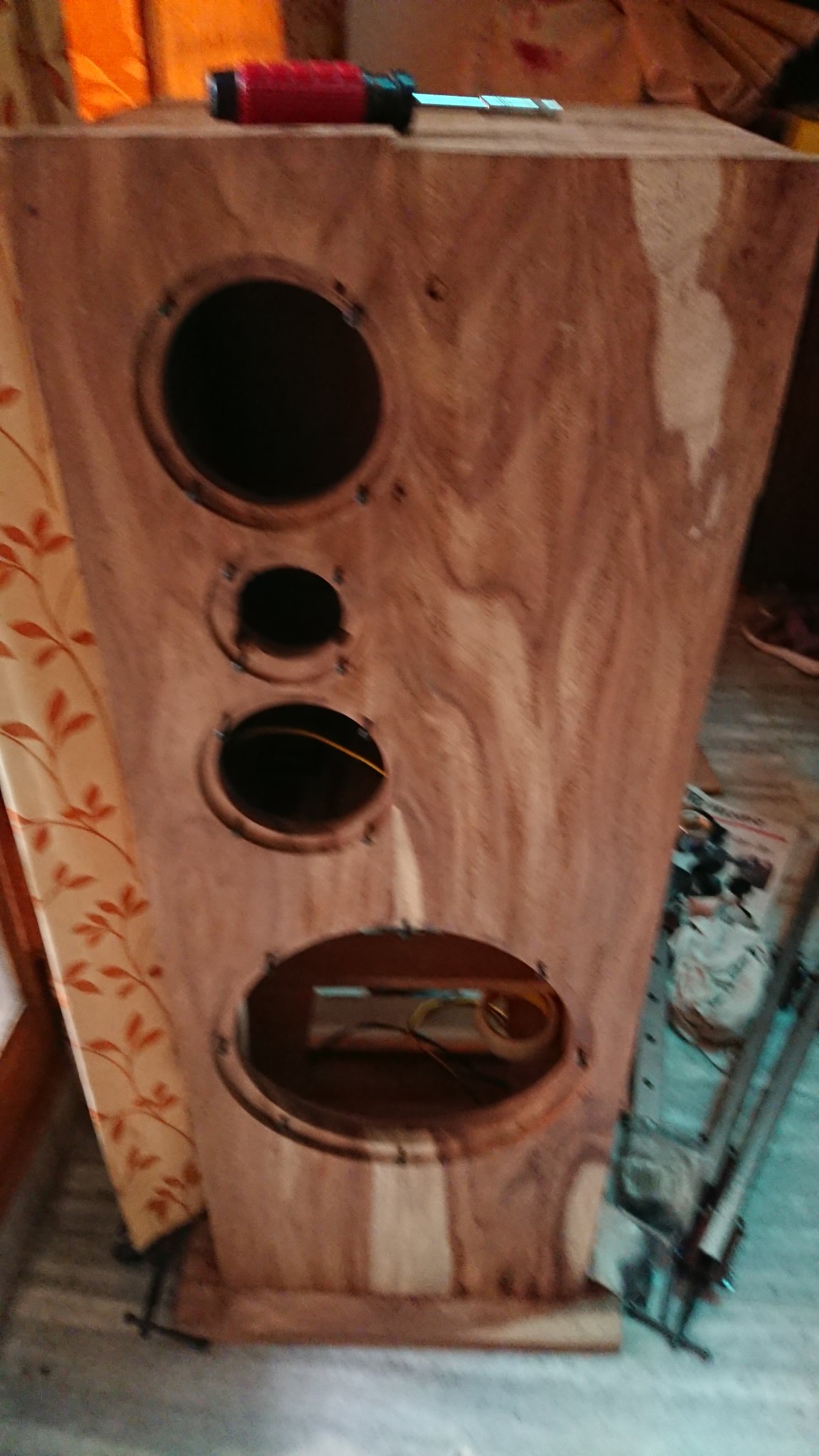

Left Speaker - All pieces cut except back panel and three 2.5 inch braces. Back panel will also be screw mounted using gasket.
  • Maybe glueup tomorrow.
  • Using double baffle, one is recessed 3/4 plywood. Front one is 1 inch thick hard wood and is as per design, will be attaching centre of front baffle to recessed baffle permanently using glue and dowels, away from centre using bolts to allow for wood movement of 1 inch thick panel. 1 inch thick panel will not be attached to side panels as front baffle will expand/contract and rip the side panels. That's is what I understood about wood movement.
  • Few days gap, then driver cutouts, wiring.
  • Will be using rubber paint to seal cabinet.
  • Back panel and the onto right Speaker Front, back, most pieces are already cut.

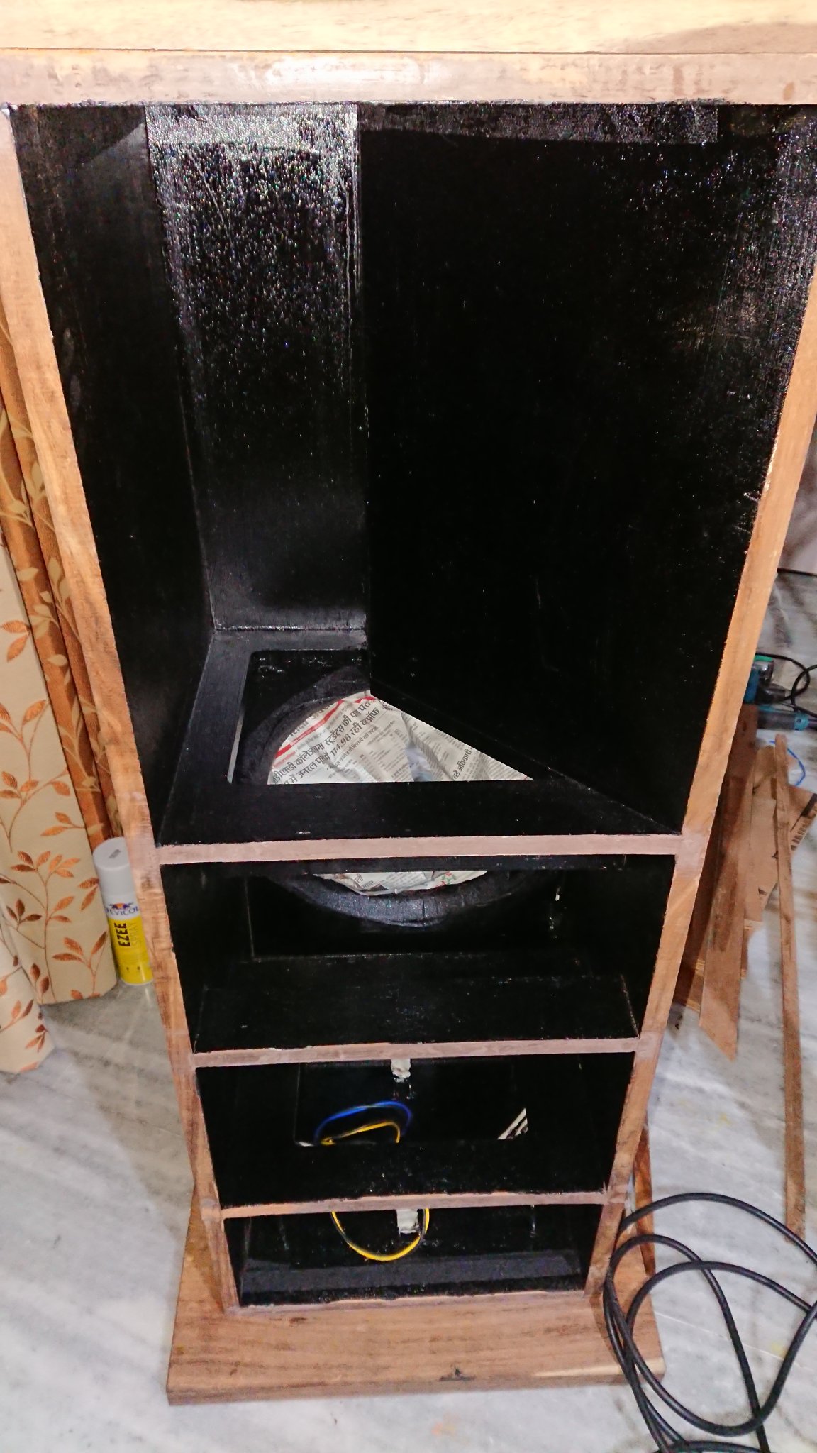

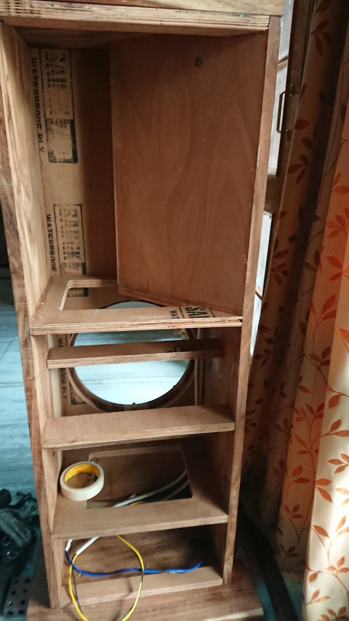

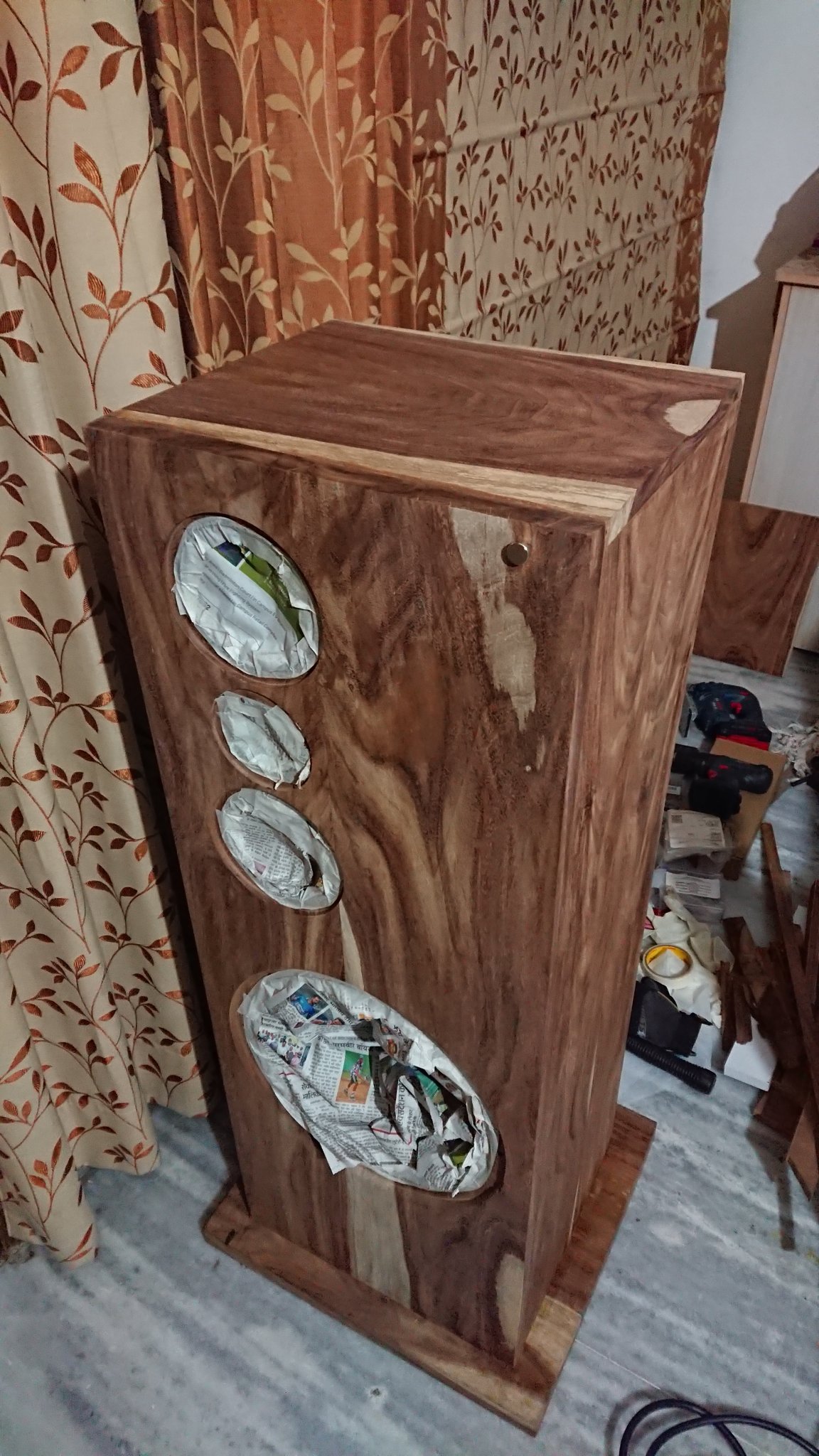

Update
Rubber paint done, used reinforcement cloth with rubber paint to seal gap between front(1 inch floating) and recessed(3/4) inch baffle where drivers are to be mounted and the top cover of the MTM section.
Sanding started, then finish with tung oil and maybe beeswax or shellac on top.
After that mounting of driver, crossover and testing(1-2 weeks).
I'll be using ceramic wool for sound absorption. Will start test without wool and add gradually.
Gasket on back side to mount back panel with screws. I want back panel to be floating so I can make modification to interior easily.
The is only left speaker, right speaker building in parallel
