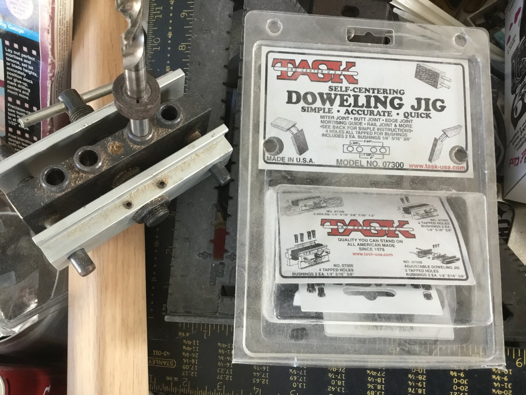

My comments had nothing to do with edge to edge joinery. But I agree with you that doweling in that case is much more about achieving alignment than adding strength.
I was discussing edge to side joinery that the Dowl-it or Task jigs are incapable of doing.
So in that regard I think that those are poor investments and people are much better off spending their money to buy a more versitale doweling jig such as the Jessem or Dowelmax that can do both edge to edge and edge to side joinery with very high precision.
I really should have use the term end to side joinery rather than edge to side in the previous post. That's much more accurate with regard to typical speaker cabinet construction.
But it doesn't change the arguments against the Dowl-it or Task jigs. They are only applicable for edge to edge joinery, which isn't sufficient for all the joints necessary in building speaker cabinets.
Both Jessem and Dowelmax can do it all.

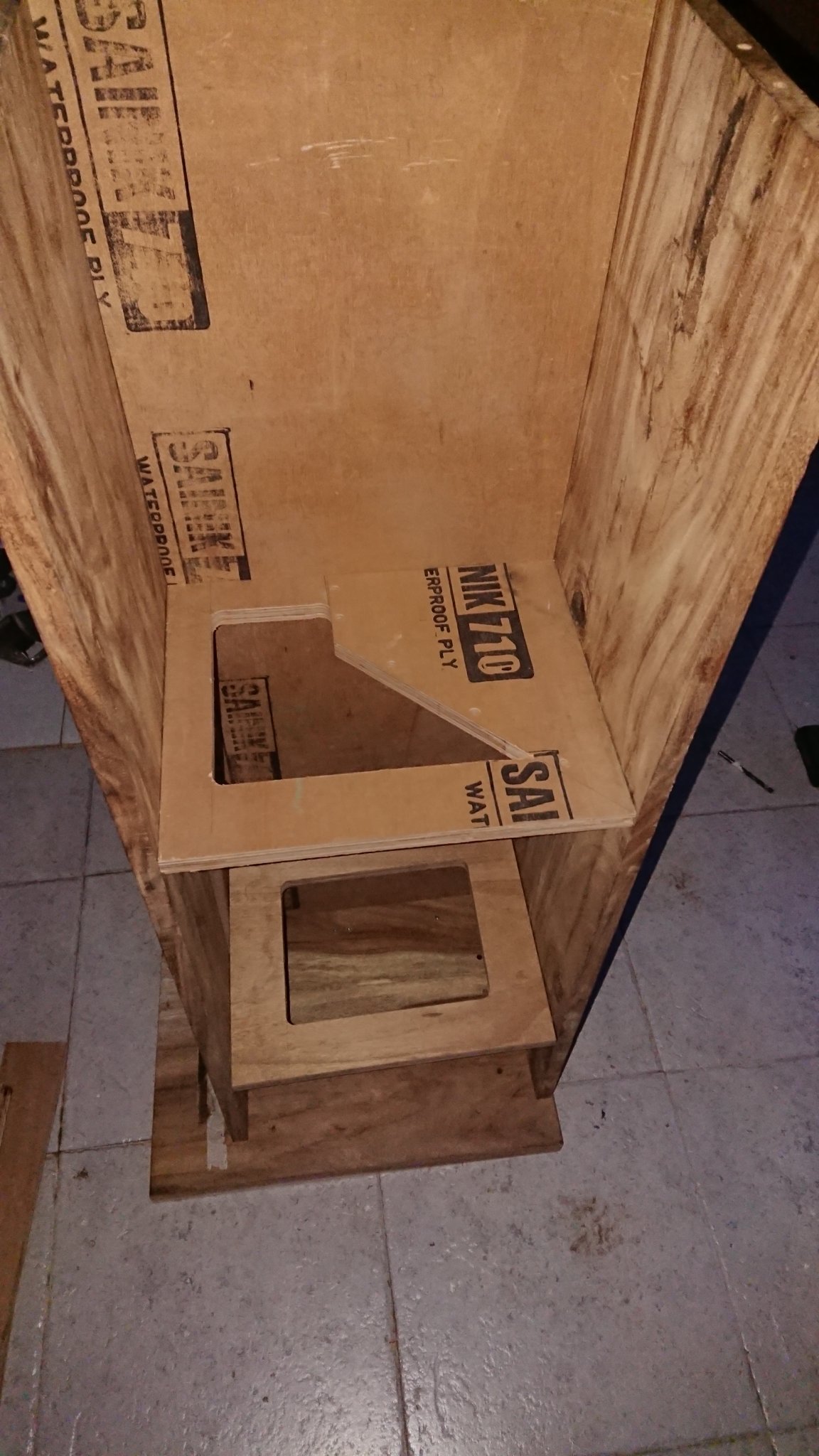

Left Speaker - All pieces cut except back panel and three 2.5 inch braces. Back panel will also be screw mounted using gasket.
  • Maybe glueup tomorrow.
  • Using double baffle, one is recessed 3/4 plywood. Front one is 1 inch thick hard wood and is as per design, will be attaching centre of front baffle to recessed baffle permanently using glue and dowels, away from centre using bolts to allow for wood movement of 1 inch thick panel. 1 inch thick panel will not be attached to side panels as front baffle will expand/contract and rip the side panels. That's is what I understood about wood movement.
  • Few days gap, then driver cutouts, wiring.
  • Will be using rubber paint to seal cabinet.
  • Back panel and the onto right Speaker Front, back, most pieces are already cut.
