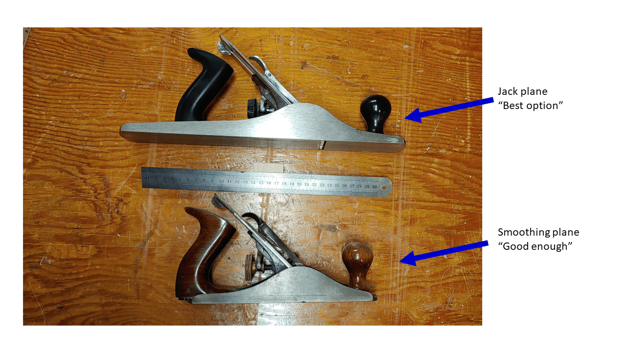

This would be the first thing I would try. A small level of waviness at the glue-line can be corrected with a hand plane. it is not fast, but it works. Professionals no longer do it this way, because time is money, but a decent hand plane is not expensive, and it is fairly fool proof. The right tool for this is called a "Jack Plane" and has a length of 15 to 18 inches. A shorter 12" plane "Smoothing Plane" can be used. Don't try it with a small block plane.when using wood, I find that I can apply fine control with a simple stanley handplane.
Clamp the pieces together, and with a pencil, mark the spots with good contact. These are the high spots to be shaved down. Then separate them and shave a bit off of the high spots. Repeat the process over and over until a tight fit is made.
It is very important that the plane blade is very sharp.

About using hand plane, don't you need experience to use it correctly. I tried to plane with electric plane and created high and low spots.
First I am going to try this and then I'll try hand plane.
You can probably find a good used plane. They are simple devices, and they never really wear out. Some of mine are at least 80 years old.
