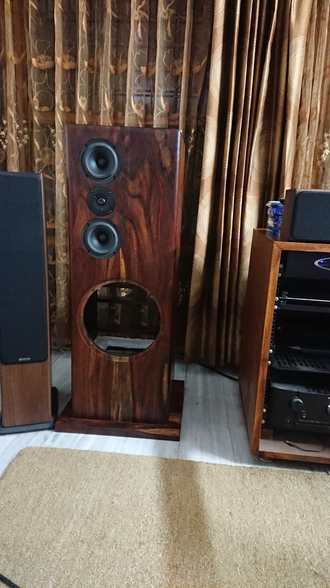

Used a 3/4 roundover and sanded it with a sander(80 grit) to make it rounder.
Back panel pending, will mount woofer crossover on Back panel. MTM and DIY crossover fixed and did a quick test. It is making music 🙂
I have put in 1 inch ceramic wool all around the MTM section.
Applied tung oil and dried for 2 days and applied wax over it with a hair dryer. Only thing I didn't like is that the sapwood turned out darker.

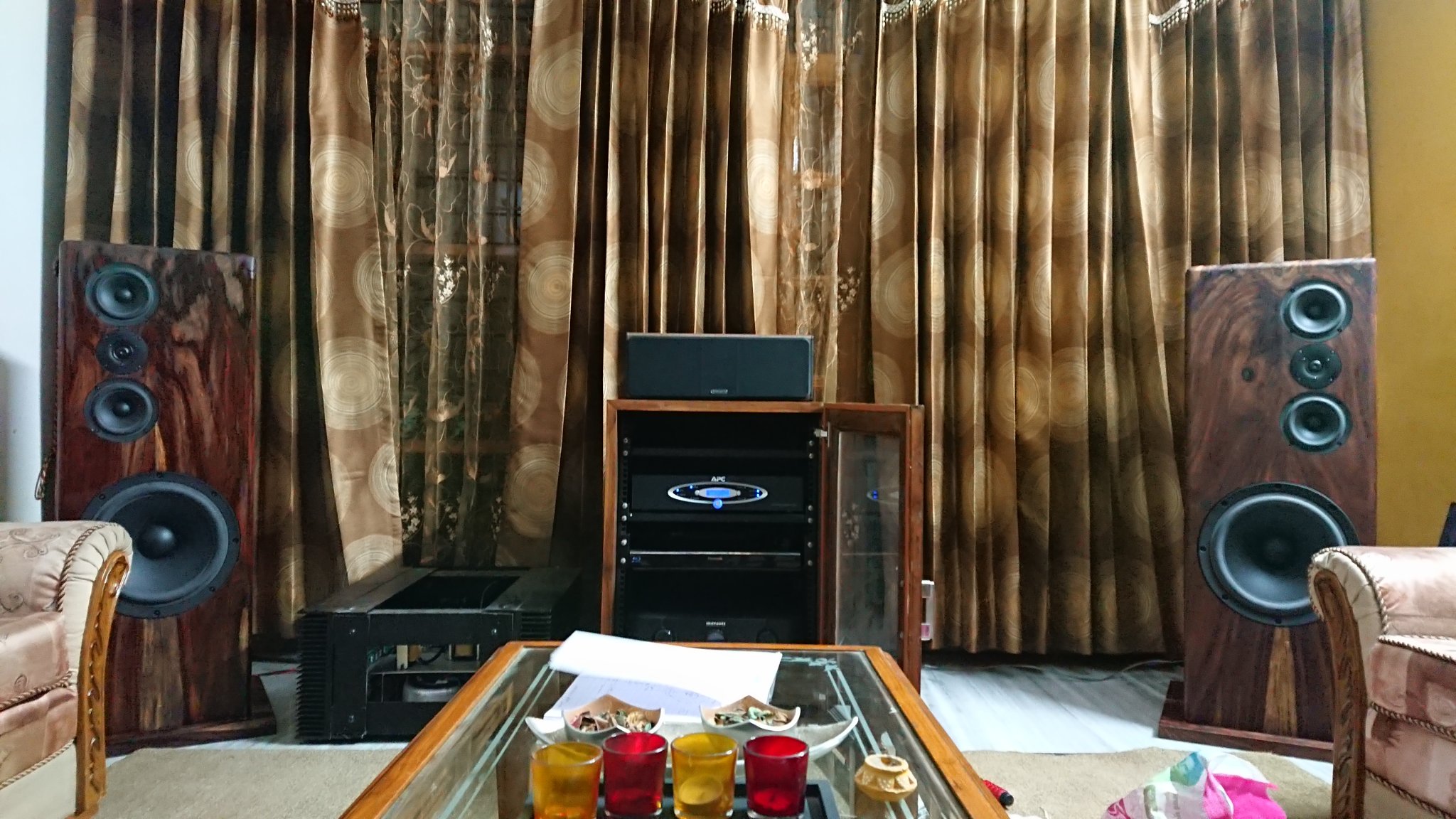

Update : Speakers are 95% complete. Assembly is complete.
1. Need to apply tung oil on the outside over a period.
2. My first impression - I love them, especially for Mid-Low response.
High and Mid are good, but bass needs some therapy. I am not an expert, so I don't know how to describe the issue I am experiencing, Bass is good and it is tight but it could be tighter with more punch, there is a vibration like bass signal has been stretched over time. At present bass section is only painted with liquid rubber with nothing else inside. I have used ceramic wool for High-Mid section, but I do not want to use that in bass section as it can disintegrate easily with high air pressure. I am going to try coconut coir door mat to treat bass section 🙂

Wow. What an accomplishment. That wood is stunning. In time, you will get all that you want out these speakers. They look to be well thought out, and it has been a long road.
If getting into the cabinet is relatively easy then you can start with pretty simple experiments with say maybe a pillow fit into that space inside. Not too big of course. A fibrous door mat may not do anything worthwhile.
