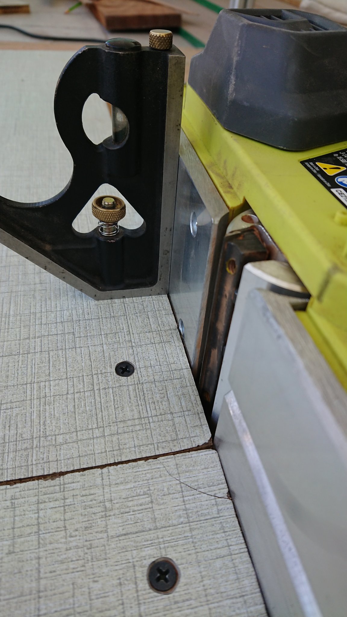

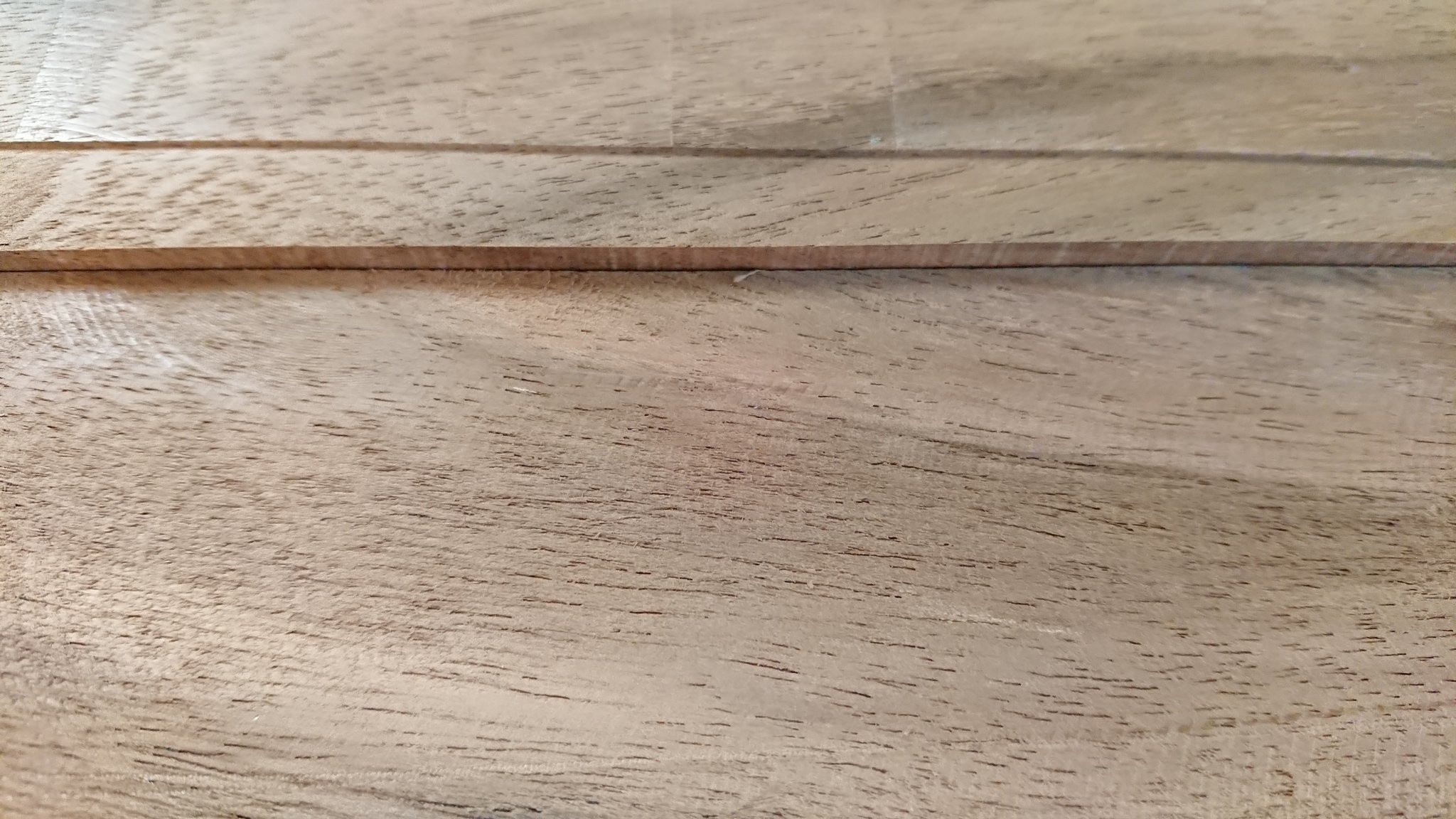

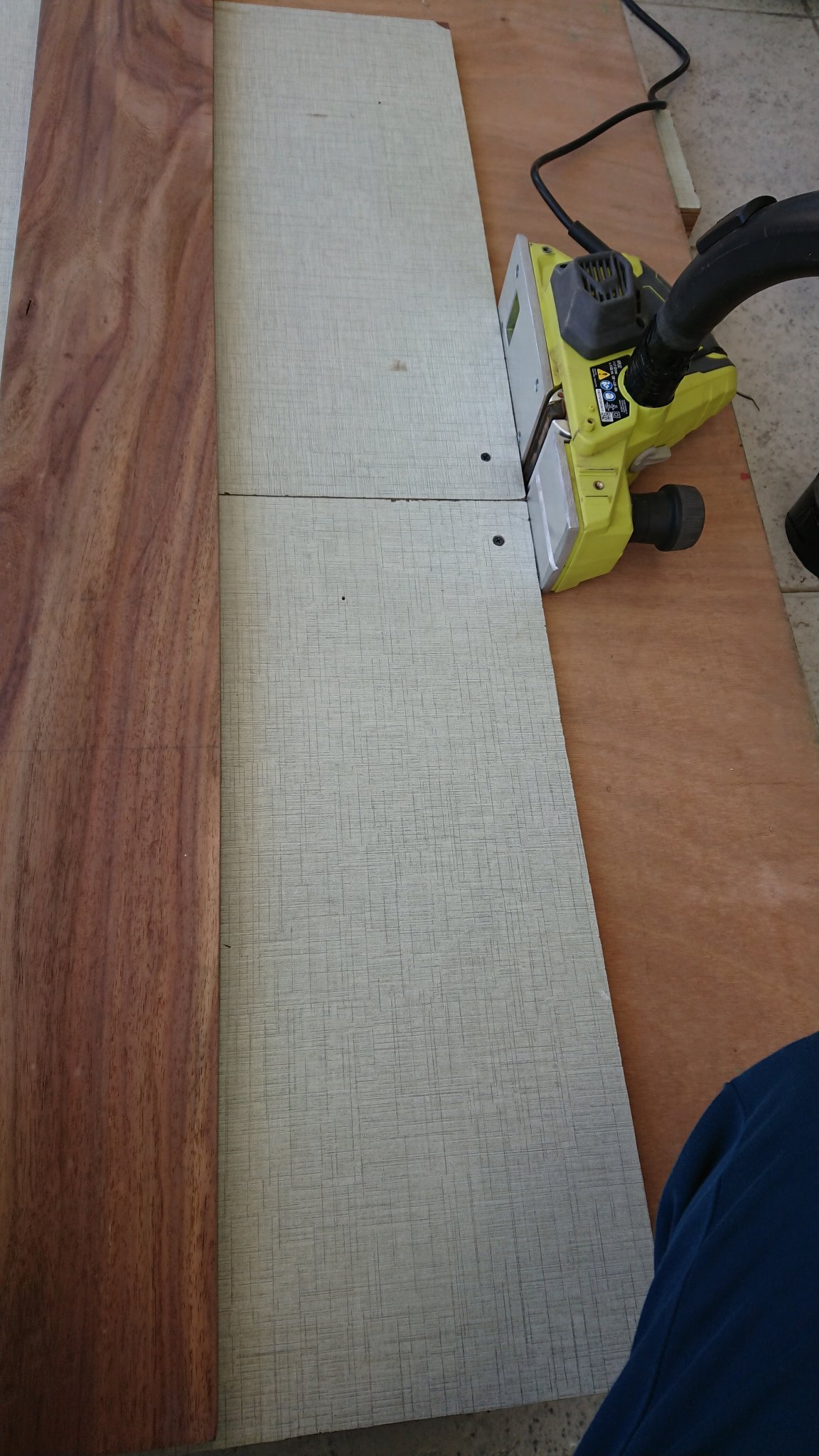

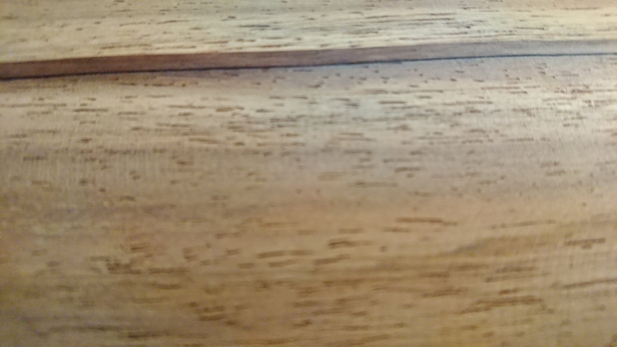

Good result, 75% length, there is almost no gap(can't put or slode a paper in between) at all except bottom 25%, maybe due to short length of the outfeed side of planer.

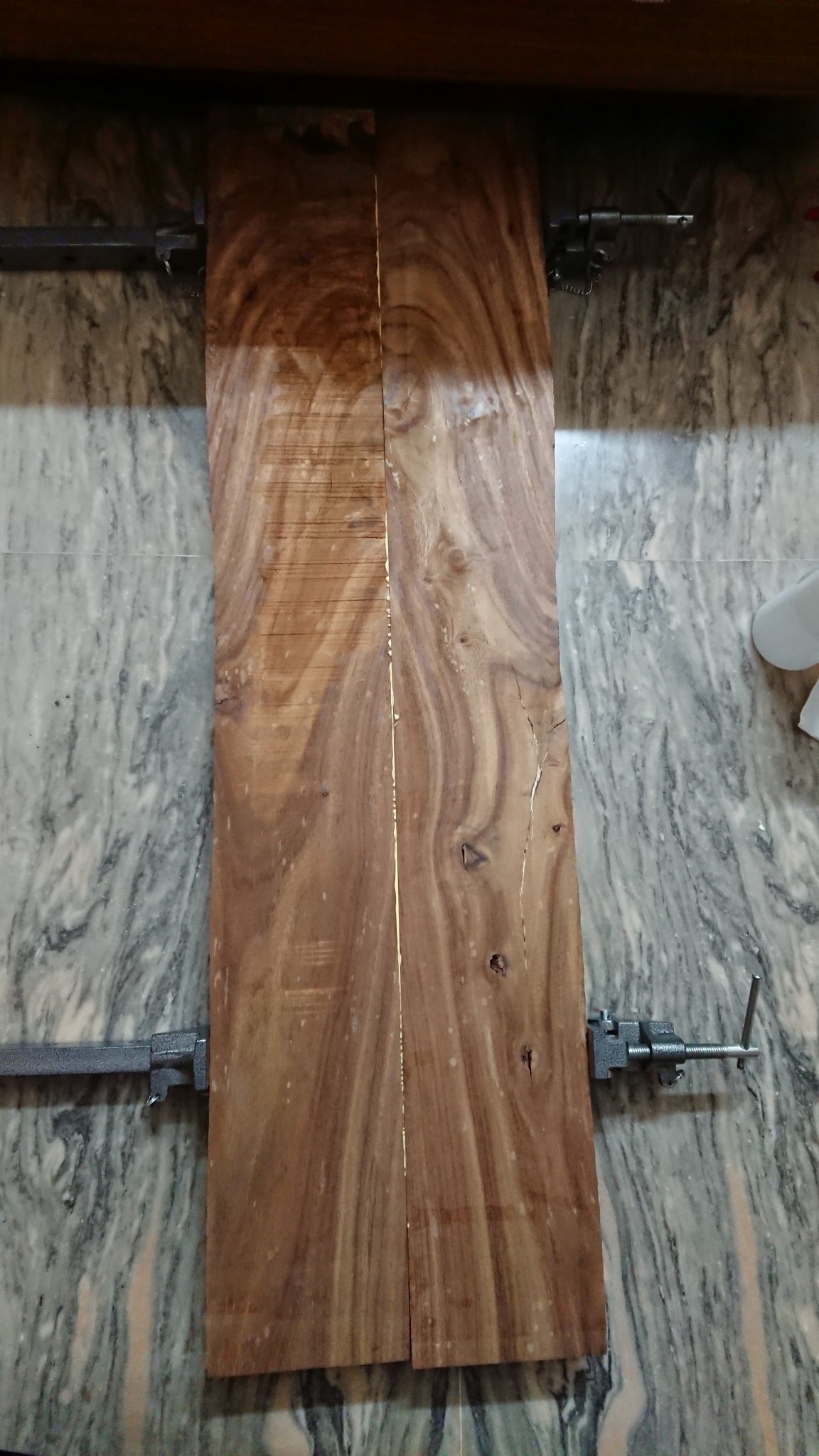

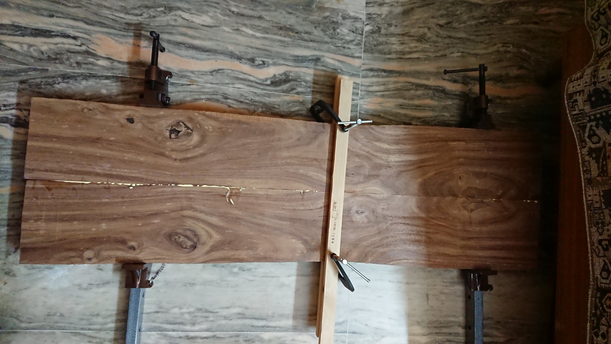

Will start glueup to make panels. Since I have only two bar clamps, will take few days.

Now 24hrs to dry.
One mistake I did, usually we finish all sides and then joint.I left some pieces unfinised/not same thickness. I will need to plane/level them with surfacing bit to make all sides 90deg and then make the final cuts on sides.

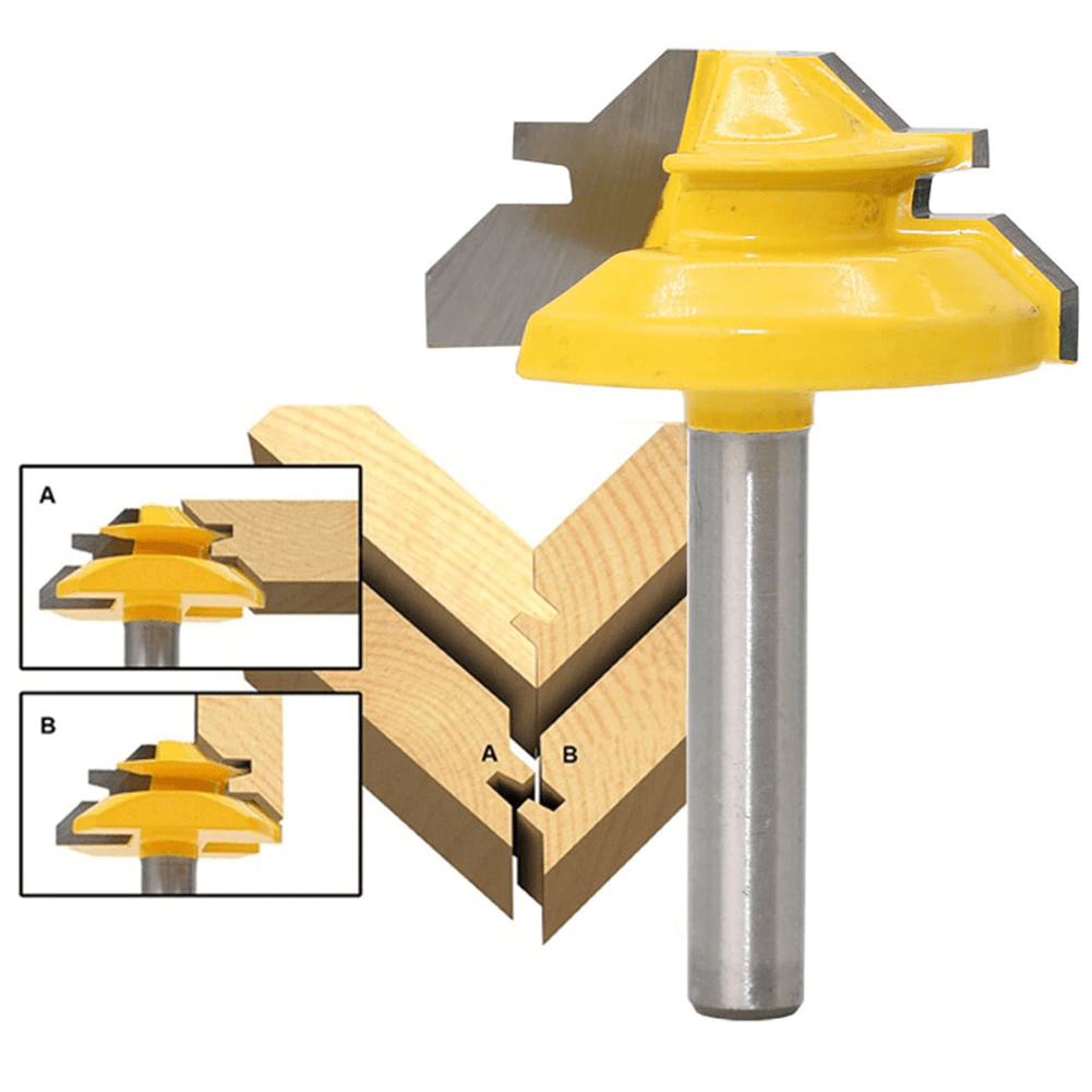

The lock miter bit mentioned by @classicalfan makes a very good right-angle joint. It is excellent for plywood/mdf or other sheet material which have a consistent uniform thickness. The joint must be cut with a precise bit depth and fence position, and this is determined based on the material thickness... If one sheet of material is 18.3 mm thick, and another is 18.7 mm, the setup will be different.
To anyone interested in this router bit, I highly recommend the setup tool which aids in exact positioning of the bit depth and router fence position.

It is already proving challenging, I milled all wood in January during timeoff from work, but failed at jointing. So had to put a pause for some time and stored the milled pieces inside, between then and now some milled pieces have developed minor bow, I kept some margins for 2nd milling, but now temp on higher side so rushing to step where I can cover it with oil and shellac so that movement is reduced.That is some very beautiful wood. I hope that it works well for you. Some of the hardwoods can be challenging. Come to think of it, I have a short hallway in my house that is solid (not veneer) 3/4" rosewood. Fortunately, it was prefinished when I got it. Leftover from a large flooring project.

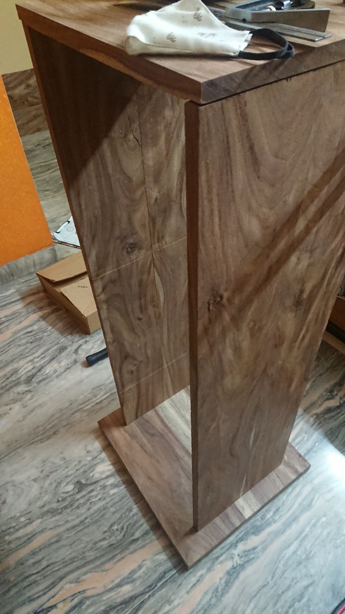

Is it advisable to put corner brackets in speaker box to make it sturdy?
Something like this
Something like this

I always do. Bracing that provides strength in a corner serves all associated sides. Other internal bracing is used with a round over on its edges. At least that is my thinking. What adhesives do you have access to?
What are you using for joinery? It looks like just plain butt joints from the picture, but it's hard to tell exactly what else is there.Thank you,

Some well placed dowels can add a great deal of strength as well as possibly straightening out the wood at the same time. And you won't need the metal corner brackets at all.
Dowels are made for alignment, they add no strength. Pardon my saying so. It is that I have enough background in just this sort of thing (cabinet making). Biscuits as well are newer development and no they don't really add strength either. The joinery is key for making a strong joint, but in this case if only a butt joint is being used, then you better have blocks or maybe pocket holes for screws. I am not a big fan of those either, but they can have their place in building.
Fortunately there are other ways to strengthen an enclosure. One popular way is to run a rabbit joint all the way on the back of the enclosure and then insert the back panel giving an incredible increase in strength. You could do kind of same thing with the front baffle bay routing a rabbit around its edge that just fits inside of the front of the enclosure. I did this with the last set of speakers that I built and plan to use this idea more in the future.

I have used titebond original for joining.I always do. Bracing that provides strength in a corner serves all associated sides. Other internal bracing is used with a round over on its edges. At least that is my thinking. What adhesives do you have access to?
I tried miter but couldn't perfect it so changing it to butt joint.What are you using for joinery? It looks like just plain butt joints from the picture, but it's hard to tell exactly what else is there.
Panels are joined using dowels 5/16 inch and panel to base as well. Since it is heavy enclosure I'll put some sort of corner brackets to make it stable, so that when its lifted or tilted it doesn't become leaning tower of pisa 😀

Dowels, in fact, add a great deal of strength to a joint. Used correctly they can produce a joint even stronger than one made with Dominos. Here is the proof:Dowels are made for alignment, they add no strength. Pardon my saying so. It is that I have enough background in just this sort of thing (cabinet making). Biscuits as well are newer development and no they don't really add strength either. The joinery is key for making a strong joint, but in this case if only a butt joint is being used, then you better have blocks or maybe pocket holes for screws. I am not a big fan of those either, but they can have their place in building.

You really don't need corner brackets in a speaker enclosure. Once the front and back panels are attached they will provide all the strength needed to keep the enclosure from racking.I have used titebond original for joining.
