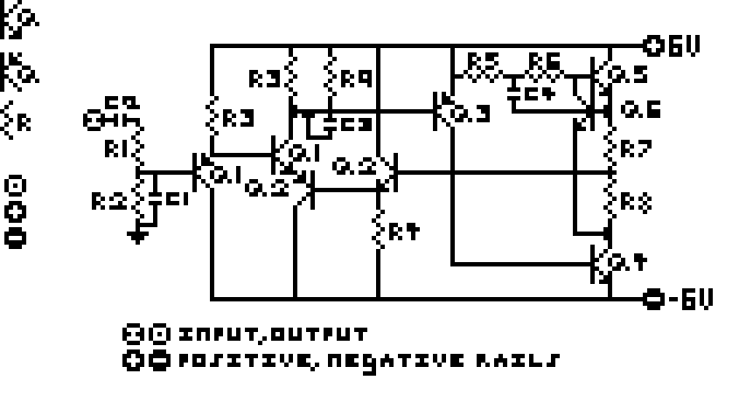

On a side note, I'm testing out a super-compact schematic drawing style! Well actually I'm really lazy and this looks the best with the fewest mouse clicks. I wonder if there could be problems copyrighting a schematic drawn using LTSpice.
Cool, huh? I could fit the entire schematic in my avatar!!!
- keantoken
If you didn't catch that, here it is blown up. 😀
I was fascinated with pixel art for a small time, which produced my avatar. It is incredibly hard to draw the number 2, 3 pixels high.
I don't think I will test the capacitor today, not enough time.
- keantoken
