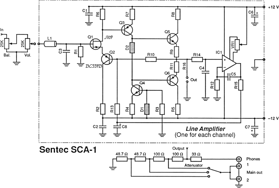

Noticed this while perusing some manuals I downloaded a while ago, thought some might find it of interest
Rgds
James

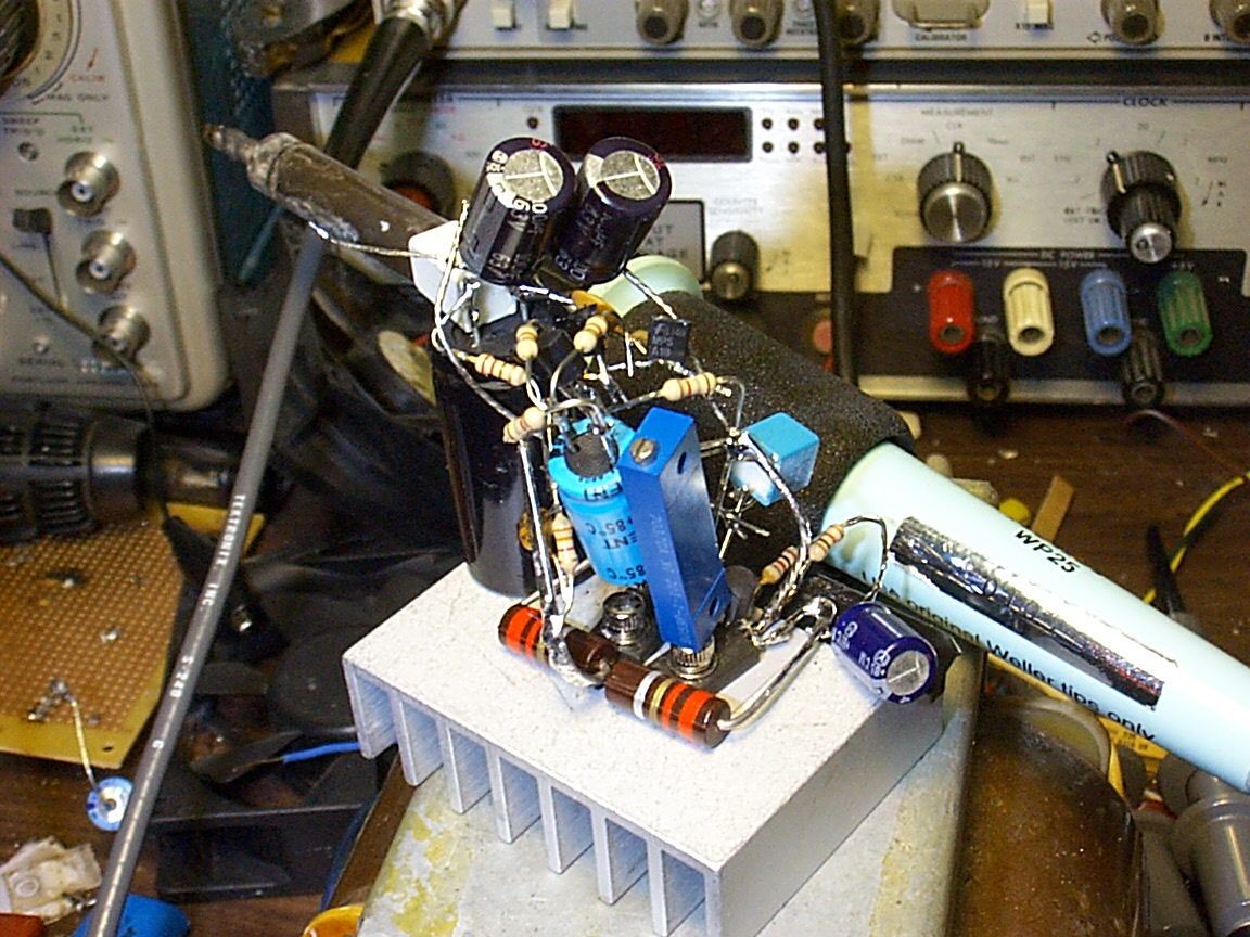

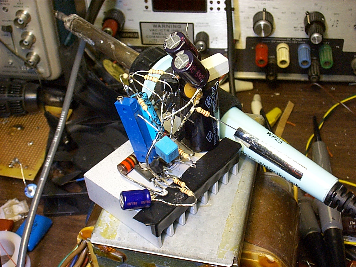

Okay, I FINALLY fried my last prototype, and couldn't figure out what went wrong.
It was a cruel accident of fate. The patient was operated on without anesthesia, so was still active during the procedure. With no speaking apparatus, there was no way to tell the surgeon.
Anyways, I made a totally new prototype. Before this happened I was going to replace the trimmer in the compensation network with a resistor and see if that would improve stability. This time I took the liberty of updating the wiring scheme. I was going to wait until I had new transistors from the same batch, but I tried listening to my computer on headphones and I couldn't stand it. This amp sounds so natural and detailed, with a sense of space that makes the music seem more real. It also sounds beautiful with music that wasn't recorded in a realistic way. Even on speakers this is all very evident.
I used the best transistors in my junkbox:
PN200A
MPSA18
2SC945P
2N4124
2SD669A/B649A
All very fast transistors. And Lol, it's still not in stereo.
I will have to fix my signal generator soon, so I can test it and other things.
- keantoken
