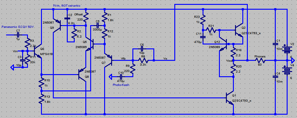

Here is the schematic again, as-built right now.
I should increase C2, it will help into capacitive loads. However I believe an alternative is a small output L||C, which would improve stability without impacting performance at audio frequencies. I favor this option over increasing compensation; a 500nH||22R network improves stability greatly, with hardly an impact on 100KHz phase shift.

I just plugged in the headphones to listen again. I didn't expect it to sound very different with headphones because the speaker emphasizes all distortions, but I believe I'm wrong about that.
It still sounds excellent, even better with headphones. I am very pleased with this amp!
The bass is extremely impressive, to me at least, and especially after adding the photoflash cap. This is a change I highly recommend if you've been using stock electrolytics!
While it sounds very good on speakers, on headphones it is exquisite.
The square wave still shows overshoot, unfortunately. To cure this I will increase C2. Even so... That is the last of my worries, if I can make it unconditionally stable with an L||R as the simulator predicts.

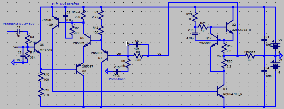

Capacitor Woes
There was audible hum at first, and I realized this was because the H2 generator was removed, and no longer providing the benign side-effect of increasing PSRR by filtering the bias network. To fix this, I decided to add a filter cap across the H2 generator break points. However, simulation confirmed that due the the low 100 ohm resistors, HF operation would be affected, and the last thing I want in the compensation path is a bulky electrolytic capacitor. So I increased the 100R resistors to 1k, which works well enough.
On the way, I realized I was not using a 6.8nF compensation cap as I had thought, but actually a 68nF cap! Oh the humanity! Oops... I just replaced it promptly with a 6.2nF cap, and will audition shortly.
Here is the new prototype.

Square wave tests mostly the same, I think even better.
Cymbals and upper midrange are MUCH better, instrument separation has also increased a lot. Highs are sharp but not fatiguing.
This is the initial impression listening to the speaker, but I will test out headphones later and see if the hum is resolved as the scope suggests. I could also actually hear pixels changing on my monitor... Weird (maybe the new soundcard?)

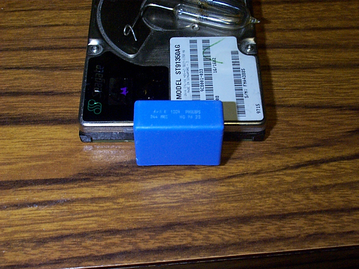

I think the new MKC cap by far sounds the best.

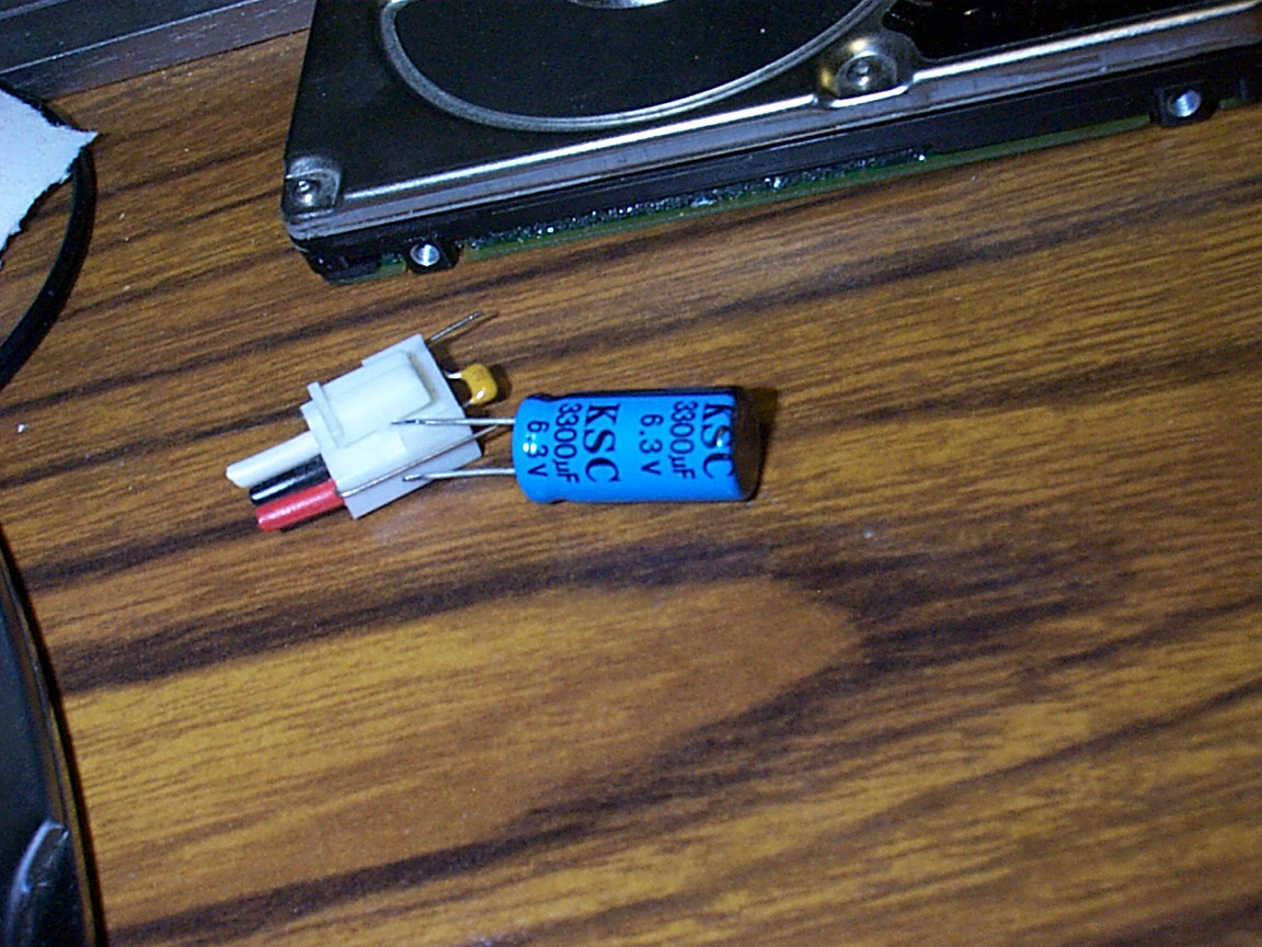

Attached is one of the caps I was originally using for the feedback DC blocker. When I tested ESR of several caps, I found to my surprise that this one had amazingly low ESR for it's size. Usually smaller caps have higher ESR. So big cans might have high ESL but still have VERY low ESR. These can be gotten out of "Glade Wisp" air fresheners. I harvested this one so I would have a stereo pair, to be used for C5.
