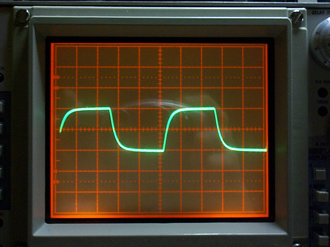

So, considering the above, the theoretically correct way of setting compensation would actually be to start with R2 at near 100 ohms, and decrease until oscillation/ringing stops.
The interesting thing about this circuit is that it seems to be immune to capacitive loads, thanks to the special attention made to the compensation. In simulation, stability margin into any capacitive load will be no worse than 20 degrees. So in fact, if this bears out, we may be able to set normal stability margin at less than 90 degrees, since capacitive loading will pull the margin to around 20 degrees no matter what. However this has ramifications for other load types. Voltage drive amps are by nature immune to inductive loading, and usually require very little compensation if an inductive load is all that is expected. Optimally, we hope that the C6 miller cap is all that is required to make the amp stable into inductive loads. However when this is not the case, such as it is for this amp and most others, we must increase other types of compensation.
Inductive stability is very important, since at HF your amp will most likely see an inductive load no matter what, be it speaker cables, headphone cables, etc.
Attached is a square wave at 200KHz - no ringing! Connecting the speaker wires, with or without zobel, doesn't change this square wave behavior. This is with an R2 value of 25 ohms.
- keantoken

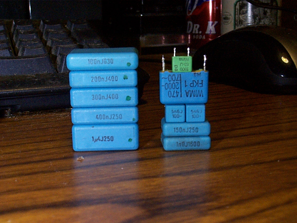

Okay, I just replaced C2 with one of the small 5n6 blocks in the photo below.
The highs are much smoother, much less harshness! Yes, I know I said the harshness was gone already... But there's less of it now, I swear! It looks like I just haven't hit the limit yet.
- keantoken
