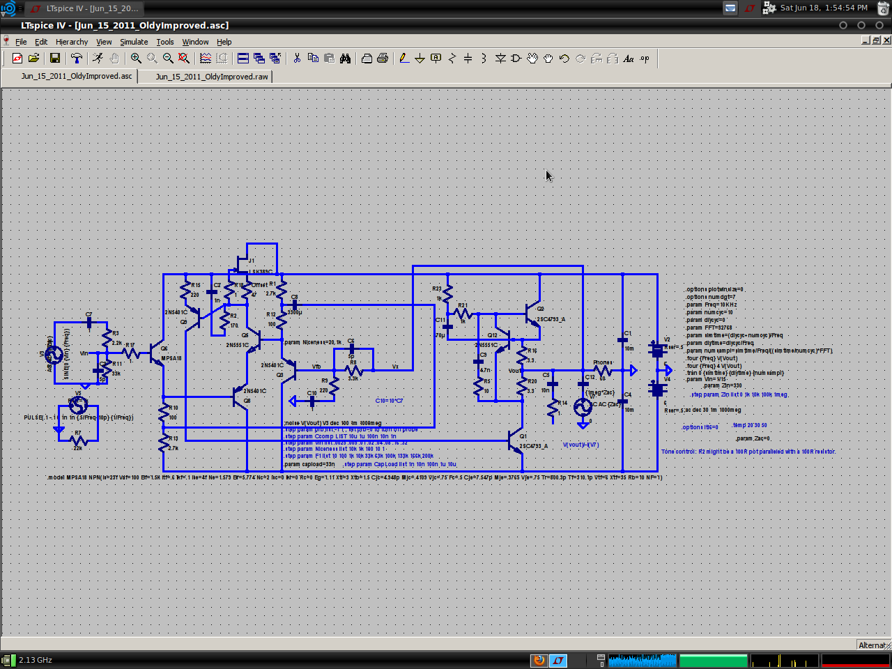

I still can't find those germaniums, they dropped off the face of the earth.
Offset cancelation does work on this amp. If you keep the rails steady, offset usually stays within 1mV.
The frontend is unique in three ways, the NTP usage, the lack of B-E resistor for the output transistor, and the use of shunt compensation.
The 2SC5171 would probably be best here. I was using the 2SC4370 before though, and I got it sounding very warm and smooth. However with faster outputs like the 2SD669, there is more definition. So I plan to test with the 2SC5171, because it's Beta rage extends to 300mA and it is fast, which makes it an ideal candidate.

Q1 Q2 Q12 Q9 all flirt with saturation and probably slow to recover because of it.
Q1 needs base to emitter resistor. All the above except Q12 might benefit from a
Schottky diode from base to collector. Q12 a weird situation, Q2 wants a higher
threshold for best operation of Q12.

Here is the schematic I'm currently looking to build. The reduced reliance on Q9's Vbe should increase reliability.
R15 will allow me to use a smaller C2. I will change this resistor to see which capacitor is best for the position of C2.
The prototype I'm using right now has a 33R degen for R15, and a ~45R+15nF network for C2 and R2. Those are the only changes since the last modification. Oddly enough the sound of everything has changed, especially the strings. Again I'm bumping into the issue of not ever having been to an orchestra or any kind of real concert. It still sounds better than it did before, so I will continue.
