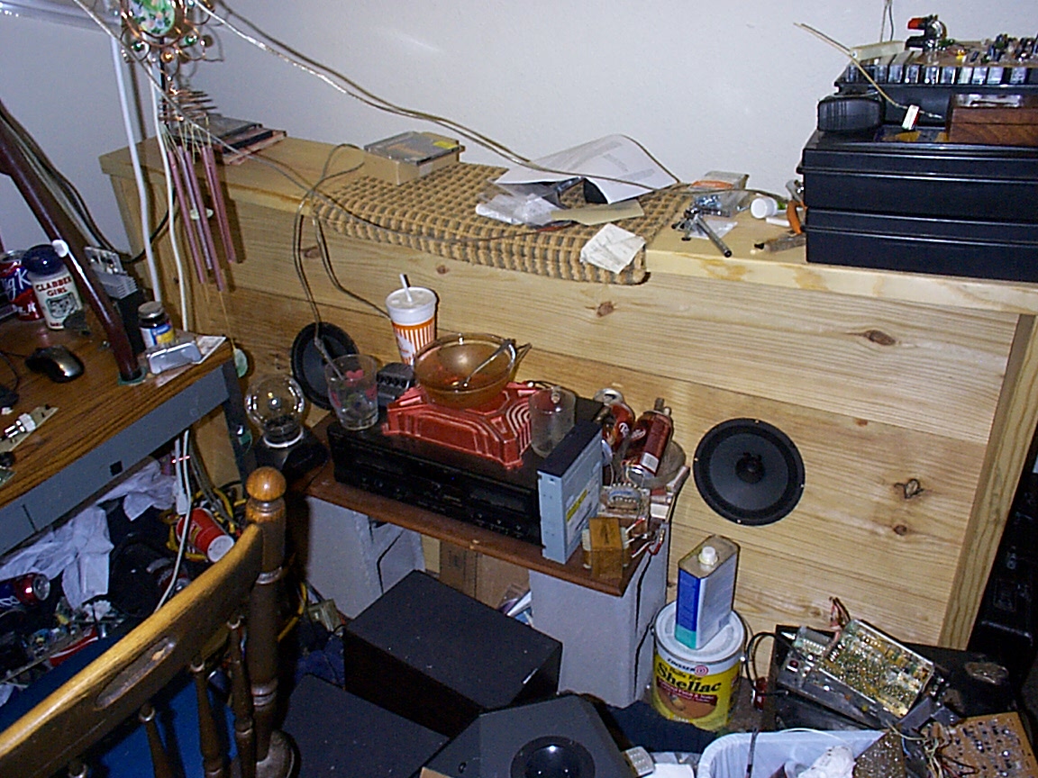

Someone commented about my workstation. I suppose I do have enough equipment to do a few interesting things... Though I would prefer a nicer signal generator. Not many parts to throw together either.

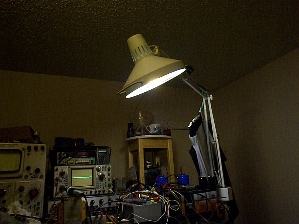

I thought I was obligated to post a decent picture of my workstation head-on, without that ugly speaker in the way. It is currently playing, as can be seen on the scope and DMM, through the right speaker in the second picture.
However I think the last picture is what will make you drool...

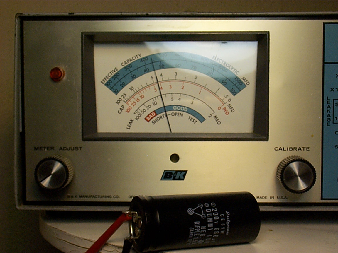

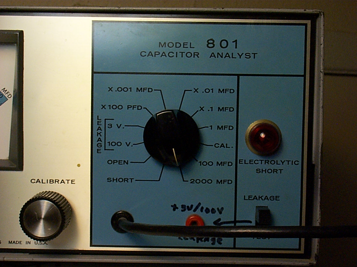

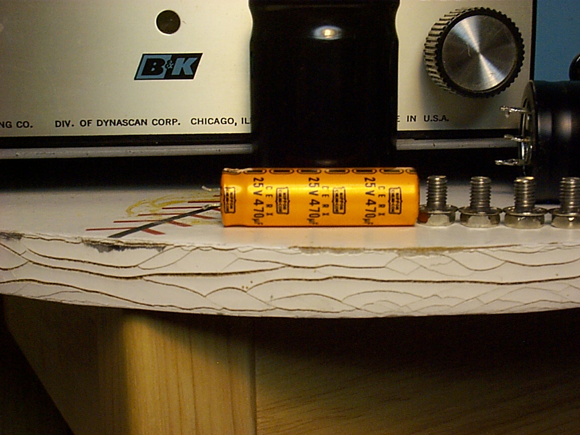

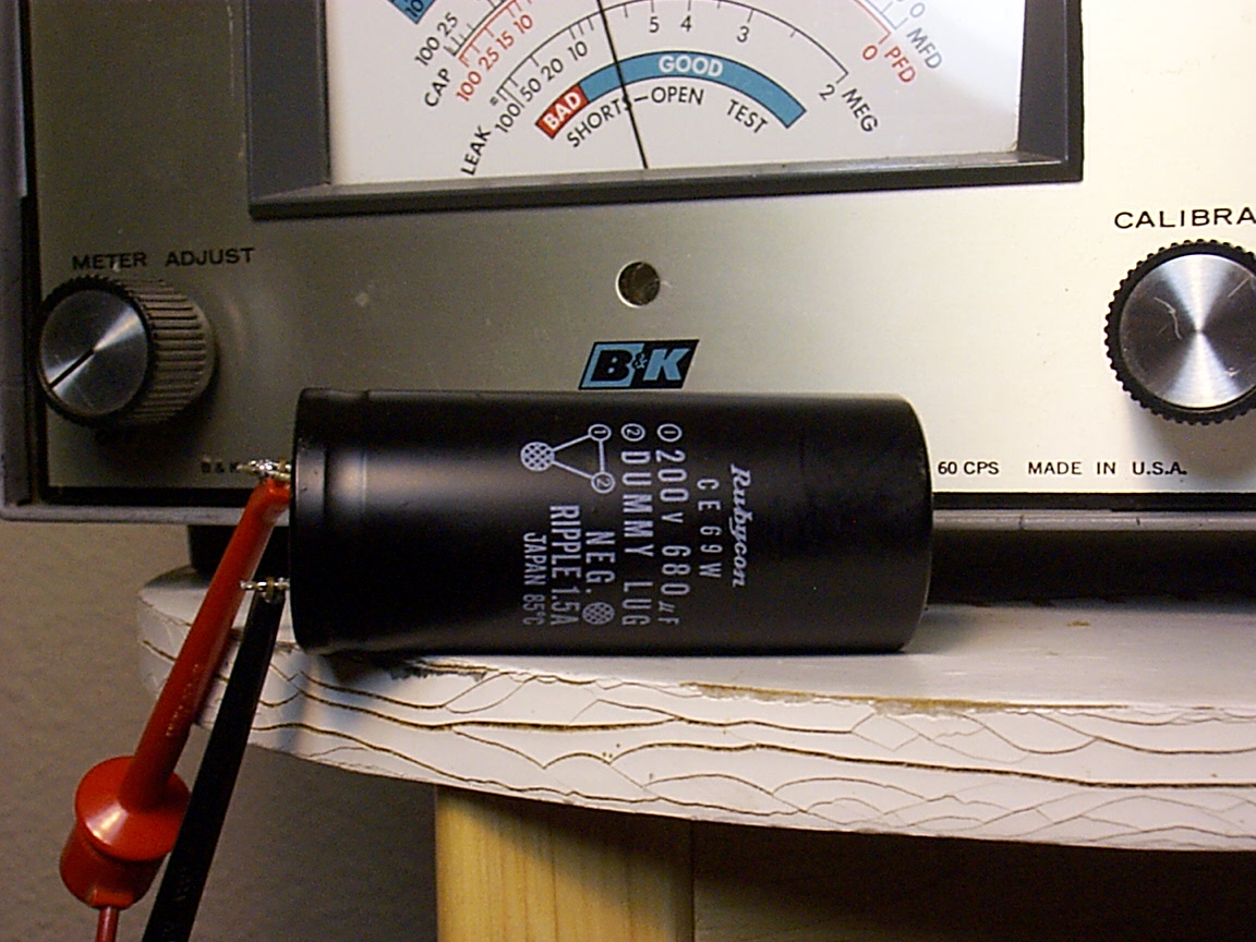

The "effective capacity" reading on the capacitor tester is interesting. Most electrolytics only have an "effective capacity" about half their capacitance value - however, a golden orange NCC 470uF cap from 1979 has an unusually good figure of 400uF. Annoying, since you can't tell the actual value, but useful at the same time.

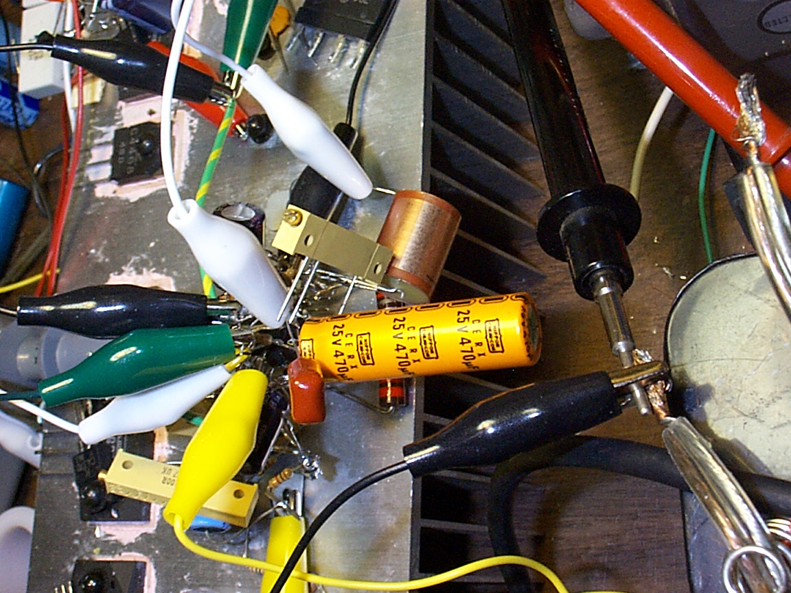

I do believe the change is for the better.
With the smaller feedback cap, bias is much easier to tune (a large feedback cap will magnify small offset changes).
Everything does seem to sound better. Seems to sound more musical, instruments are fuller.
Anyways, although it was an impulsive move, anything could have been better than that 6.3V 3300uF (not 6800u in fact) cap (now 470u, with mylar 1u bypass), and the input cap used to be mylar, polycarbonate can't be a bad move, especially an Ero MKC.
I also removed the Niceness circuitry, it seems to affect stability and as I've discovered, the compensation is crucial for this amp. I may try it again under more controlled circumstances. Anyone wishing to try for themselves shouldn't be worried, compensation is only affect at the very highest extreme setting.

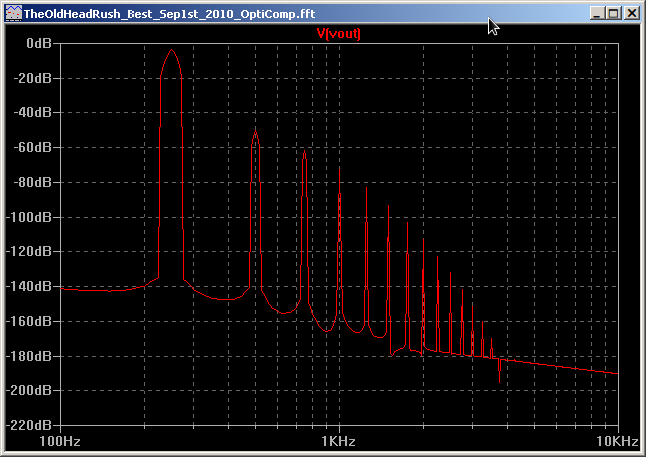

FYI, this is the worst case spectrum driving my current load, the Wild Burro BetsyK. Worst impedance is about 5.4ohms at 250Hz. Even so, it is the best sound I've heard!
