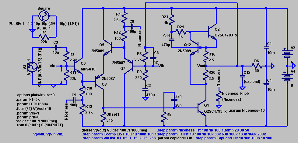

Rush Cascode Headphone Amp + JLH Output Stage

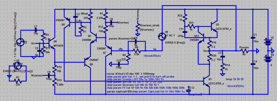

V6 and V7 replace capacitors, so I can get a low simulation noise floor and see the low-level stuff.
Here is a nicer schematic.
- keantoken

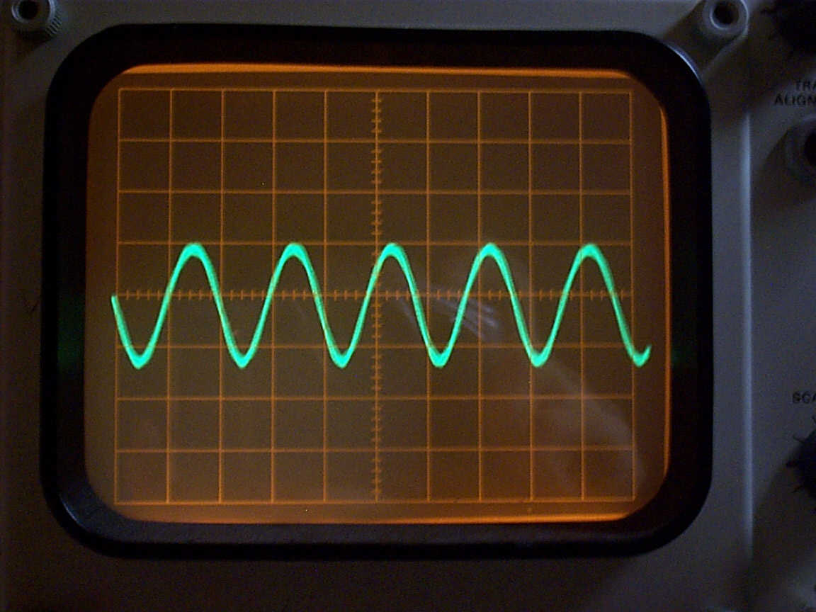

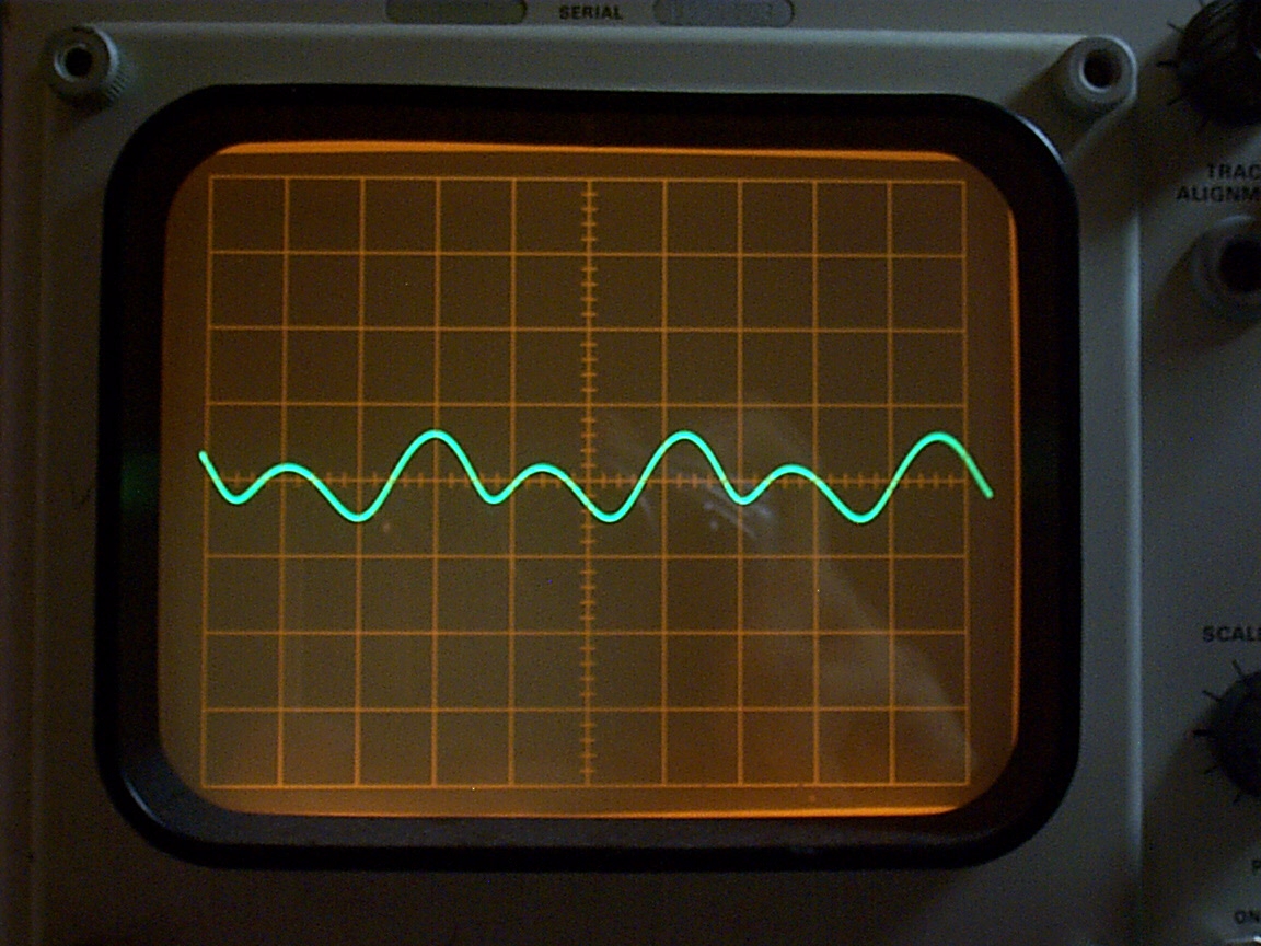

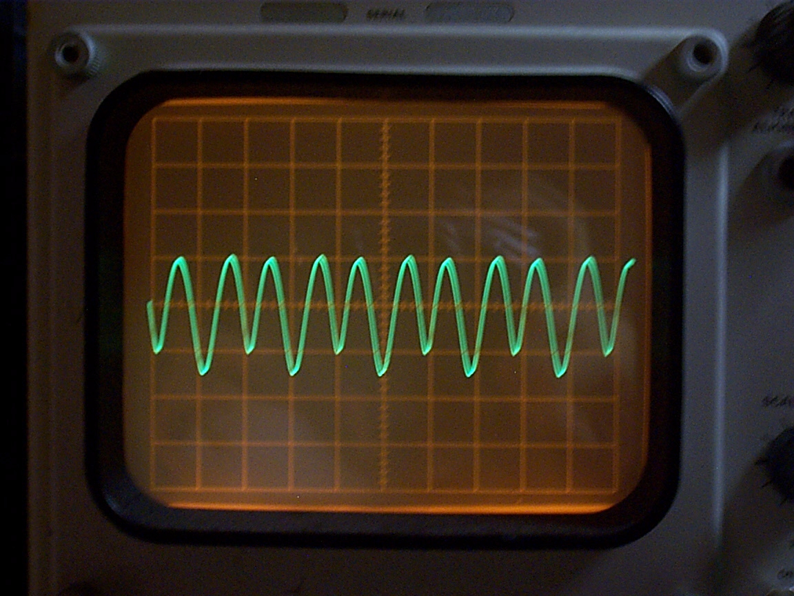

Alright, I've been taking a break sort of, but here are pics from a very basic distortion test. I put one probe of my differential scope plugin to the input and output of the amp, and adjust the volume so they cancel out and leave the distortion residual. These tests are from the version in post 261, I haven't prototyped newer versions yet.
Long story short, it doesn't work so well if there is a lot of phase shift between your amp's input and output. I simulated to find the best point to test, which is about 5KHz with minimal phase shift.
The first trace is 5KHz distortion with no niceness, 20mV/div. The monotonic distortion of the NTP is visible as the slight egg curve. This disappears without the 50 ohm load.
The second trace is the same, with niceness all the way up. 2nd harmonics are obvious. 200mV/div.
Third trace is 15KHz, with niceness turned all the way up, 500mV/div. Without niceness, phase shift is too large to see the distortion.
- keantoken

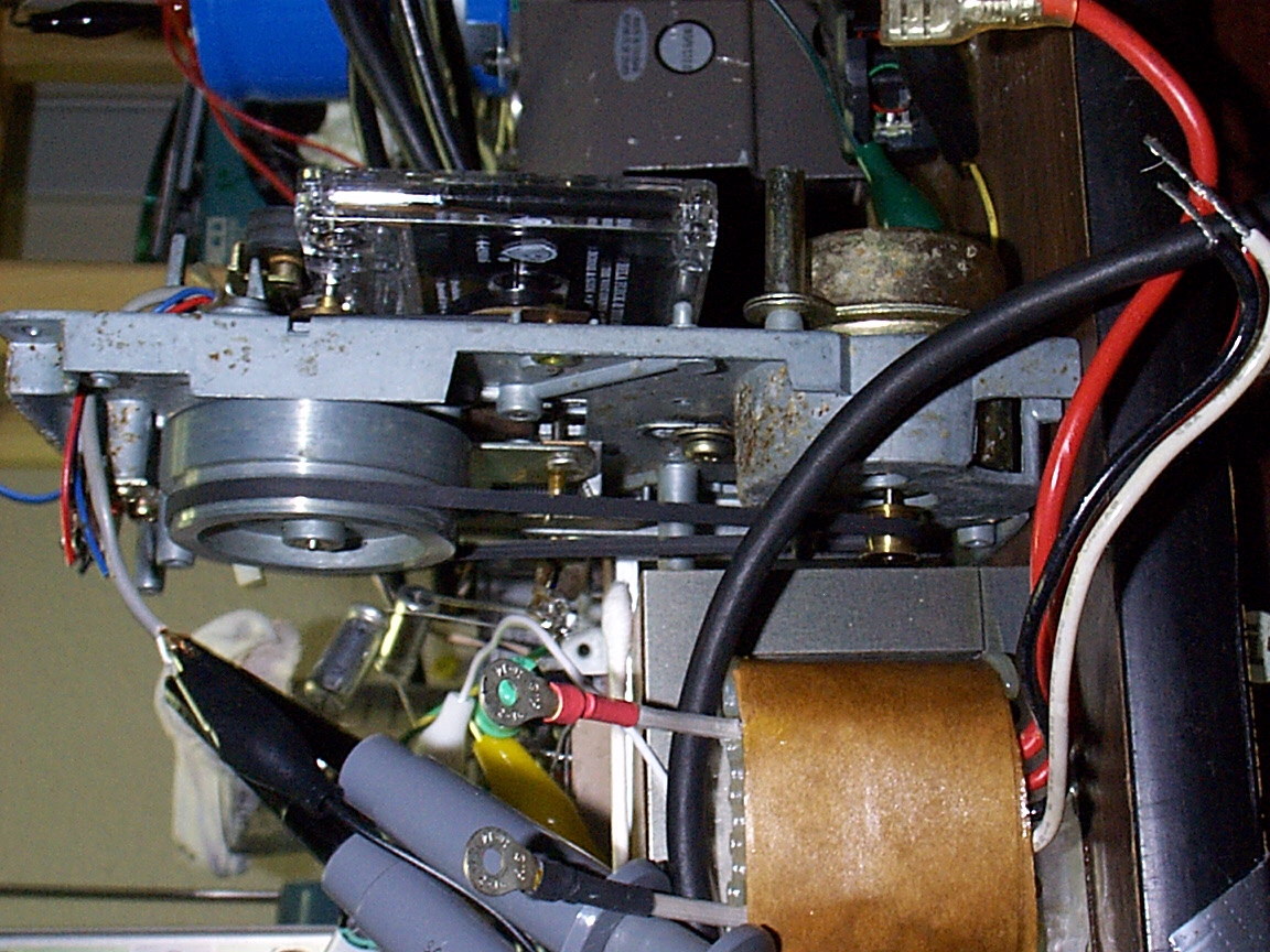

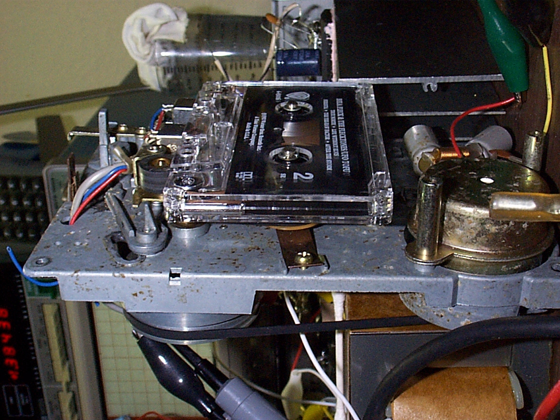

I pulled this out of a really old tape player. I think the tape head is mono. In the future I think I will use my own circuits to make it into a full cassette player. I've cleaned all the parts and oiled them again, tested it on a tape head cleaner/degausser.
I'm listening to it through headphones from my scope's signal output connector.
Bela Fleck and the Flecktones
- keantoken
Yes, cassettes are really cheap these days. I scored some really nice ones at 50c a piece. Eh, cassettes aren't audiophile approved, but I couldn't care less.

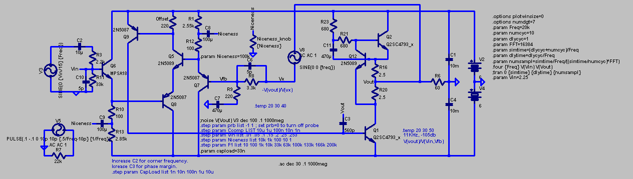

Hey kt, I got some good news. Got my tube headphone amp working, stable, and with decent distortion (maybe). Can't say anything about the sound, as the prototype is mono only. At this point if you got a stable recipe of your own headphone amp it'd be great, because I'll be busy for the next little while with the pcb and proper build of my amp.
There is no reason why this schematic should be unstable, you should be able to get it working with minimal finicking. It's slower, but still very fast.
- keantoken

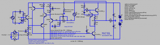

Okay, I'm screwing around with the prototype again.
I haven't had any design ideas for months, so I can freeze the schematic below, except for the compensation values, which should be determined when and if I ever get a PCB design ready.
I've been looking at square response lately, and have some observations:
1: heatsink should be grounded.
2: input pot must be grounded.
3: Don't leave the third lead hanging on the bias trimmer.
Before fixing these I had strange problems where it would oscillate near the middle of the volume setting. Now square wave response is much smoother, with a little ringing.
- keantoken
