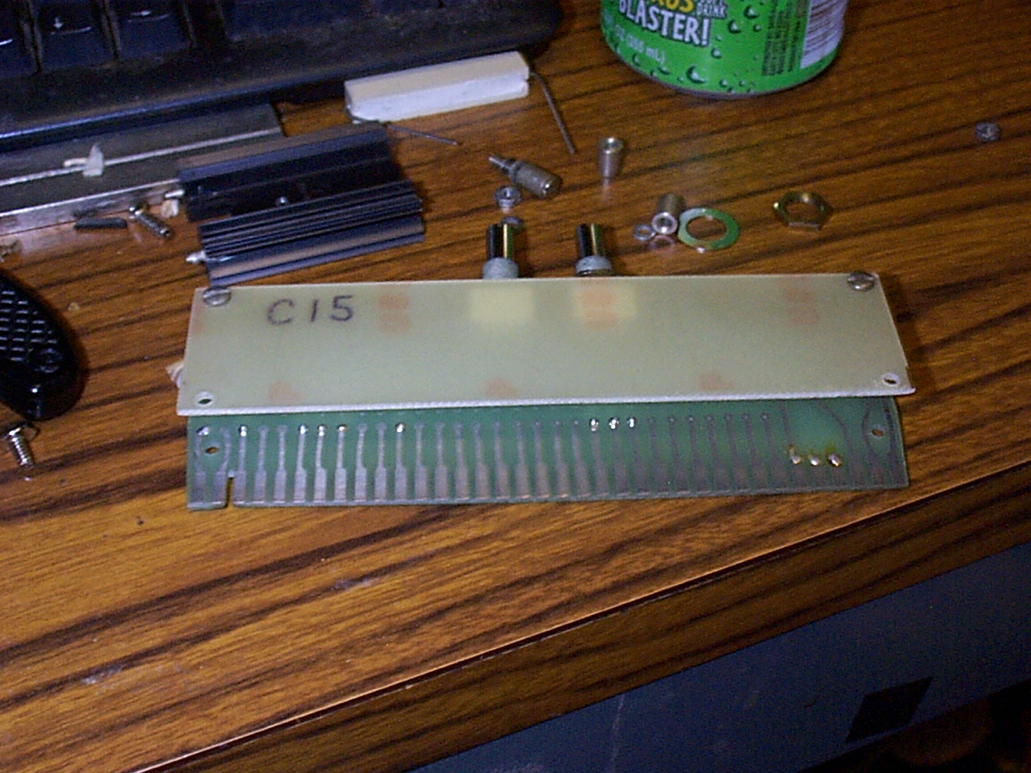

Alright, my next prototype will be stereo and I think I will be able to fit it in the attached space. Used to be some module for some arcane device? Got it from a repair shop and though it would be perfect for prototyping.
If/whenever I get that done, after tests I might send it off in an envelope to inquiring minds, to see how much my ears correlate to everyone else's.

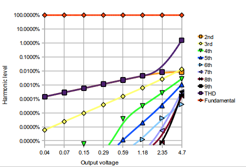

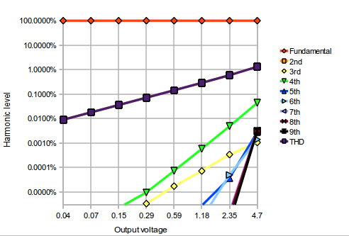

Here is a harmonic profile vs. output voltage graph for a 33 ohm load, lowest load for +-5V swing, which is close enough to clipping to increase THD. Listening with headphones is usually done at around +-50mV (for my portapros at least). This done with the Niceness knob at 1kohm.

Here is with the niceness knob at 100 ohms. The 2nd harmonic is hidden behind the THD line, since the other harmonics are so low there is hardly a difference between the two.

I don't follow your comparison with the previous post.Here is with the niceness knob at 100 ohms. The 2nd harmonic is hidden behind the THD line, since the other harmonics are so low there is hardly a difference between the two.
Are the left hand scales labeled correctly?

AndrewT, the harmonics are plotted as a percentage of the fundamental. Note that the left axis is logarithmic. The 2nd harmonics comprise almost the entire THD reading, which is why the 2nd harmonic percentage and the THD percentage are right on top of each other.

is this confirming that the scales are labeled correctly?AndrewT, the harmonics are plotted as a percentage of the fundamental. Note that the left axis is logarithmic. The 2nd harmonics comprise almost the entire THD reading, which is why the 2nd harmonic percentage and the THD percentage are right on top of each other.
Look at the absolute values of each of the harmonics in the two cases.
The second posting shows very clearly that some of the harmonics are approaching a factor of 10 higher than the previous posting.
That does not equate with your statement
since the other harmonics are so low (there is hardly a difference between the two)
With the niceness knob turned to your example value, some of the higher harmonics are much worse than without the tuned value niceness knob.
