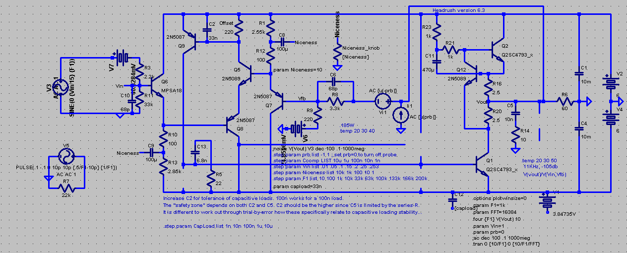

Alright, I finally realized I'm being held to a higher standard.
I get it, guys. Took some time, but don't get cocky, because I have to return the favor and blow your socks off. Fine! I'll give you exactly what you want!!!
Here it is, in all it's glory.
I want to return focus to post #214. Look at those awful Vbe curves and what they do to the higher order distortions! I have thus come to the conclusion that the B-E resistor is a cruel and unusual way to treat an amp and the person who must listen to it.
Funny thing is, see how many transistors I wasted just trying to buffer it? Doesn't matter, it distorts just the same and even worse when all the Vbe's add up and are imposed across R4, and the current gain is only about 2!!!
To make things worse, Vbe is highly nonlinear, which injects distortions right into the feedback loop and everything. Nasty!!!
Distortion is actually less, after removing both buffering transistors and the resistor. Since Hfe is far more linear than Vbe, we've just beheaded most higher order distortions. Performance into 4 ohms is clean!

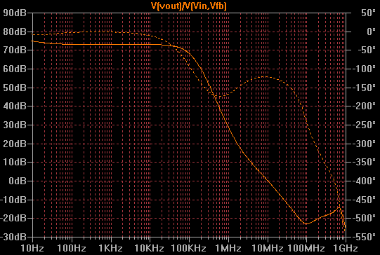

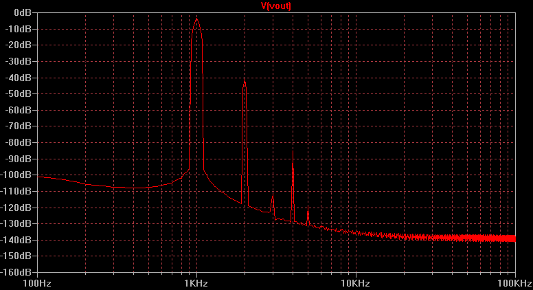

Attached is the FFT at 1KHz, 2Vpk-pk into 60 ohms. The first plot is with the Niceness knob turned all the way up, the second with it all the way down. In addition, the simpler circuitry has improved speed, which means smaller compensation. The OLG corner has moved to 100KHz!
Are you happy now!? Iko, I know you're smiling! The old HeadRush is back!!!
(Looks awfully "Tube-like", no?)
- keantoken

Yes kt, I'm smiling! I haven't kept up with exactly all the versions, but that original one I liked much, at least the way it simulated. So if this one is closer to that one, I like that. The distortion profile of this one is nice, for sure. How far are you from a prototype?
The first one simulated so well because the MPSA18 models were a match made in heaven.
But, I think your original idea to adjust R1 to balance the transistors will work to achieve the same performance if it is desired. It may interfere with the offset control, however I should probably use an output cap or servo for a headphone amp anyways.
- keantoken
If I use a series cap, I want to DC bias it for best operation, which would necessitate input circuitry that references ground to the same rail.
With a feedback capacitor, offset is pretty stable. If you don't want an output cap or a servo, then you will want a regulated supply, because the air conditioner turning on and off bumps the offset up or down a few mV.
- keantoken

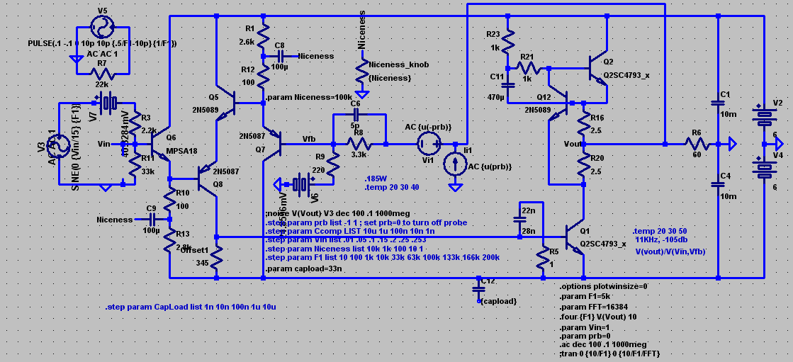

Here is the circuit I'm looking at in the sim.
THD@1KHz into 60 ohms 2V pk-pk, is .0083%. Larger than I hoped, but others here should be satisfied. With the current design, no one should worry about high-order harmonics. I have done my absolute best, save for removing the level shifters, to ensure as little high order trash as possible.
Every revision since the first prototype seems to have improved sound, except for minor compensation changes. There are a few other things I still want to address.
The circuit no longer reproduces ultrasonics with the same grace it does the midrange, due to the vastly reduced open-loop gain. Distortion increases steadily with frequency. I'm not sure how this will affect the sonics, and in this regard previous versions might be more favorable.
Phase shift at 100KHz is -2.4 degrees.
Upper -3db point is at 3.5MHz. Lower -3db point is determined by input and feedback caps.
It is stable beyond slew and current limit into capacitive loads.
Bonsai!
- keantoken

Hi kt, it's almost impossible to read some of the values off the schematic. What's v6? If I may suggest, when you post the schematic to remove the grid so the grid dots may not be mistaken for decimal values. Also, would help to have the distance between components large enough that their info doesn't overlap.
