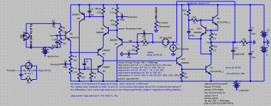

Increased C2 to 33nF, to help into capacitive loads, decreased C5 to 6.8nF. It's now either stable into 10nF or it oscillates above 1MHz either way. However DC offset doesn't change with 10nF loads, which gives us a good bet that it's not oscillating.

The input and feedback caps are bright green electrolytics, rated 200V each, and labeled "HXBP". I got them out of old ultrasonic air fresheners, I think they were used in a flyback type circuit to get the voltage necessary to actuate the piezo tranducer thing... I think they are similar to photoflash electrolytics. I should probably increase C3. Schematic as implemented.
