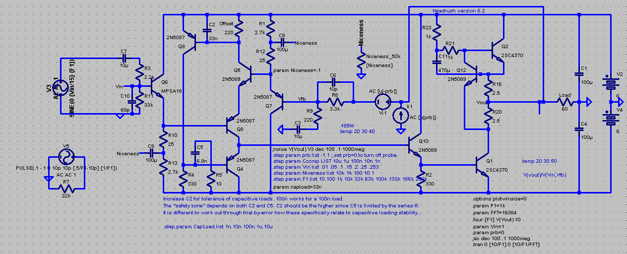

C11 bootstrap could be better driven, either by VOut or Q2E.
That does assume you are driving Q2B through Q12EC like an
Allison or Aleph. Are you trying to load Q1C with R23 1K, and
drive Q2B through the electrolytic path in parallel with Allison?
Is this part of a plan I don't yet grasp, or a simple miswire?
Hi Ken. I didn't notice that schematic blip. It IS intentional, but I haven't wired it up that way in real life. When wired this way, the current through R21 acts as push-pull and helps Q12 drive Q2, or at least acts as a better CCS. Wired with Q2E as reference, it does the opposite.
I've mentioned in other places how bootstraps can be improved upon, yet usually aren't.
- keantoken

kt, can you please post the schematic of the amp that you actually built?
BTW, a couple of days ago I almost started a layout for your amp then got side tracked again with more experiments with my lna. But you keep making me curious with this amp, so I might just start the pcb layout soon.
Here it is, as built, all components in their actual values and connections. Notice that the output transistors are 2SC4370, but I was using the 2SC4793 models.
C6 should be more like 50pF, 68pF good enough.
- keantoken
Gah, not again. R12 and R10 should be 100 ohms. 25 ohms gives funny shaped overdrive characteristics.
There are a few margin-type things I have excluded in order to get the prototype ready fast. For instance, Q12 may need stability compensation although I haven't had problems. If you're making a board I would like to discuss the few extra things that should go on it "just to be sure".
- keantoken
Should Q4 be thermally bonded to Q10? I'm not sure why Q4 is oriented
so as to be a diode curved load for Q8. Unless its some sort of current
mirror thingie together with VBE Q10... But wouldn't a CCS type loading
have made more open loop gain?

Q4 might be considered the third buffer to the VAS Q1. So it's like a double buffered VAS. Just think of Q4 as a complimentary EF buffer... This was originally added because I wanted to experiment with MOSFETs in the VAS, but that turned out to be a bad plan... Haha lol.
I didn't plan to have thermal bonding, and temperature change here will have a very negligible affect compared to the tempco induced by Q9.
Q4 gives Q10 a very low source impedance, which boosts usable bandwidth. Or so the theory goes. At the least it was comforting to know that bandwidth would probably be the least of my problems. Bandwidth is important if you want open-loop plots like the ones I posted.

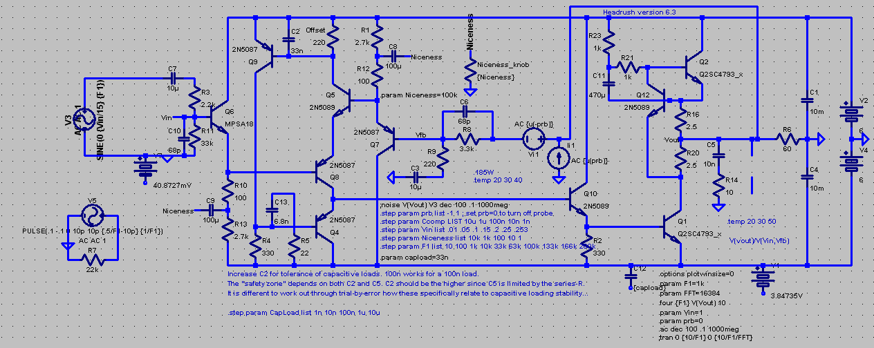

I found a 68p cap stuck in my foot this morning (my last one!) so I decided to upgrade C6. So far it's stable into 10nF.
Here is the schematic of the prototype sitting on my bench.
C5 and R14 look like a Zobel, but their actual purpose is stability compensation.
- keantoken

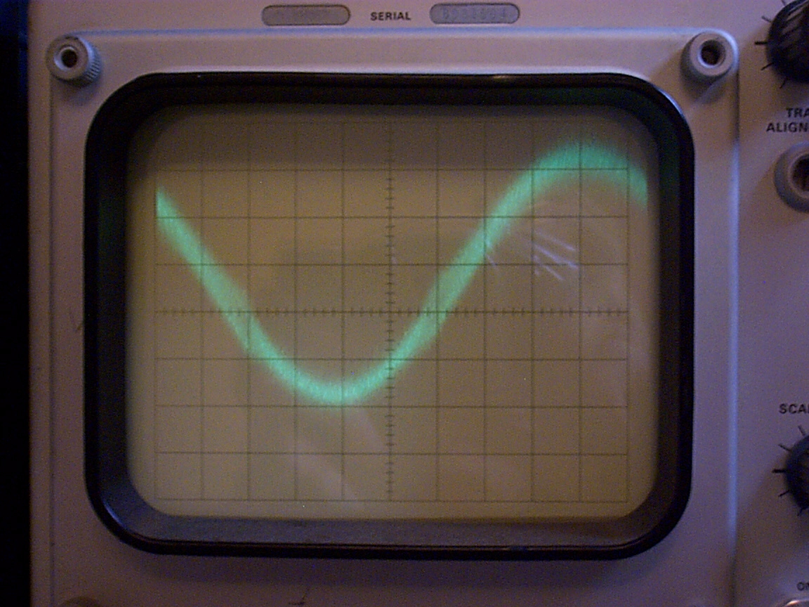

Something's oscillating but it's NOT my amp!
Look at my soundcard output!
20mV DC offset, and oscillating! NOW I know where all the ultrasonic trash is coming from!
I'll try getting a shorter cable from radioshack, not one of those spiral ones I have now, it must be a perfect resonator.
- keantoken
The amp gives a clean sine well into the hundreds of KHz, with my signal generator. My signal generator is not suitable for audio however.

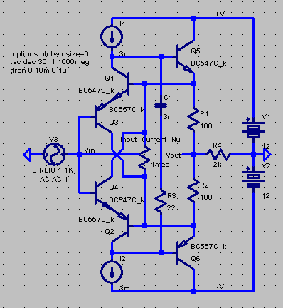

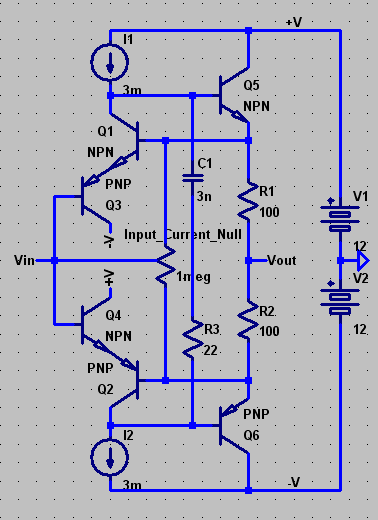

I think, if I build two of these high-Z Allison buffers, I'll be able to measure differential voltage directly, and thus take visual distortion measurements and directly verify operation.
- keantoken

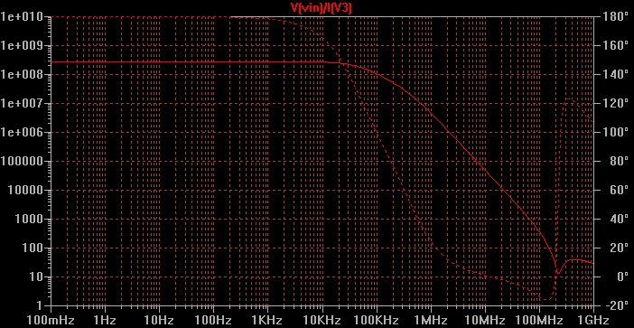

Actually, here is the actual circuit I might try to build. That is 268megaohms at 10KHz!!! (this is with the 1meg trimmer disconnected) Of course this value is optimistic because of the current sources, but it gives one an idea of what is possible.
So it should be an excellent electrometer. 😉
The big boost comes from the effective cascode of the input transistors, which removes early voltage and nullifies collector capacitance. This is better performance than I would hope to achieve with a Jfet buffer. Not sure how noise pans out.
- keantoken
With 100k CCS impedance, input impedance is still 2megaohms. But it is possible to get way higher than that with just a 2-transistor CCS. I have two options: options 1 has high impedance. Option 2 has lower impedance but less imprint at HF.
My main concern is stability. It is hard to get the circuit stable without limiting HF. I think I have a solution but the bench will be the arbiter...
- keantoken
