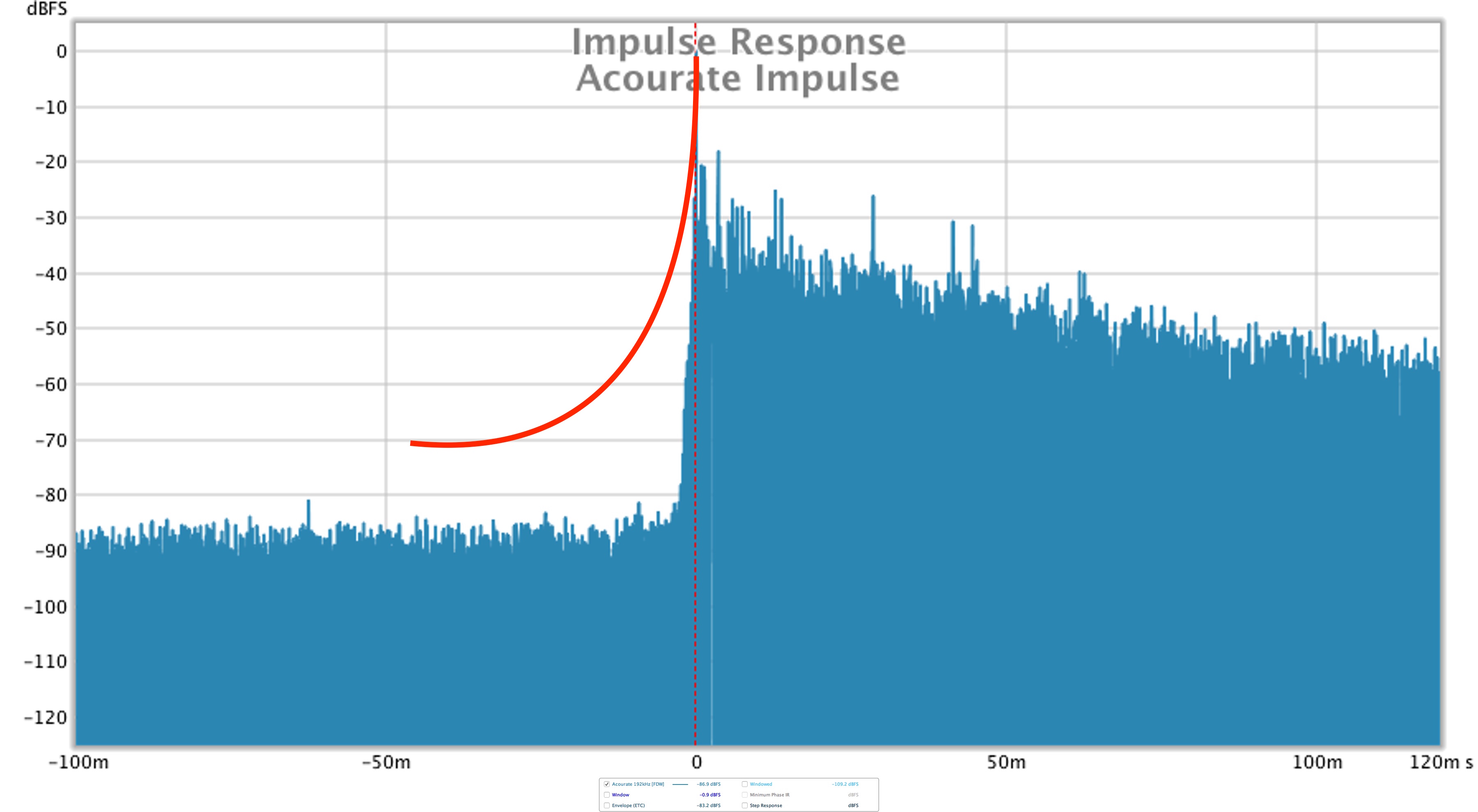

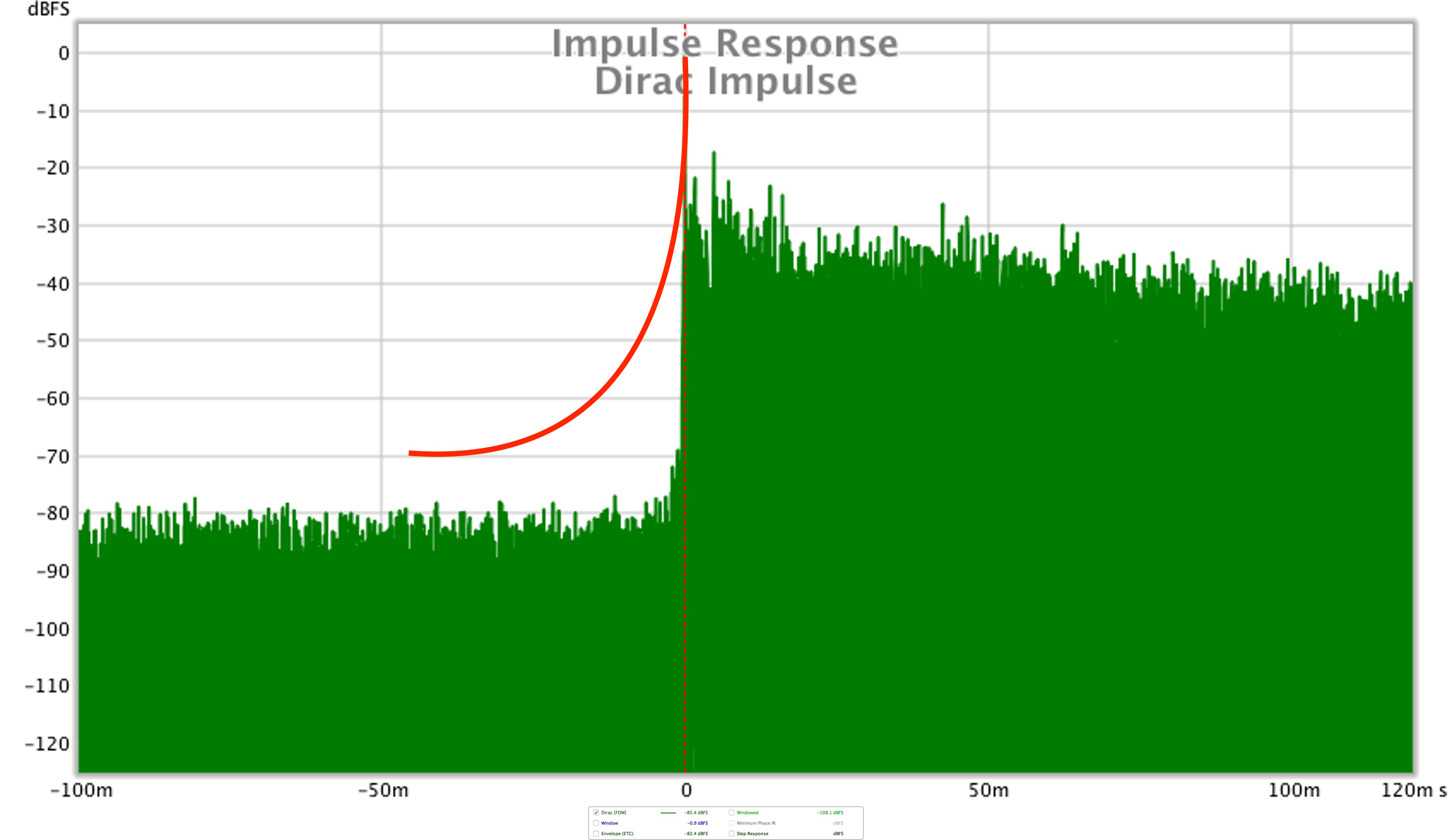

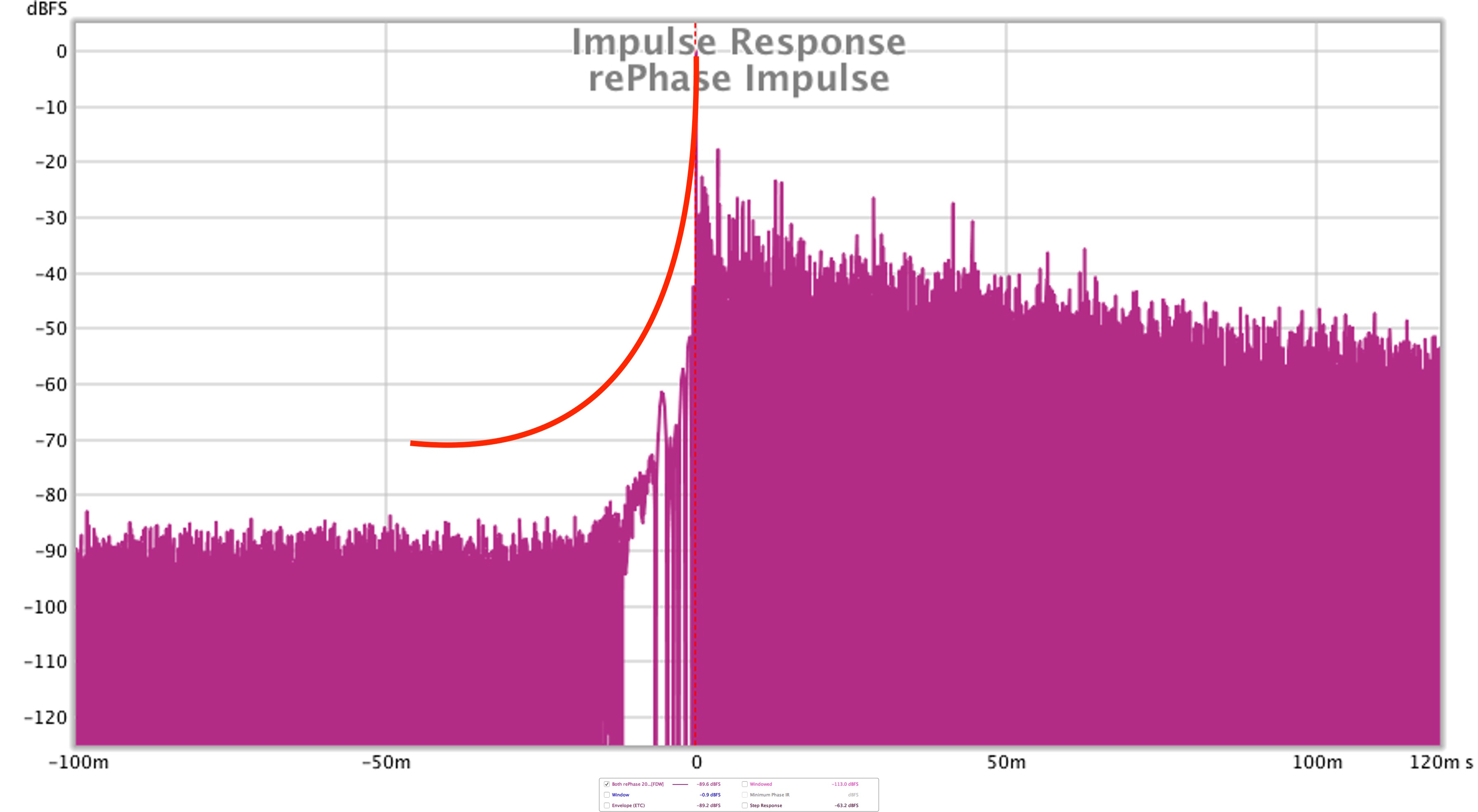

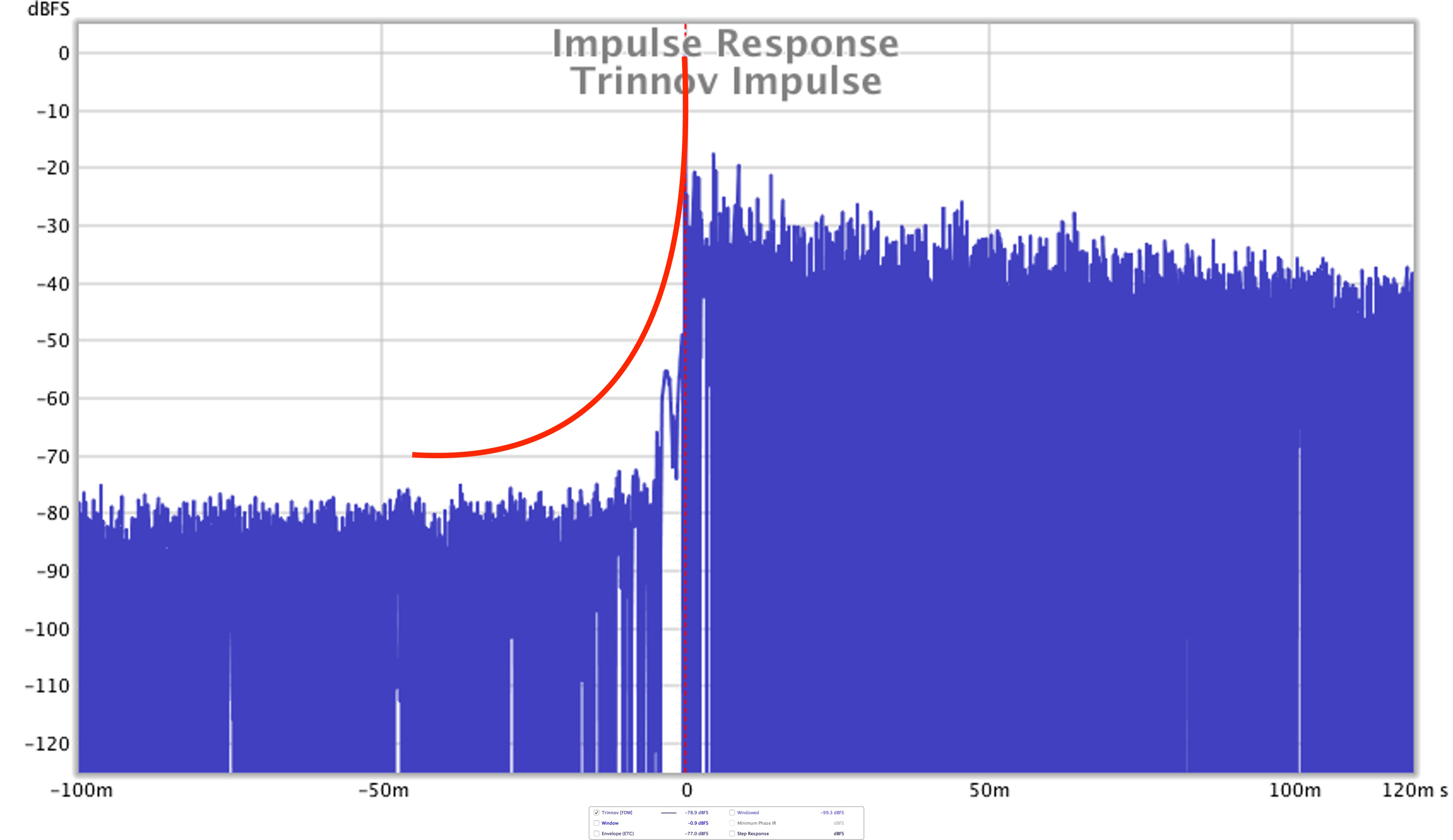

To achieve a more complete answer on pre-ringing audibility, with the help of the paper of Bohdan and a manual replication, here are the measures I made on my system.
Conclusion: none of these correction systems are producing audible pre-ringing IMHO.
