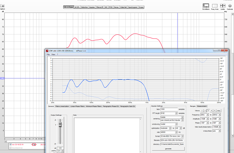

I'm having problems using Rephase with the new miniDSP HD.
So I run a measurement of the driver, no crossover. Then I go to rephase to flatten the response and phase and introduce a LR8 lowpass at 1000Hz. I'm happy with the calculated curve so load the filter into miniDSP and run a measurement, results above. The preview look in the miniDSP software looks like the measurement, not like the calculated curve in Rephase.
I tried changing the number of taps and tried LR4 and other types of crossover. I ask for 1K and get around 2K. Any idea what is causing this?
