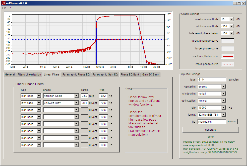

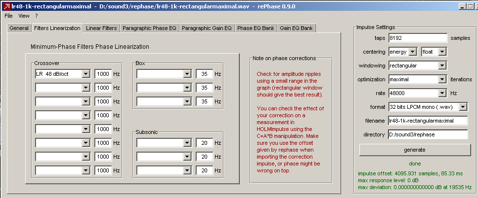

Here is a little piece of software I have been working on for some months now.
It is called rePhase, and is a tool for loudspeaker phase linearization, EQ and FIR filtering.
It does so by producing correction impulse responses that you can then use in your favorite convolution engine.
It is a free software, without restriction (but without warranty either).
Download: rePhase project page

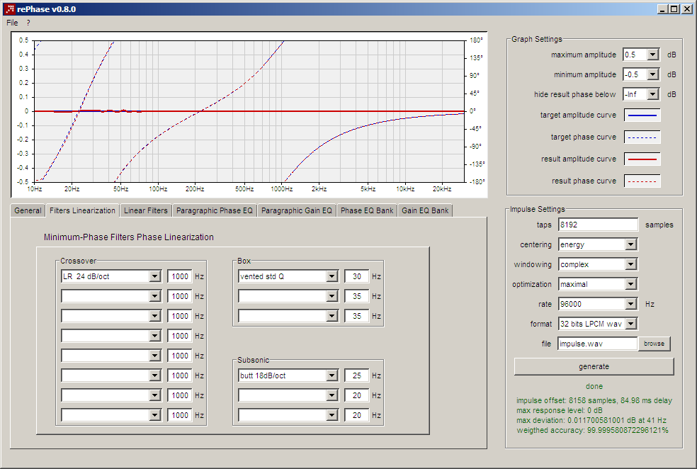

At start the first goal of rePhase was to let you generate impulses specifically tailored to reverse the phase shifts introduced by the crossovers of your loudspeakers (passive or active) and boxes, resulting in a linear-phase system.
It is similar to phase arbitrator in this regard (but it is not a processing plugin, just an impulse generator).
rePhase has evolved and now includes other features: it can generate linear-phase EQ and crossover filters of arbitrary slopes, including Linkwitz-Riley (albeit linear-phase) and Horbach-Keele shapes.
With the paragraphic EQ sections you can alter phase and amplitude independently.
You will need a convolution engine to run the generated impulse, such as the minidsp openDRC, foobar2000 convolver or VST convolver, among many other software and hardware tools.
You can use rePhase to linearize passive loudspeakers, active ones, and turn IIR active crossovers into linear-phase crossovers (turn a DCX2496 into a DEQX or a Dolby Lake
You can also design the whole filter with rePhase.
In any case you will need one convolution per way (Jriver can be used to run the convolutions for example)

Hello Andrew,
I do not plan to add IR import for the version 1.0.0 milestone, but that could come after that.
Sorry about that. I have to give it some more thoughts before choosing an integration strategy (and avoid the "automated correction" temptation...).
Right now you can use HOLMImpulse and the C=A*B manipulation to check the result of a given correction on a measurement.
Can you please give me the exact settings and version of rephase that generated the ringing shown in your screenshots?
Version 0.8.4 could generate a HF ringing at the Nyquist frequency when the phase target was not a multiple of 180° at the end of the spectrum (which was particularly the case with high order and high crossover freq filter linearizations...). This should now be fixed with the new "float" centering option (the phase target is artificially shifted to the nearest 180° multiple at the Nyquist frequency, and the impulse is then offset by the corresponding sample fraction to restore the original phase target).

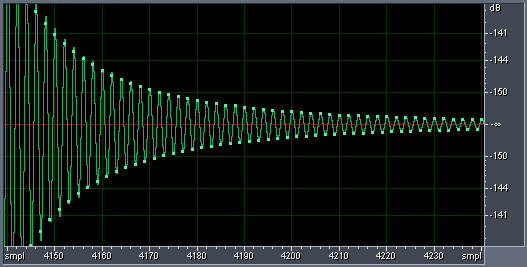

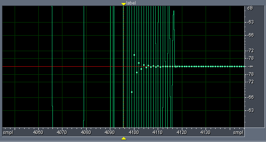

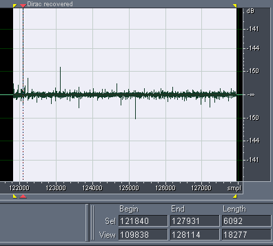

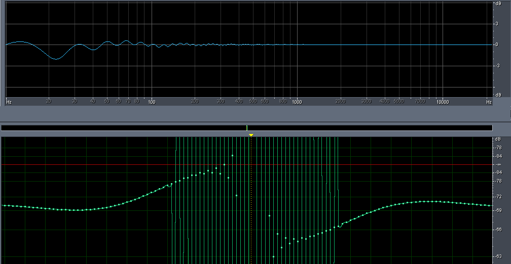

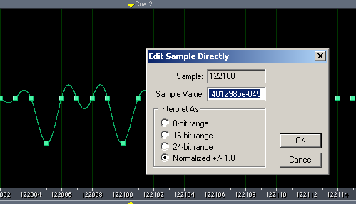

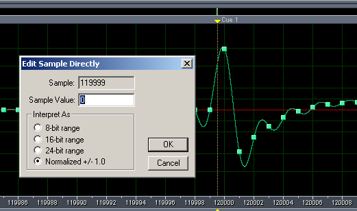

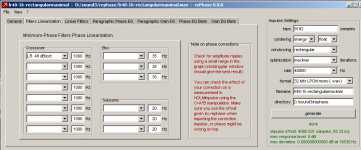

I used:
And various combinations of settings; all produced ringing.
Real point is filter mismatch and degree to which it impacts results with convolution engine. Allpass filter generated with Cool Edit convolved with time reversal of itself produces clean Dirac, likewise rephase linearization filter convolved with time reversal of itself produces clean Dirac.
When rephase Linkwitz-Riley 48dB/octave 1kHz linearization filter is convolved with Cool Edit Linkwitz-Riley 48dB/octave 1kHz allpass filter, the slight mismatch appears like this:
(click to enlarge)
I've seen similar results in past when filters recovered from DCX2496 are convolved with time reversed filters generated with Cool Edit.
On the other hand,when correction filters are generated by mathematically derived inverse transfer function of measured responses, very controlled results are possible.
Andrew
(click to enlarge)

I was indeed able to reproduce what you got:
I generated a LR48 dB/oct at 1khz with rephase (LR48 in FIR section, and LR48 linearization in time=inv mode) and did the same with cool edit (2 4th order butterworth cascaded on a dirac).
The impulse generated by rephase has some ringing that the one generated by cool edit does not have.
In fact the impulse generated by rephase has more ringing on the left of the impulse, but the impulse generated by cool edit has more ringing of the right side (which is normal I suppose?).
Thank you for bringing that up. This might be due to some 32bit rounding in the FFT engine, I will see how this can be improved.
The impact should be quite limited though: this ringing is very low in level (already much lower than what it was in rephase 0.8.4, thanks to the fractional sample centering) and is at the Nyquist frequency.

......cool edit has more ringing of the right side (which is normal I suppose?).
Cool Edit Pro2.1 running on XP SP2: LR 48dB/octave generated starting with Dirac produces all zero to left of causal Dirac, when waveform is reversed in time all zeroes appear to right. I start with stereo Dirac, apply HP Butterworth 4th order twice to left track, and apply LP Butterworth 4th order twice to right track, both tracks are then summed producing all-pass result with non zero values spanning 2101 samples (48kHz sample rate):
Normal time order:
Final sample:
Convolution of the 2101 sample filter with a time reversed copy yields:
Convolution is Aurora plugin, applied with 0 scaling or DC correction. Recovered Dicac has normalized value of one. Total math has been done on 6092 samples as apparent in above picture.
