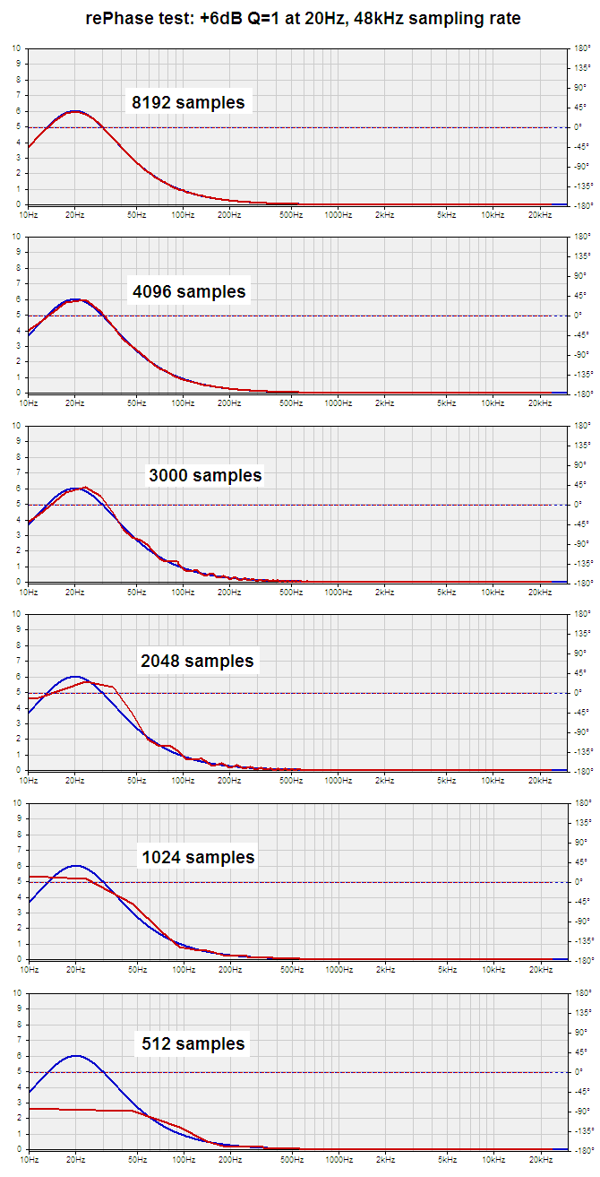

Give me an example of EQ, phase linearization, or linear phase filter of a given slope and frequency, and I will post some curves showing what can be expected depending on the number of taps (impulse length).
Here goes!
This is from the rePhase interface, but it should be accurate.
Blue is target, red is result (after several automated optimization steps)

What is it you want me to simulate exactly?
2nd Order Q=1 HP together with a 6dB boost?
What Q for the boost?
Or is it phase linearizion and not actual filtering that you want me to show?

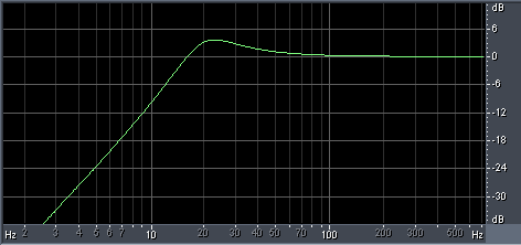

No, what I wanted was a 2nd order high pass filter, say a B2 at 20 Hz. Then add a Q =1, +6dB boost centered at 20 Hz. So there are 2 stages. But, the plots above show the point I was getting at. You need about 8k taps at 48k sampling to get good resolution at 20 Hz. And if you go to 96k sampling you would need about 16k taps....and so fourth as the sampling rate increases. This has a dramatic effect on processing time even when using partitioned convolution.

2nd order Butterworth 20Hz high pass with 20Hz Q=1 6dB:

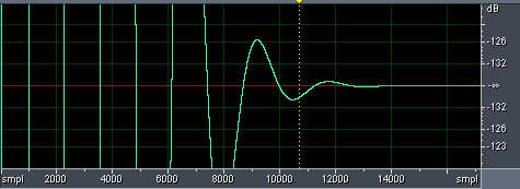

Zoom of IR to -132dB:

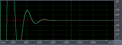

Zoom of IR to -90dB
From above it is clear that truncation to less than 8k taps introduces questionable artifacts.
For real control of subs IR get longer.
Higher Q filters push filter length up very quickly.
Correction of LF in room swells this right up too.
I get most consistent results with 16k-32k taps.
For speaker operating >40Hz I've done quite well down to 8k taps.

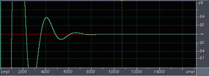

Zoom of IR to -90dB

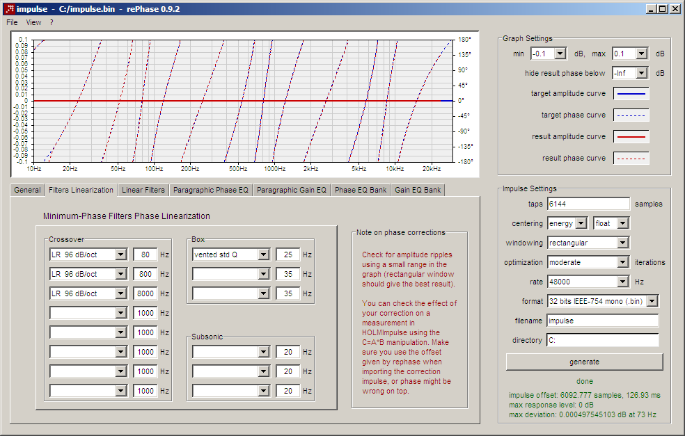

With the 2x6144 taps @ 48khz of the openDRC you can "lienarize" almost anything, even bassreflex phase shifts (and it does only use direct convolution for now!).
Here is an illustration, with a somewhat "exaggerated" correction:
BR at 25Hz, and LR 96dB/oct (16th order) at 80Hz, 8000Hz and 8khz (of course only the first one present any challenge, but this was done to simulate something realistic).
Blue is target, red is result.
As you can see it all turns out perfect, and the impulse "center" is automatically set a 6092 sample within the 6144 samples of the impulse.
Adding some linear phase EQ would "symetrize" part of the impulse, but most of the energy would still be on the left of the peak and auto-centring would adapt...
